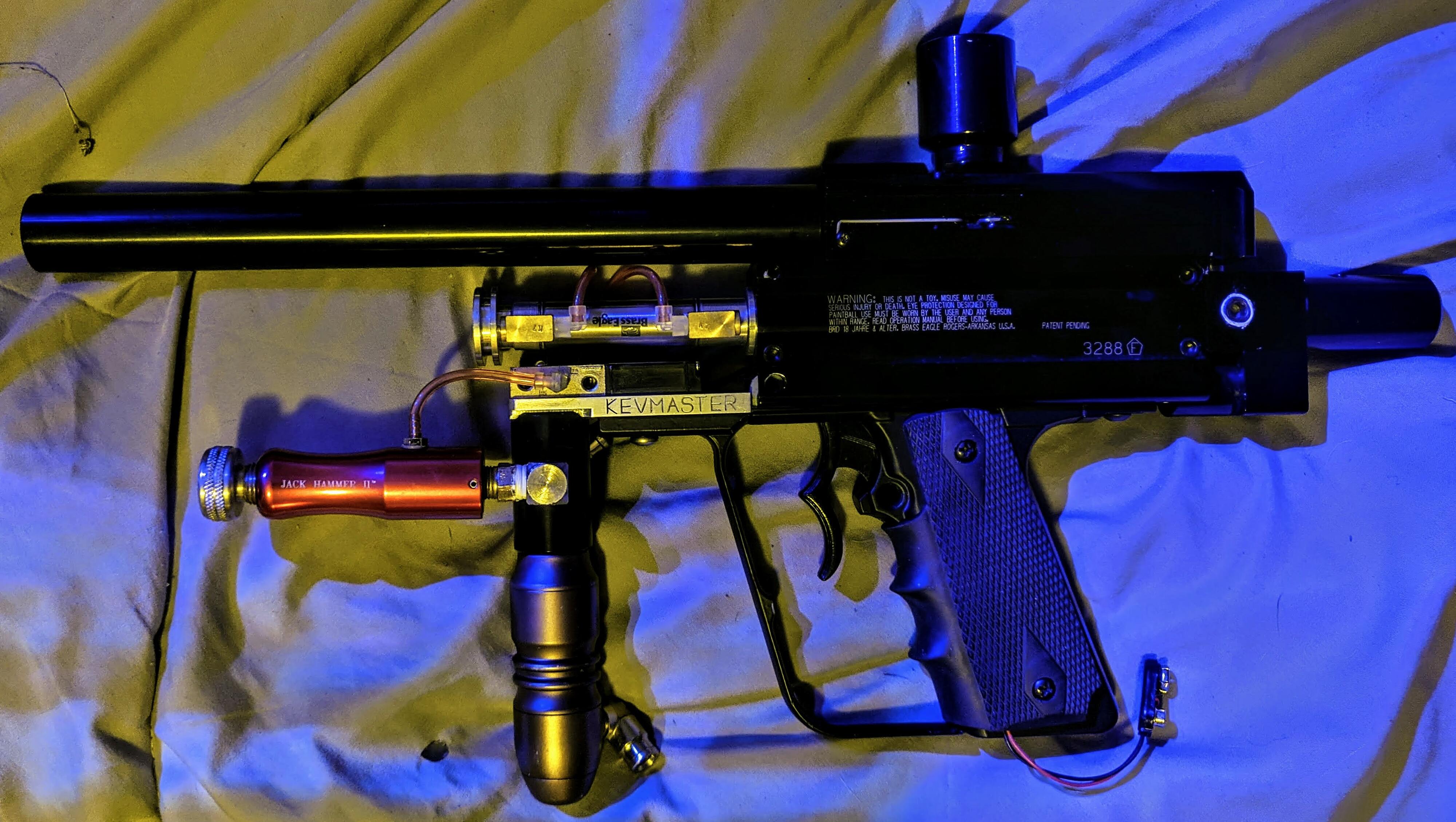

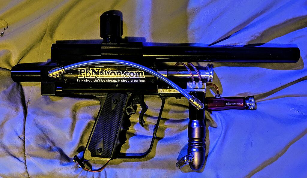

    IMG_20210226_183703.jpg IMG_20210226_183718.jpg Hey! This thing hasn't been out of the box since 2003, went to air it up and leaks down barrel but fires as it should. Anyone have a list of orings for this thing so i can rebuild? Also considering just selling it either now or after i get the leak figured out as I just don't have the time or interest to devote to it anylonger...does anyone even want these things anymore?

    KevMaster BEOG? Send it to Jordan he will fix it lol. Leak down barrel though, I would assume you need a cup seal. Or smooth the sealing face of cup seal if you cant replace it.
    Also, if you wanna sell I may be interested. PM price if you want it gone.
      Jordan commented
      Leak down the barrel is more likely valve body orings... still check the cupseal and valve sealing surface, though.
      Thanks for the mention! (I'm always open to questions, but I'm not interested in working on anything that's not a personal project right now.)
