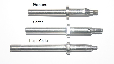

    ​ Phantom on top.....

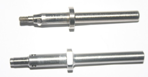

    Click image for larger version  Name:	buz2cci power tubes1.jpg Views:	0 Size:	22.2 KB ID:	626168
    Click image for larger version  Name:	buz2cci power tubes2.jpg Views:	0 Size:	21.0 KB ID:	626169
    Inside diameter:
    - Phantom: .172
    - Carter: .145
    Diameter where it enters the valve cap:
    - Phantom: .248
    - Carter: .274
    Diameter of tube forward of collar:
    - Phantom: .248
    - Carter: .235
    Length of tube, forward of collar:
    - Phantom: 1.386
    - Carter: 1.520
    The Phantom power tube will work, but there is a bit of slop due to the difference in diameters. Changing just the powertubes causes a velocity drop when the Phantom tube is used.

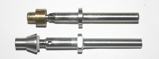

    All three power tubes:
    Click image for larger version  Name:	buz2cci2lapco power tubes.jpg Views:	59 Size:	22.7 KB ID:	626286
    The Lapco is very similar to the one for the Phantom, it is just longer.​​
    Originally posted by RedLeaderSB
    Does the phantom valve body nut thread in? I have a Carter with phantom power tubes in it, but I don’t recall if I had to make a bee valve body to match the nut or not.
    The Phantom nut will not thread into the Carter. The Carter takes a larger diameter.
    Some more twiddling....
    1. Carter powertube, heavier than red main spring, stock silver valve spring, TPC set to middle of run, 800psi output 13/3000 with a fresh fill. Shooting 212 to 220fps....
    2. No change to parts in step 1, TPC one more turn in, shooting 220 to 228fps.
    3. Change just the valve spring to a very light one, shooting 238-241fps.
    4. Change tank only to a 625psi output, charged to 3000psi, expected the velocity to drop, and it didn't! It went up to 248-255psi....
    5. Mounted a 12-gram changer, stuck in a twelvie, charged it up, no leaks. Expected a change, but not a great one. Wrong again! <shakes head> Velocity dropped to 215-217, very consistent over 10 shots.
    Am I going to have to put a regulator on this and find the sweet spot? Yeeshhhh.....​

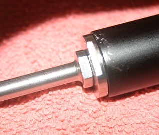

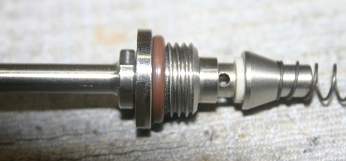

    Inlet holes:
    Click image for larger version  Name:	ptube port1.jpg Views:	0 Size:	30.3 KB ID:	626631
    Powertube completely closed with spring installed:
    Click image for larger version  Name:	pt_closed w spring.jpg Views:	0 Size:	35.0 KB ID:	626632

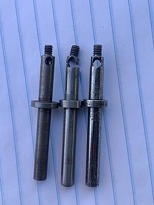

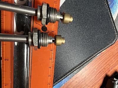

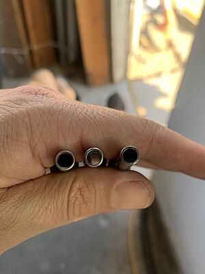

      Here are some of my Carter Powertubes for comparison. The left one is a 3 hole, the broken center is 2 hole turned down and has ramped holes with flats. The right is 2 hole also turned down with flats
      • Walker
        Walker commented
        Mine do not look like that at all.....
      • Socalpumpballer
        Socalpumpballer commented
        Yours is a very specific era of Carter power tubes that are not standard nelson spec and had its own specific valve nut. was suppose to be the most efficient one he ever made allegedly. I would ask Bacci if he has anymore info on them. Even other examples I’ve seen have larger holes though

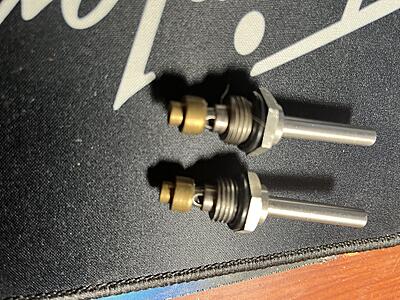

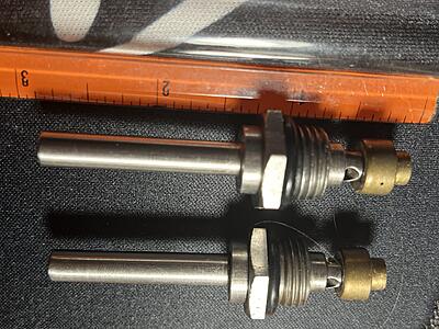

              Here are the power tubes Earon made for me about 2 1/2 years ago. For all I know these are phantom tubes, but they look just like my original tube that is somewhere around 30 years old.
              Notice:
              3 holes - not just 3 holes, but 3 holes drilled at an angle - we had to use a special drill bit and an indexer to get them like that - I broke more than a couple of those drill bits which were a fortune back then.
              the power tube is also tapered and the cup seal comes right up to the holes. This is all to facilitate the ease of air flow into the tube with (in theory) as short of a dwell time as possible.
              Earon did change things through the years, I'm sure. When ever I would see him we didn't really talk paintball. We usually talked about sports betting and regular life stuff so I never really kept up with the details of what he was doing in paintball.
