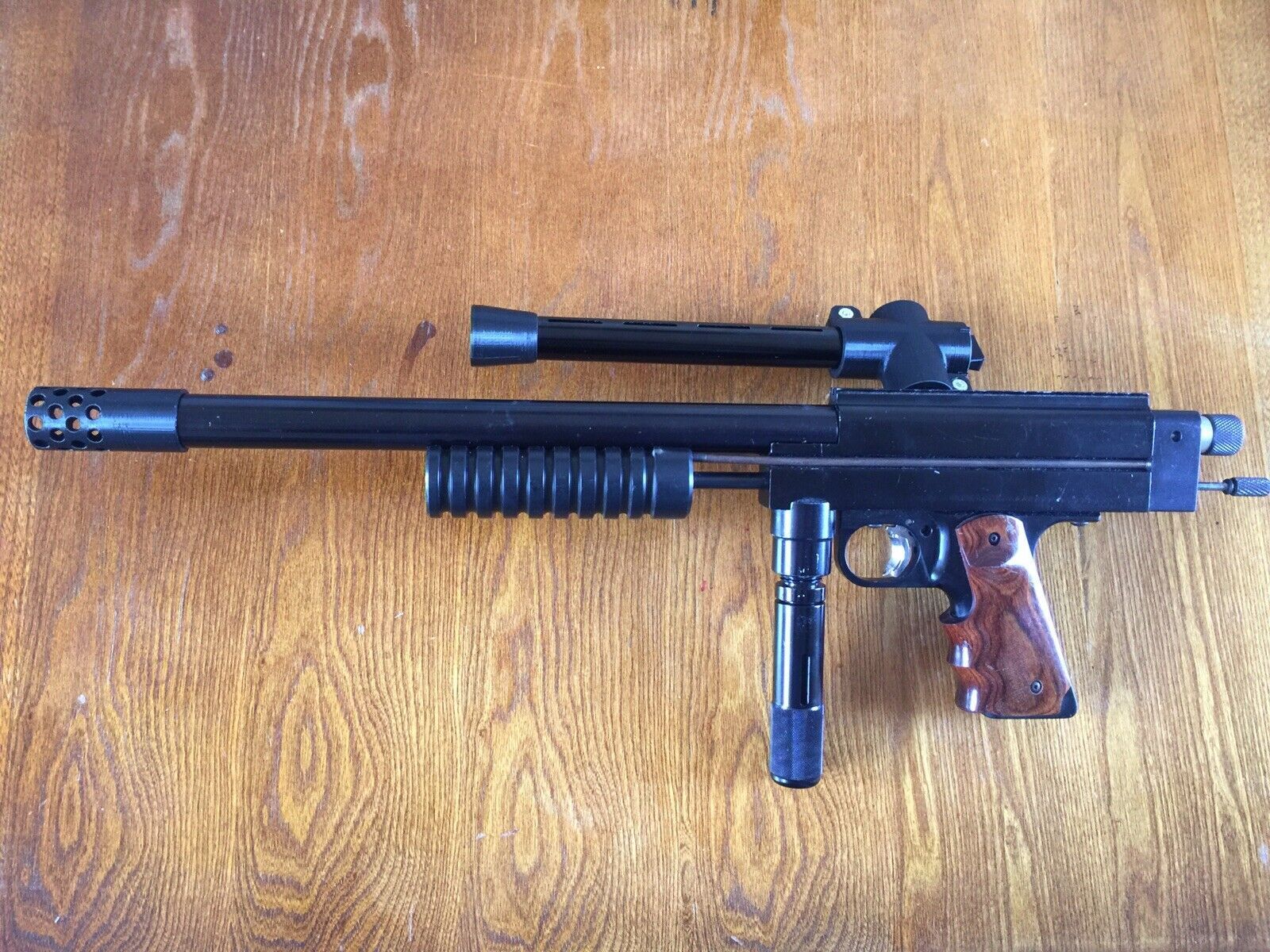

          I have done several feed neck removal on phantom and various Nelsons ...
          For phantom:
          The ones I did had the feedneck threaded into the body, then spot welded ...
          at the time, I had a very limited shop and no idea how to do it ... I would do it a bit different today
          if you plan on putting a feed back on: cut the weld and unscrew the feedneck. Clean the body and feedneck on the lathe. Ano how you want (or not, this is personal preference). And voila! Stock feed conversion.
          This will have a big hole, and the thread edge will show ...
          (I just did this to my bushmaster and love it, might post a picture of the job)
          If you have no intention of converting it back: I would cut the feedneck close to the body. Once it's rough cut, put it in the lathe and finish the cut flush to the body with the remnant of the thread in the body. Drill the body at the right spot for the feed. You can ano it as you want, but the threads remnant may not take.
          This allows you to have a smaller, clean hole for the paint, but ano may not bee clean near the opening.
          The cleanest way is to get a new body and ano it to the desired color, which may not be always possible ...
