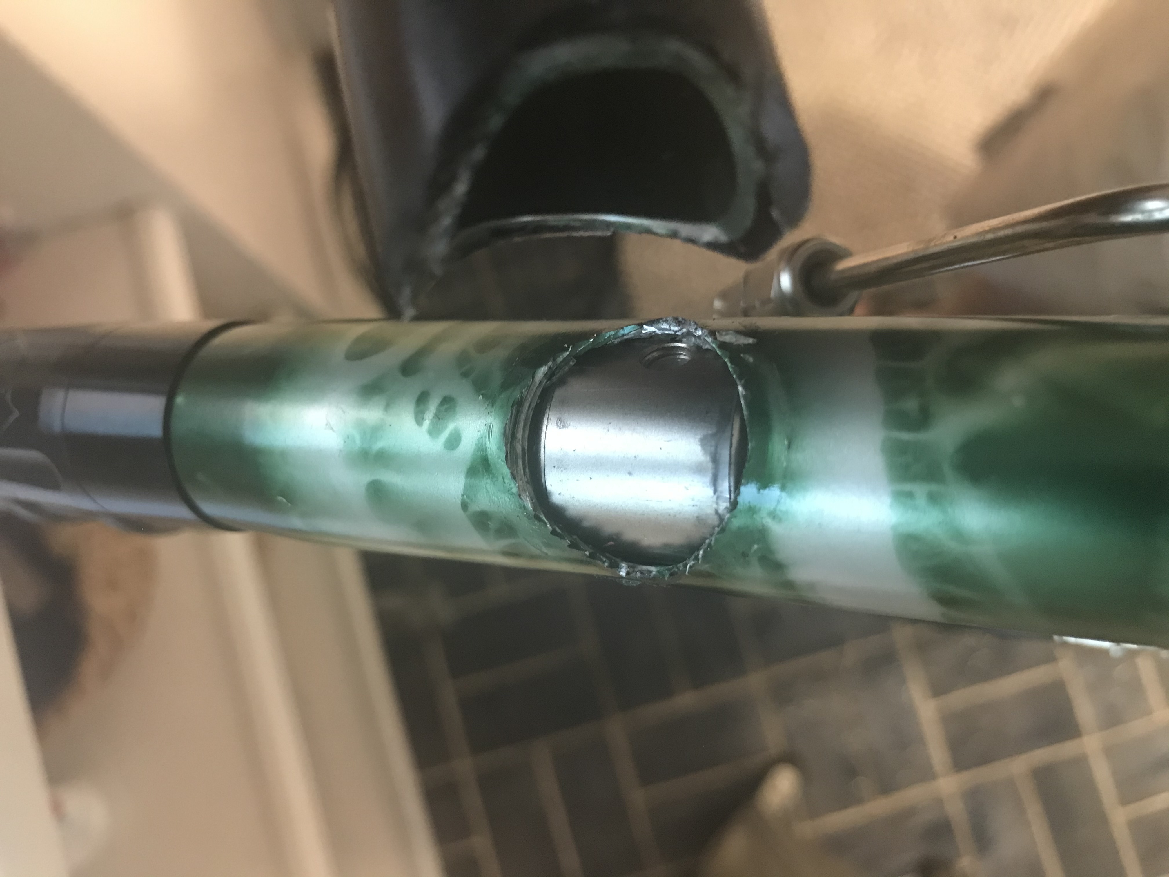

ID:	134547 Working from home today, heard a “crash” in my utility room....still in shock
    Any way to salvage this?
    Snapped the feed neck off one of my phantom bodies.

    Congrats on being the proud owner of a new single shot Phantom!
      Carp commented
      Or you could.. Drill, clean up, helicoil a nutsert in and then, you can add just about any feed you'd like to use (MAK -magfed adapter, stock-class feed, Spyder clamping direct-feedneck adapter..etc) 😁

    They weren’t milled out of a solid block of aluminum so they are attached by welding or adhesive, correct? I would assume it could be reattached. Maybe contact CCI and discuss it with them. I would hope they have the fixturing to attach it perfectly.

      It almost looks pressed on to me. Like some jig from the inside of the body flares the body into the neck.
      If thats the case it may be possible to lay that material back out, add a little green loctite for good measure, and repress that flare.

            Was that a centerfeed body with the pressed in male feed port that (from factory) had a black plastic kinda shroud around it?
            Easiest and most obvious solution besides pressing it back together (if thats what it needs) is that it would be very straight forward to add the stainless steel threaded insert to that body and turn it into a stock class body, despite having a rougher than normal feed port hole it would be identical.

              The neck and body were threaded together somehow. Most of the threads are still there, but it looks like they drilled a small hole and soldered a spot on each side to keep it from twisting. Then the black plastic ring was epoxied over the top.

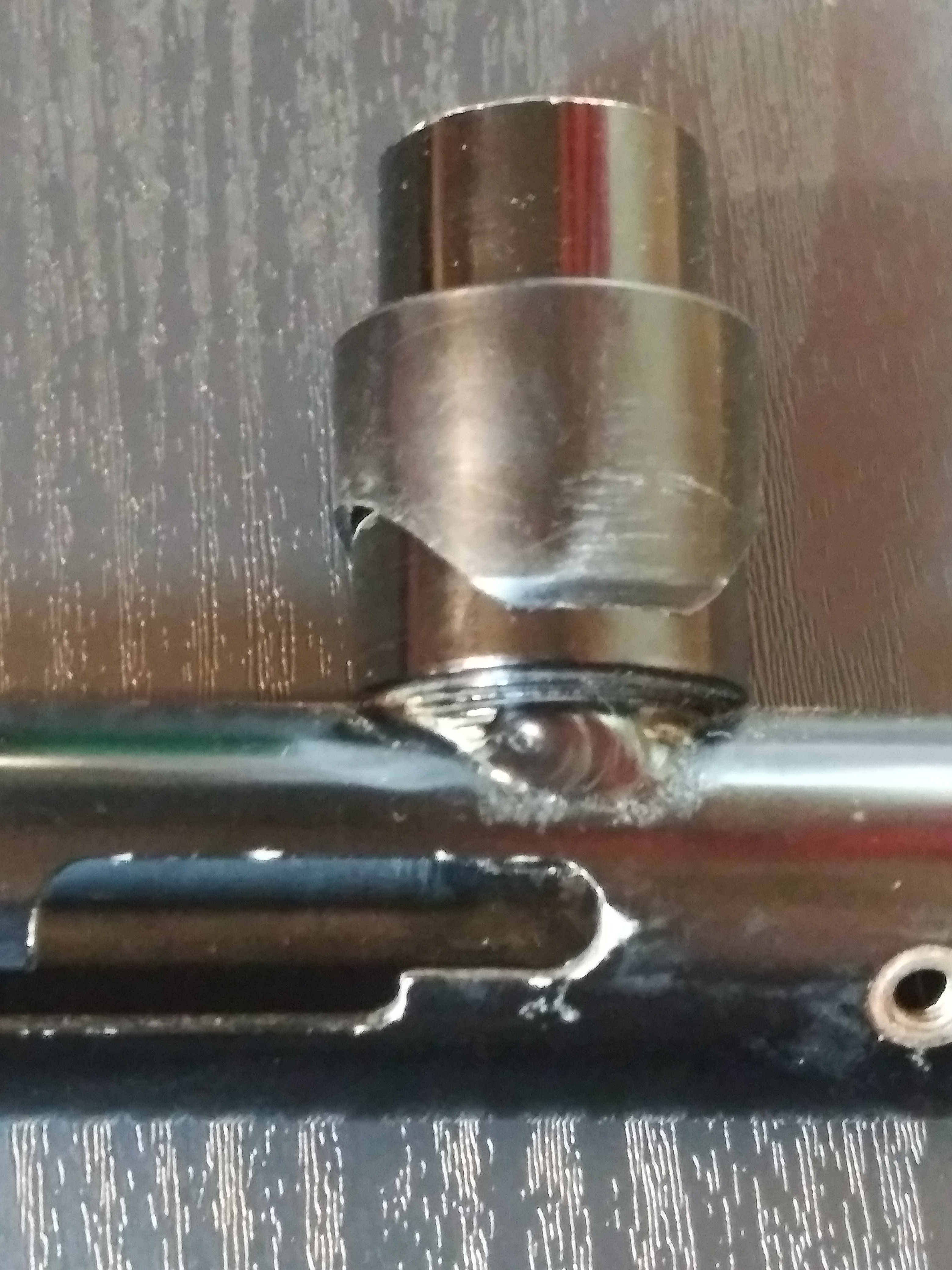

              Kind of like this but, vert/center instead of right... Right? Although my plastic cover/guard was slipfit and not apoxed.

                JeepDVLZ45 commented
                Yes, just like that

              Ouch! Would epoxy with a couple of welds make it more secure? Not sure what it would do to the ano around it though or if you could cover it with the sleeve then.

                I have a guy I work with who used to have his own machine shop....I know he’s got a couple do-dads and thing-a-ma-jigs from those days in his basement still. Hoping me wants to make some extra $$ and help me out!

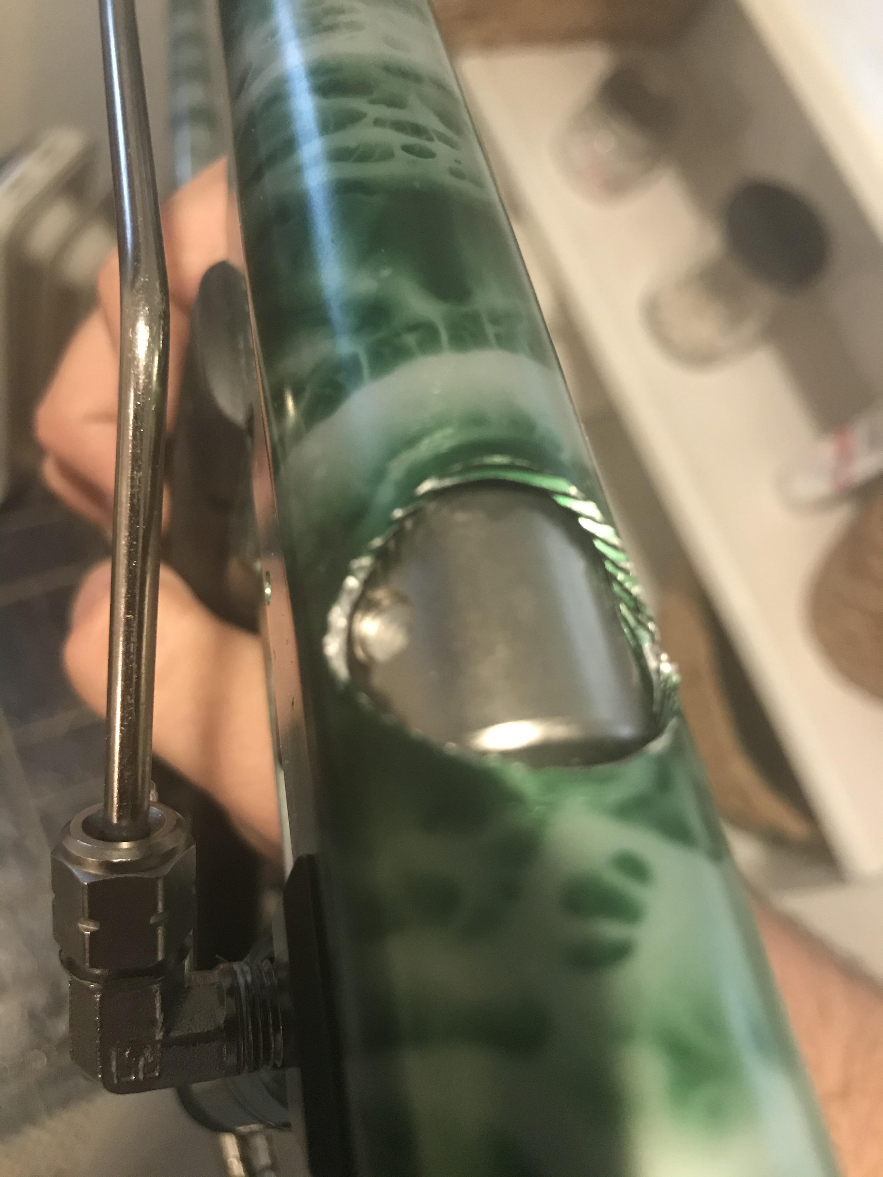

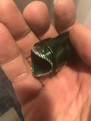

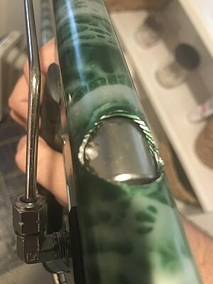

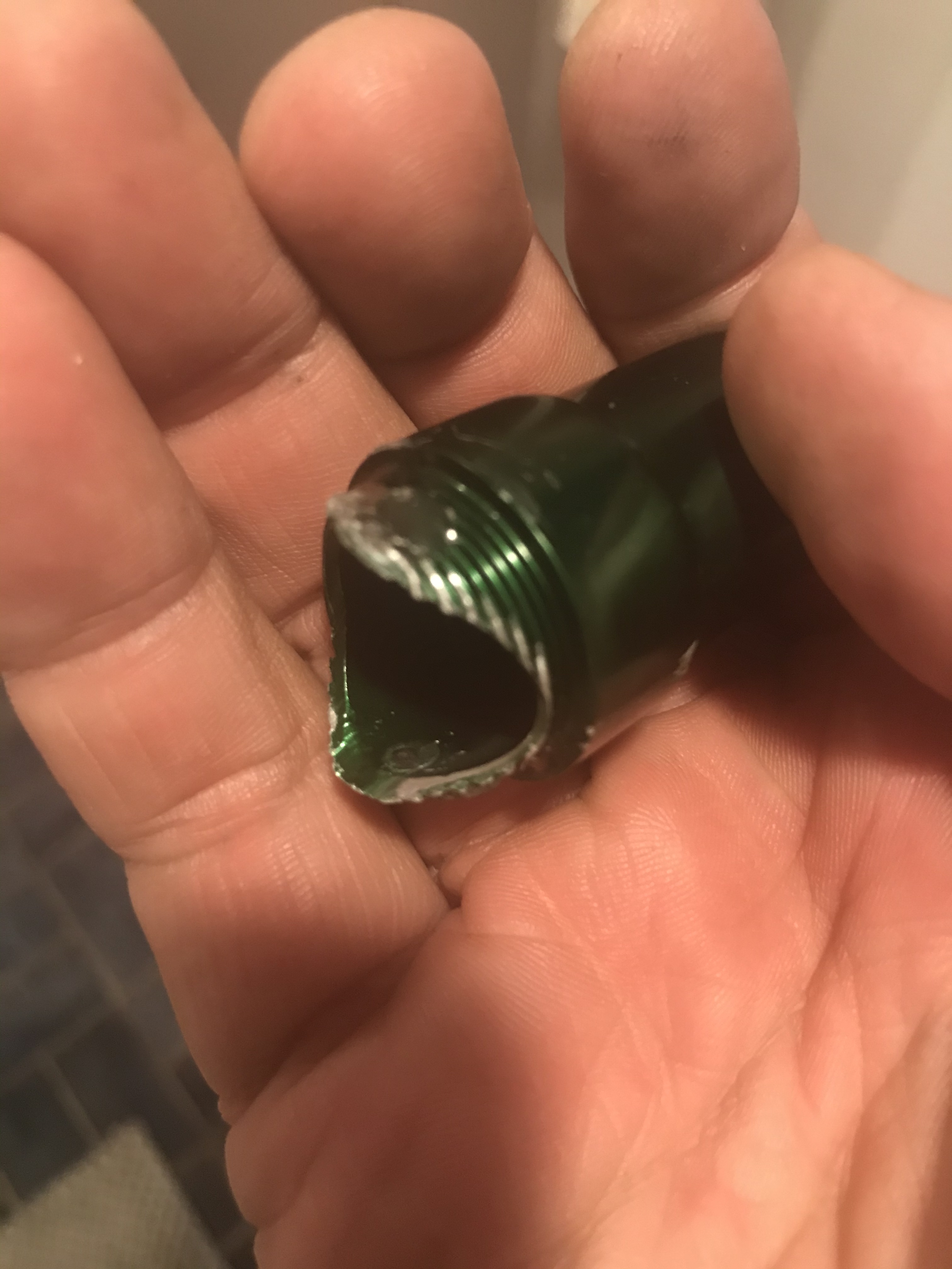

              Click image for larger version  Name:	602A16DE-E4DF-41E1-88F8-8C11A70FC53F.jpeg Views:	8 Size:	1.67 MB ID:	134671 Click image for larger version  Name:	95070B6F-338E-480E-AEB8-B3EB9CE4E562.jpeg Views:	8 Size:	2.11 MB ID:	134672
              better view
              it looks like it should be such an easy fix....

                No way of cleaning up or retracing the threading? It almost looks usable... 🤔
              • Ironnerd
                Ironnerd commented
                Dang! The stuff you see when you don't have a thread-file handy.
                Honestly, Someone at a local machine shop should have a thread file/thread chaser/die to clean up the feed neck, maybe a tap to clean the threads in the body.

              It would need to be cleaned in the area but it can be re tac welded back on. They are only tacs that hold that in place.
              • 808Jackal
                • 67
                Tap it for a thread insert and put a stock class feed on that puppy!
