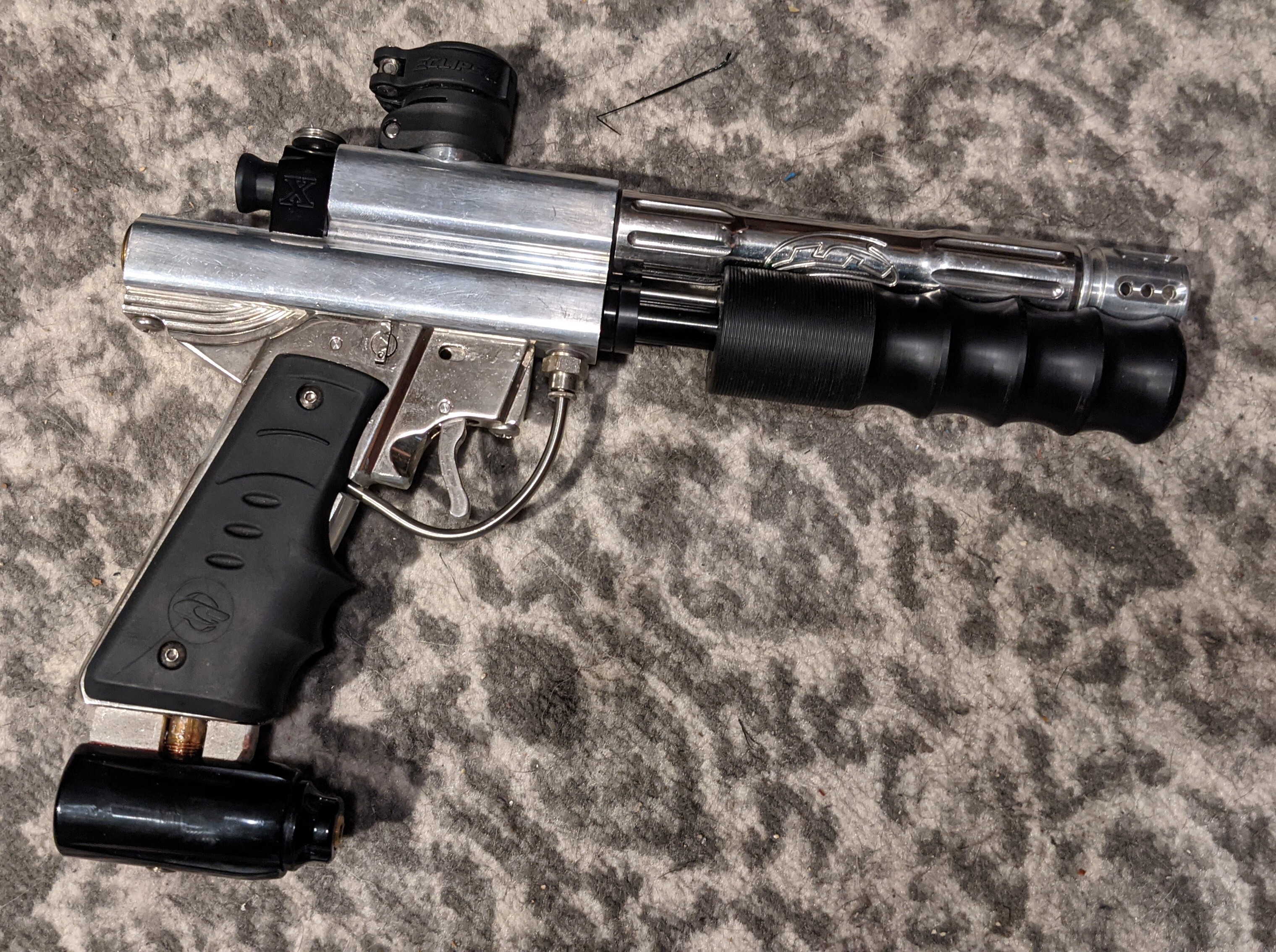

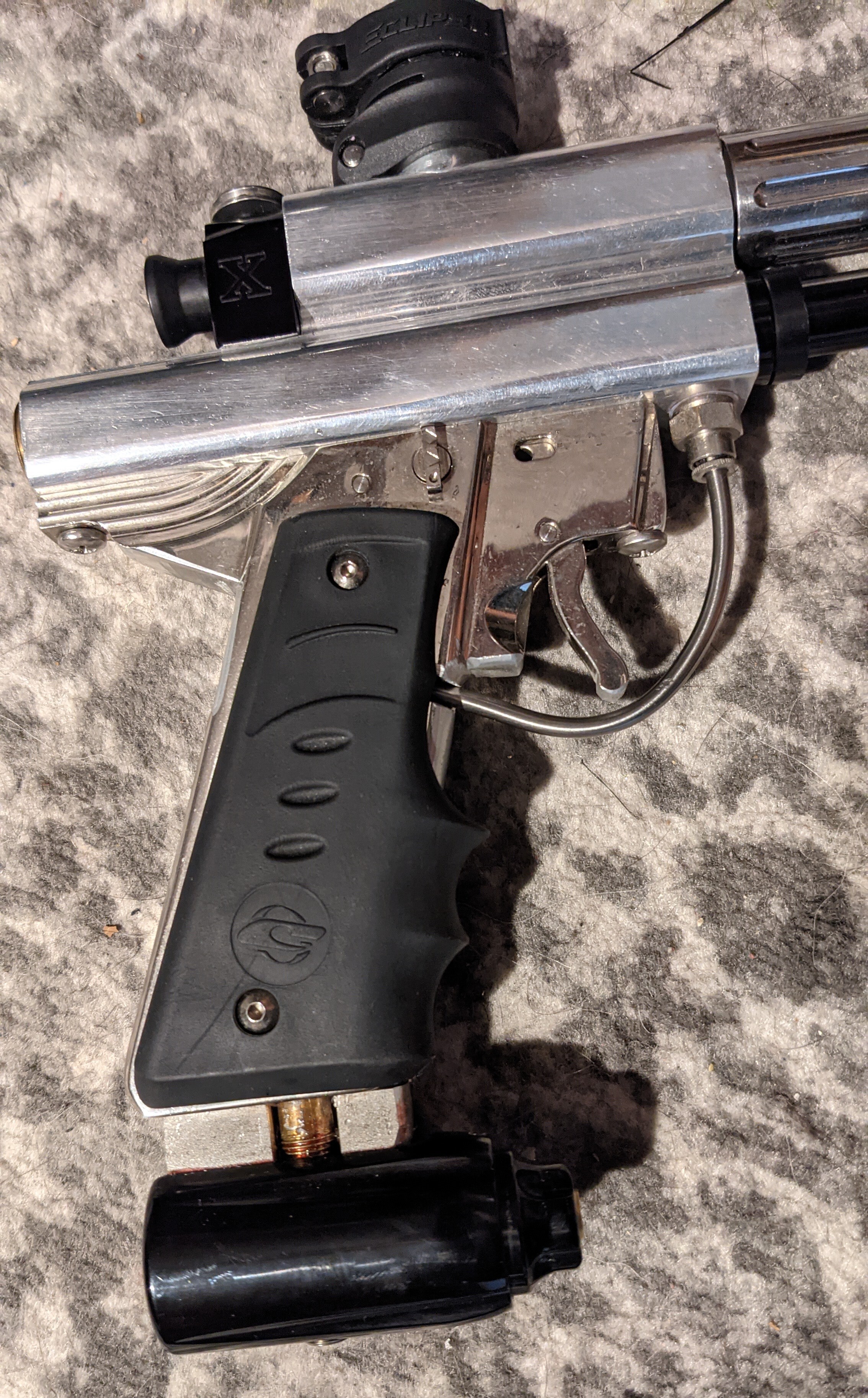

          Originally posted by Mechstar
          I now have one...and am on a Quest to GAS THROUGH ALL THINGS! LOL.
          Here is my first cocker build ... 😅
ID:	167993 Click image for larger version
          • Mechstar
            Mechstar commented
            That build is perfectly MCB…
            Beautiful and Disgusting at the same time!
            The gas line as trigger guard totally appeals to my brain because it reminds me of my first ever marker, a Tippman Pro-Am. Such a perfect way to route the gas line.
            XEMON commented
            Thanks 😊
            I wanted the smallest cocker I could make, so I started with a midget and got all the top rails off ... Then got reed of the front block.
            If I can get my pump assist kit to stop leaking it may return on it ...
