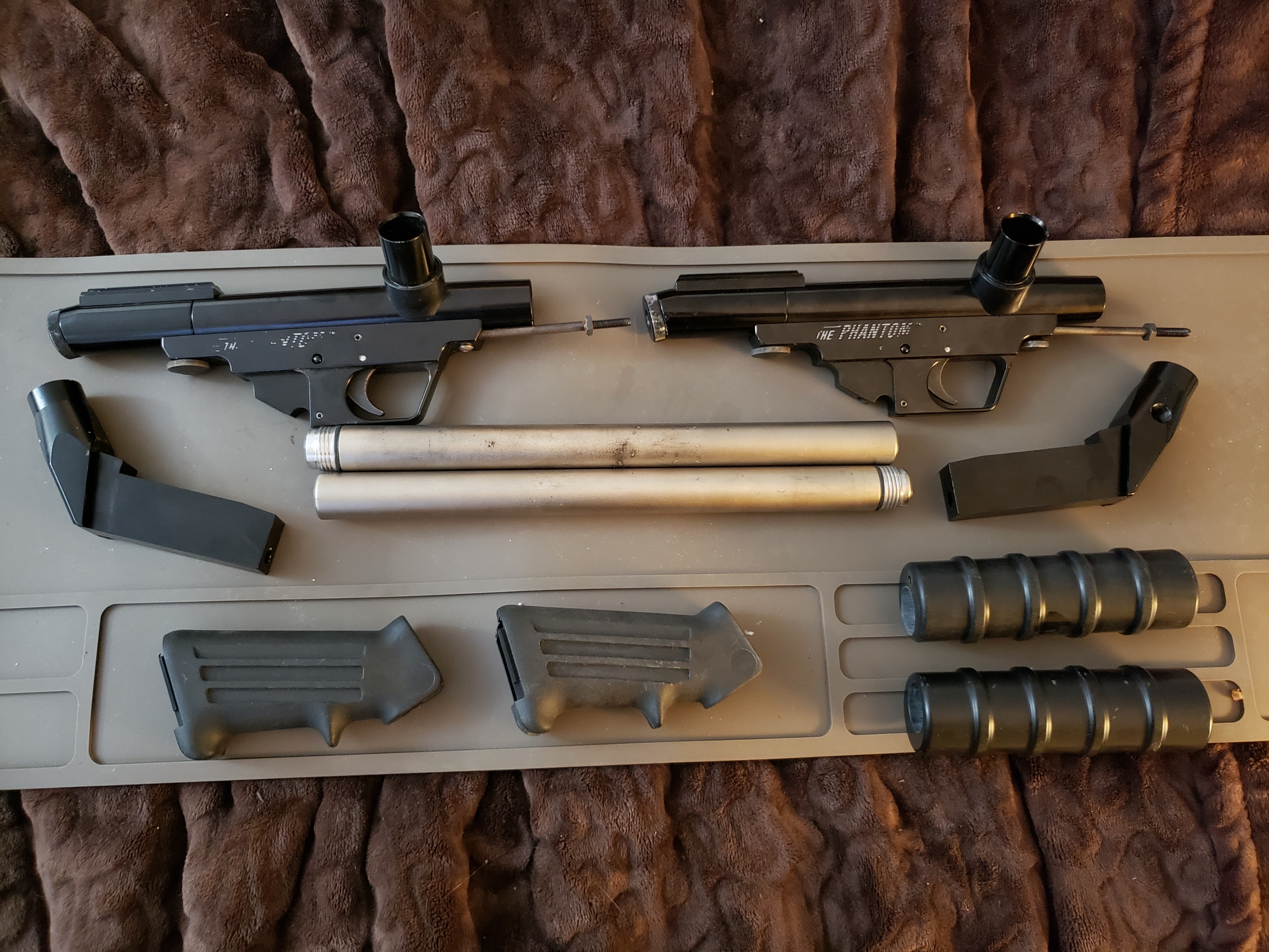

        Got them in. Very happy for what I paid. Need a deep cleaning and some new O-rings, but overall very nice.
        They do have the newer internals, which I was a nice surprise.
        Old hole-less trigger guards, ASA grip inserts, both right-feed bodies.
        One will be re-released into the wild once im done, haven't decided what im going to do with the other.

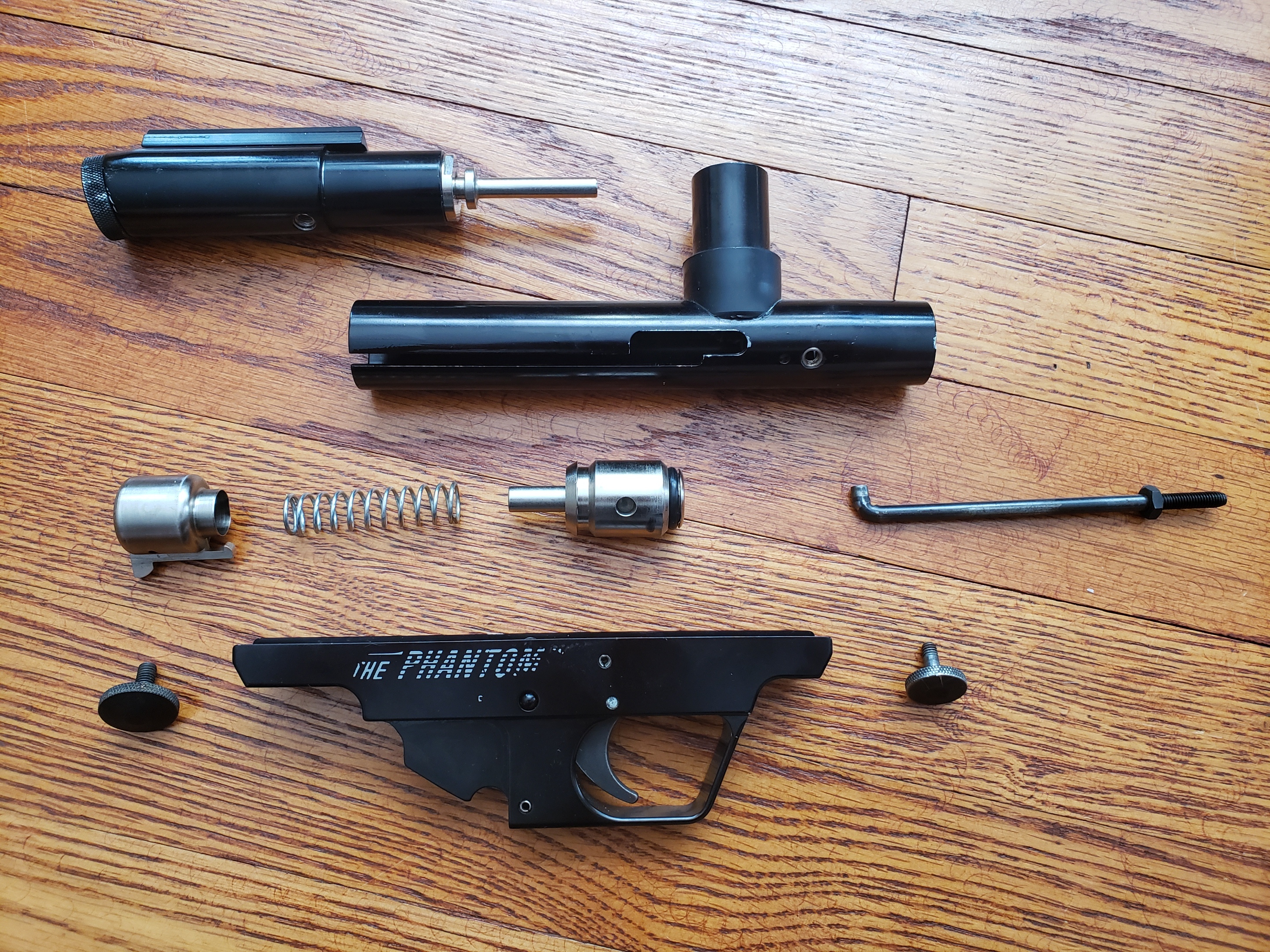

            So, some things I noticed.
            1. One had a shot nylon set screw in the bolt. Not a big deal, easy to replace.
            2. One was missing a take-down screw, will need a replacement. On that note, the remaining 3 are missing the friction o-ring on them. Again, no biggie.
            3. One had some slight rust inside on the bolt. Looked like it came from the body insert. Will need a little cleaning, but again, no issue.
            4. Noticed that both had missing pump return springs. Not sure if those were added later or not, or of both went missing at some point in their life.
            5. Both trigger guards are undrilled for a vertical adapter. I believe this was added later, but could be wrong.
            6. Takedown screws and pump rod is blued steel. My newer Phantom is stainless. Not sure when that switch was made.
            7. Looks like they have the newer, shorter power tube, but the hammer is the older profile, not the "barrel" shape like the new ones (guys on the phantom FB page told me about these 2 things).
            8. Barrels have the straight grooves in the end, but no hole drilled. The surface is interested, doesn't feel smooth and glossy like anodize, almost a little textured. Has some scuffs and black marks I can't seem to get off. But the bores looks good and smooth.
            They will both get a rebuild (springs, seals, orings), some cleaning, and some lovin. One will be released into the wild for someone else to enjoy. I dont need 3 phantoms right now lol.
              • 6380
              That Nylon setscrew just keeps the TPC from moving around on yah. People try to tighten them up with the TPC in place and they strip. Proper way to set that up is to take the TPC out turn that Teflon grub screw in so that it just barely enters the bore of the bolt. Then put the TPC in so it creates a lil resistance on the TPC. Mike added an O ring to the Newer TPC to do the same thing and prevents the need for the set screw.

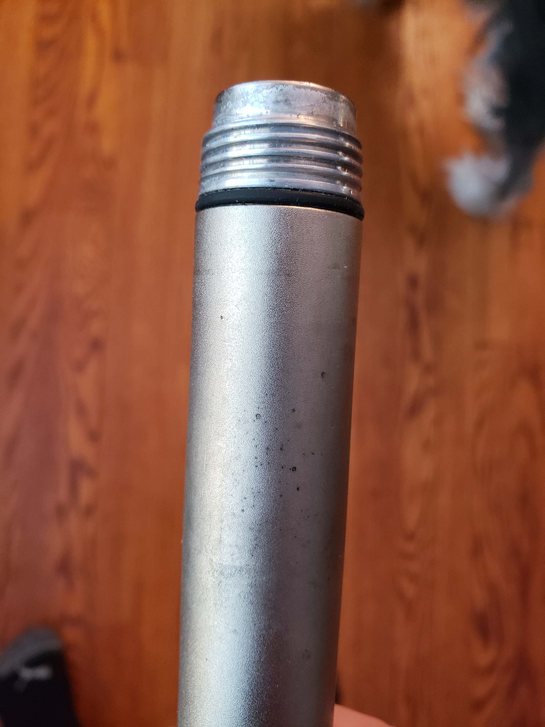

                • 4418
                Those might be the nickel plated barrels
                • BlindFaith429
                  • Oct 2021
                  • 496
                  That might explain why they feel heavier than they look, for a basic aluminum barrel. They measure 11" exact with the threads.
                  I tried scrubbing them with the scrubby side of a dish sponge (one that is safe on non-stick pans to reduce the risk of damage) and it didn't really do anything.
