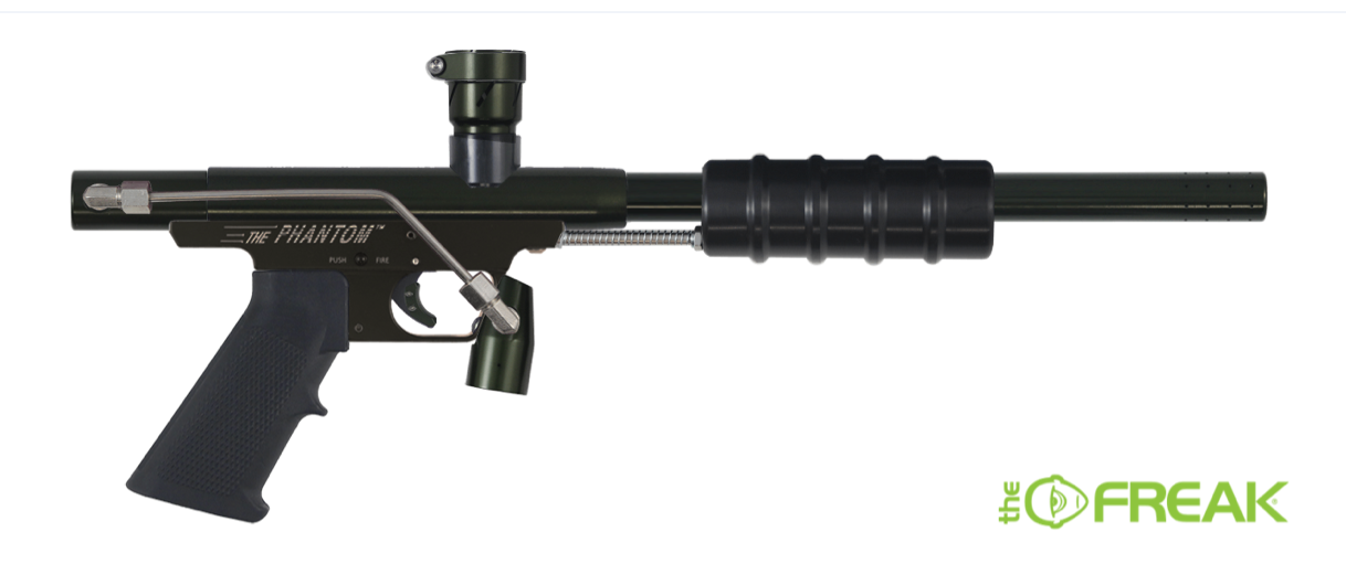

            I placed an order. Thank you once again for your feedback. This is what I went with.
            "Aren't you getting too old for this??"
            "Nope."
              Very nice, hope you love it.

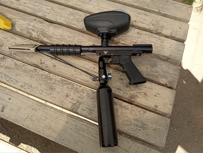

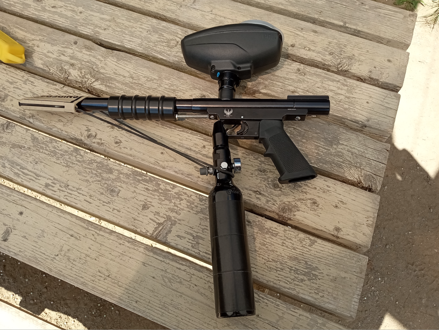

                Well, I finally got to try my new Phantom on Saturday!
                EV installed the HPA (red?) spring as per my request so it was shooting a tad hot. I was easily able to bring it down and I had a steady 280 fps average thereafter. Mine came with the ASP detent mod and I was using a SS 0.689 Freak insert (obviously I got the Freak-ready option).
                My first surprise was how quit the marker is, as I was told that HPA was louder, but also how nice the pump stroke was. I expected it to be much stiffer. Before playing the first game, I was shooting different targets to get the hang of the gun and with a little practice I was able to hit what I was aiming at. The gun was intrinsically very accurate.
                Yet, during the first few games I could not hit the wide side of a barn! It wasn't the gun's fault, it just that I really needed to get used to a radically new set-up. In one instance, I had outflanked someone who was wide open and sitting maybe less than 50 feet away... and I must have shot 5 or 6 shots and missed him; and every time I fired he didn't know he was fired upon! It was quite comical, actually.
                I told myself not to get disappointed and to play at least 4 full games before switching to another gun. I did not order a UC kit nor a .45 frame with stock to see if I could get away with a minimal configuration. My initial thought after my early games was "ok, I'm SO ordering the UC kit, the grip and stock". At the end of the day, I wanted to finish the pod of paintballs I had left and used the Phantom again. Well, this time around the more I played, the more accurate I became. I Still could not rake in the kills (which is not the point when I play pump anyways), but at least I wasn't missing my target in terms of feet, but inches and I did even get a few nice hits in.
                I may very well end up ordering more parts from EV, but for now I intend to keep playing with that configuration and give it some time. That being said, I absolutely love my Phantom. I love the tight and elegant design, and how light, nimble and quiet it is. A friend of mine plays with a SC Phantom and when he saw me getting my Phantom out of its bag at for the last few games of the day, asked me "grows on you, doesn't?" Sure does!

                  Glad you got it and gotten some trigger time to see how it works for you. Not sure what you were shooting before the Phantom but if it was stacked tube it will take a little time to get used to shooting a single tube, the point of aim is a little different. In addition Phantoms are super light even in Open Class configuration and that can affect your stability when pumping and shooting just takes a little time to adjust muscle memory. I assume you are coming from a primarily semi-automatic background and playing pump is a different mindset so again takes some time to get used to it. Play a few more times before investing heavily in additional parts. Your setup is pretty solid so give it a little time to develop new habits.
                    • 6370
                    Nice setup. If you bump your tank reg pressure up a lil bit (825-850psi) you can use the Stock Silver springs on both HPA and 12g.
                    I need something to shoulder when I shoot or I can’t hit anything. It takes a lil time to get use to how they aim. They point a lil different. I notice I shoot high a few games when I switche back to my Cocker pumps.
                    But take the leftover paint and target practice with it a lil bit till you get the feel for them.
