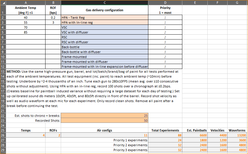

                      Sounds like someone is going to have to do some science to demonstrate the differences between CO2 and HPA. In my experience, I don't actually pay attention to sound signatures since I hear them both just fine, but it wouldn't surprise me if CO2 is quieter due to the progressive expansion. Consistency, though... Testing that is challenging since CO2 is sensitive to the gas delivery configuration; VSC, back-bottle, with or without expansion chamber, with or without in-line filter/diffuser, thermal changes due to CO2 phase changes induced by high rate of fire.... ugh. CO2 is so much more finicky. This is why I complain about CO2. I don't care if there's a needle to thread where it improves sound signature when I know it's going to be less consistent as the day goes on due to ROF and environmental temperature differences. For science, though... here's a simple DOE I'll put out into the world and hope someone follows through on..haha

                        I think before anyone does that it would be a good idea to survey what HPA setups people have. HPA is more stable than CO2 for use in a paintball gun. That’s so not in question that it’s pointless to prove or even mention. The issue is that Phantoms, configured as they are amongst the userbase, seem to like CO2 better. The Phantom, or the Phantoms that exist, are the problem.

                          That's really all there is to it. People have biases and preferences. There isn't a snowballs chance in hell that CO2 shoots more consistently than well-regulated HPA; its pressure is stable while CO2 pressure is chaotic. That's really where I stop thinking about it because there's nothing more important to consider. But if people want to claim otherwise the least I can do is setup the DOE to prove it right or wrong.
