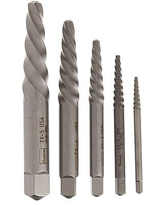

          Ez out and heat. Then replace them with new and red lock them in after Ano.

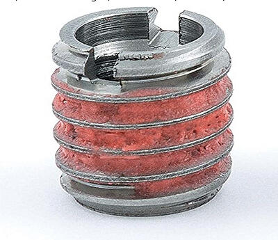

            Any idea on what size helicoils they are?
              They’re actually more of a threaded insert. I would order new ones from Xtreme. Shoot them an email I’m sure they would be happy to help you out with what you need.
              I’m not sure the size easy out a set is like $11 on Amazon I would just grab a set and find one that fits. Heat and twist them out.

            The insert kind of looks like this but small it’s not a helicoial like you would use on stripped out threads.

              Airsoldier.com has them, too. 1/4-36 threads on the OD, IIRC, and machined from stainless bar.
                you can buy them directly from Phantomonline.com, Look under Phantom - Breeches. give them a call if you are not sure how to install it.
