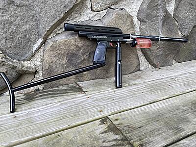

    Starting lite with 2X 12g
    • latches109
      Always Sciencing
      • 2113
      #35
      The Walker 2.0
      • peter2
        peter2 commented
        so there's no hardline on this 2.0 setups? Thx!

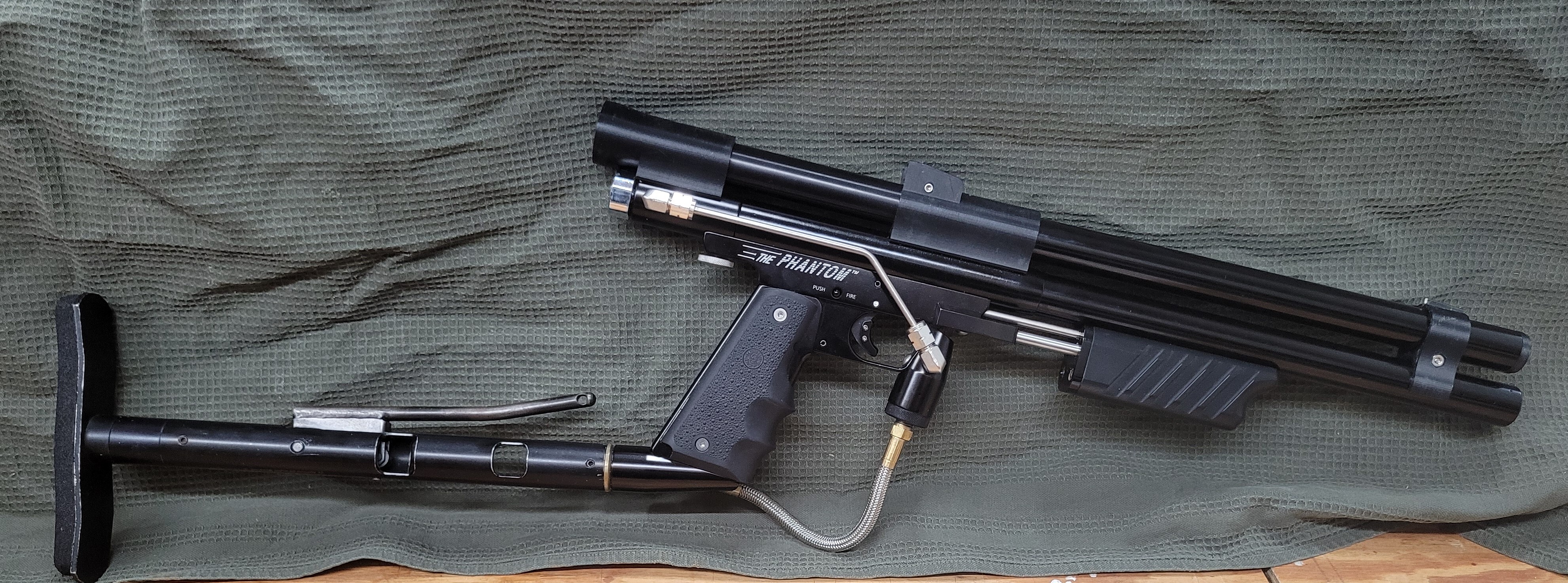

ID:	398537 Here is my spring-fed Phantom currently without its gas-through grip to meet my last modified stock game but still can prime with one cartridge then slap in the 2nd.

          Chuck E Ducky has it right the check valve is in the Micro CA II. Mine was missing so I just made one with a flat head screw and a spring out of a ball point pen. It does not provide a perfect seal but enough to quickly cycle in a CO2 cartridge. Some day I will make a better check valve but this is working well enough. I have been thinking about in the future changing over to an on/off like the ID EZ-on/off so I would get the benefit of being able to bleed down at the end of the day. Right now I have to shoot it down or crack the seal between the stock and the ASA to fully degas.
          You could prime with a CO2 or HPA bottle you would just need a dummy CO2 cartridge connected to an ASA that you could slap into the stock. I literally have hundreds of CO2 cartridges (I was buying bulk whenever sales happened, whether I needed them or not) and I really do not play stock class all that often. Downside of my move back south definitely less of a stock class area down here compared with I was up in MA.
          After seeing your image with the expansion chamber mounted I started thinking that would be better then my gas-thru grip if I can find a small one
          I'll have to pull off my ICD lever changer of my Duckslide and tear it down to see if I can make an easy DIY check valve for it. Wouldn't use it on the Duckslide that is my dedicated stock class marker but now I am curious. There appears to be less space in the ICD lever changer then in the Micro CA II between the piercer and the ASA body to put a check valve and you have to have a way to retain it which is built into the Micro CA II.

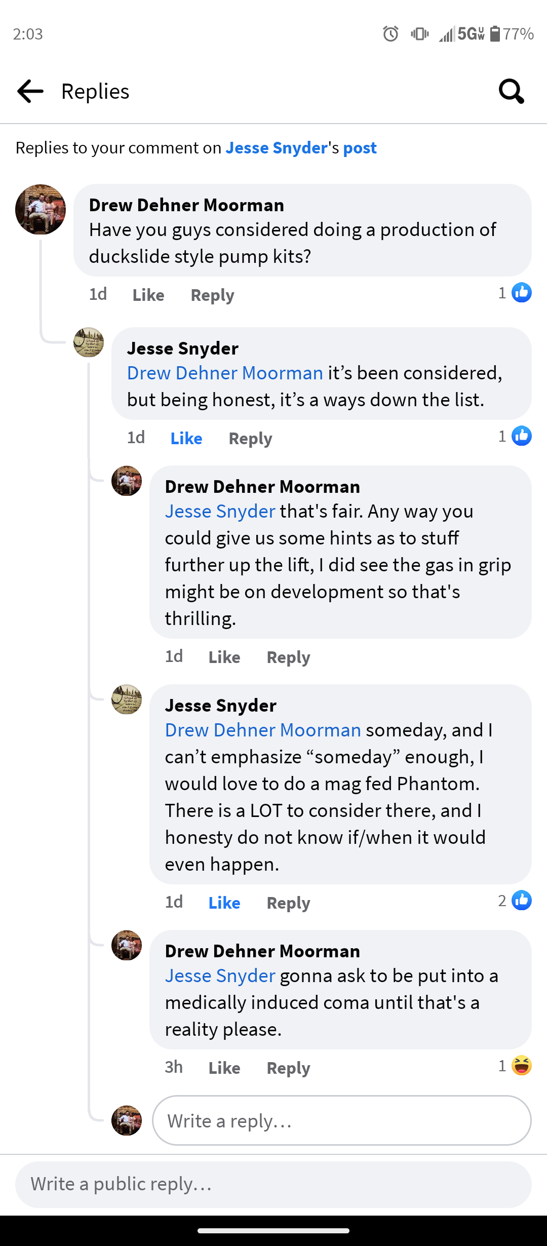

        For those not on fbook, seems like all our dreams are being considered at the least.
        Collection
        GITM based out of Warzone RI

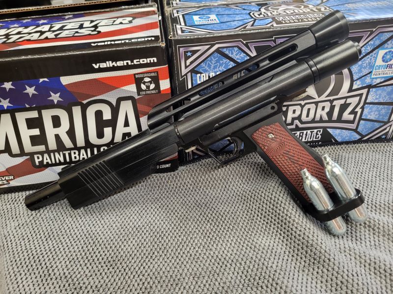

            Yup, maybe not the most practical, in the most utilitarian sense of practical, but it works, sends little round things down range to eliminate opponents and looks pretty. I will most likely not (though never say never) downsize the Duckslide. It takes up so little space in my bag that it goes with me just on the off chance I get to play some stock class games with some like minded individuals. It is eventually going to be modified like BLachance75's with milling down the top rail to mount the feed more traditionally. They are playable in the stock for but a reciprocating feed takes some getting used to and I still screw it up occasionally (guess I need to play more).
            Click image for larger version  Name:	Duckslide_Small.jpg Views:	0 Size:	156.2 KB ID:	399131
