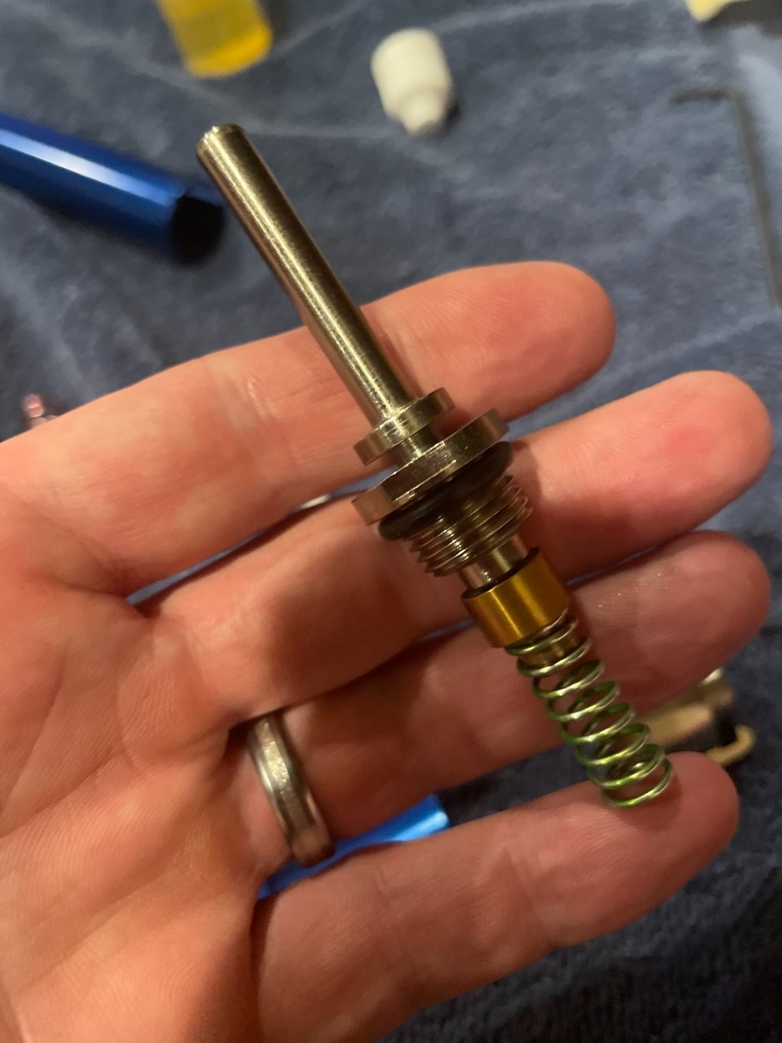

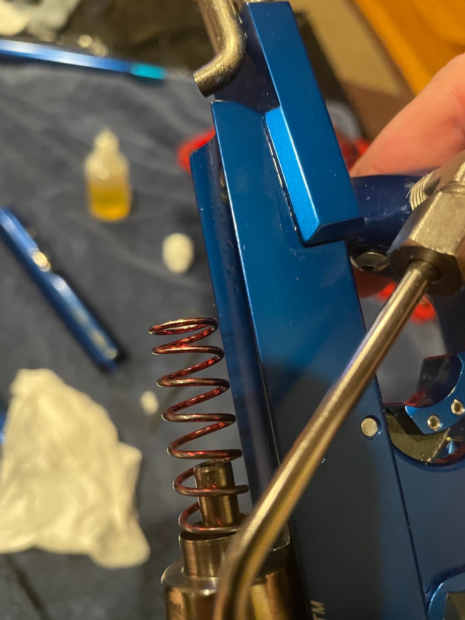

    Ok I'm adding my gun to this set of discussions "For Science"
    Background: I purchased a new EV Phantom which I got delivered beginning of August. I have played several games with this marker including an OSG stock day, Riot's pistol game, a pickup at Xtreme, and the whole weekend of Stocktoberfest. This gun was in multiple configurations (bottom line, long barrels, short barrels, different feeds etc). Everything worked fine, consistent over the chrono ~270s and a decent amount of usable shots out of leland 12gs (~30, I run a 15 round tube most of the time). I had NONE of the issues people are complaining about. After Stocktoberfest I decided it finally needed a cleaning.
    I opened it up and to my surprise it shipped from the factory with a red hammer spring. Intrigued by this I opened the valve to see what color spring was in there... Green. I thought to myself maybe this is the secret to fixing some of these EV Phantom issues... I should tell everyone... UNTIL I chronoed it this AM... Starts 280, shoots down about 10 FPS every shot, gets about 10 rounds to a 12ie until it starts shooting under 200 and leaking down the barrel on the backstroke. I don't know what changed. This is the same parts that were in it before I cleaned it and oiled it like every other Phantom I cleaned and oiled last night (all old CCI and NOT having any issues now).
    I will now start swapping parts and see if I can figure this one out. Stay tuned...
    First plan is to try it on HPA and see if it is a CO2 only issue
    Then I'll try original CCI parts, powertube, springs etc.
    Click image for larger version  Name:	signal-2023-09-26-093616.jpg Views:	0 Size:	100.0 KB ID:	453083 Click image for larger version  Name:	signal-2023-09-26-093612.jpg Views:	0 Size:	417.4 KB ID:	453084 Click image for larger version  Name:	signal-2023-09-26-093622.jpg Views:	0 Size:	303.8 KB ID:	453085 Click image for larger version  Name:	signal-2023-09-26-093632.jpg Views:	0 Size:	363.5 KB ID:	453086

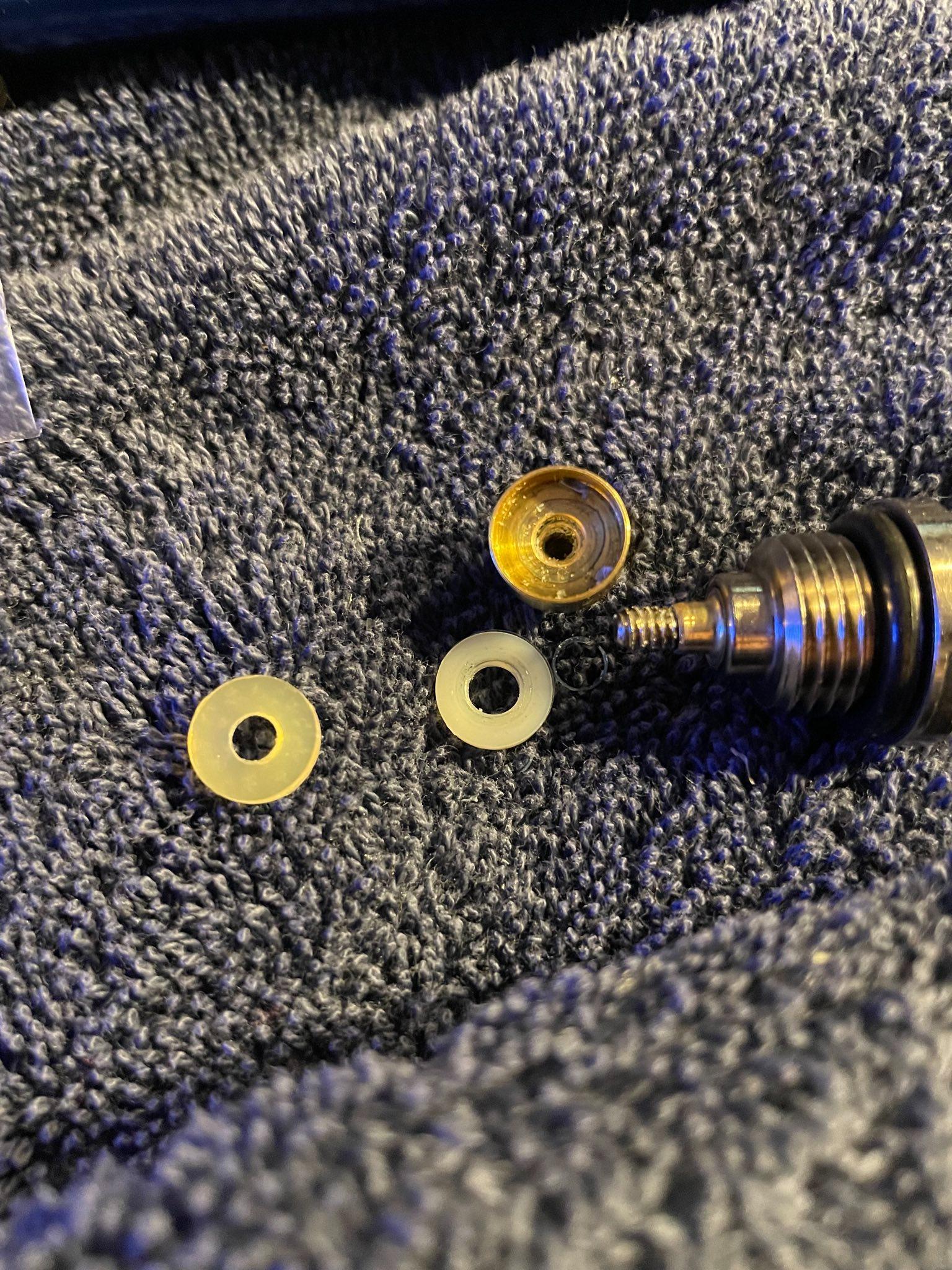

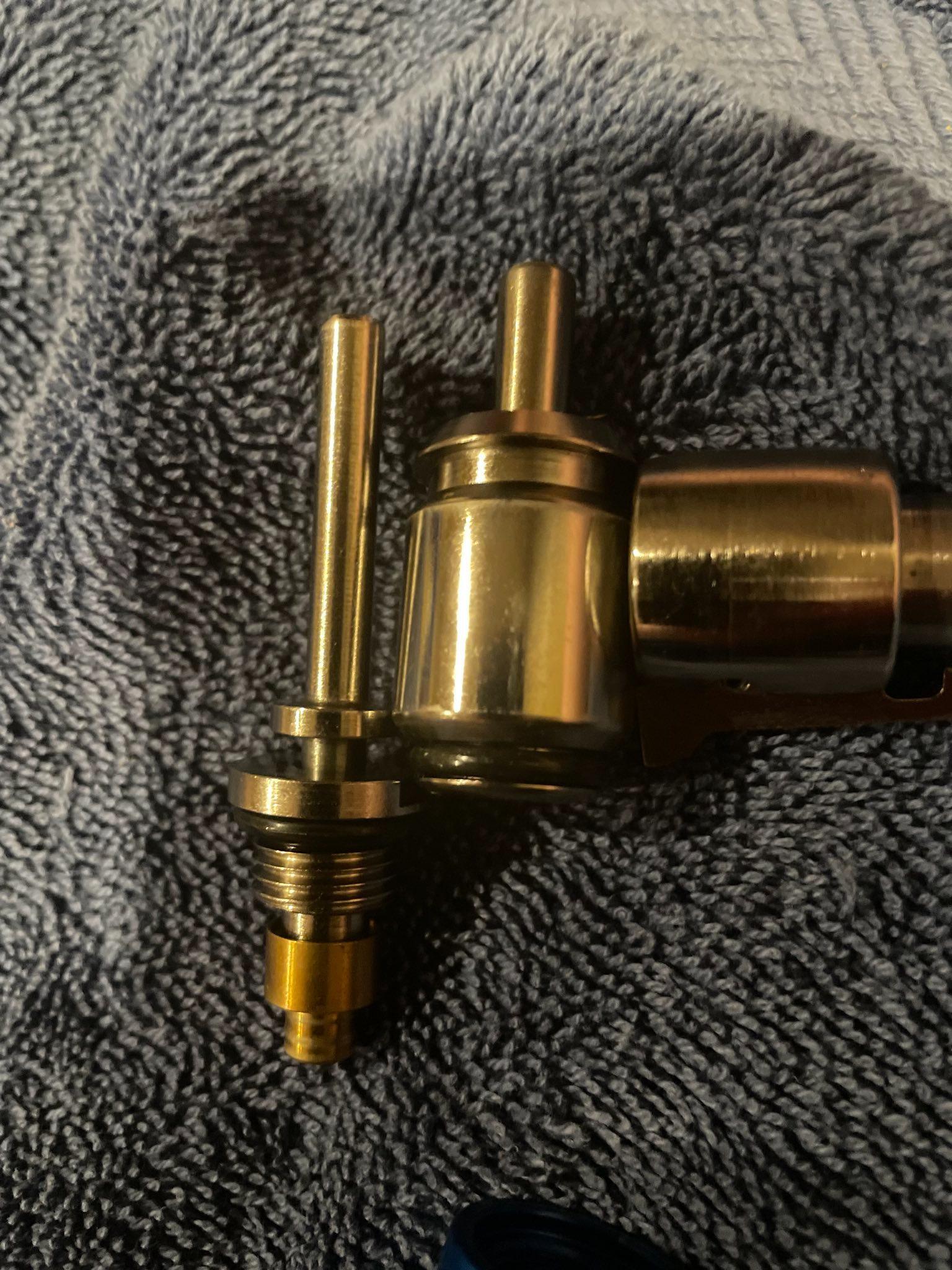

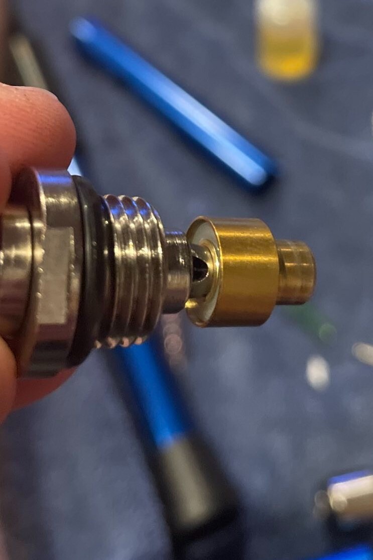

              Update: TLDR this is very likely the cup seal as others have suggested...
              I replaced the cup seal with a "very" old Phantom cup seal that was definitely CCI vintage. It came in the box with my original Phantom that I got from them early 2000s in the extra seal kit. The photo below shows the EV cup seal on the right and the old CCI seal on the left before I installed it. Oddly enough this EV seal looks a little different than the problematic ones people have been posting.
              Installed new cup seal. Nothing else changed or touched. Shot 30 rounds with HPA still same results (everything clustered around 300fps no drop off or misbehavior). Then I switched it to CO2 and ran ~90 rounds through it, counting about 10 seconds in between each, all consistent around ~270 at the beginning of the string and dropping off normally as the 12g ran out. Got ~30 usable shots out of each 12g and when the gun behaved like it was empty, it was in fact empty. I'll abuse it some more but it seems "better". Now I'll probably try a normal spring combination and see what happens...
