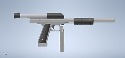

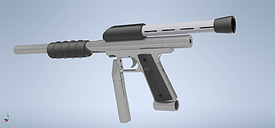

    This frame is intended to address three things I don't like about the Phantom.
    1. The EV Phantom 2.0 frame is giving people problems, but hoses aren't cool anymore.
    2. The .45 frame never felt like it "fit" quite right in the web of my hand.
    3. Anyone else notice 1911 spec grip panel screws don't line up quite right?

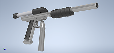

    This frame will allow gas from either a bottomline or a VASA to the valve body, inside the grip frame. To do that, the body slot needs to be notched wider and a special but simple modification needs to be done to the valve body (bobbed or standard), both hidden inside the frame lines. However, you can then field-strip the gun without special tools, taking off grip panels to access internal macro fittings, or any of that - it's just a single face seal o-ring from the frame to the valve body with plenty of diameter for the gas. The VASA will clear a standard thumb screw. I'm debating whether to make the front end match a standard Phantom frame, so you can all use the standard U/C kits. (I'm leaning heavily towards yes.) The ASA uses standard 3/4" spacing, but the holes are pretty far forward, which keeps the CCI stocks and bottomlines from fitting as the "heel" will interfere. CP ASAs fit, and are easily modded to provide the gas through.
    So the question is, at a price point similar to or less than EV's 2.0 frame kit, and available in raw or black, how much interest is there? Do these features check all the boxes, or am I leaving out something super-important? I'm hoping for $150-175 for the frames (the VASA features increase the cost but could be done with a jig after the fact, too), $40 for a bottomline, and $50 for a VASA. I would absolutely open-source the prints to modify valves and bodies for gas-through, or offer pre-made valves and mill the bodies for a small fee.
    If there's interest, I'll finalize prints and quotes (I'm far better at the design and documentation than CNC programming, so I'm outsourcing that part) and get this show on the road.

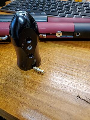

        I'm planning two routes. One would be a modification - light machining on the existing body and valve, so people with nice ano can keep it. The second path, I'd buy some bodies and preemptively modify them, and make a batch of bobbed valve bodies. Just supply the internals and pump kit.

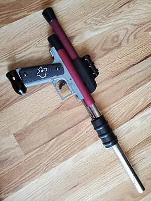

      Actual 1911 grips don’t really fit a Phantom unless they are rubber. For me that’s fine. They don’t take the right screws either. I just modified a CCI aluminum handle and my hardwood grips to fit each other.

          I jammed a 32 degrees rebel frame on my phantom and have never once looked back. It's light, comfy as all hell, makes me feel like I'm a gun slinger from an old spaghetti western, and best of all cost close to nothing. I can add a bottom line if I choose to, also off a rebel, but I strongly dislike open class phantoms in the first place. Phantoms feel the best with a 12 gram and a feed tube. If I want a hopper and a tank, I feel like their are other platforms that are much better suited for that.
