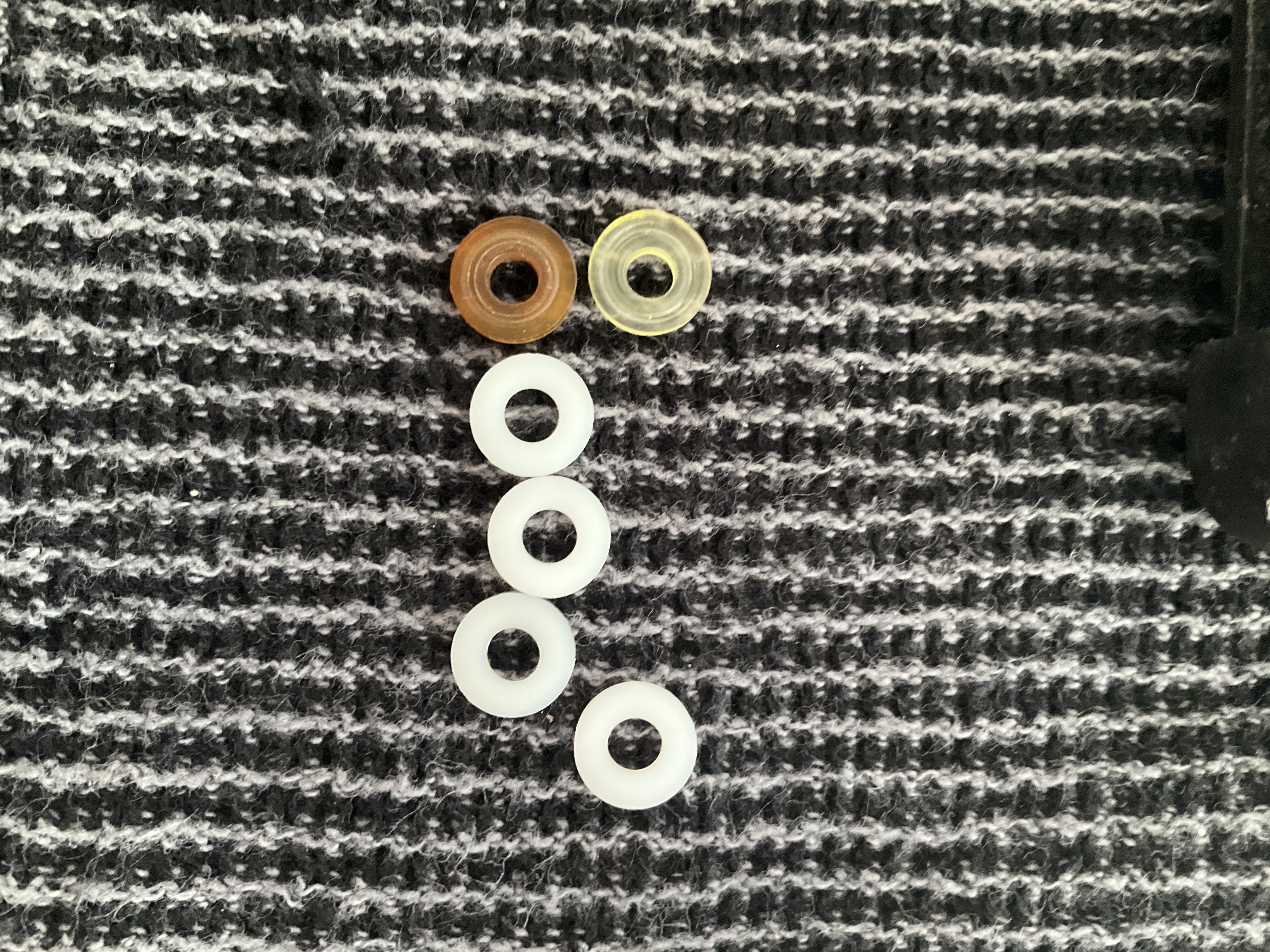

    Does anyone have an CCI-era cup seals they’d be willing to part with? I have now ordered 2 batches from EV, and I’m not impressed one bit.
    The first time I ordered them, the seals kept sticking and coming unseated. I’m told there was a bad batch of them that made it out right around the time EV took over. Fine, whatever. Mistakes happen. I ordred another batch of 5 cup seals and they arrived last week or the week before. Today I finally got around to replacing the bad cup seal I had. Immediately I saw they are not the same. They are a solid white color, thicker, and don’t fit as snuggly into the brass cup as the old ones do. I figured I’d gas it up and try anyway. Leaks down the barrel. Took a different phantom, not having any issues, and swapped the cup seal. Leaked down the barrel. Tried 2 other cup seals out of the package I ordered. All of them cause leaking down the barrel.
    I have sent a message to EV hoping to get this resolved. Anyone else having trouble getting seals that fit right?
    Last edited by StockMike; 08-13-2024, 03:38 PM. Reason: Here is a picture of the older ones that are faulty. And the new white ones. They also have

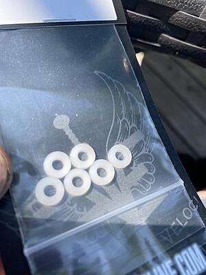

    It seems I had a hand punched nylon seal. They now have new seals which aren't:
Name:	Screenshot 2025-06-29 at 10.30.45 AM.png
    FYI, EV offered me to send me a set for free.

          Well Jesse at EV responded to me, very quickly to his credit. His answer, however, seems pretty bogus to me.
          “We've moved to a harder material cup seal which works the same and even better than the old ones, as it is less likely to grow from CO2 use. They're also no longer directional like the previous cup seals.”
          I thought the old cup seals were very omnidirectional…. Several times I have just flipped one over if it had become worn or torn or anything.
          I continuing to state my case and belief that this design of seal is bad news, I hope it can get corrected to everyone’s benefit.

            Just punch your own seats, buy some sheet urethane and a cheap set of gasket punches and go to town. Honestly I never was a fan of Mikes cup seals the work but I change out cup seals on phantoms more often then I have my other Nelson clones even when I was getting stuff from CCI.

              Really? I very rarely have to change one. All the issues I see now come from EV. I get 10+ years of hard use out of the older cup seals if they leak I flip them and get 10 more. My Phantom gets used a lot it gets lubed with outlast and I use food grade 12g but when it gets cold I use HPA on it. I don’t think I ever replaced a cup seal on my Phantom. I bet it’s got more field time than the average baller. It’s my most reliable setup hands down.
              Even the older phantoms that get abused rarely need cup seals. 90% of the time you can just flip them. If they even have an issue. I have cleaned some abused phantoms up it’s rare for them to need seals.
              The issue with EV seals are they are to soft and are griping the sealing surface. The harder ones don’t seal as well.
              We do have a member working on new seals I haven’t tested them yet. But he’s showing good results.
              Also a Spyder cup seal will work in a pinch. You can lap them with fine wet sandpaper on a flat surface to re seat them off needed.
              Vito was selling some older aftermarket ones that looked nice at Slims he said they work great in a bunch of different Nelson markers. I might grab a few this year to try.
              I wonder if it would be worthwhile making a new brass cup that held a oring like CCM’s cup seal. They use a 90 duro black bunna and I cycle 12g through mine all the time no issues with super light CCM springs.
              I just don’t want to mess up my amazing efficiency I get on my Phantom so it’s got to sit the same as the original.
