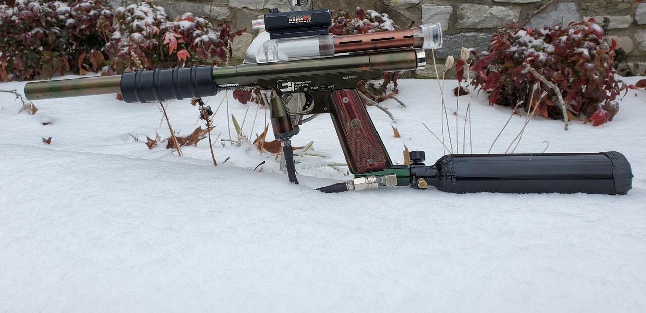

    I know very little about this lil guy I picked up in a big lot of gear. Is there an ASA (or better, an ON/OFF) option that levels out the tank angle to match the barrel, rather than being at a slight decline? I discovered the CCM frames that are perfectly flat on the bottom, but turns out finding one of those is difficult/expensive. Thanks!

    Your bigger challenge may be to find an ASA that doesn't mount at an UPwards angle because of the design of the bottom of the CCI .45 grip blocks. ASP/Airsoldier used to make mounting wedges with integrated rails that corrected the upward sweep of these .45 blocks but they may be out of production now.

                      Pull the CCI/EV bottom line and replace it with a Duckbill ASA and it will get you closer to level:

                      I never was a fan of CCI's bottom line even though I own a few. I do not like the large drop in angle it feels more awkward to hold then a less angled bottom line.
                      There are all sorts of AR to 1911 grip blocks out there and some are flat bottomed that is what is essentially used on a Phantom.

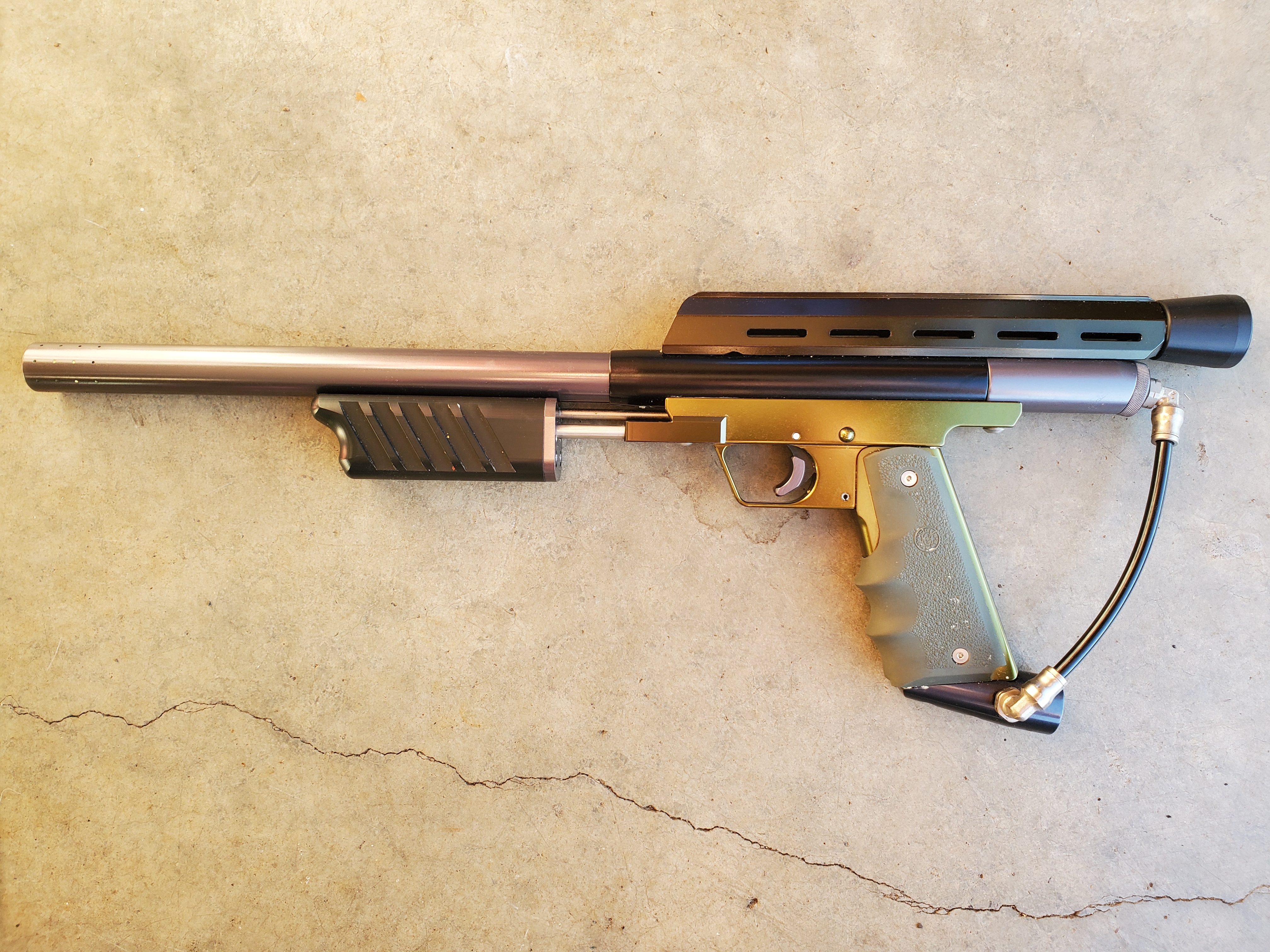

                        If you don't have the scratch to completely replace the grip block you can look around for an adapter that yields the angle you want.
                        I ended up using an old ACI bottomline adapter with mine, though I had to carve off a little material with my dremel to get it to sit just right.

                          Depends of the 45 block on the Phantom.
