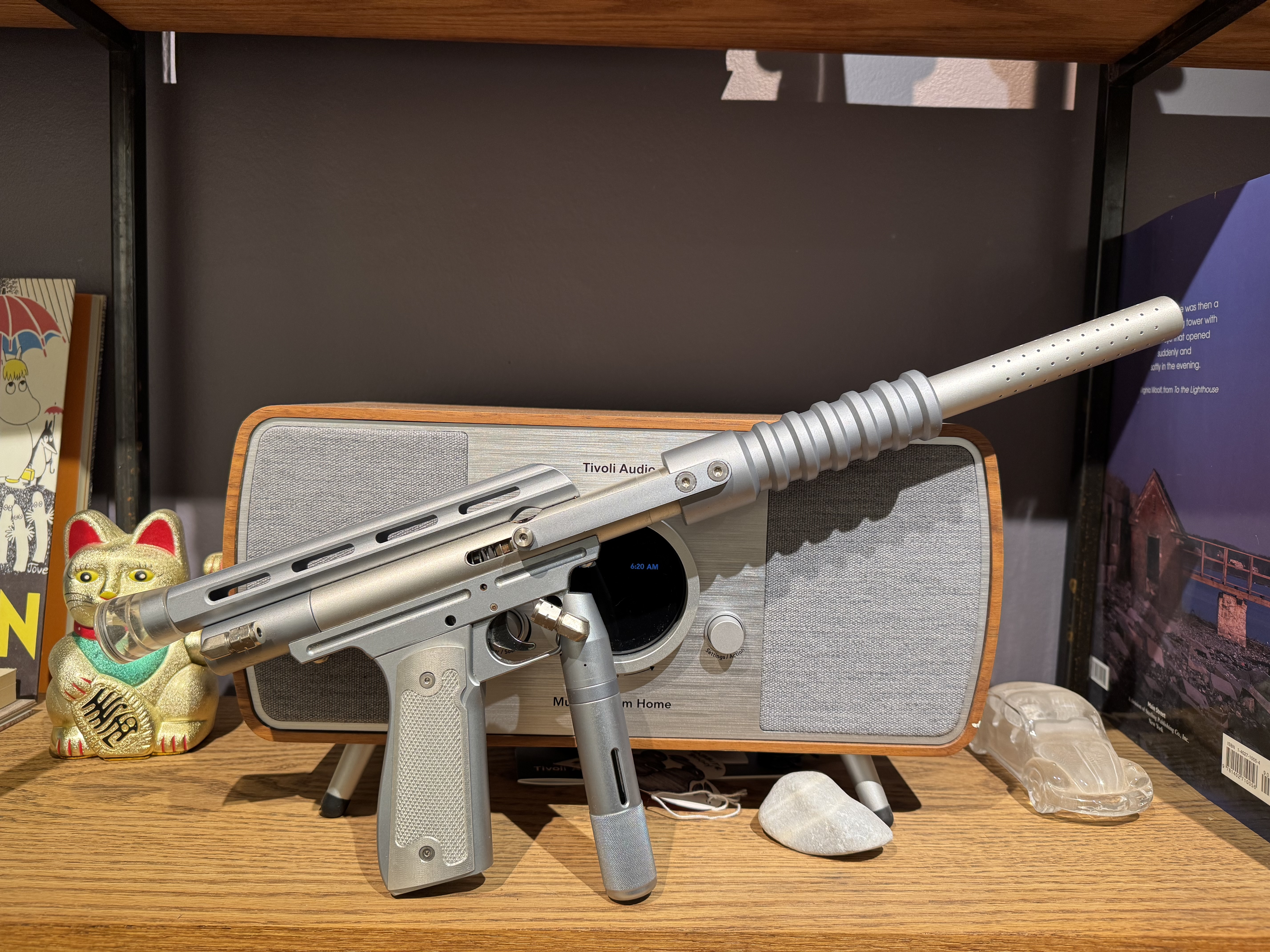

    Having a couple days off allowed me to get in the shop and finish up some projects so I finally got around to wrapping up this Phuzzard that's been sitting in a gear bag for about 5 years. I thought all i needed to do was drill and tap the hammer but it looks like I lost the airline too.
    Some nifty things going on here, I happened to have a ASP AC threaded body while also having a Carter Buzzard pump handle and the thought of a pretty "authentic" Phuzzard could come of this. Barrel is an OTP tip from an Angel barrel mated to a freak bored 10" prostock barrel and turned down to fit. Buzzard did the anno that matches a Carter Autococker I sold here last year. I wish the silver/gray was a bit darker than the silver but it was the decision I made at the time. Now to go play with it.

                Nice shiny 304 Stainless trigger would set that thing off nicely. It’s got a cool window cut on it.
                Trigger for the Phrame - but will also fit standard CCI and EV Phantom frames. Made from .120" brushed 304 Stainless, this adds a classy racegun look to your Phantom.

                  Ha, I showed it to my wife and she said the same thing. I didn't think any were on the market so I was planning on making one but you saved me a ton of time in the shop, thanks!

                  Is that an RTR frame block? The transition from the trigger group into the backstrap contour is such a subtle touch.

                    It is the RTR, i spent a lot of time filing that transition! Great eye!

                    always loved my phuzzards.
                    drilling the bolt sucks, but otherwise they arnt too bad to do.
                    • ih8cornnuts
                      ih8cornnuts commented
                      it was cake when I scored an unhardened bolt! I also bought some hardcore bits for the other bolt I have.

                      howd you get an unhardened bolt? you cook it yourself?

                      I think I got it from ASP or someone on here? It was a long time ago though
                    Alright so I clearly don't understand how the pressure doesn't get vented out the side...

                      its been working just fine for 40 years!
                    It goes through the power tube and out the bolt. You know, I wonder why nobody has ever made a power tube with an external O-ring...

                      oooooooooooooooooooooh.
                      duh. thanks
