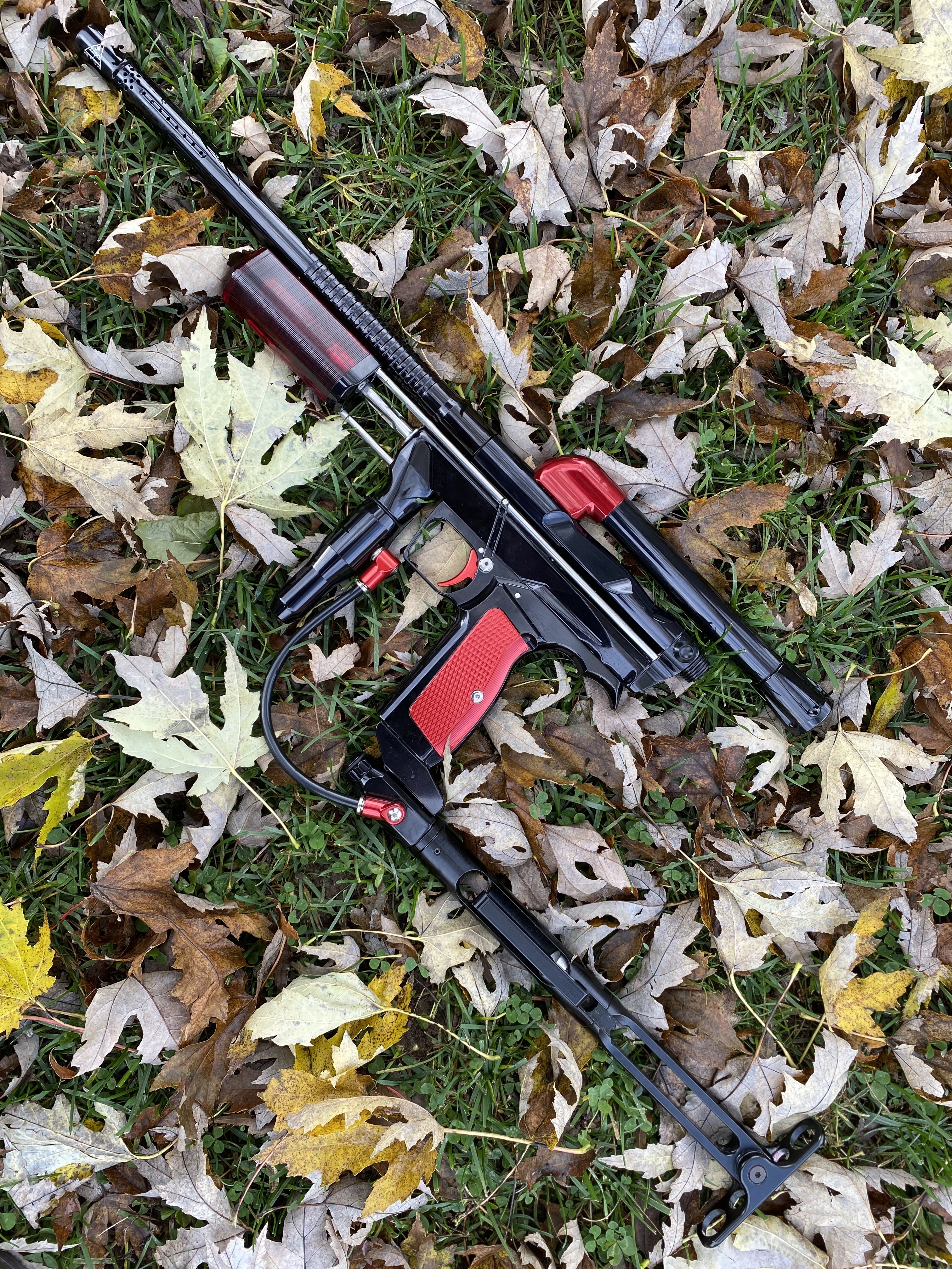

          this one was me, i remember i was able to get a couple shots over 40 before it wasnt worth it. (unless it was 30 which lines up with everyone else, but i think i was able to use 40 between reloads consistently.. it was awhile ago)
            This marker is why I built my J6 into a SC marker. Everyone was like you can’t do that. Your like oh yeah hold my Beer.
