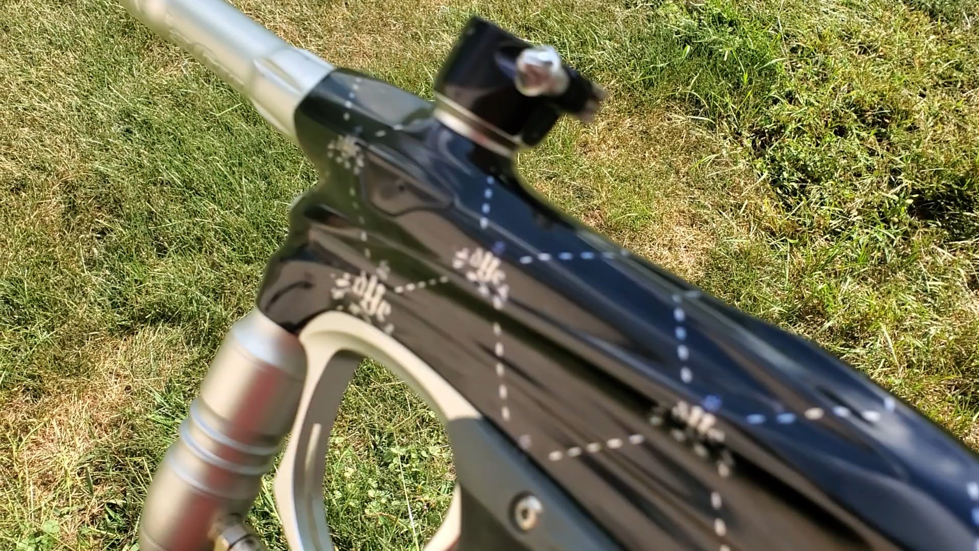

    Started making aluminum breech spacers to replace the plastic, failure prone eye pipes made by dye. They take a long time to get them to fit right. And each dm7 is different as far as breech dimensions go. I’ve started sizing them to my tightest dm7 breech, so that they should fit your marker no matter what. Ideally, you’d send your marker to me and I could size each one to your body. Out of the two that I’ve finished, one has a really messed up looking bore which doesn’t effect anything and is purely cosmetic. The o-ring doesn’t even really ride on the inside. Most of the ones I’ll be making in the future will have nice clean bores like the one pictured. The one being tested in the video is the crappy looking one. It's hit or miss what they'll look like on the inside since again, it's %100 cosmetic and does not affect the function or damage either the bolt or o-ring
    Videos of testing
    This is "eye pipe test 1" by Crustacia Hambone on Vimeo, the home for high quality videos and the people who love them.
    This is "eye pipe test 2" by Crustacia Hambone on Vimeo, the home for high quality videos and the people who love them.
    pm me if you have any questions
