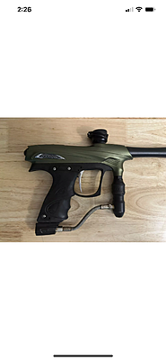

    Hey y’all, feel like a bit of a moron here but I’m more into mags/cockers. I bought this Rail on eBay to let friends borrow when I play. I’d like to order an oring kit but I’m not sure what year this is. Not sure if anyone can tell from the picture please?

    2011 or 2012, same oring kit either way. Also these can take the dye rize solenoids if a new noid is ever needed. Im about 95% sure all orings are the same on these as the dye rizes too.

        Kyle is correct. It's a 2011-2014 series Rail. Shares a solenoid with the Rize CZR and o-ring kits should be the same.
        A few tips about these:
        1. Make sure the eye pipe is correctly aligned and fully seated, because if it's not all the way in it can get cracked when you tighten the barrel. To avoid overtightening the barrel, put an o-ring around it just above the threads. Something like a 016 or 017 should work.
        2. The boards are notorious for vampiric battery drain, so it's best to remove the battery at the end of the day. If you don't, at least be prepared to find a dead battery the next time you use it.
        3. The HPR has a tendency not to purge and can hold 1-2 shots worth of air for long periods. Be mindful of this when testing the battery/board; you may unexpectedly dry fire it without a tank. Best practice is to screw in the barrel before powering up the board, just in case. I learned this the hard way by launching a eye pipe across my garage. Marker had been sitting in my gear bag for two weeks without a tank, but the HPR still held air.
        Bonus fun fact: These share circuit boards with the UL version of the SLG.
