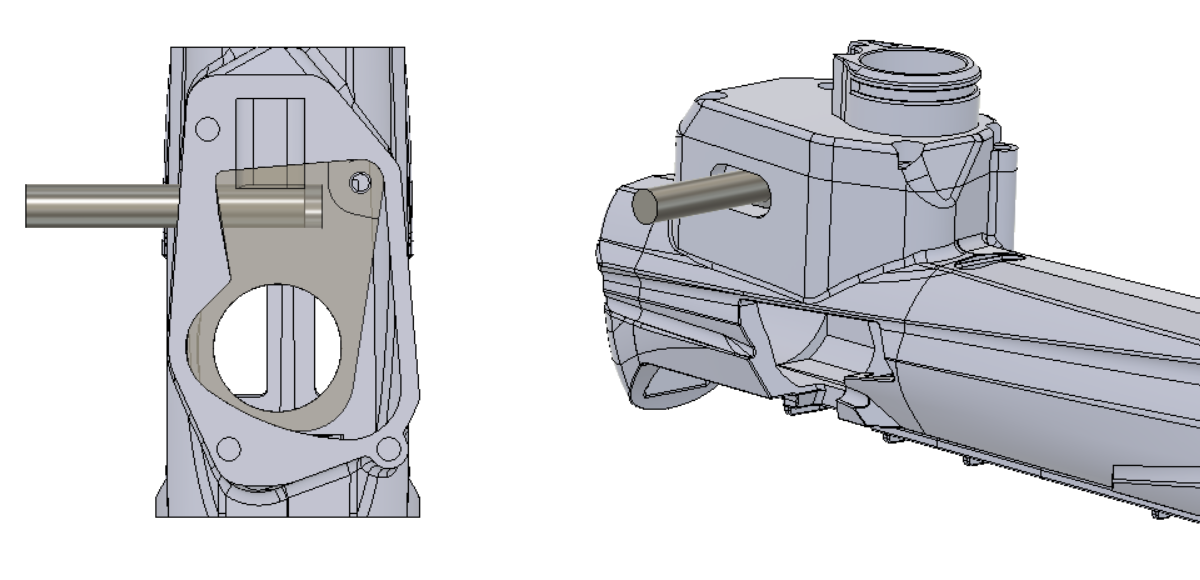

        I started to design a pump emek body that would impinge on the feed stack if "closed" and load if open.... However I stopped because technically you could hold the pump back and shoot semi. I have other ideas too but nothing that doesn't involve machining

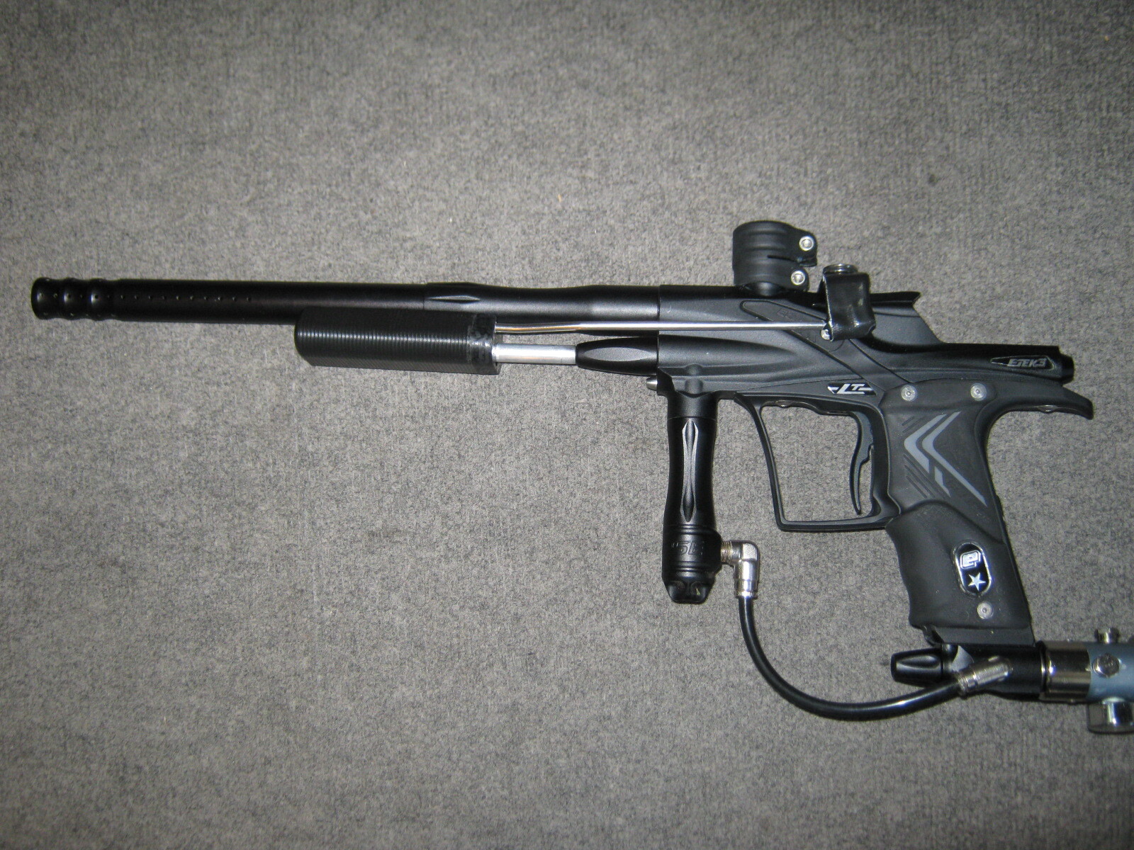

                I Spumped an Etek. done kinda cheap and so it could be quickly turned back to a semi.

                My brain wouldn't allow me to let this one go, so here's a thingy I made. EMEK pump body, the "pump" action is via a thumb lever next to the foregrip, which operates a pivoting block...

                  And a shooting video... Pretty smooth little thumb-pump action. The pump "stroke" is nice and short too, because all it does is pivot the block about 15 degrees to disrupt the ball stack.
