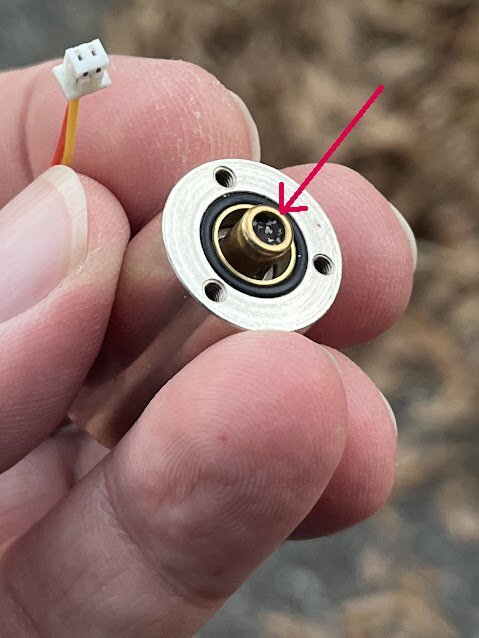

              So I am going to give you a compressed easy answer and a little bit of "homework" if you want to do it. First off the piece that you describe as crumbling is likely the poppet valve (went with ANS because I am lazy), there is only a single solenoid.

                No, it's the solenoid. Sorry I didn't describe it well enough. I don't know the name of the parts. Inside the solenoid, there's a smaller armature that moves up and down depending on whether the solenoid is charged or not. The tip of that armature has a round brass feature with a cup seal inside. That's the seal that's falling apart.

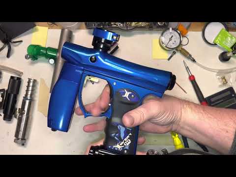

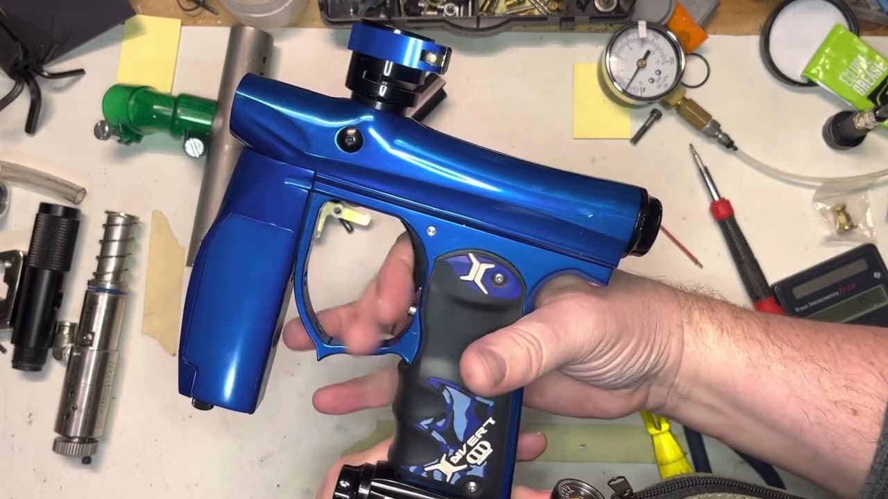

                    New problem. I took the Minis out last weekend, but neither one of them saw field time. When I aired them up, they both did a weird farting thing. They would cycle and move the bolt, but they would only shoot the paintballs about 5 feet. So I gave up pretty quick on them and switched to Emeks.
                    Once I got the Minis home and tested some more, however, I realized that they would start working...after a while. Here's a video of what I'm talking about. This Mini has been sitting in my garage for a few days. When I add air and a battery, it doesn't shoot right at first. But then about a few dozen shots everything starts to get going again, and it will keep working fine until I let it sit for a few more days.
                    Remember, this Mini has brand new o-rings and a new solenoid. Good battery too.
                    Is this normal with a new solenoid? Is there a break-in period or something?

                      Sounds like a sticky poppet... mine used to do that all the time. I ended up switching to oil instead of grease in that area.

                      I don't think it's a break in period. I've heard this is common. Now, how to fix it? Hopefully someone will chime in so you can get an answer.

                        So, I took apart the bolts again, wiped off all the grease, used some oil, and tried them again after letting them sit for a day. Same problem.
                        Then I got to thinking about the o-ring itself that's on the poppet. When I rebuilt the Minis, I bought some generic o-ring kits from eBay that had all buna o-rings, which is mostly okay since most of the Mini o-rings are indeed buna, but the one around the poppet is not. It's polyurethane. So, on a whim I bought some of these original spec o-rings and installed them on the Mini poppets instead, and boom, problem solved. No more sticky poppets.
                        Lesson learned, I guess. Buna o-rings are okay for everything but the Mini poppets. Use polyurethane for that.
                          Jordan commented
                          Yep... didn't realize you had buna on the poppet. Definitely a "must use PU" area.
