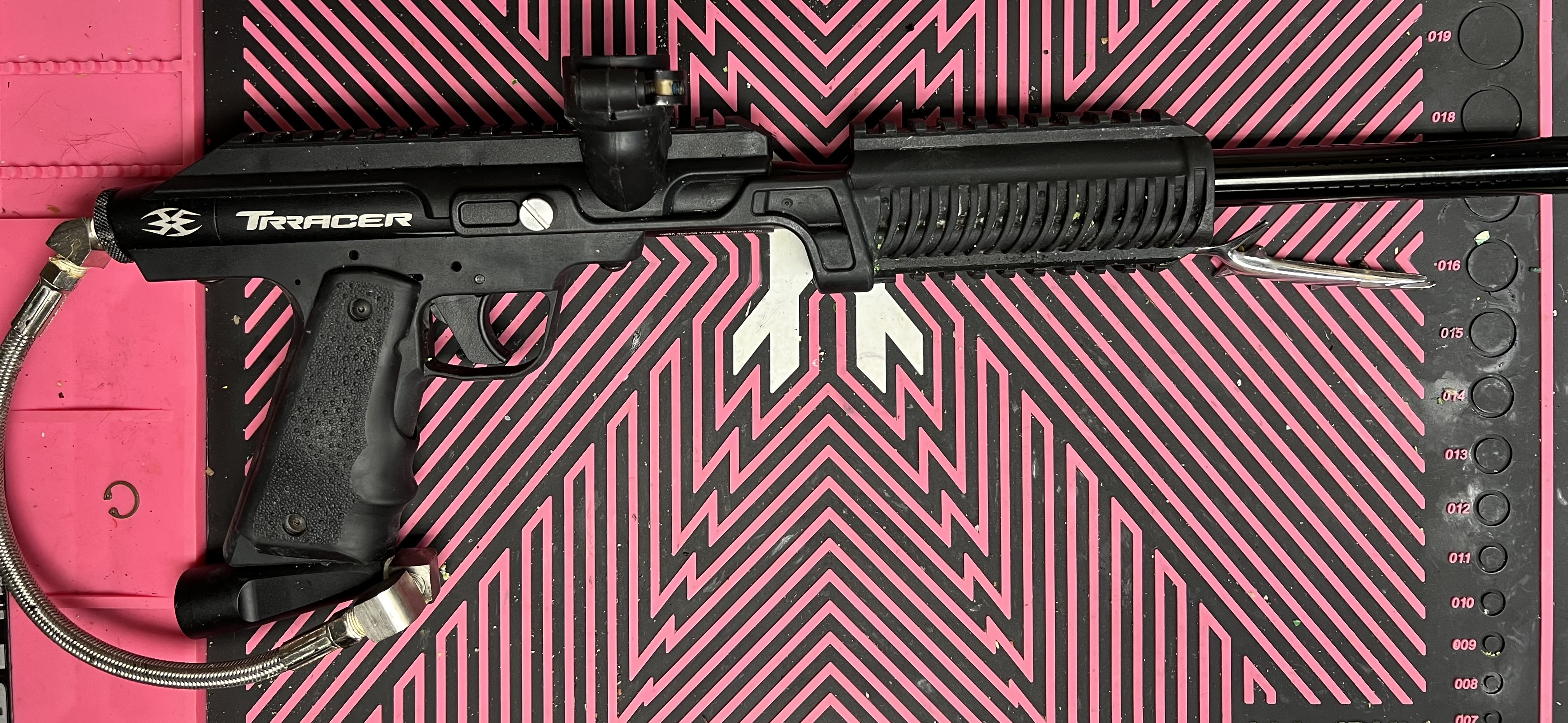

    Been a little bit since I’ve had something interesting to take apart. But recently ended up with a pair Empire Trracers. So let’s get down to business.

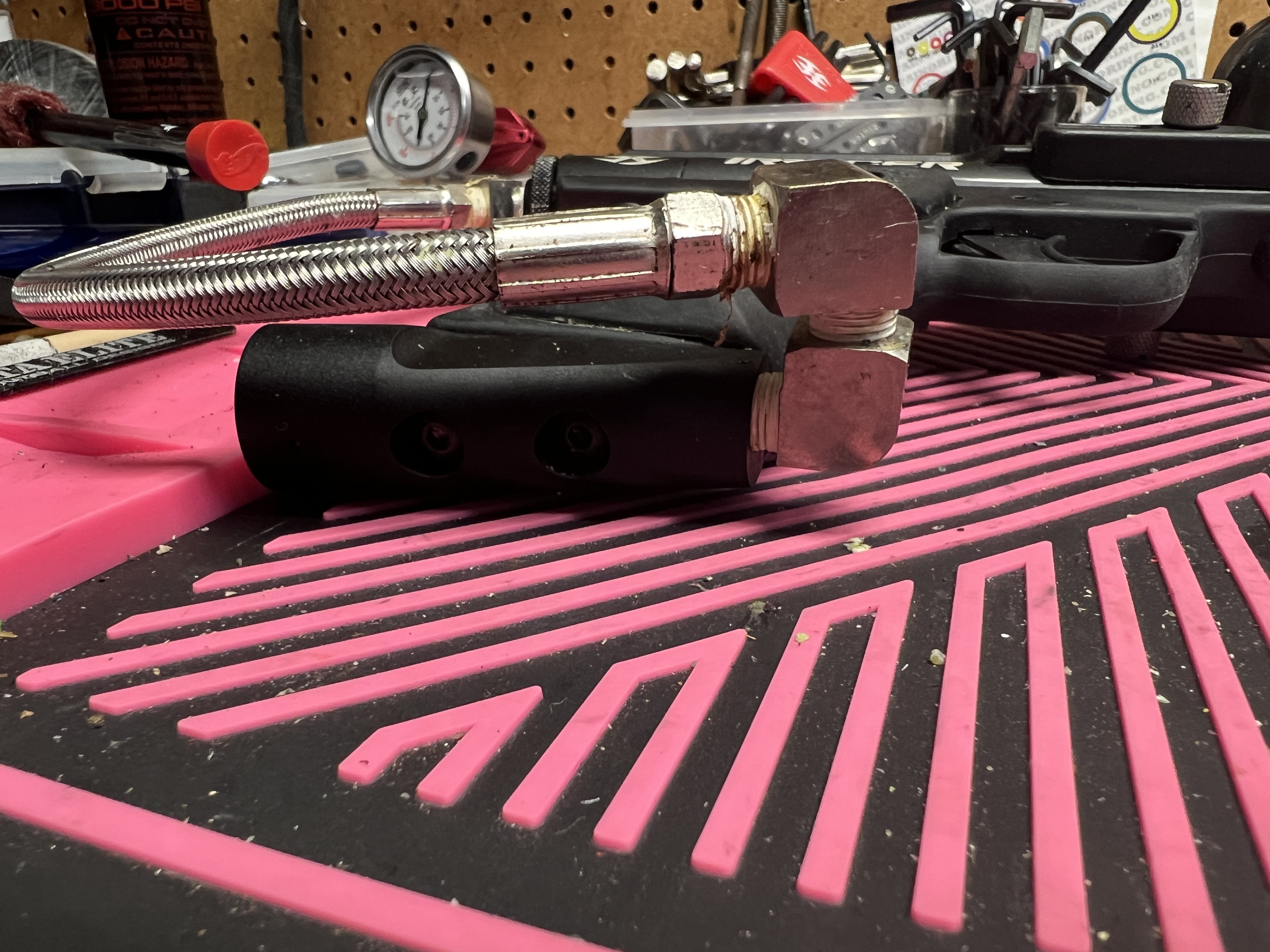

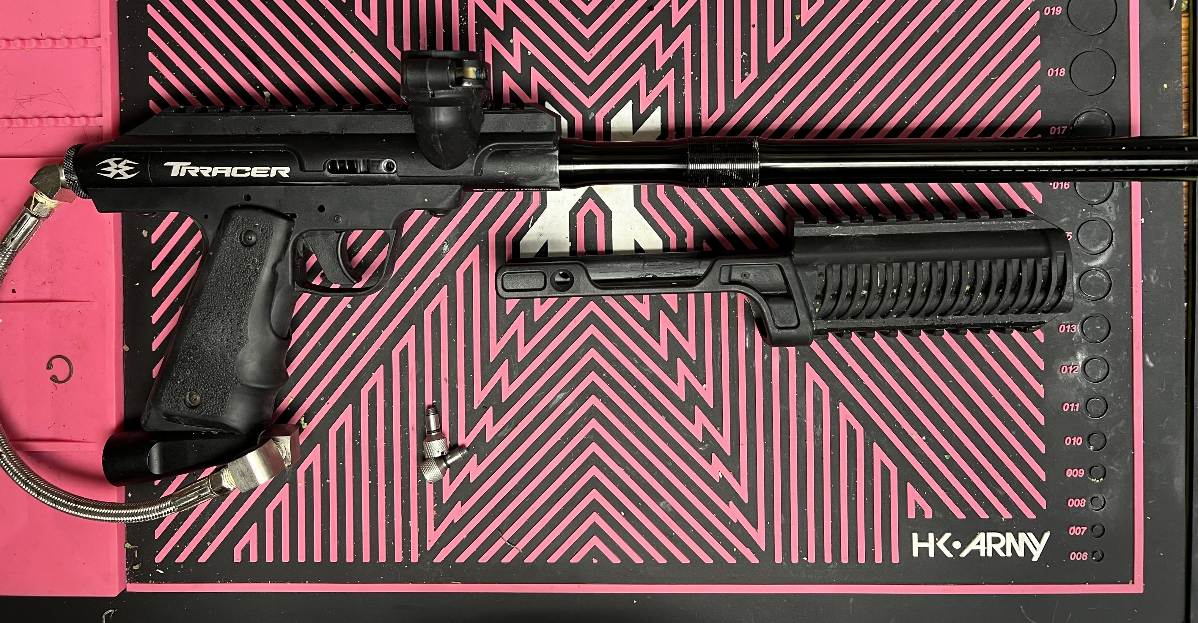

    Bit of an interesting air setup, running the back bottle to and ASA.
    The braided hose has a bunch of sharp wires
    pointing out, so it definitely has to go. Be kind find to run a tank Hawaiian style for a nice balance. But that’s for another time.

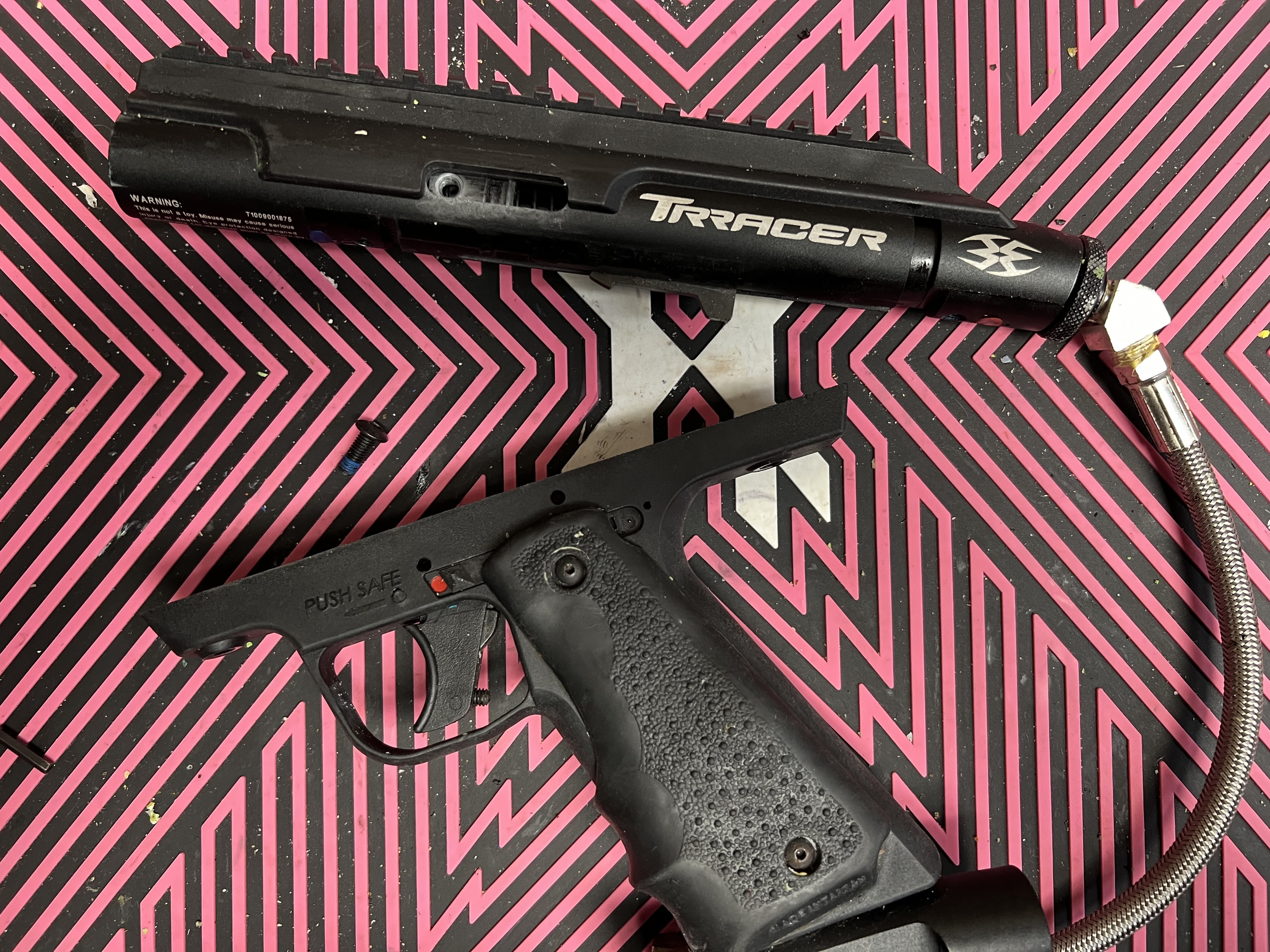

      • 4525
      Next we remove the trigger frame but undoing the two bolts.

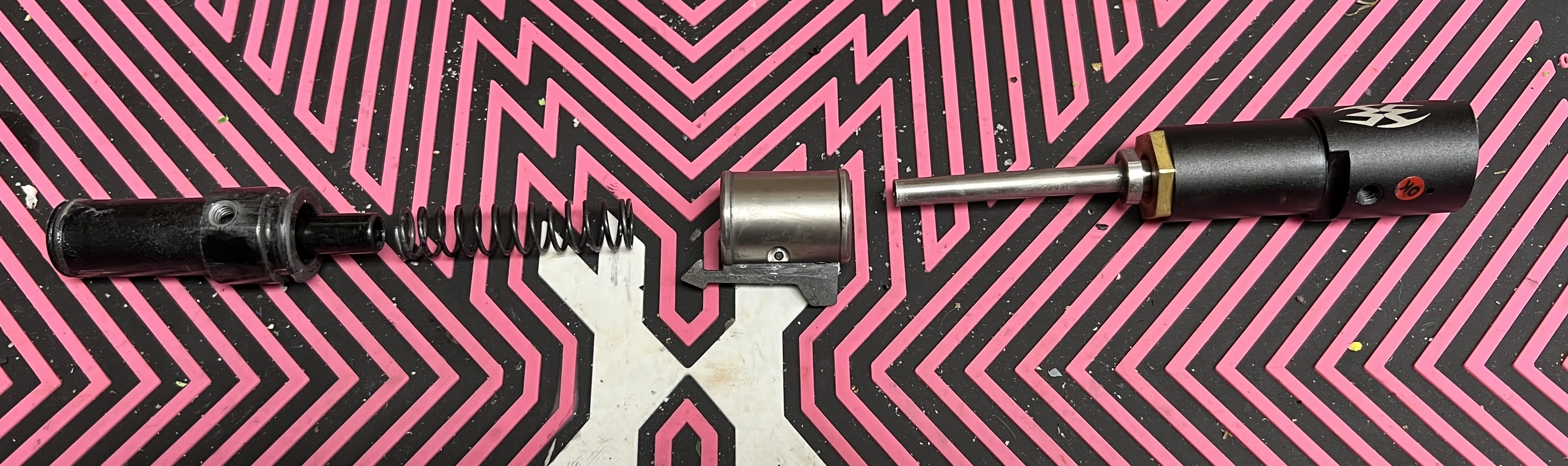

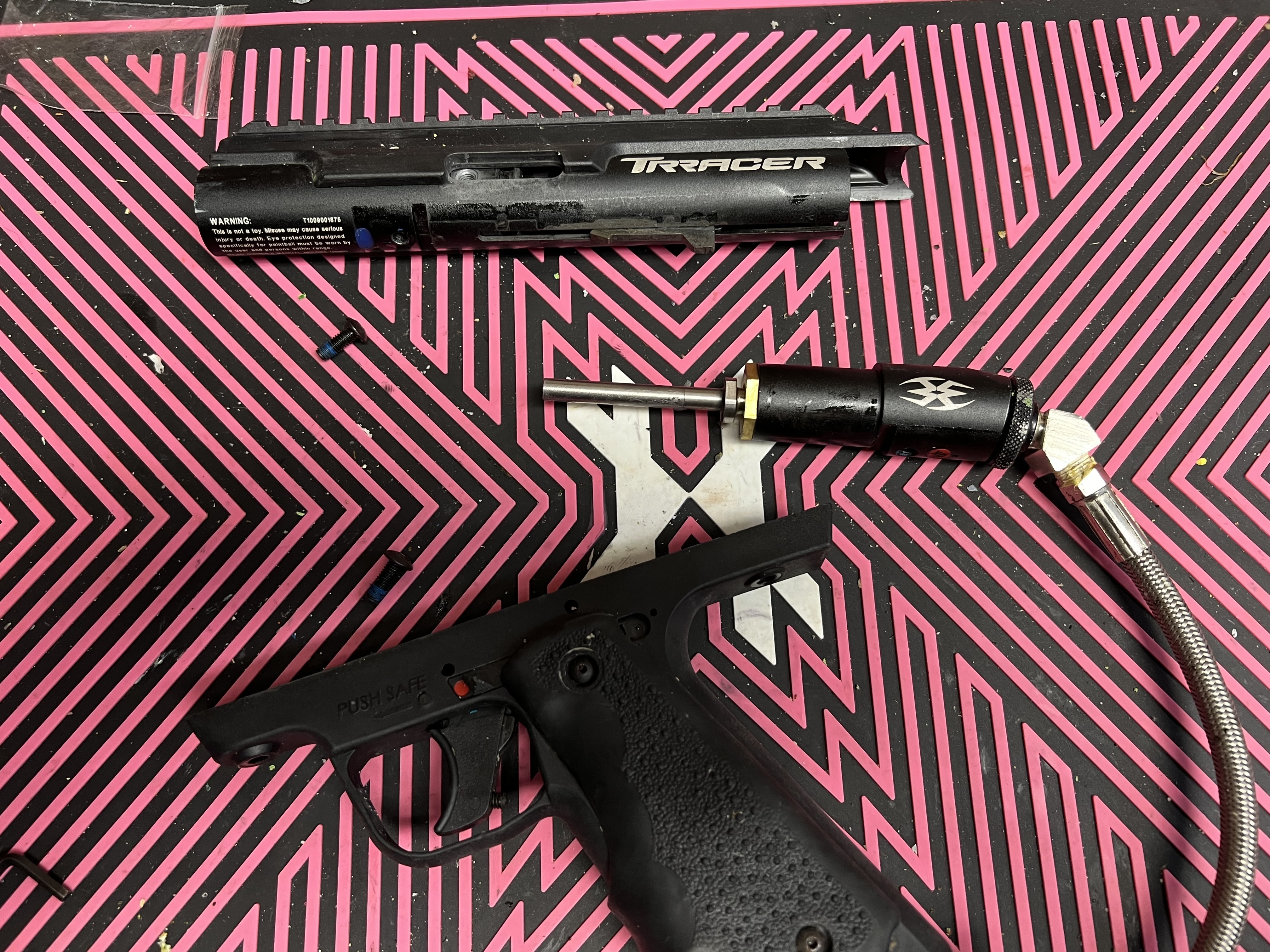

      The rear assembly, which is held in place by the rear frame screw, slides out of the body:
      And the you can remove the internals:

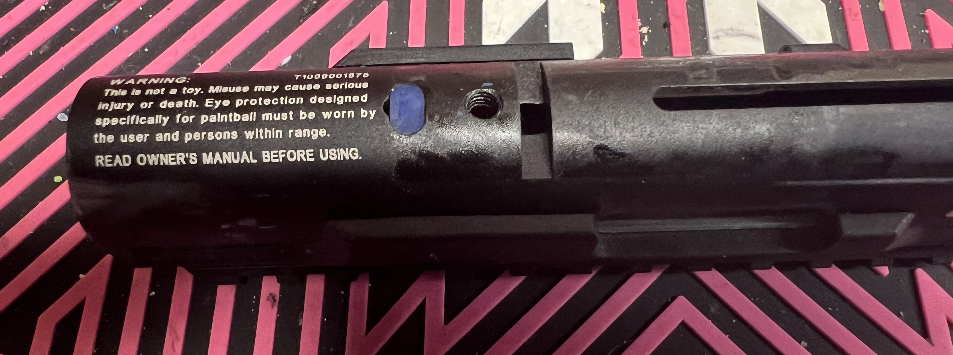

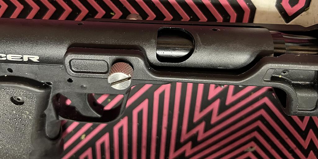

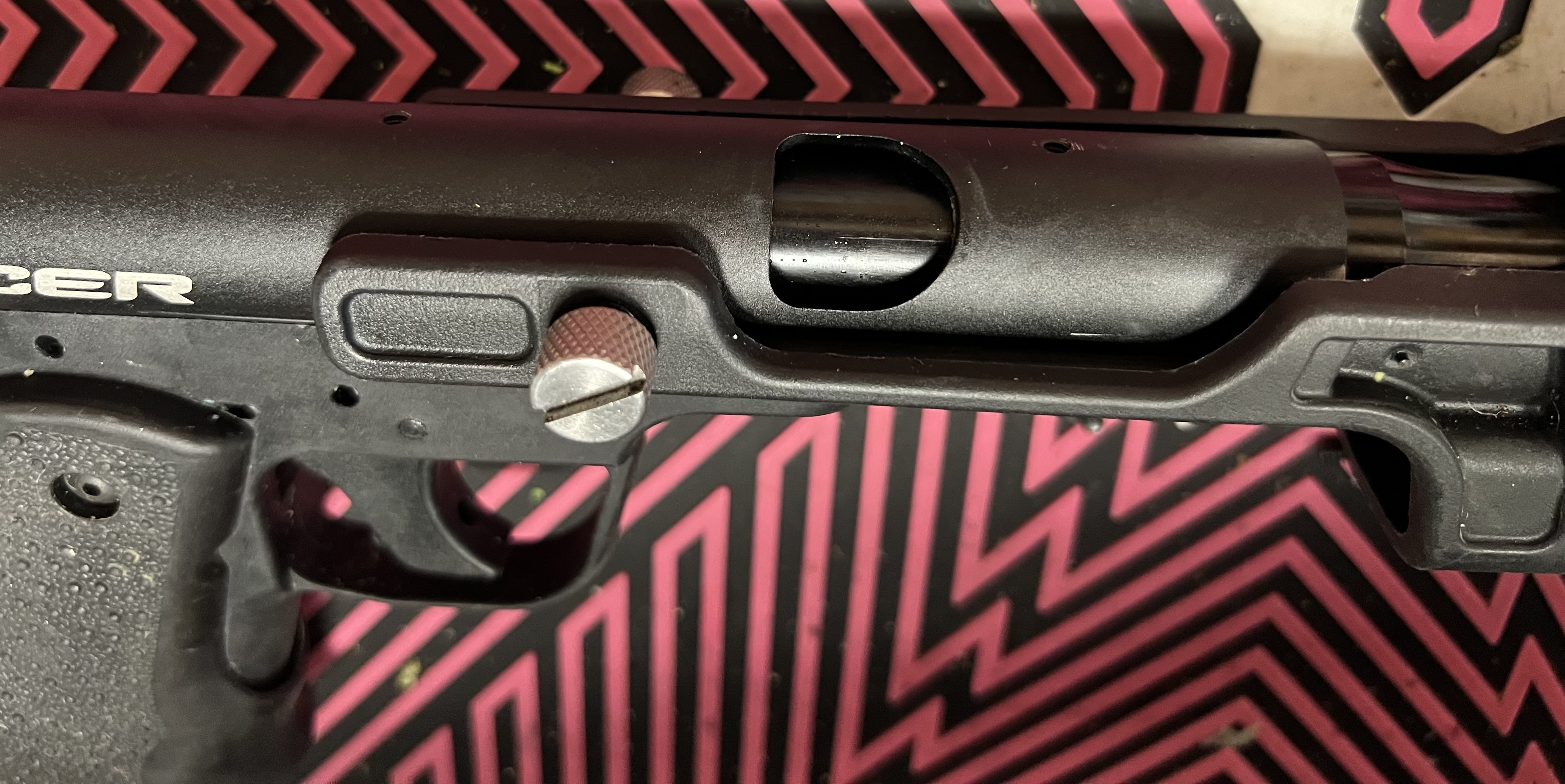

        So far, nothing too crazy, but now we get to the fun part, the body. First we’ll see the ball detent, which is a standard Empire Sniper style rubber finger. The front of the trigger frame holds the detent in place.
ID:	578479 Click image for larger version

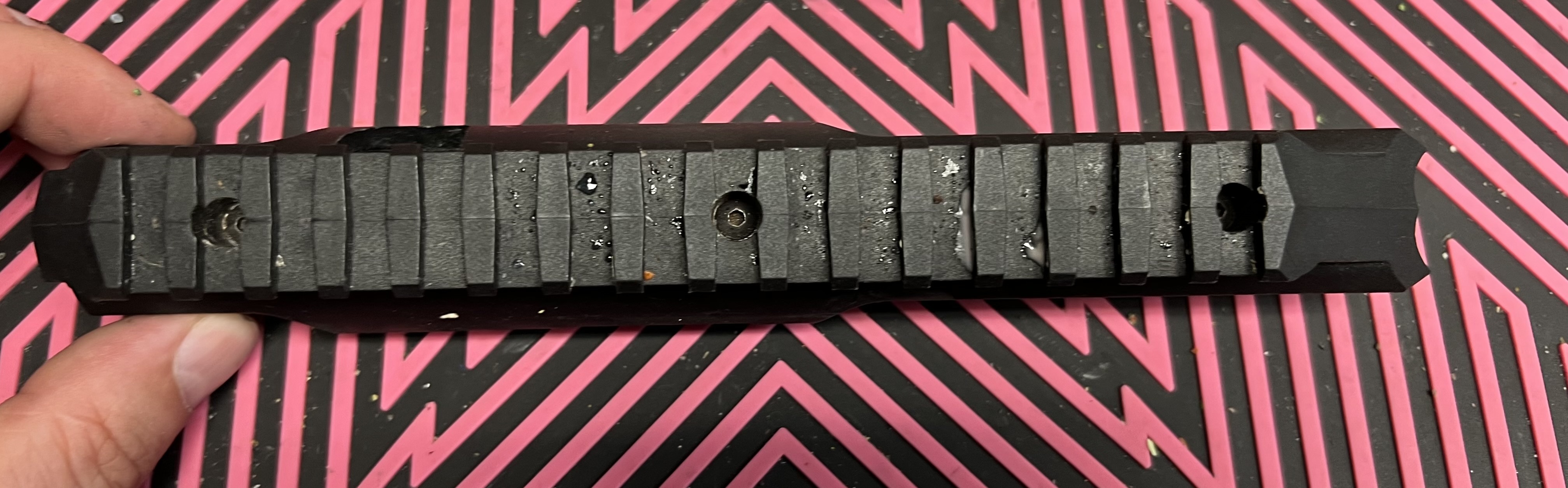

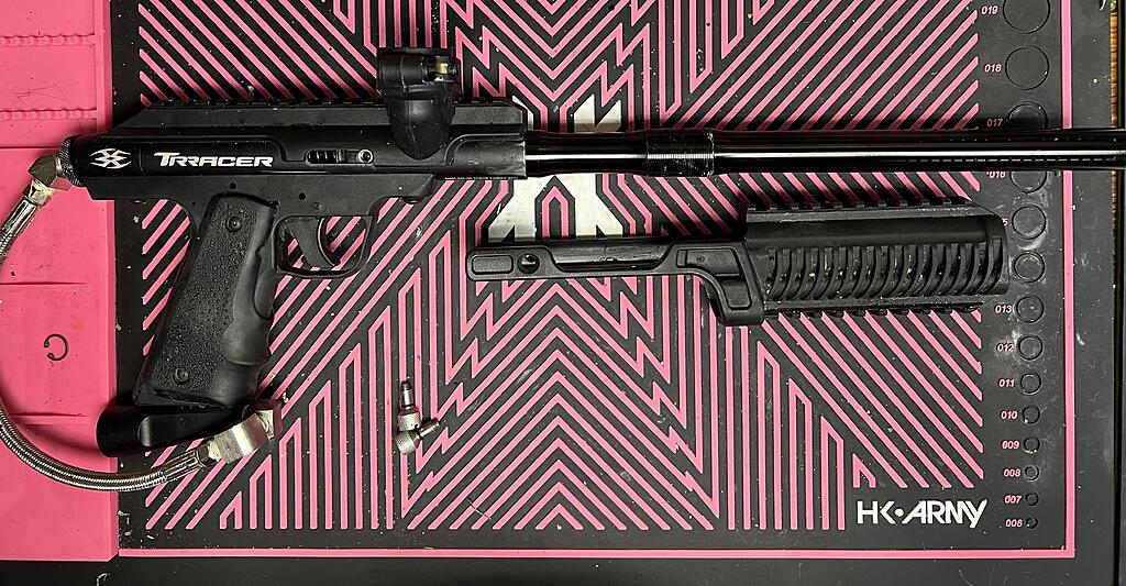

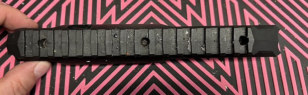

          • 4525

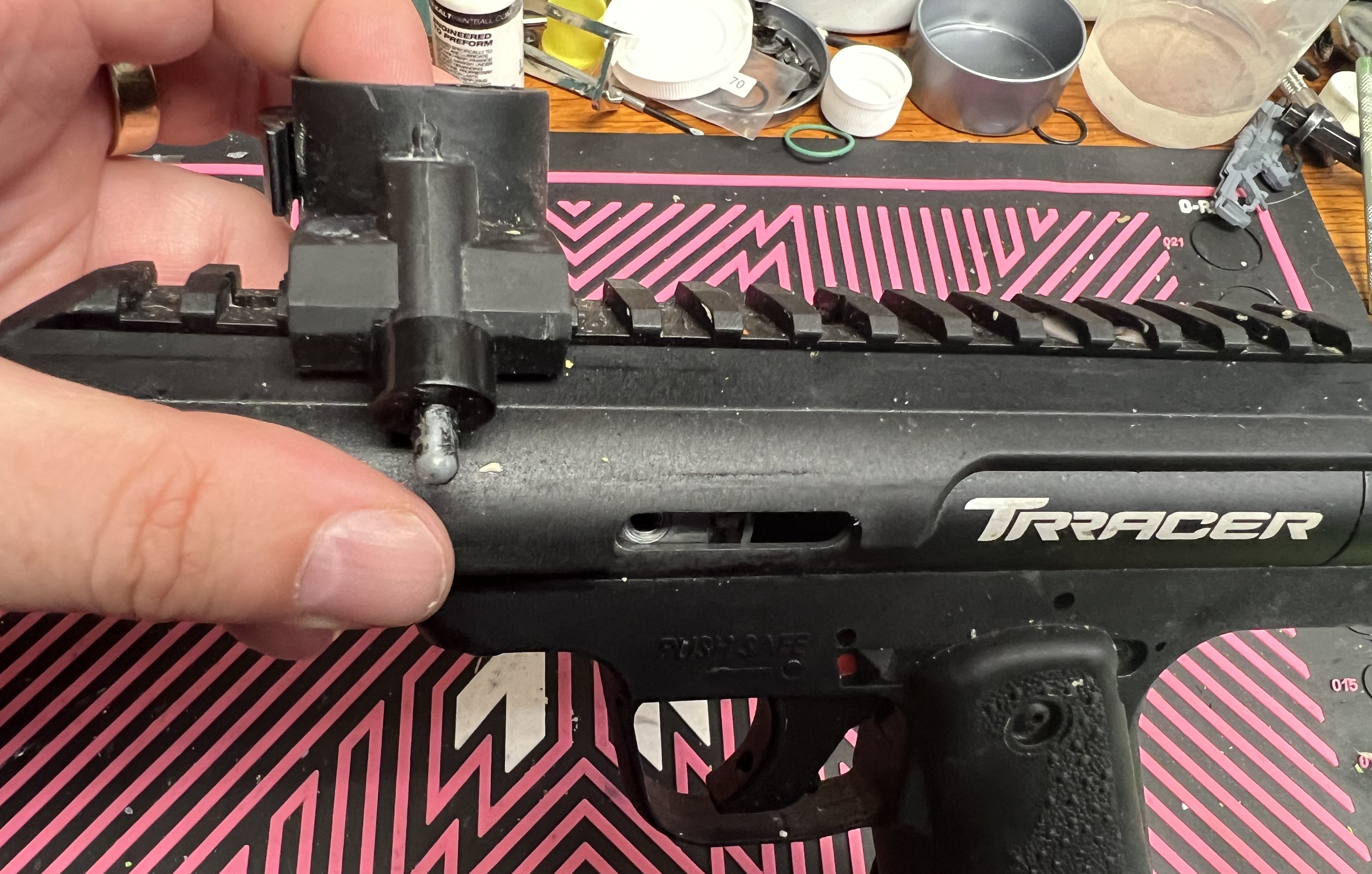

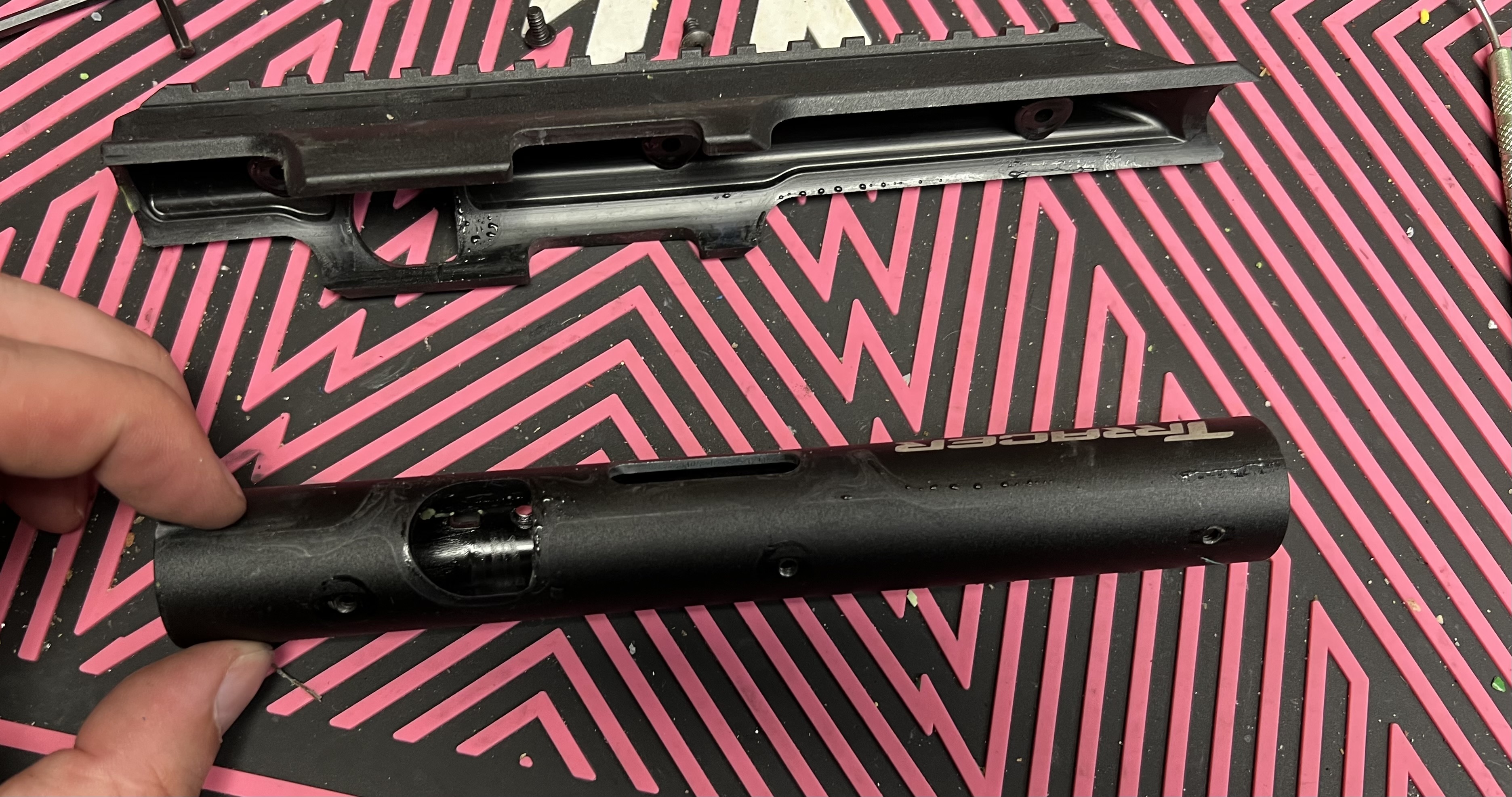

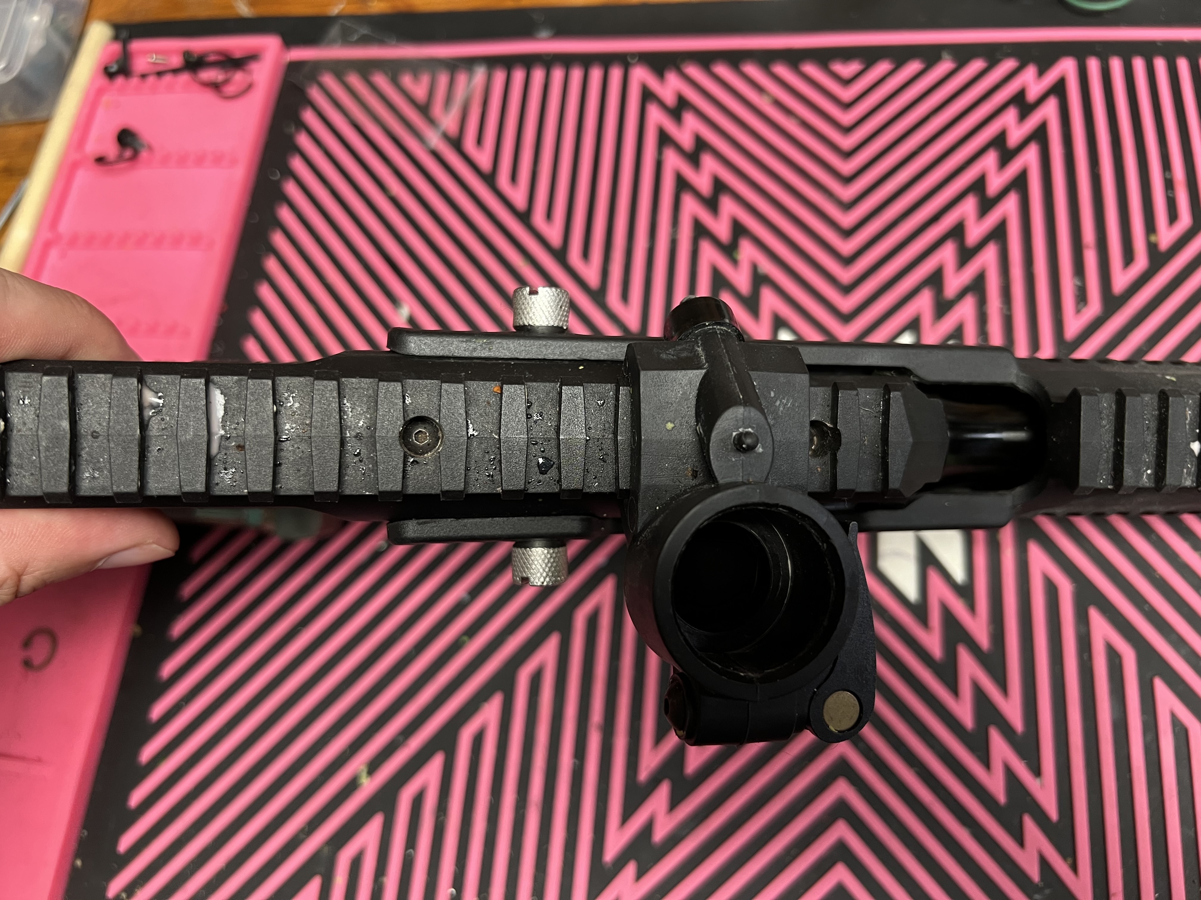

          The top of the marker has a plastic sight rail
          being held in place by three small Allen bolts:

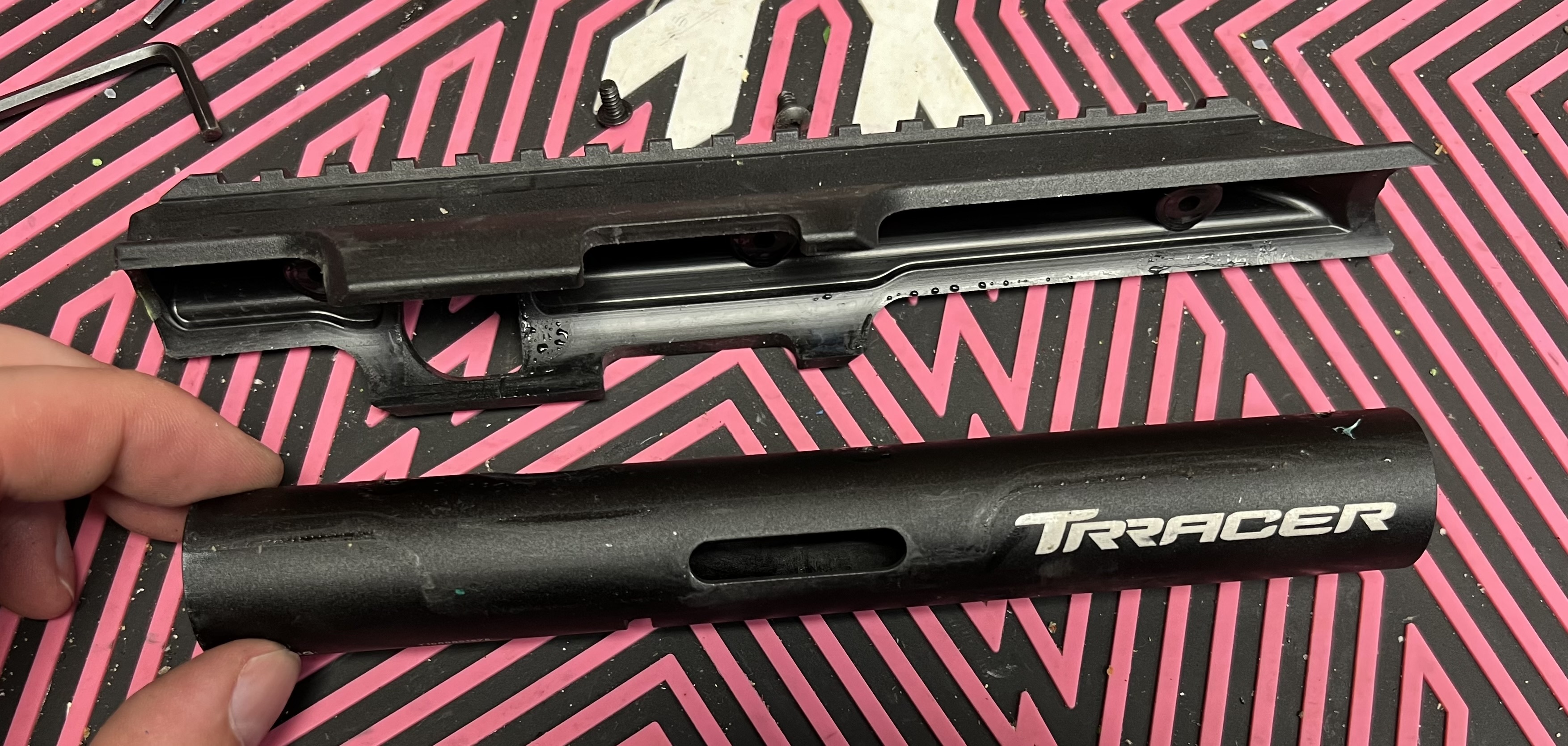

          And the body without the shroud.
ID:	578482 Click image for larger version

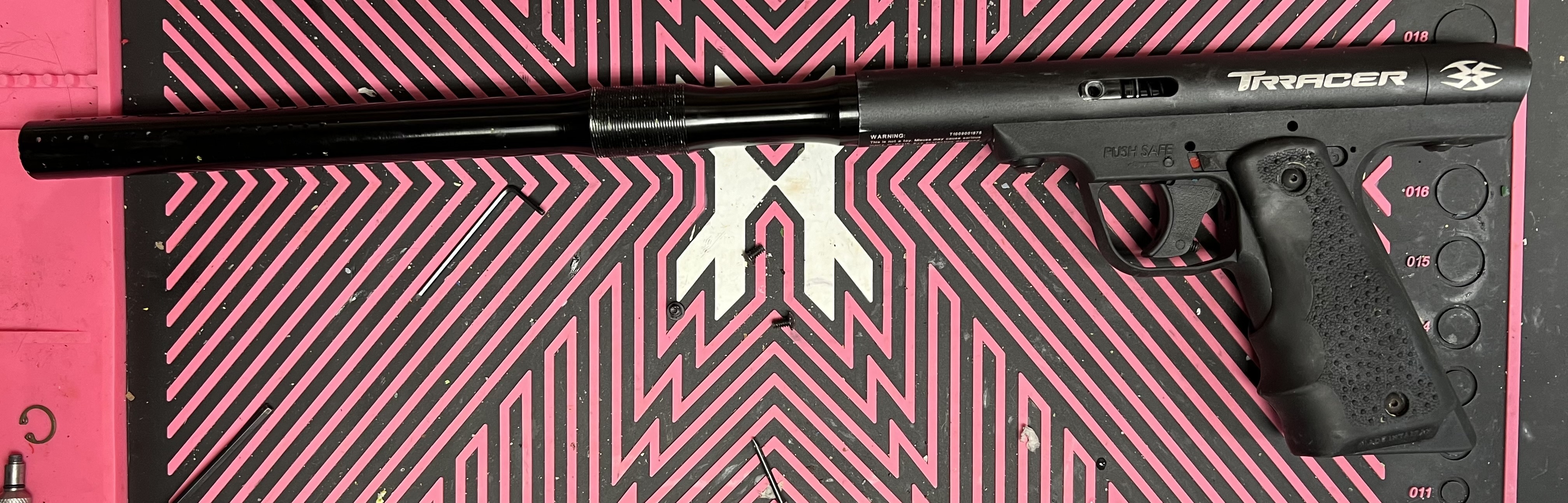

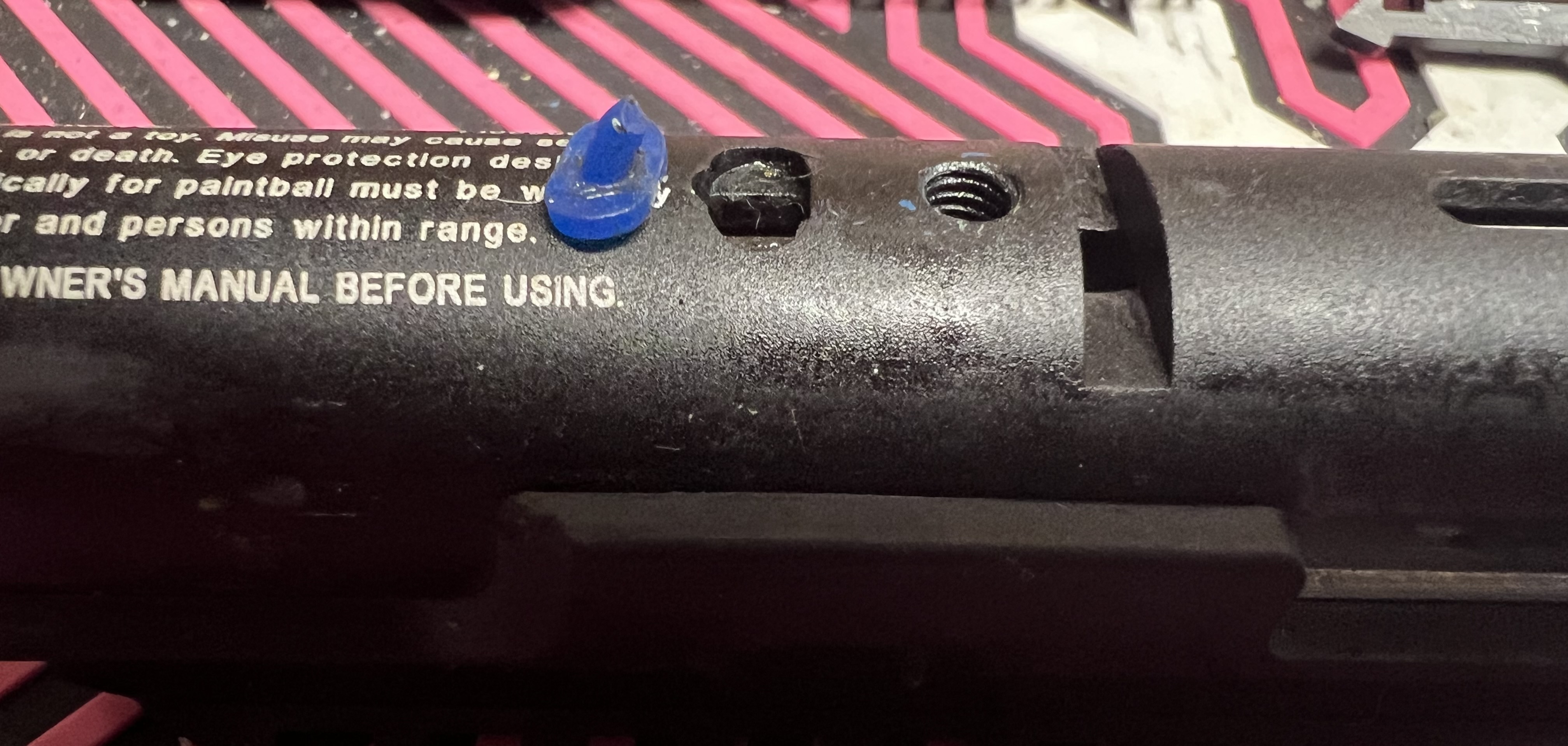

            Now you likely notice one of the best parts of the Trracer, the first strike breach. That’s right, this littlle guy can very easily be used to hand feed zoomdots!

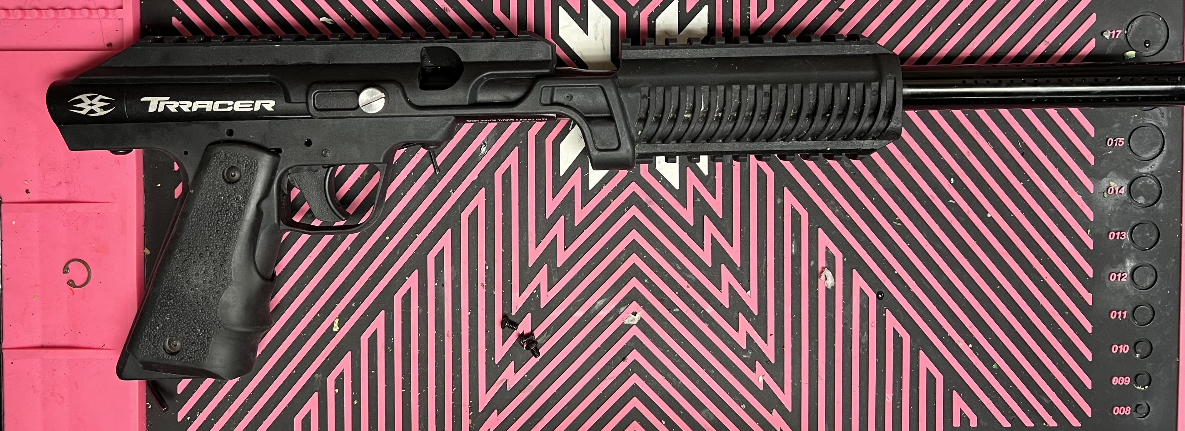

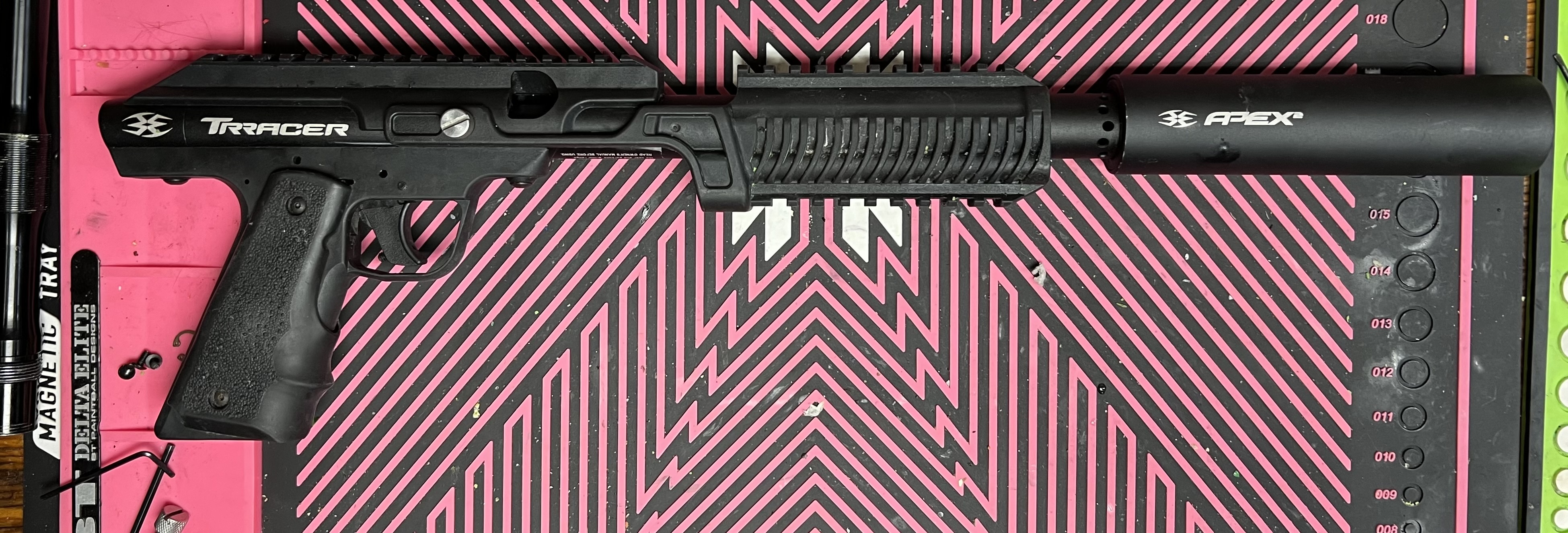

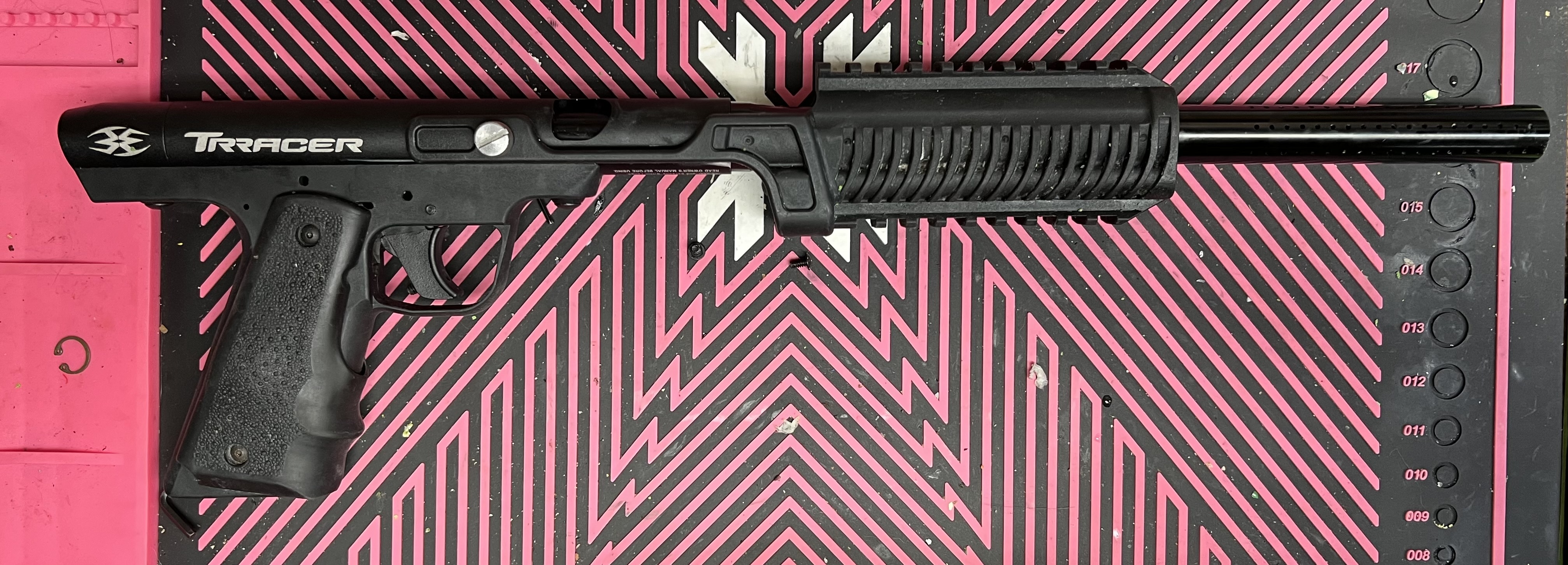

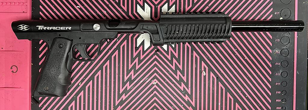

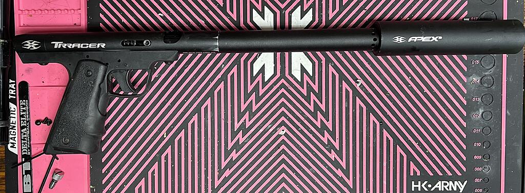

              • 4525

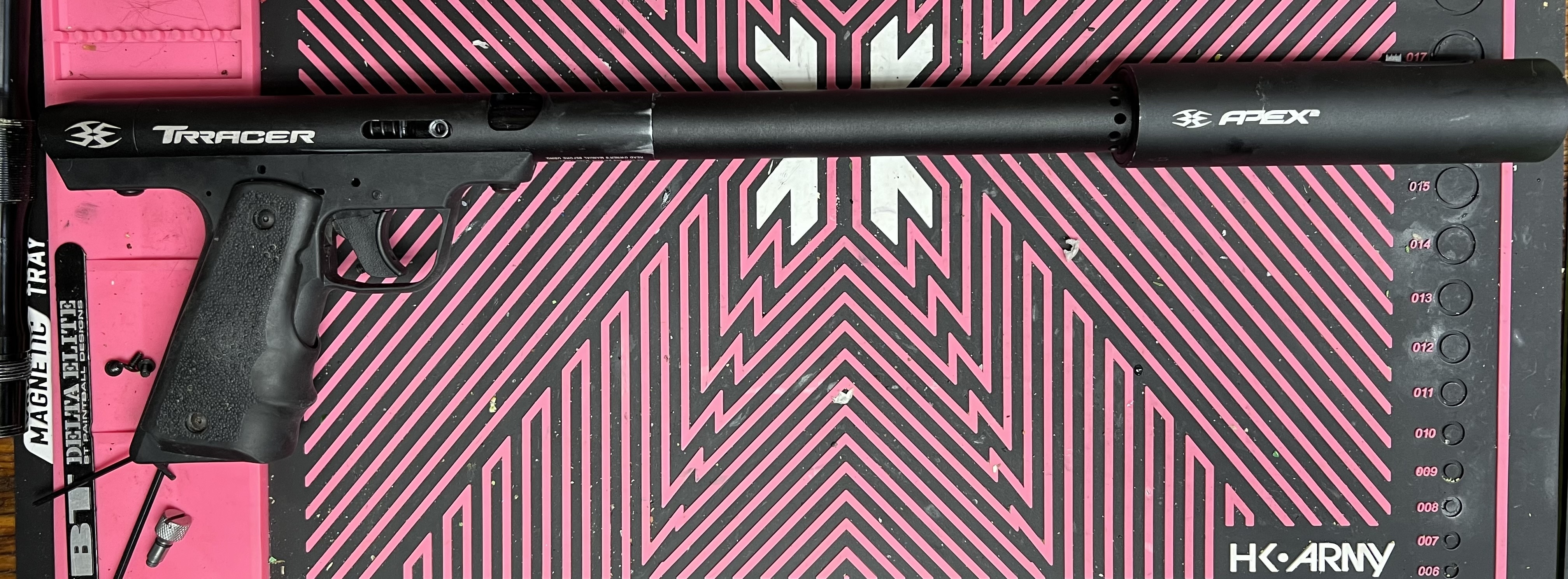

              The marker also looks quite sharp without the bulky top rail and so hard fun setting up a couple different setups:
ID:	578489 Click image for larger version
ID:	578490 Click image for larger version
ID:	578491 Click image for larger version
ID:	578492 Click image for larger version
                • 4525
                Overall these are pretty simple markers and offer some great flexibility and customizability. These are also cocker threaded, so you can use your favourite barrels.
