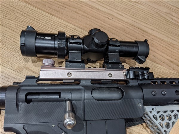

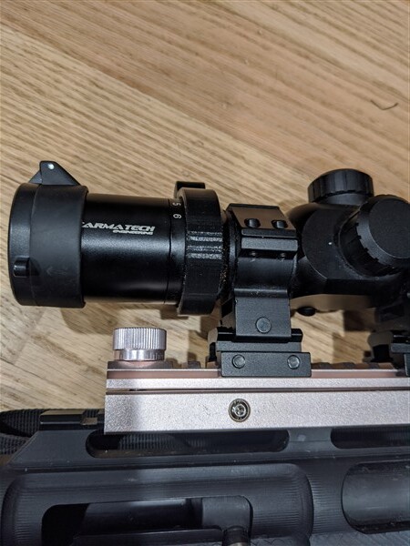

                      Ok, I got mine this weekend, and I when I put it on the gun it didn't went too well.
                      The scope woble a lot, the whole thing is not machined with very tight tolerances ...
                      I cut down the connector on the lathe and put some locktight on the front adjustment (side to side) so it doesn't woble too much. It's not perfect, but it's better.
                      The elevation screwed is not too bad and the spring feels nice. I think with a few more twick it will do what I need it to do.
                      ill post pictures when I get a chance
                        Frenchy is here!
                        • 3019
                        • Nor Cal

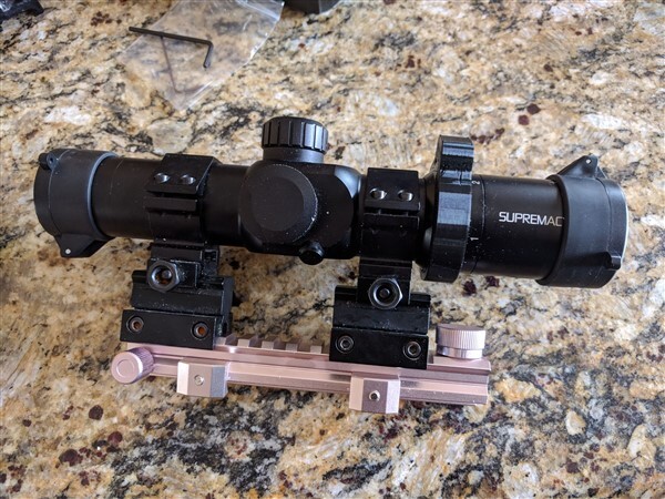

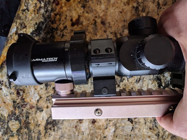

                        Here are some pictures:
                        The supremacy doesn't fit without the riser, so here is how it stand now, with 1" riser. I have 1/2" in the mail:

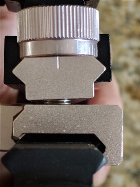

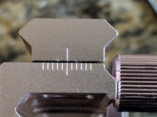

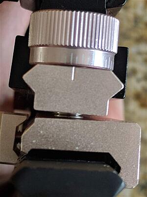

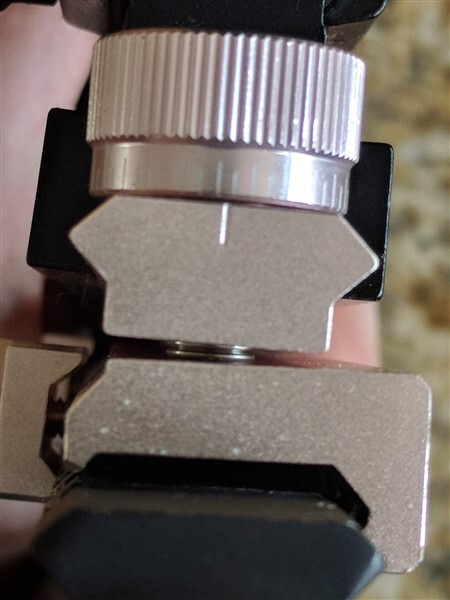

                        The rail had a lot of slop from side to side (view from the back):
                        Here is the source of the slop (view from the front):
                        I cut the threaded nut holding the front down until this gap was gone. The scope doesn't move much anymore, it is probable playable at this point...
                        Also, the front side to side adjustment got a nice dose of lock-tight as im not planing on using it at all and i dont want to move.

                          The 1/2" riser came in, they are just right:
                          IMG_20200908_183914.jpg​
