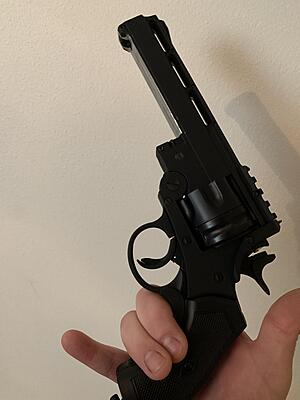

    Fyi, I know this was requested from some people before the Snap. Got my roscoe in, took it to the mill within the first week. You CAN mill the rail off, but be warned, the casting process leaves the area with some voids....
    So while I don't really care, be warned. I am also willing to do this mod for people as it is fairly quick and easy. I think my current plan is to mill a bit deeper and then make a small aluminum cover so that everything would line up flush/smooth. I mainly did this mod in order to make it easier to fit in a holster. Putting lights on the end of a revolver just looks silly!
    Now its time for a paintjob...

      That is sick... can I send mine to you? Can reward you handsomely.
      • Lt. head-shot
        Lt. head-shot commented
        Handsomely you say... You have my attention. PM me bud and I will be happy to mill it for you.
    • Arthur
      ︻デ═一 *** ** *
      • 665
      Lt. head-shot , appreciate the awesome work and quick turnaround.
