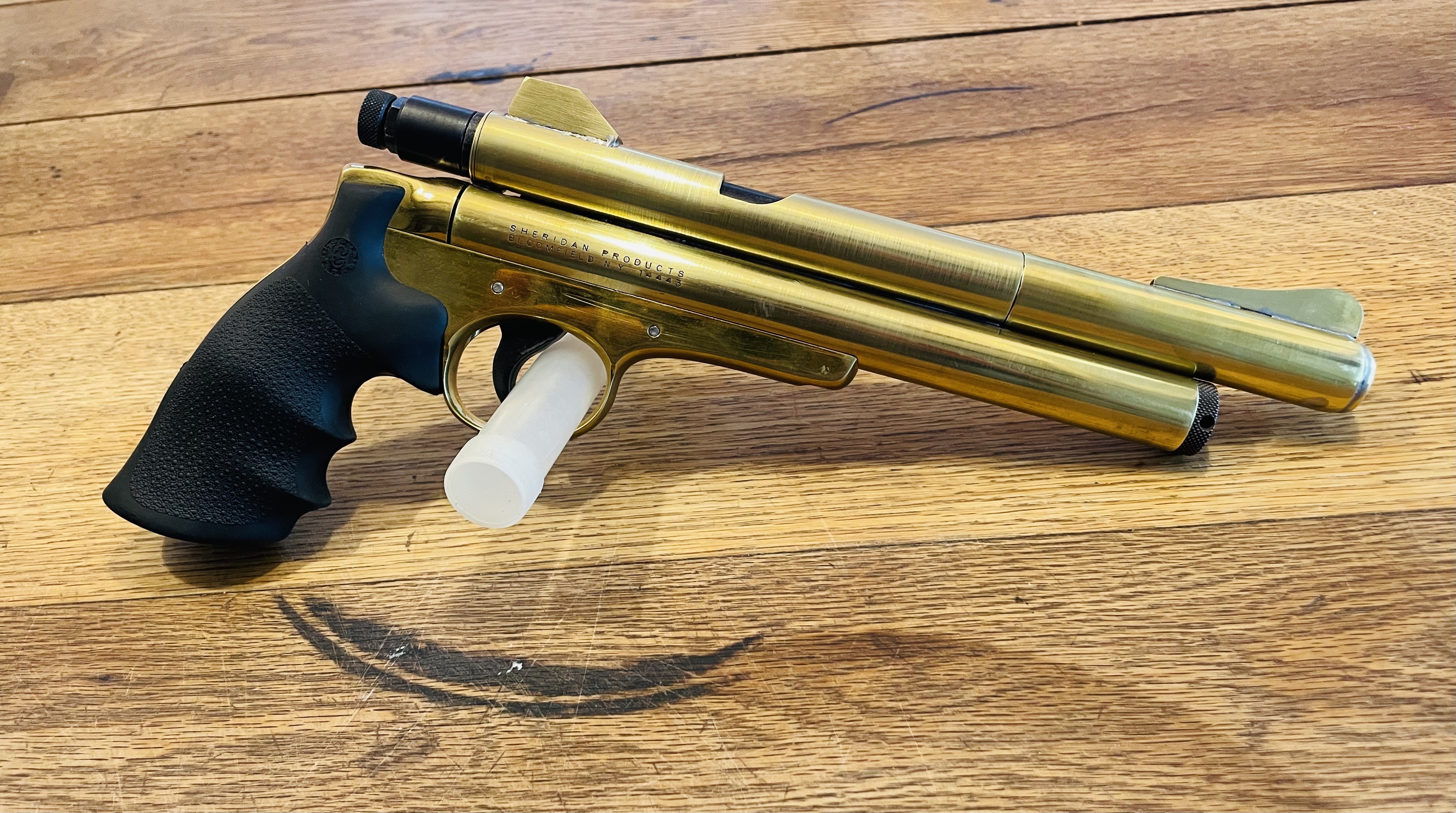

                      For me my favorite FS delivery method, is a custom bolt action Phantom I hand load them into. I don’t use sights I just point shoot them at longer ranges one at a time. I don’t think I ever want to go back to having the ability to shoot them semi tho. I shot $200 in FS one event with my Dam then sold it. It was fun tons of long shot eliminations but it felt cheap. I feel better hand loading them one at a time. It also keeps me in check shooting them as they are expensive especially when you shoot two cases of them in a day. lol
                      This is the way to go.
                      I use a single shot phantom with a 20" rifled hammer head barrel. It is deadly. I love single shot with the FSR as it keeps me from wasting too much paint.
                      Here is a pic.
                      https://i.imgur.com/BGeUguN.jpg
                        That’s fancy.
                      • chazgo2
                        chazgo2 commented
                        That thing is awesome.
