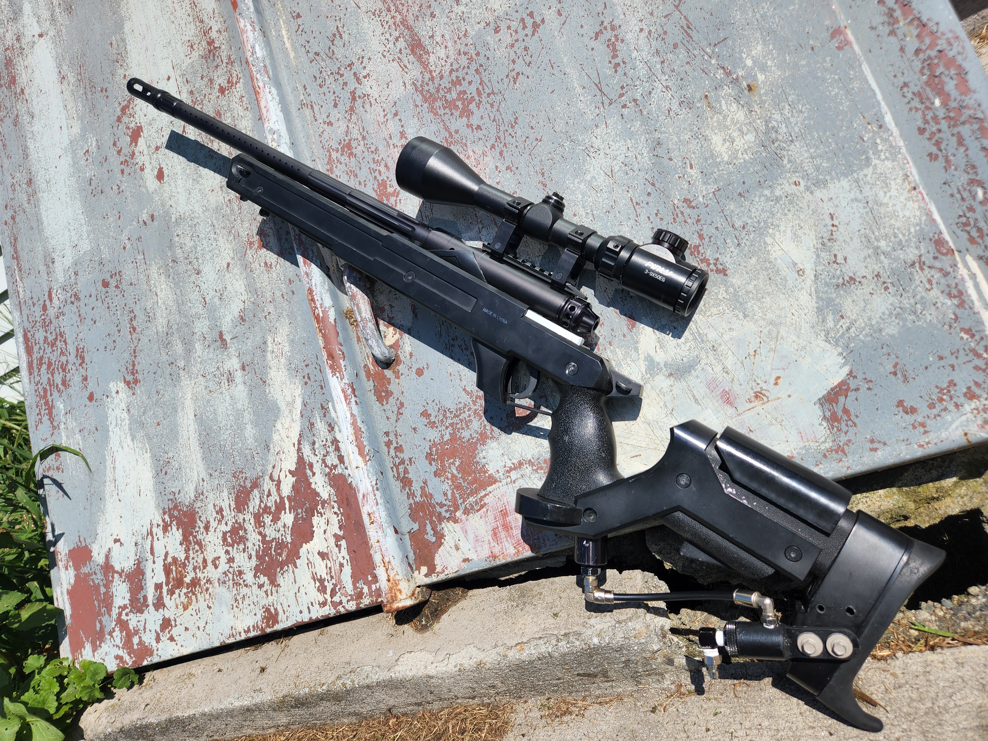

    I would say anything that fires consistently. I have shot FSR out of my modified PGP with great results. I also have my modded mech Ion rifle that shoots FSR beautifully, and it is whisper quiet with any ported barrel. I tend to use a Freak with .684 and the thing is super consistent, hardly any fluctuations in velocity. I hand load both. With the rifle, I'm just about as fast as any mag fed bolt action, plus if anyone gets too close I can jam paintballs right in, no switching mags, no need for a secondary either, so my rig stays relatively lightweight as I only carry a pouch and an air tank if I'm using the rifle, no air tank if I'm using my PGP.
    So basically anything you can jam first strikes in will work. Get creative with it.
