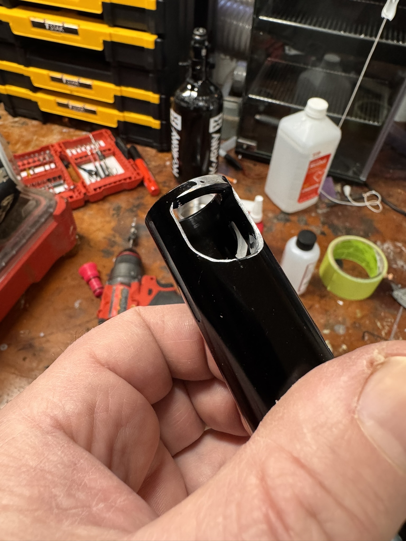

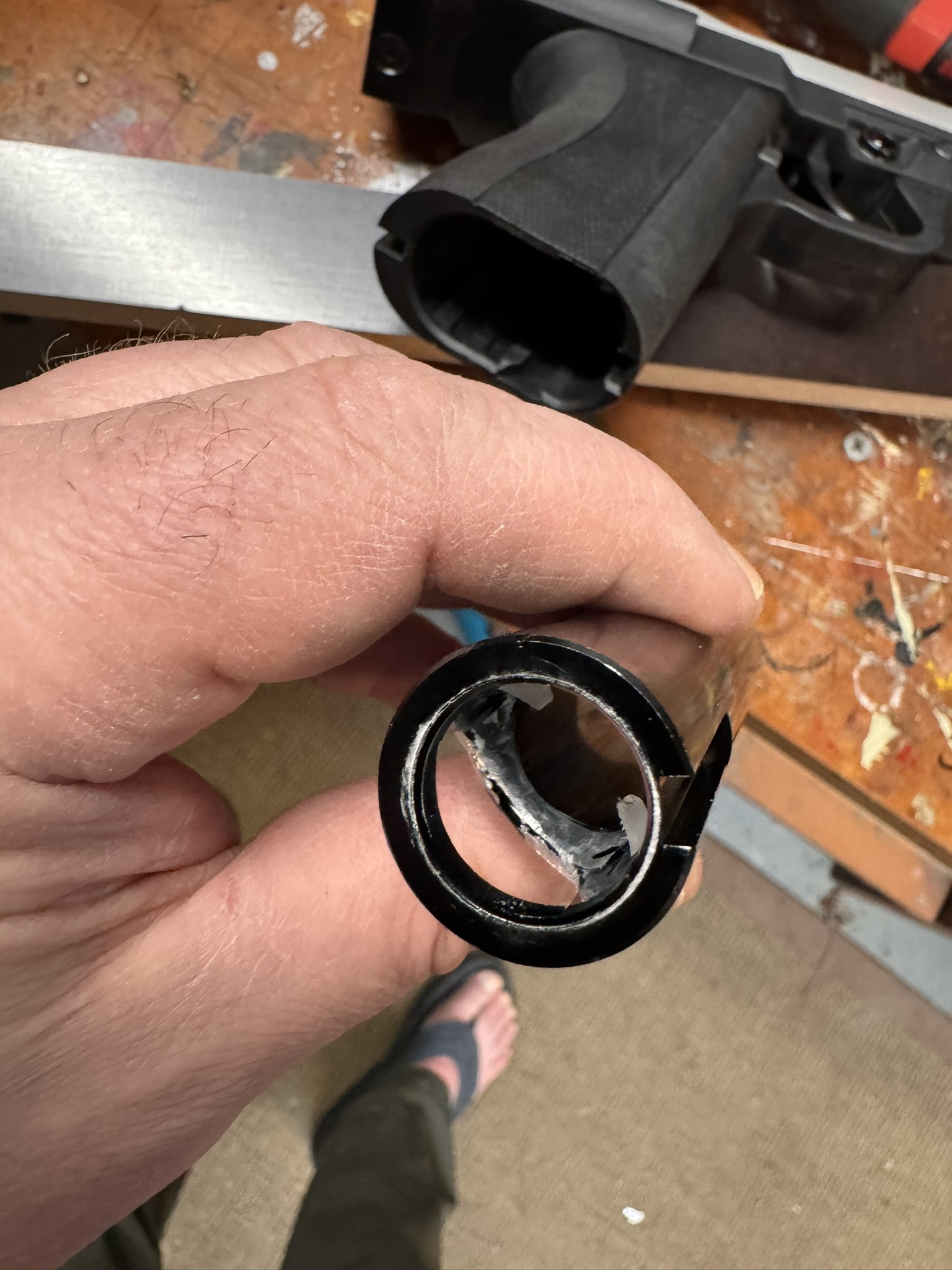

        Ok spent some time - (and$$$ - stupid 8 gram Co2's) and found some things out:
        #1 - smoothed out all hard edges of the breach opening in the barrel - to my eye this was where the issues lay. I started by not over doing it. and it had a immediate affect. shot 5 balls immediately and exploded the 6th, where I could not get past 2 before. pulled it apart and went to town making a nice smooth ramp and smoothing all hard edges. again - 5balls out with an exploding 6th - - reloaded and went again, and again - 5 balls out exploding 6th. could not see anything different when looking down barrel at 6th ball in breach. it seamed to be in correct firing position, velocity consistently 260, using Graffitti
        #2 filed a steeper ramp on bolt per L!mbo the FS bolt is already beveled but I feathered it out even more in one spot and reinstalled with that portion facing down. same as before 6th ball blew up. cleaned out, reinstalled, and this time put 5 balls in clip - and... success - after success after success. - 3 clips no breaks on 5th ball.
        conclusion... you can really only get 5 balls in that clip - why - I have no idea. beveling the breach area in the barrel works really well. beveling the bolt - not so much unless you go all the way around it - the bolt does spin over time. not sure that would cause the 6th ball issue the break happened in breach to, everytime - major mess.
        Idea #3 ... foamie on the bolt, but that seams like I would need to hog out a recess for it to get enough foam on there to be "soft" and not protrude to far into breach at rest.
        hope thats helps some people. these are cool pistols but fairly useless unless IMO everyones playing with one... the 12gram clip seams like a good investment.
