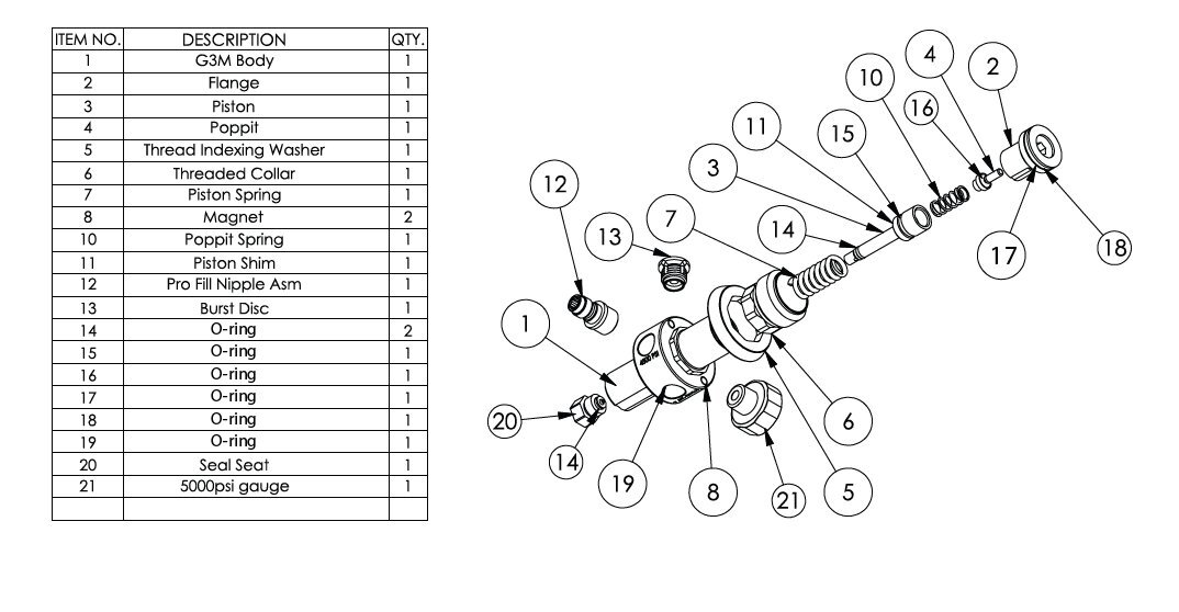

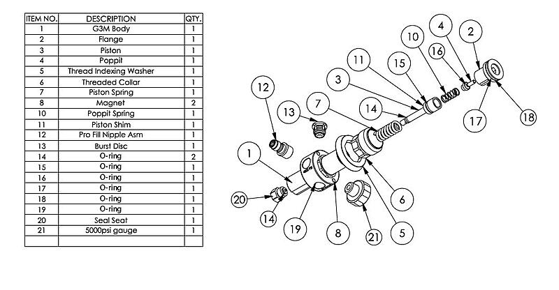

    Does anyone know the o-rings sizes for First Strike/Guerilla Air regs? Their user manuals are...disappointing. I have an M3 regulator and a Hero. Both need new piston o-rings. But the part list in the manual only says "o-ring" and doesn't specify what size.
    Seriously....look at this. Here's the M3 manual. I need to replace parts #2 and #3. This does not help me.
    Click image for larger version  Name:	M3 reg manual.jpg Views:	50 Size:	107.9 KB ID:	549757
    Updated 6/3/2024:
    #2 = 1.2x3mm V75
    #3 = standard size 010 Polyurethane 70
    #4 = size 004-P90
    #5 = size 012-B90
    And here's the Hero manual.
    Click image for larger version  Name:	FS regulator Hero.jpg Views:	89 Size:	82.4 KB ID:	549756Update 6/3/2024:
    #19 = reg to bottle seal o-ring 015-B70
    #18 = standard bottle oring
    #17 = inner flange o-ring 012-B90
    #16 = 004-P90 (poppit and fill nipple o-ring)
    #15 = 010-P90
    #14 = 1x3-P90 Metric ​

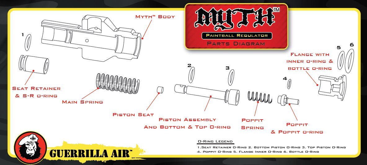

      Almost forgot. I did find this too on another forum:
      "Guerilla Air Myth G2 air regulator orings
      Piston seat 010 b90
      Piston, lower 1x3 b70
      Piston, upper 010 p70
      Flange,lower 012 b90
      Flange,upper (tank oring) 015 p90
      Fill nipple strut 006 p90"

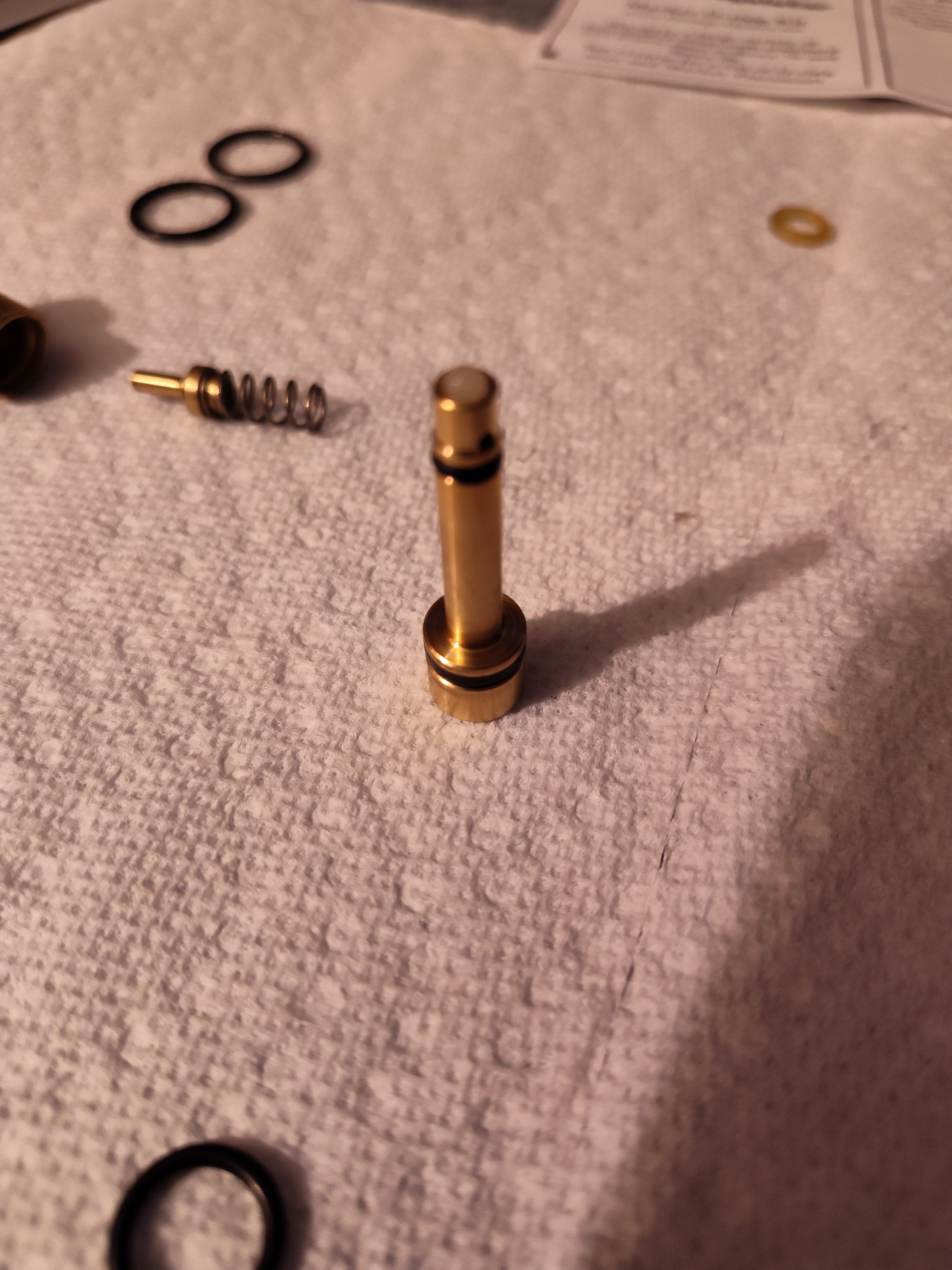

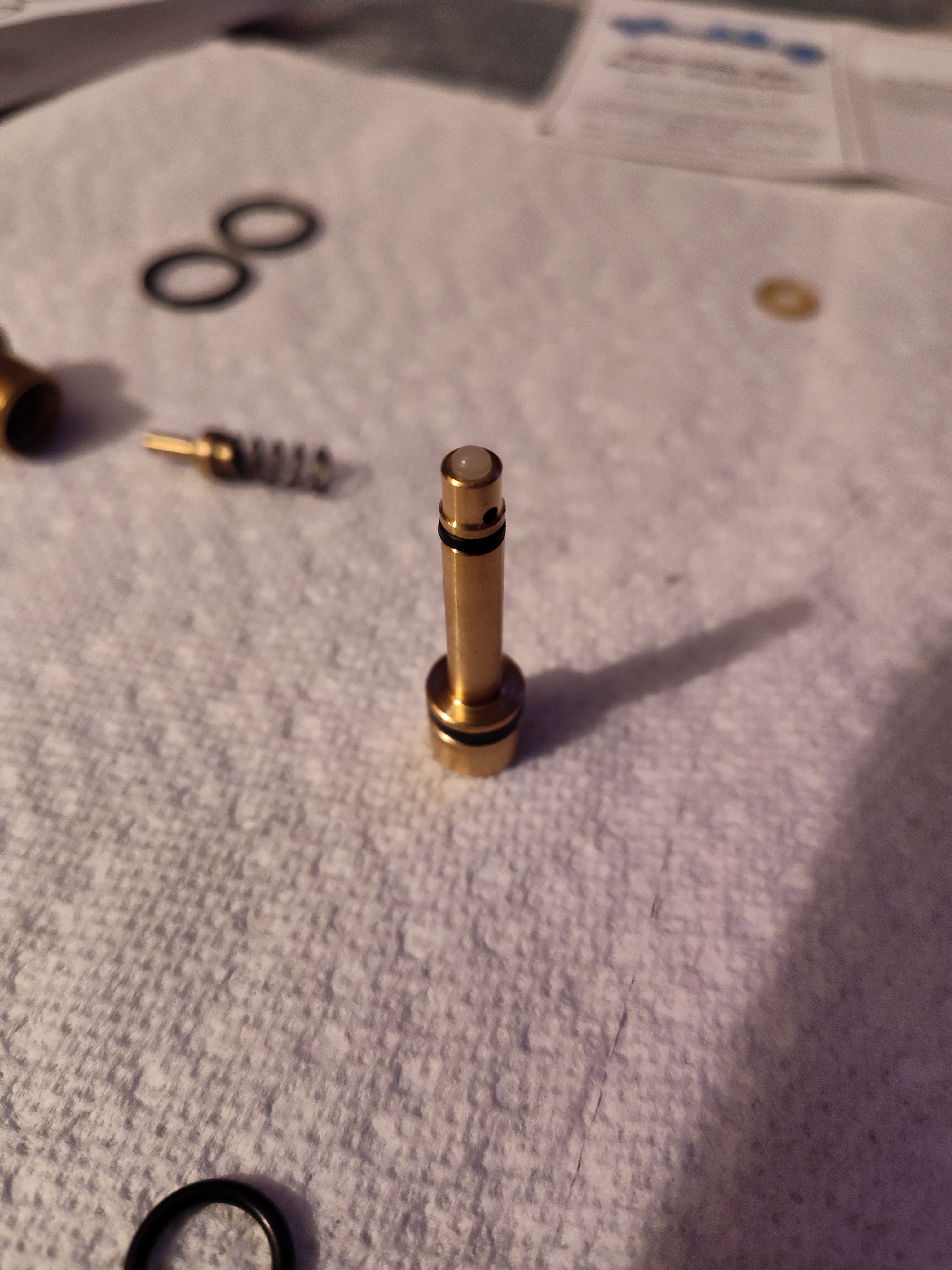

                  Installed the o-rings this weekend. The 1x3mm o-ring recommended for the piston does work for the Hero reg, but it does NOT work for the older M3 regulator. It leaks immediately. I happened to have some 1x3.5mm o-rings to try as well, and those seemed to work better. They didn't immediately leak anyway. But they're loose on the piston (because the ID is too large, probably), and when I checked back after a few days the tank had lost some air. So I don't think that's the right size either.
                  I'm going to try 1.5x3mm next. I can't find that size in polyurethane, sadly, but I ordered some buna ones from eBay. We'll see how that goes.
                  • rawbutter
                    trophy husband
                    • 562
                    • Fredericksburg, VA
                    Well, crap. The 1.5X3mm o-rings also don't work. They're too big. When I screw in the regulator cap, the inside of the regulator shears off part of the o-ring.
                    It seems like I really need something like a 1.25x3mm o-ring, but I can't find anything that size anywhere. Next I'm going to try 1.5x2.5mm. Maybe if the ID is too small, the o-ring will stretch a little, shrinking the cross section enough to fit inside the regulator.

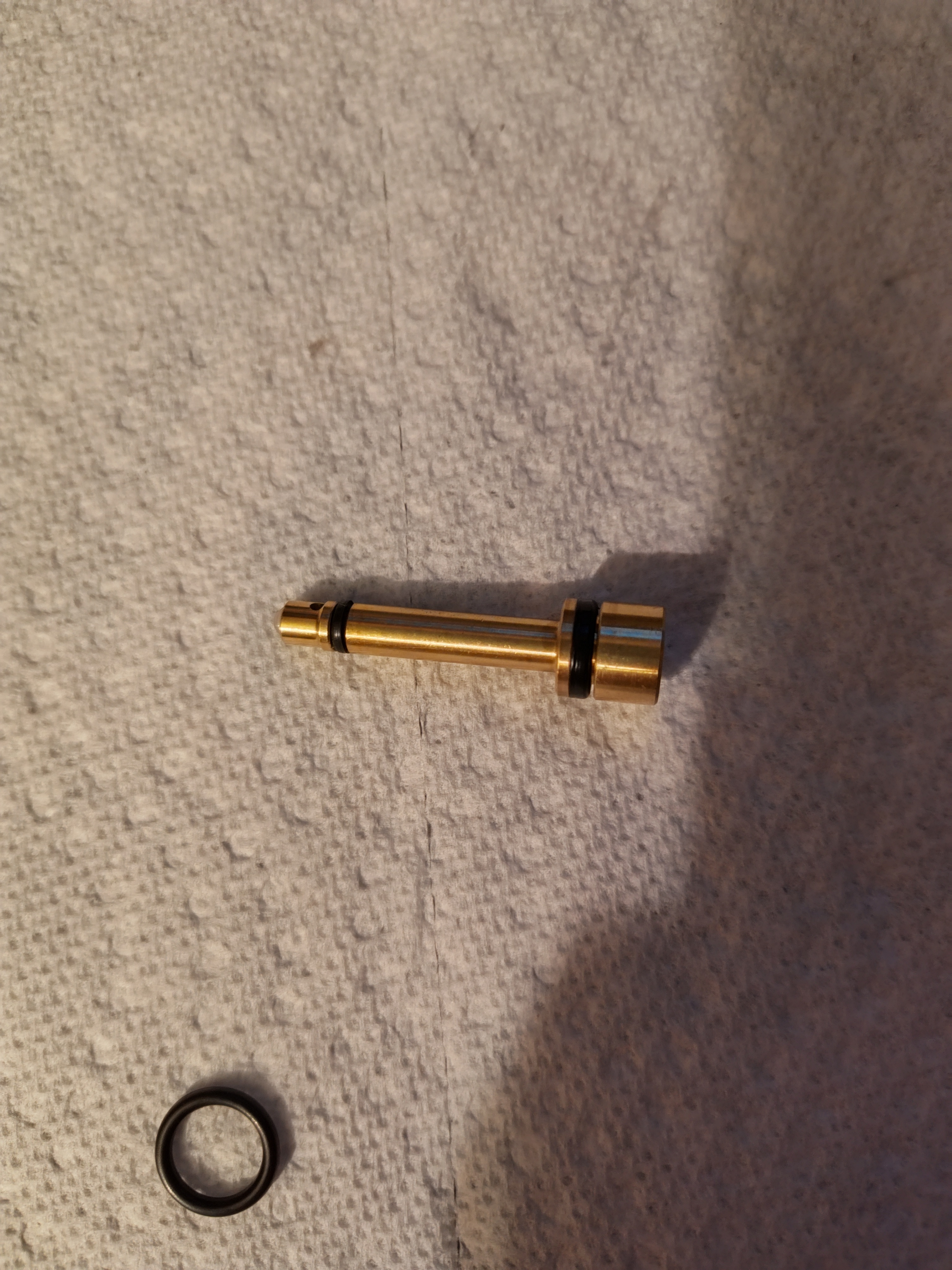

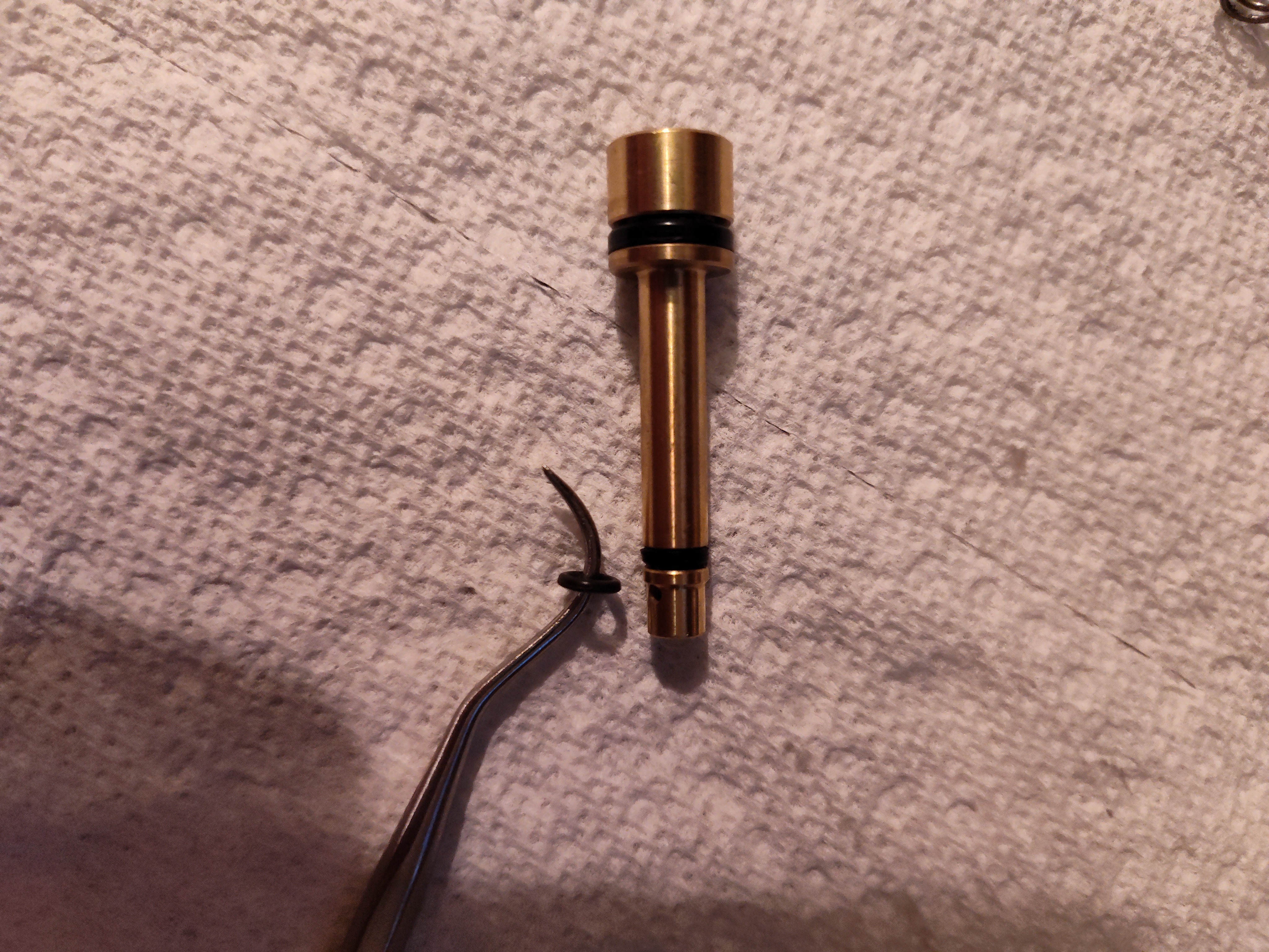

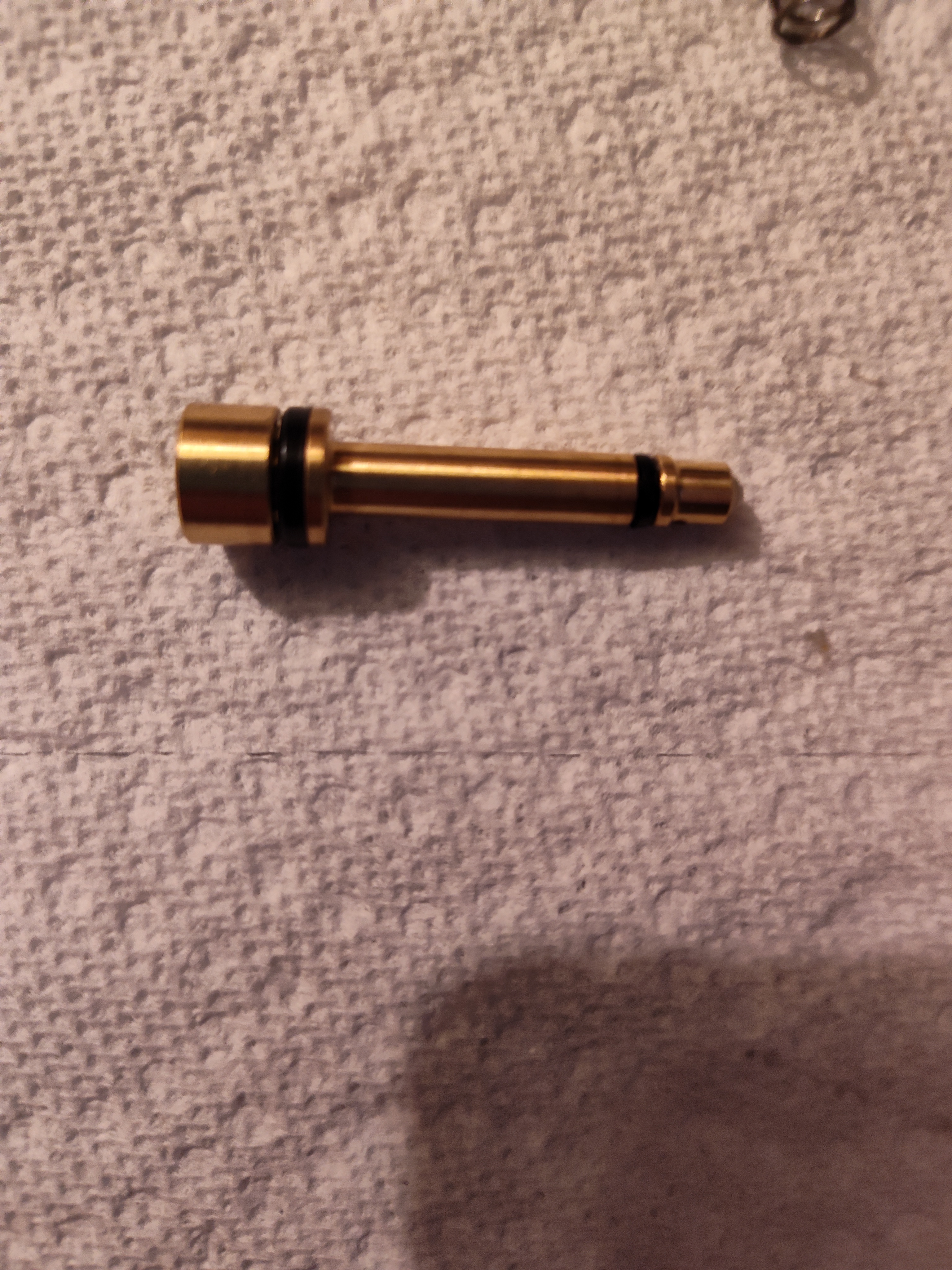

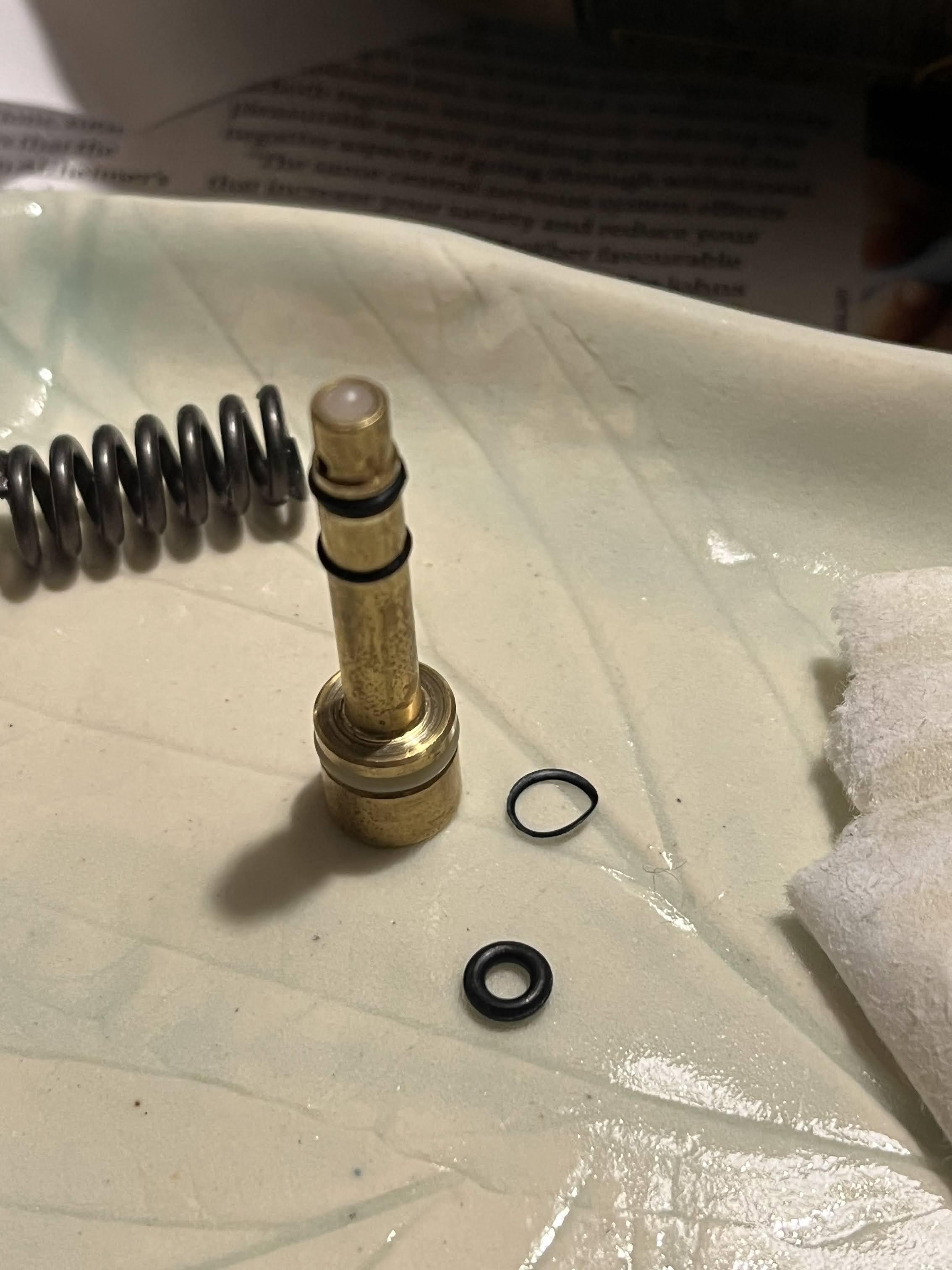

                        rawbutter I have two Myth regs nether are what you have.
                        -The first one have looks older. The bottle (13ci) is from 2000. It has the non pro burst discs and the orings look to match the 1x3.
                        -The second is closer to yours and is off a bottle from 2012 with pro burst discs. TBH I might just drop the bottle being so close to end of life and the bonnet threads some times bind up on certain ASAs. Anyway... the rings look to be more square than O shaped. I hope you enjoy my excellent photography skills... There is a shot with a 1x3 from the other reg for reference.
                        Love Feedback
                        YouTube: loveaboveall143
                        • loveaboveall
                          loveaboveall commented
                          I forgot to mention there was so much grease in the 2012 pro burst disc reg. Like globs.
                      • rawbutter
                        trophy husband
                        • 562
                        Originally posted by loveaboveall
                        The rings look to be more square than O shaped. I hope you enjoy my excellent photography skills... There is a shot with a 1x3 from the other reg for reference.
                        Those are great photos.
                        I also thought the rings looks more square than circular. I thought perhaps it was because they were so old/worn, but maybe they actually used square o-rings.
                        The larger piston o-ring should be a 010. Square rings for that size are easy to find. Here's one from The O-ring Store.
                        But again, the smaller size is the real problem. I'm having a hard enough time trying to find standard o-rings that will fit, let alone square ones. These 006 square o-rings are close, but they're very similar in size to the 1.5x3mm o-rings I already tried, the same ones that were cut by the regulator when I screwed in the flange. So they probably won't work.
                        Still, I might give them a try if everything else fails. But for now I'm waiting on the 1.5x2.5mm o-rings and a few other similar variations. Let's see if any of those work first.
