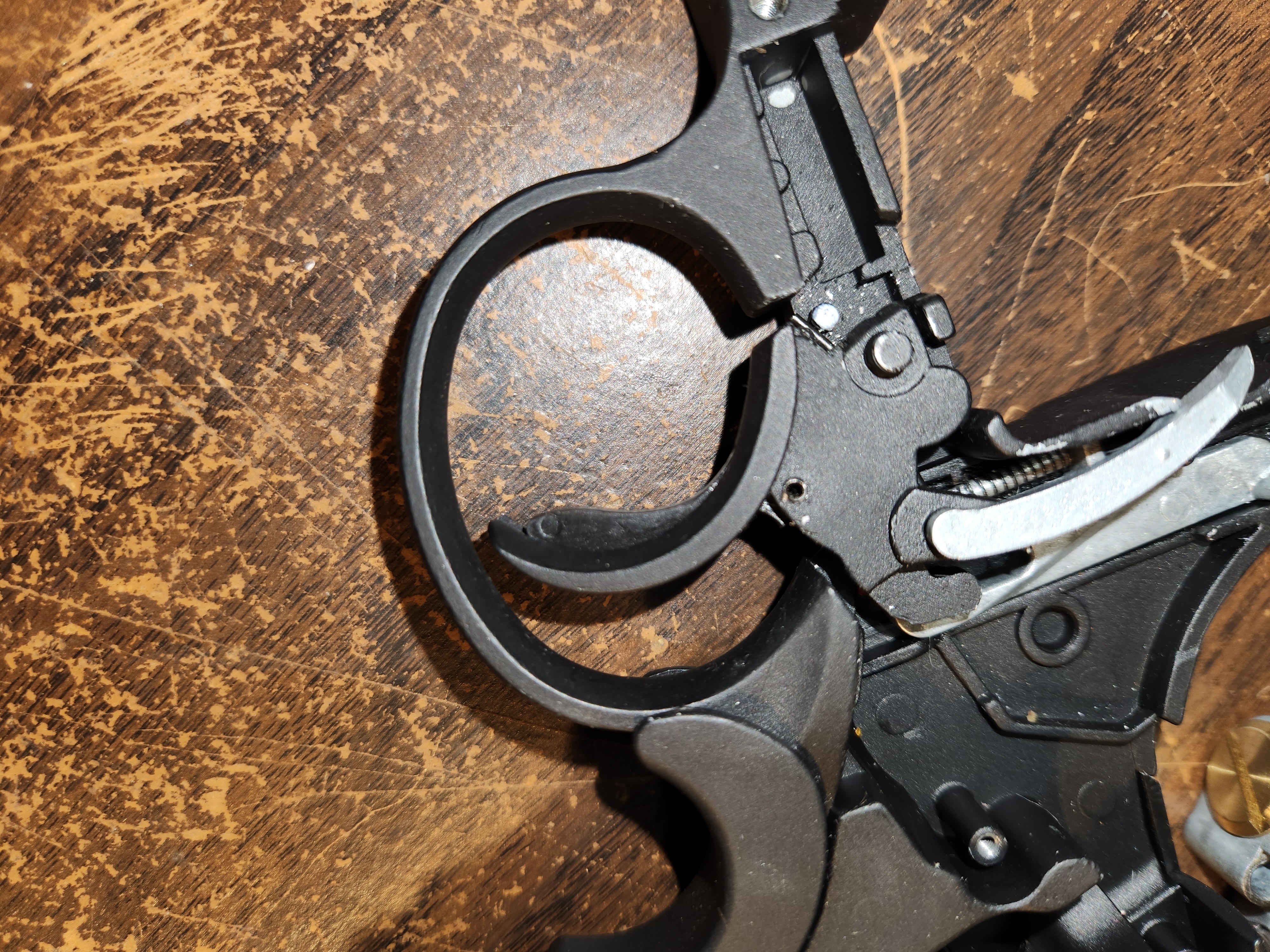

    Pic 1 is the right frame with the trigger spring peg painted white

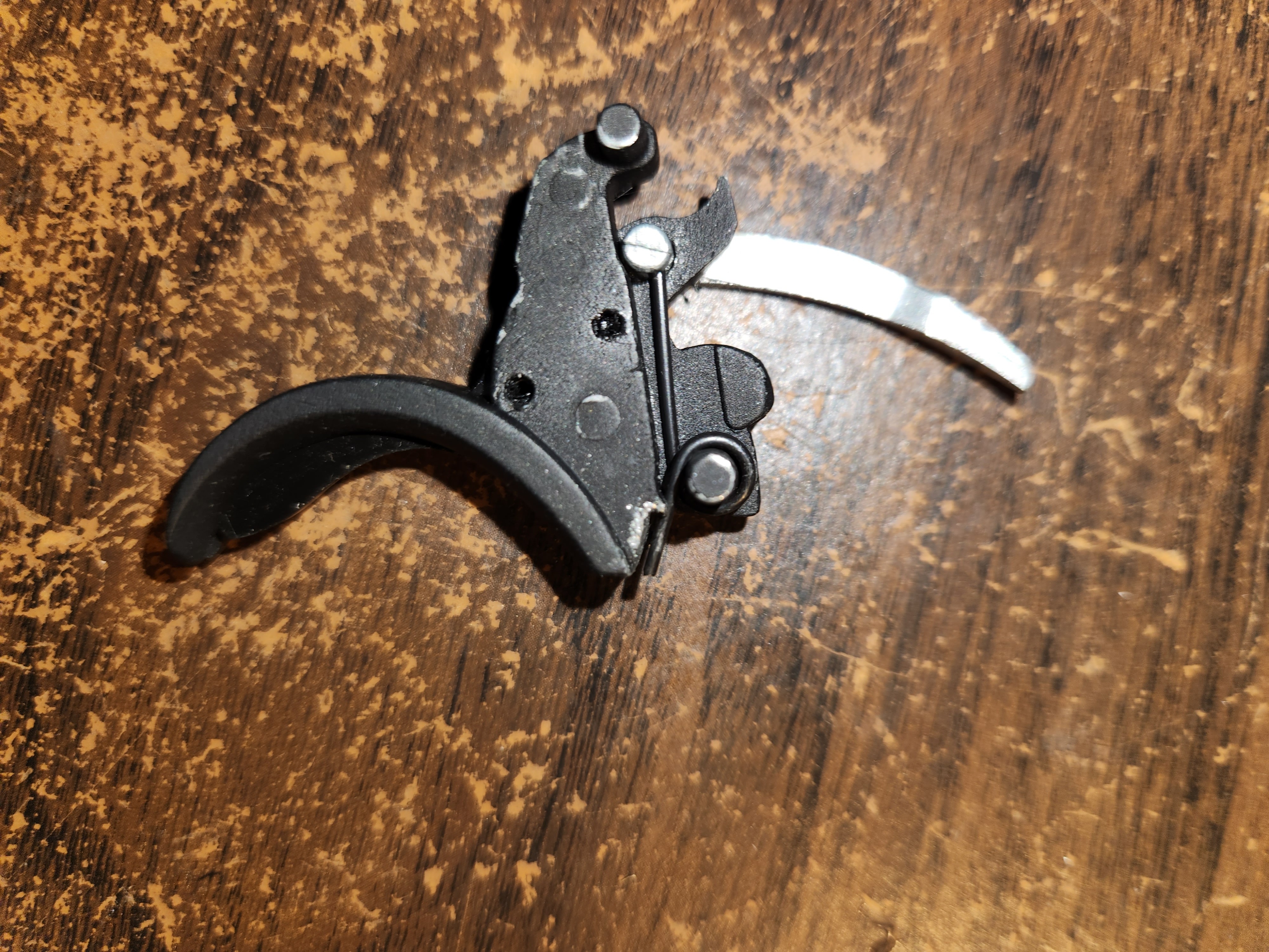

    Pic 2 is the trigger assembly spring in place, less the detent

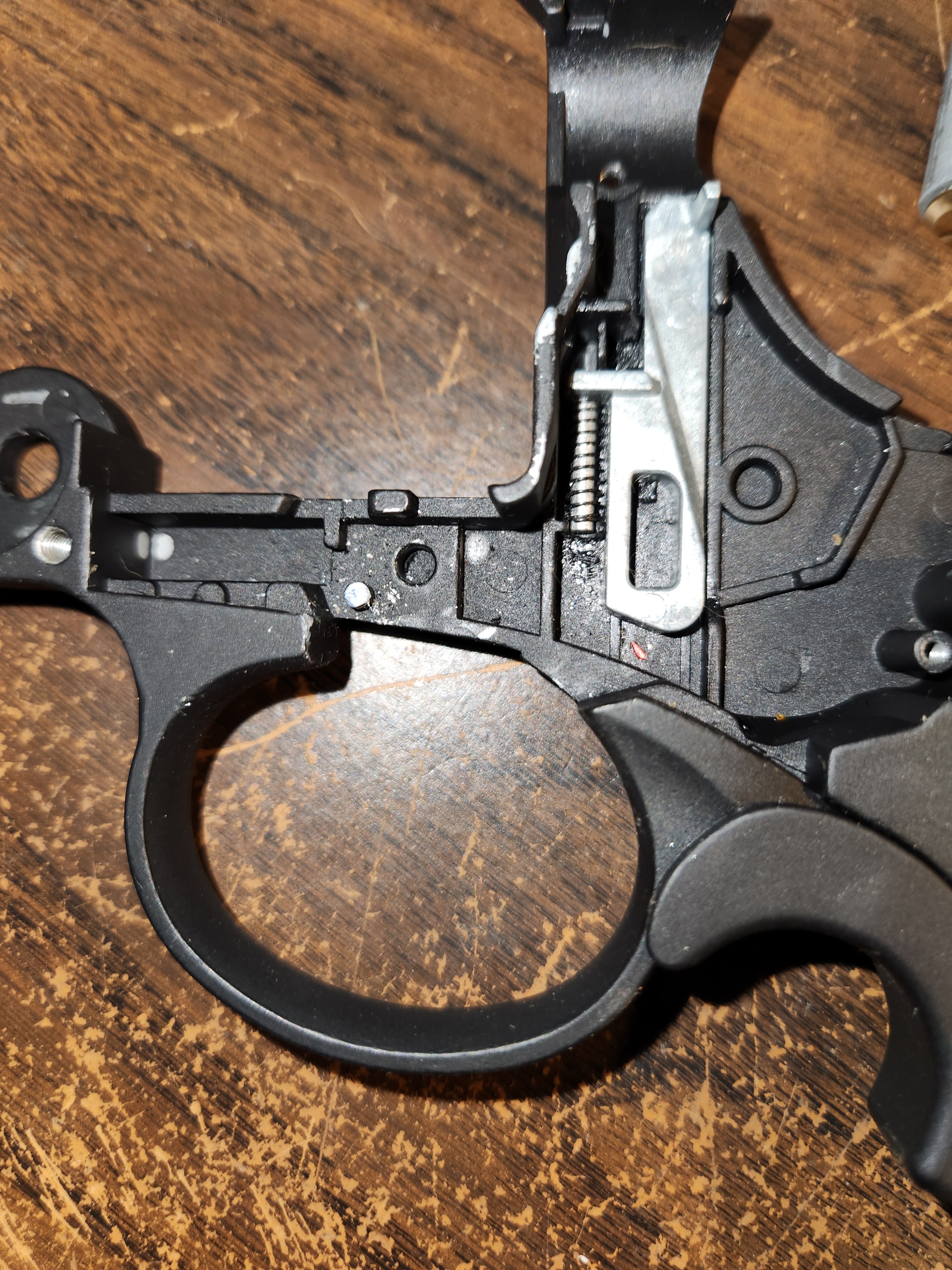

    Pic 3 is the trigger assembly in place. You can see the front tip of the trigger spring under the white pin not on top where it needs to be.
