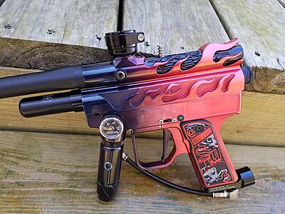

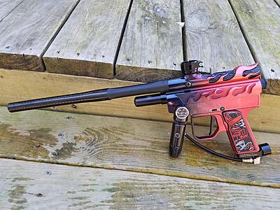

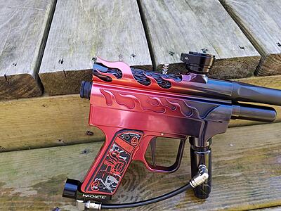

    • Walker
      • 1590
      • WA State
      FSP and a Fox

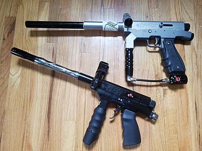

        • 3508
        #18

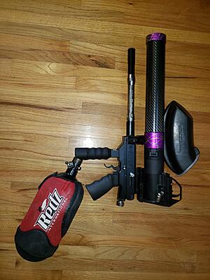

        ICD Thundercat with stock barrel modded to fit an Apex tip, CCI .45 frame block with Hogue wraparound grips, internal mods to run on HPA, PTP elbow, PMI gas thru grip, MacDev on-off and drop rail.

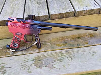

          GS Flame Bushmaster
          Due to the difference in milling from the production model and the additional top tube insert milling, I believe this to be a prototype. I have only ever seen one other milled this way but it had an Aftermath milled tray (I have no idea where it currently resides, only seen a picture in a Google search). So it's possible this was a proposed team gun. I personally picked it up as a body kit.
          PPS LPR
          AKA 2 Liter
          Zenitram 15° ASA
          Zenitram Frame and Trigger
          Vapor Valve and Bolt
          Kila Promaster Board

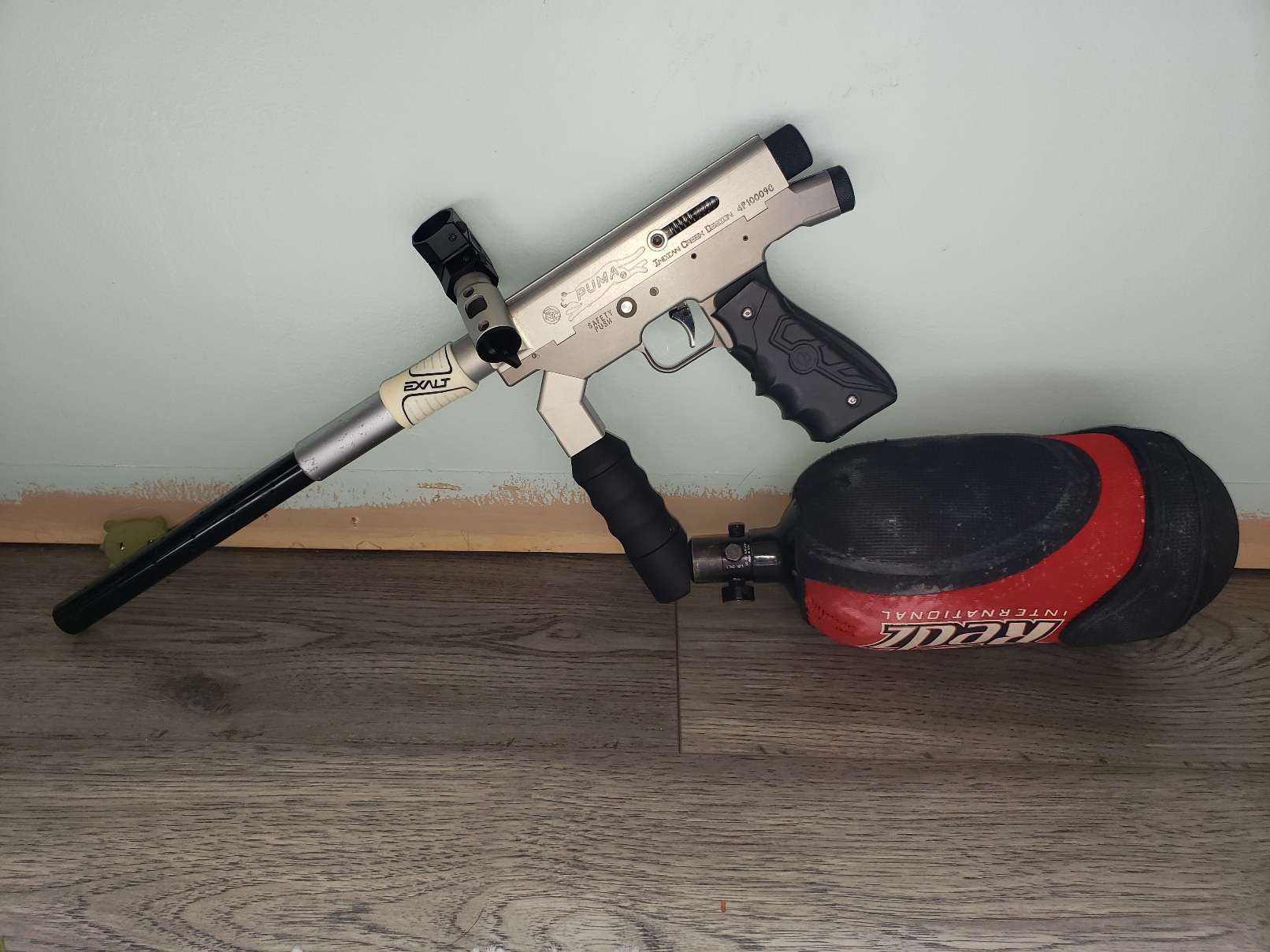

            Puma
            Sconi elbow
            OG AA barrel
            Rtr humpback frame
            Pro Team Intruder gas through.

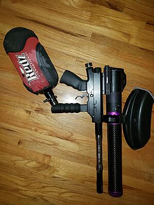

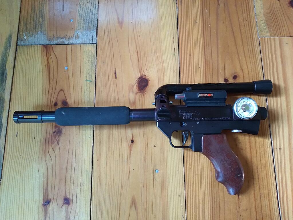

              #23

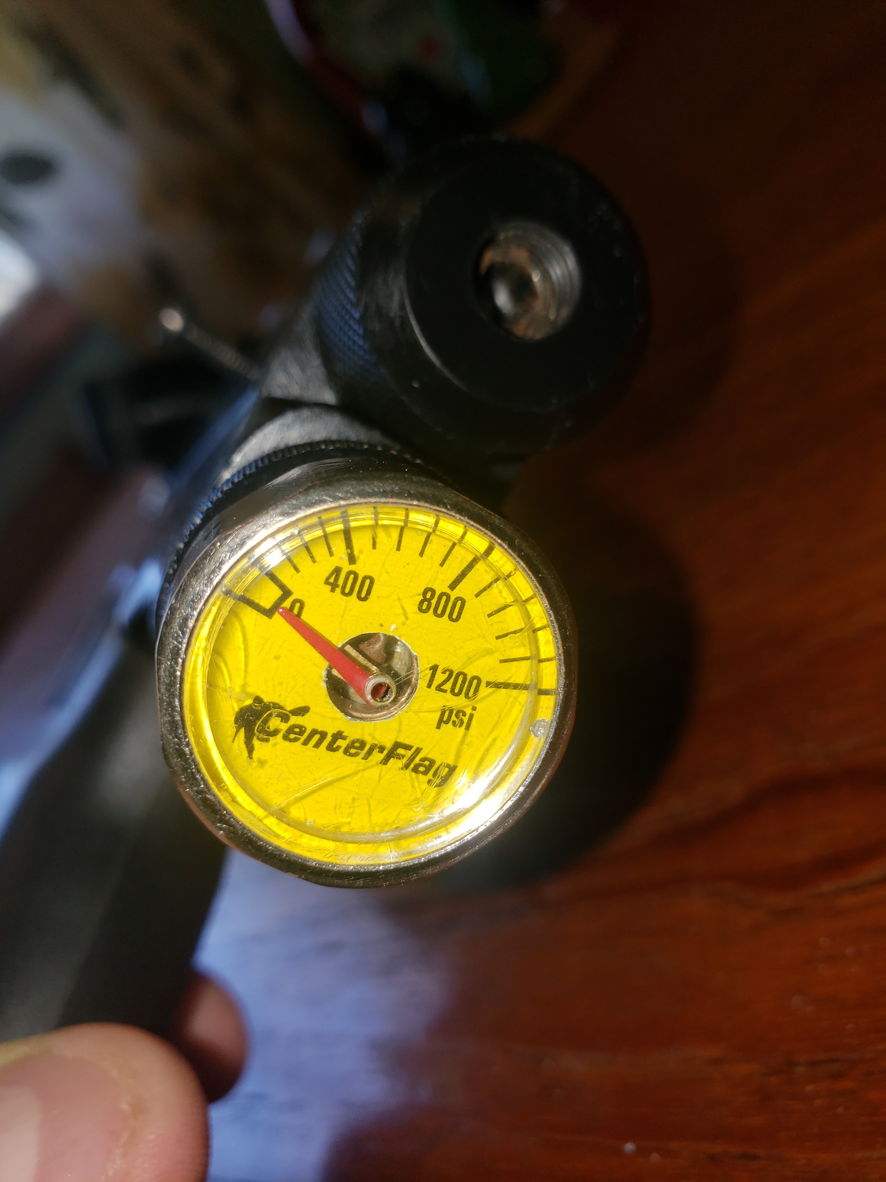

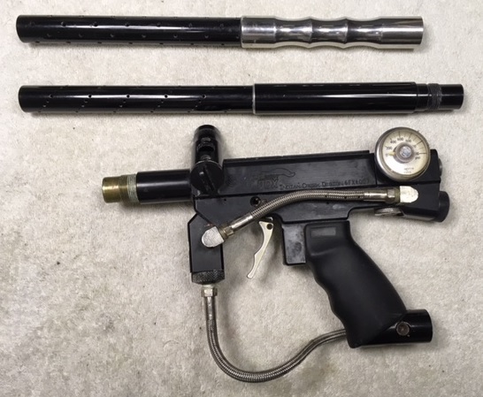

              New to me "parts cat" i got from ironnerd.
              It needed a barrel, well that was the main reason I wanted it as I previously got a dye Ti barrel for my puma, to figure out my puma has old school panther threads and the ti barrel was a bust.
              It was missing a feedneck screw, added a stainless grip frame panel screw from my stash.
              The delrin bolt was super tight in the body. Bottle brushed the body out, and took a 3m scour pad to the bolt til it moved freely.
              Missing the feed plug. I had an old automag body sitting around that I robbed for the plug.
              Had a cut feedneck making normal feednecks hard to use. I had a sconi feedneck on my puma I robbed, I got a second one.
              Missing the cocking lug. I added a 10-32 socket head bolt and custom turned sleeve ( not pictured)
              Missing the air input plug. I added a remote line adapter, and rather than just plug the hole, I added an old school centerflag gage just for laughs.
              not sure if I wanna run another armson bottle drop situation, or bottomline one cat, and armson drop the other, but Ill update when I actually buy some parts for this beast.
              Either way, I got it cycling already. Pretty stoked to have 2 cats in my fleet.

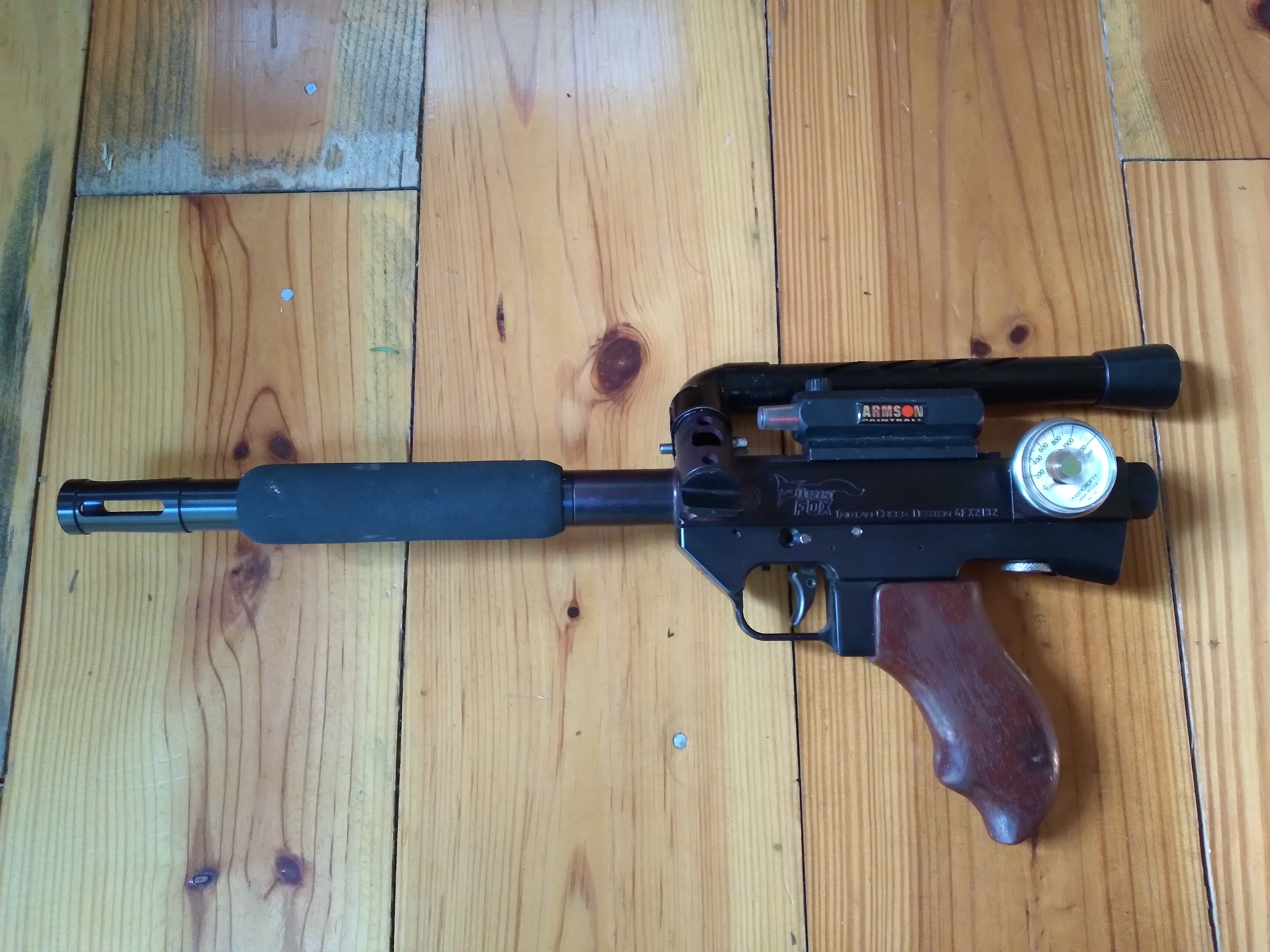

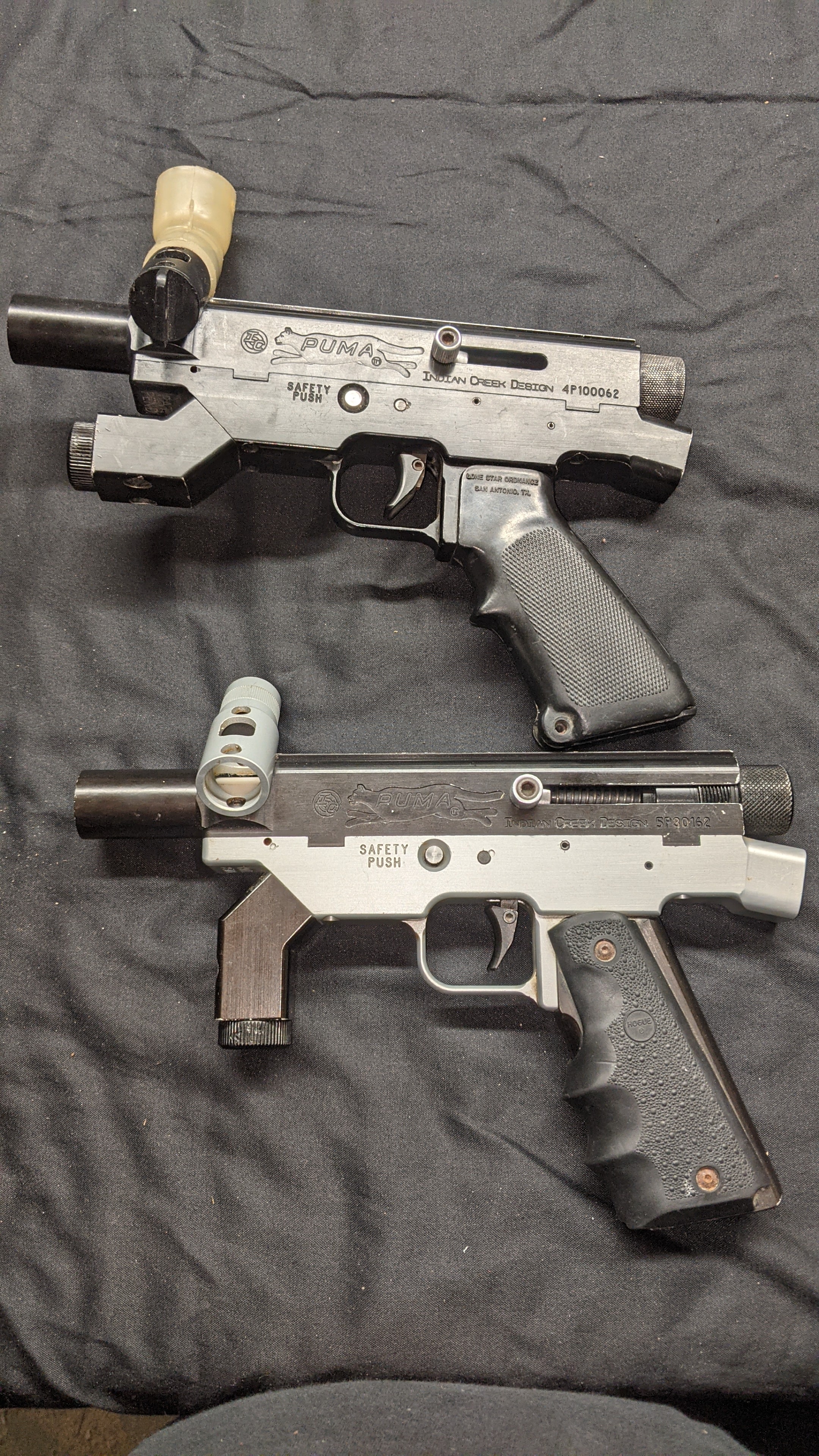

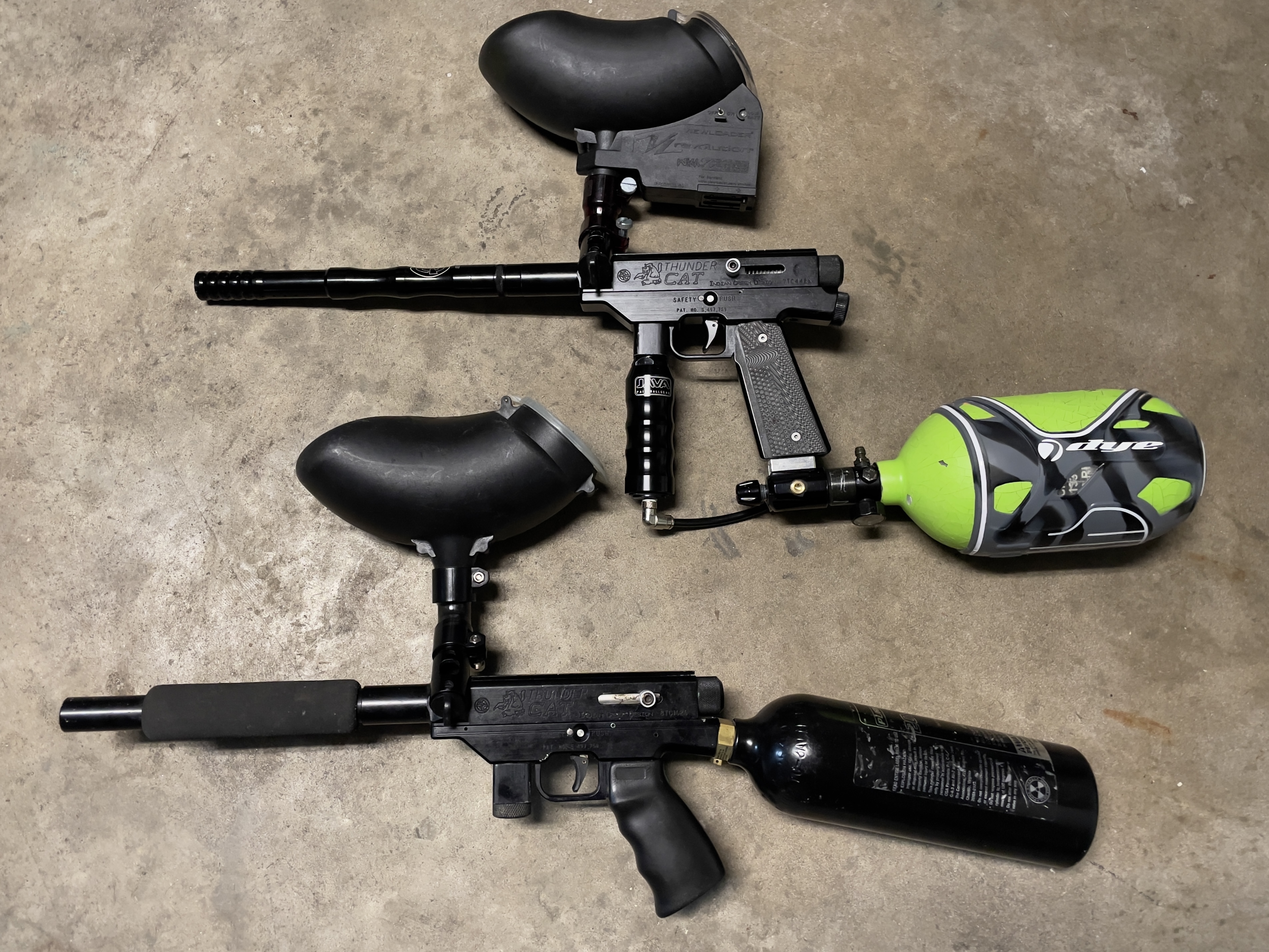

              #24
              Okay. Got some parts swapped arounnd to try something new. Gave the puma a traditional bottomline with its wider grip, and gonna try the armson mount on the tighter alley cat. Found this sweet shipping bolt from ny wifes new office chair and now I think Ill just turn an aluminum sleeve at work to make the bolt with a splash or red work.

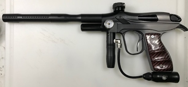

              • 3508

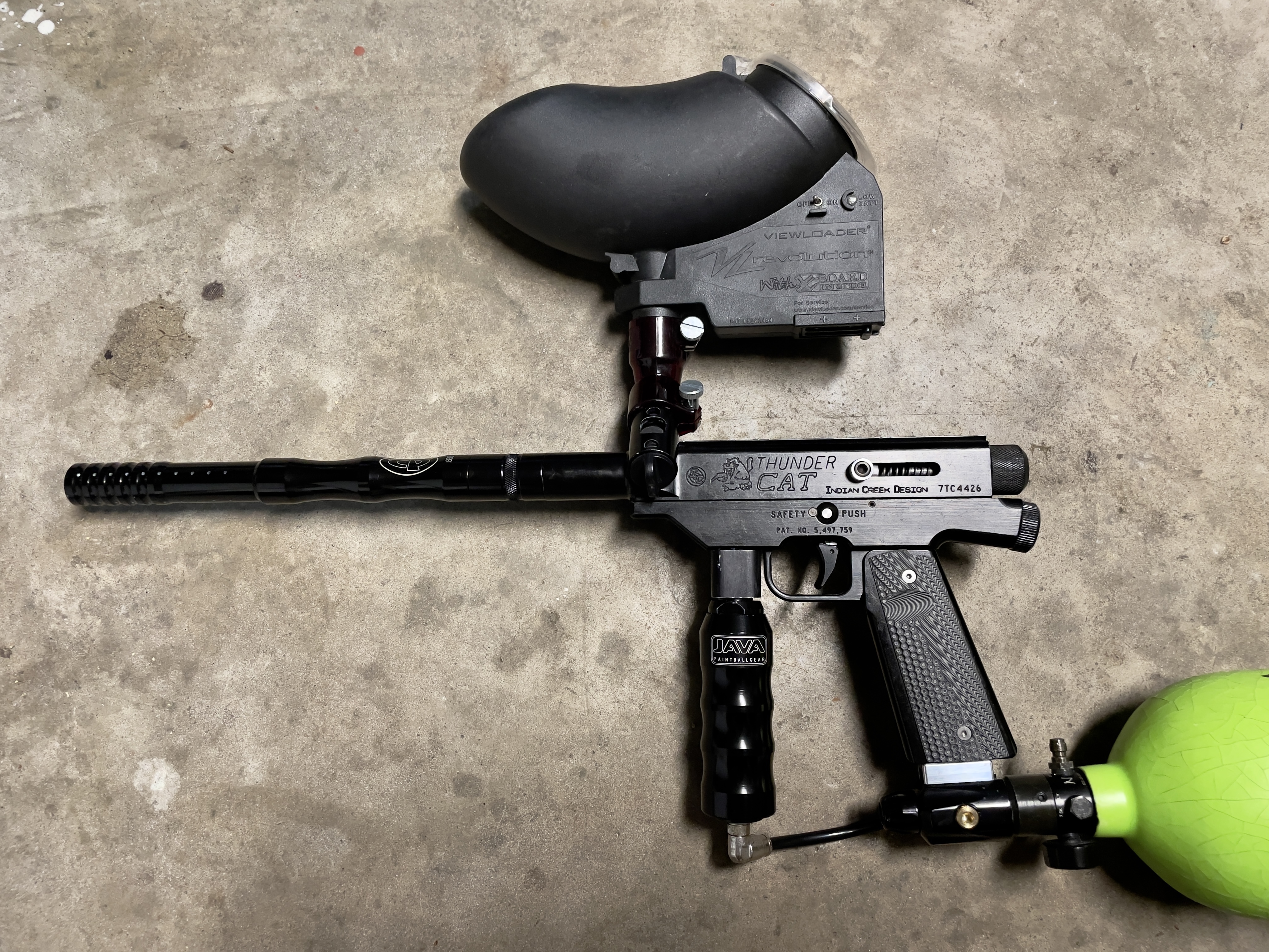

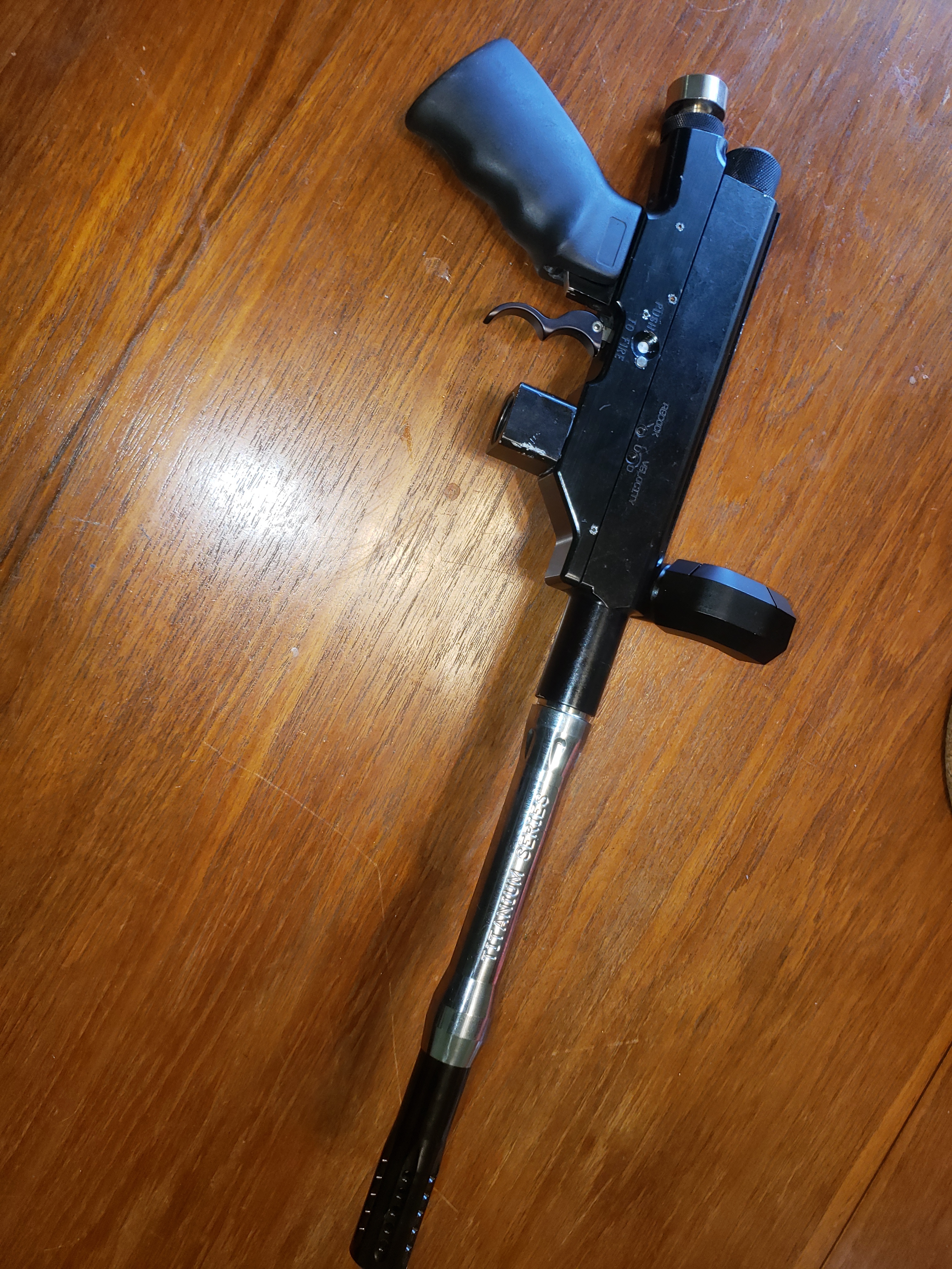

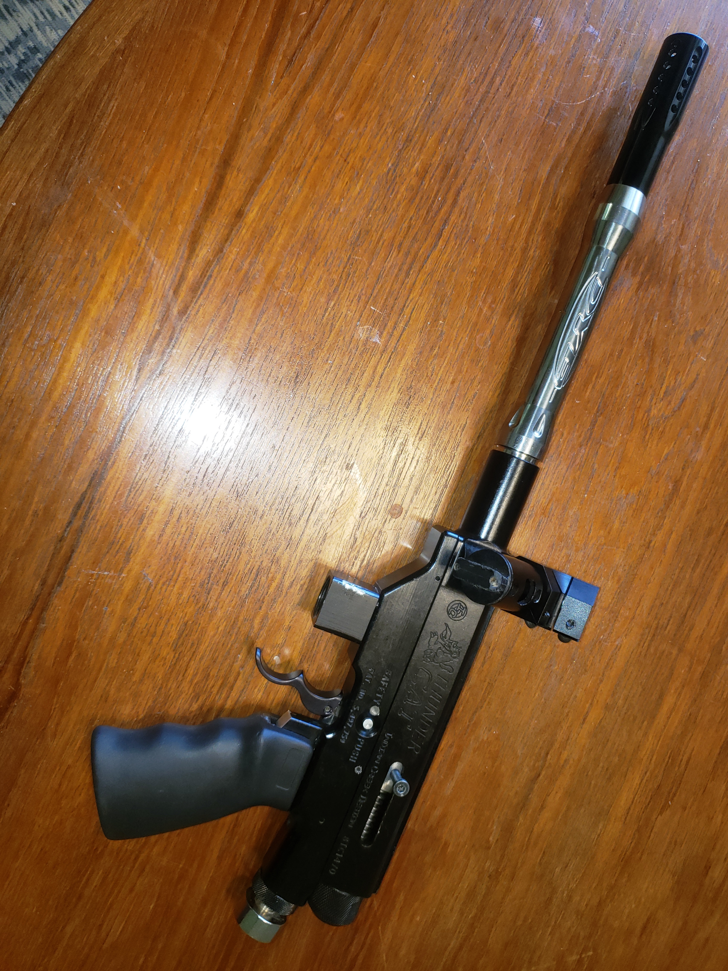

              #28
              ICD Freestyle Pro
              - MicroRock
              - Hyper2
              - .684 Ultralite
              - HR1 bolt
