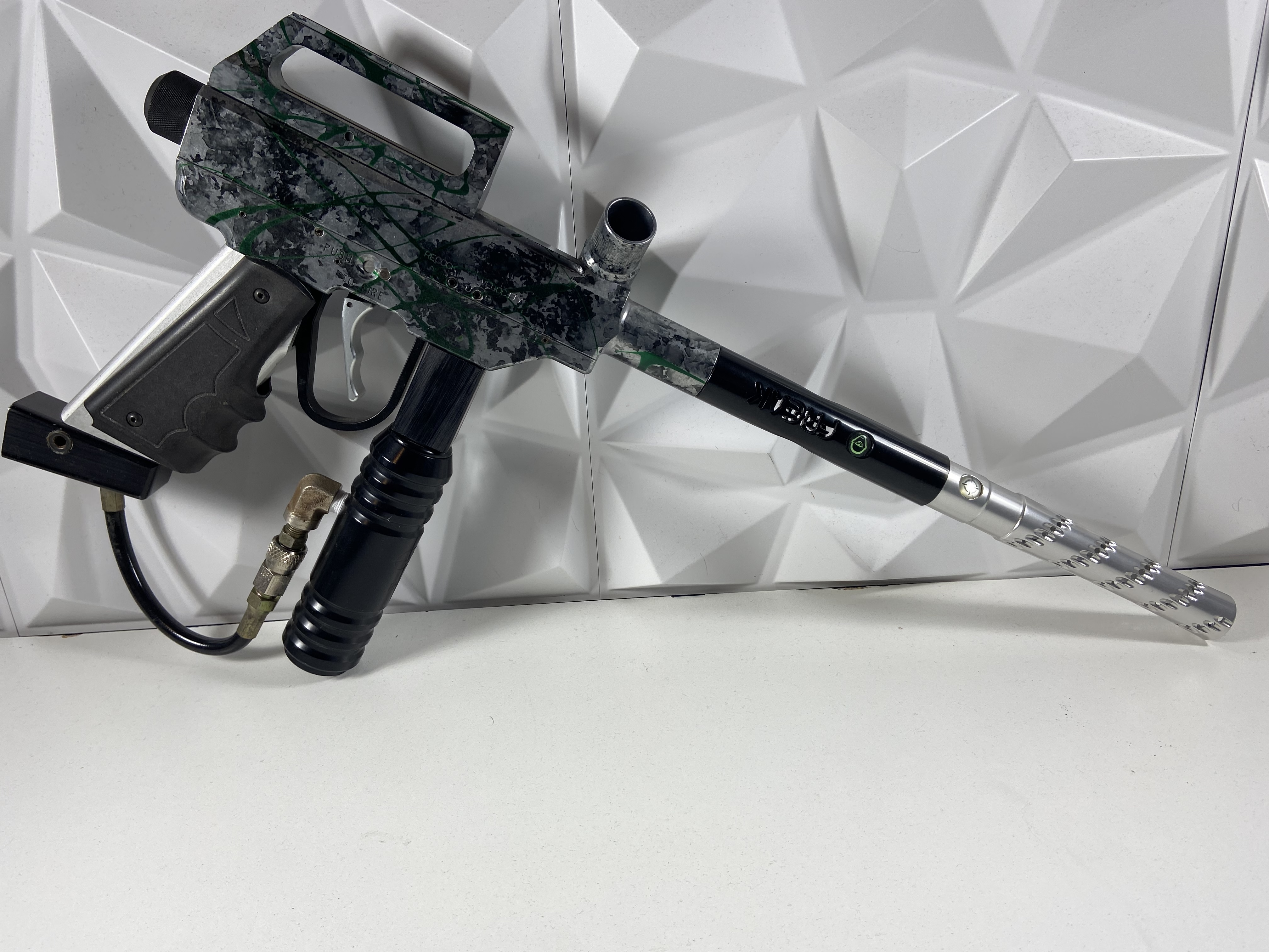

        the smart parts freak barrel has worked great for me on my alleycat deluxe
Name:	thundercat deluxe.jpg

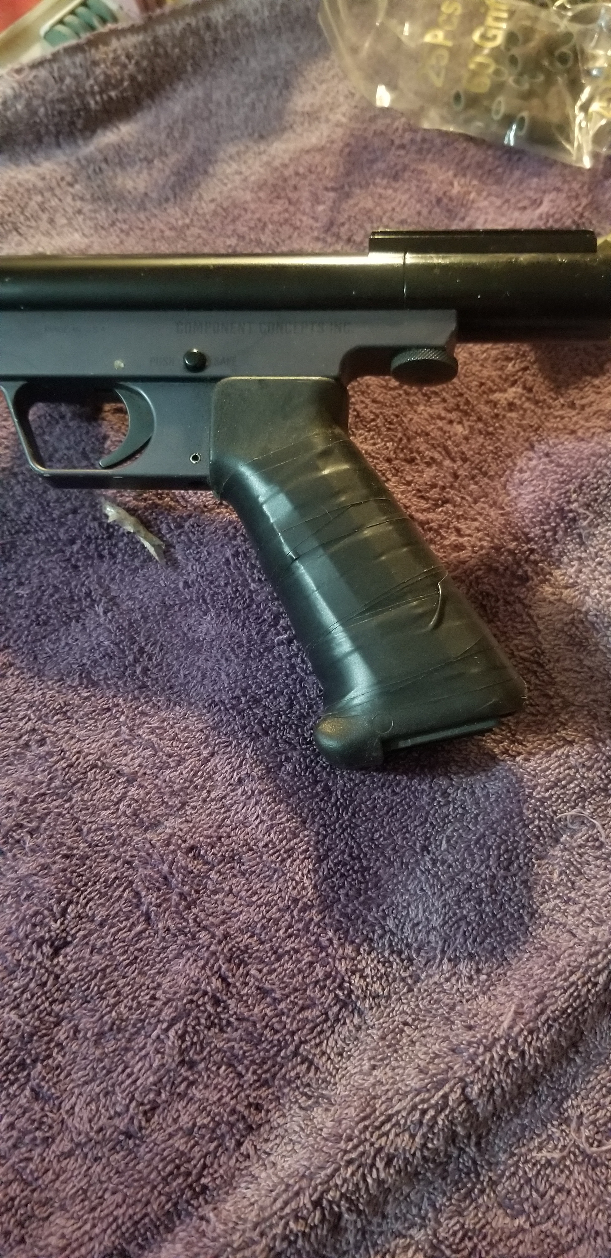

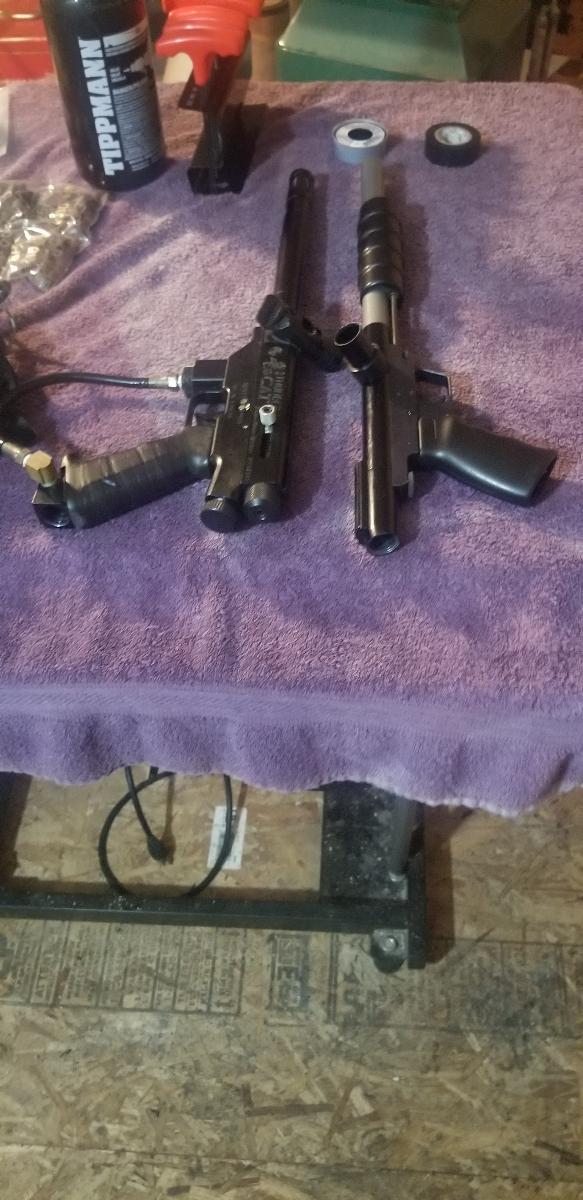

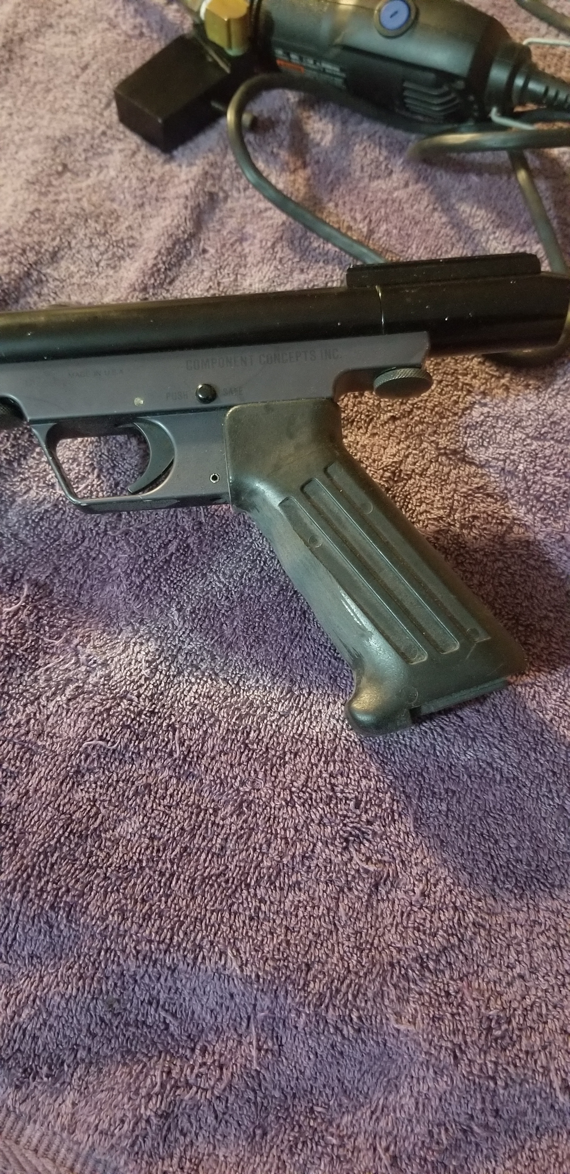

                Most of what held me back was the high cost of CCI grip frames, and I needed two of them; one for my Phantom pump and one for my Thunder Cat. Recently I realized a very simple fact...my Phantom has a bottom-line on it, and those grips are swappable. Click image for larger version
ID:	503992 Now, what held me back from using the Phantom's stock grip was how I didn't like it. That damn finger groove and the strips on the sides always bit into my hands. But then I also realized that grip is just a piece of plastic, and I own a Dremel.
ID:	503993 A quick wrap with black tape and the grip was ready to install on my Thunder Cat.

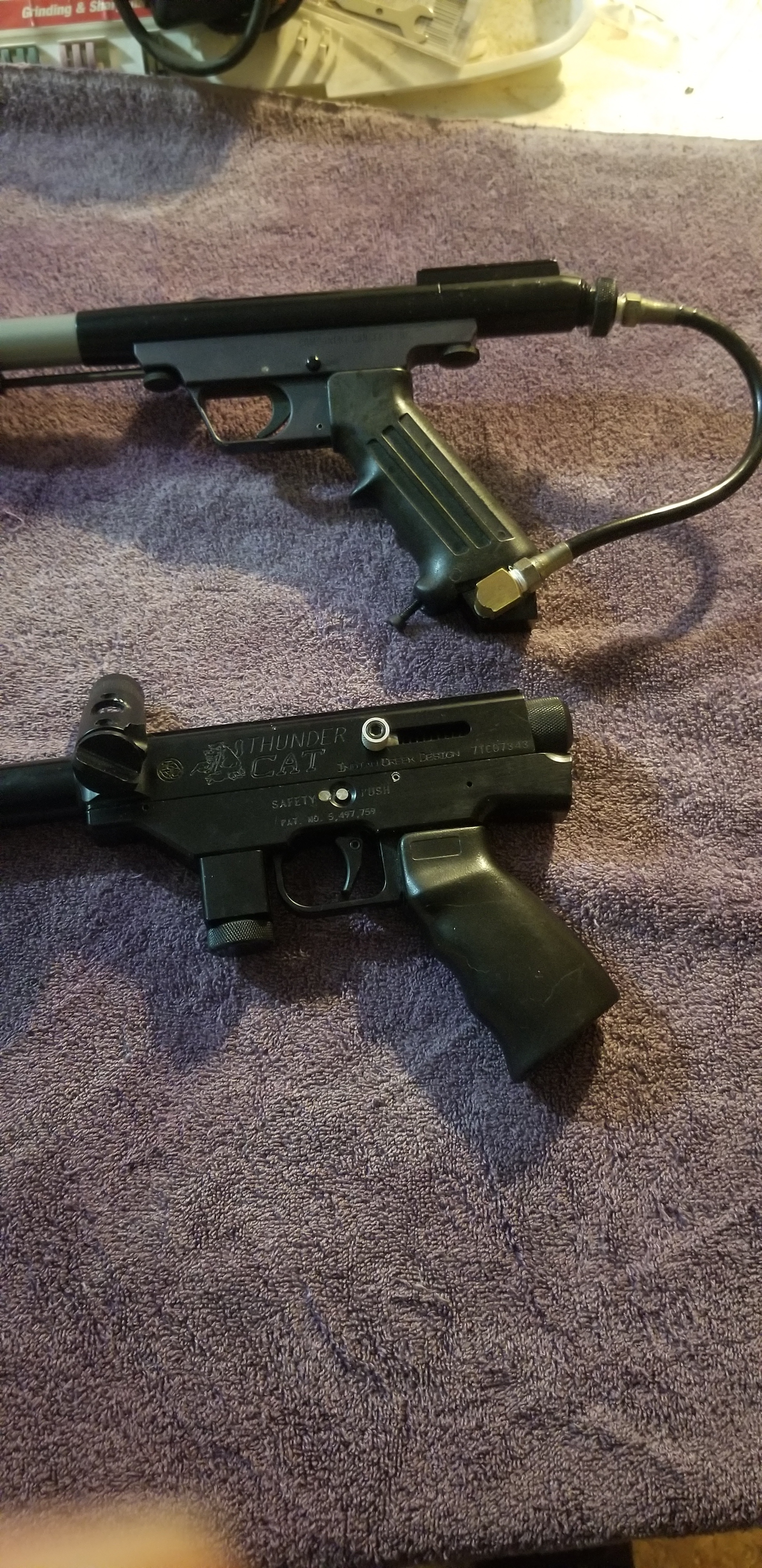

ID:	503994 Some work with an Allen set later, and the grips/bottom line swapped just fine. Now, I did have to take a fitting out of the bottom line, adjust the angle and redo the Teflon tape, but after a bit of testing I've determined this will work for now.
ID:	503995 I plan on doing a proper gas-thru front grip on the Cat at some point, but for now this should work fine. Again, saves me the purchase of several things.

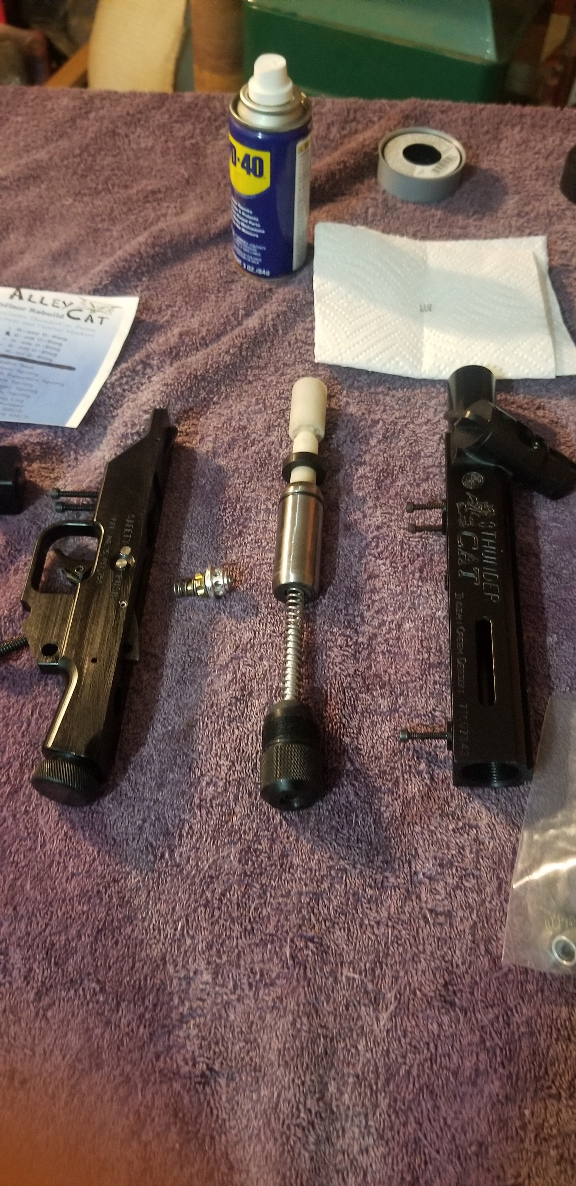

                  Next, I stripped the Cat down as best as I could figure out using ICD's exploded parts diagram on their website and opened my rebuild kit.
                  At first everything went well; I was able to replace the bolt O-ring no problem (it had fossilized into plastic) but after that...yeah. ran into problems. Click image for larger version
ID:	504021 For one, I cannot figure out for the life of me how I'm supposed to get to the trigger/sear springs. Is there a connection between the trigger guard and the lower assembly that I'm missing?
                  For another, the ICD manual is so blurry that I'm not sure what O-ring goes where. I'd like to think I did a good job matching sizes with the bolt and powerfeed o-ring but I might be wrong.
                  Also, the diagram indicates an o-ring that should be between the vertical gas feed and the lower assembly that doesn't seem to be in my kit; none of the o-rings in there seem to match. To me intuitively, an o-ring should be there. But I can't figure out which one.
                  Lastly, damn y'all...the new mainspring is hella snappy. Even with the tension turned all the way down it feels rough.
                  (For the record I took it apart, put the parts I could figure out how to get into it - bumper, mainspring, bolt O-ring- and put it back together. It's still pissing air out of the block above the vertical ASA, so that's where the problem is.)
                  • Myrkul
                    Myrkul commented
                    You are correct about an "o" ring being needed between the VASA and the body. It's a #016.
                    The trigger and sear are held in by tension pins. Unless you have a super pressing reason to pull them like a broken sear spring...I wouldn't. Even with a punch and a hammer they are a bitch to get out, and if your punch slips it will leave a nasty dent in the anno. I've only done it a few times while swapping out a trigger guard, and I don't plan on ever doing it again.
                    As a final note, make sure you clean it out hella freaking good with warm water and soap before reassembly, WD40 will kill your "o" rings.
