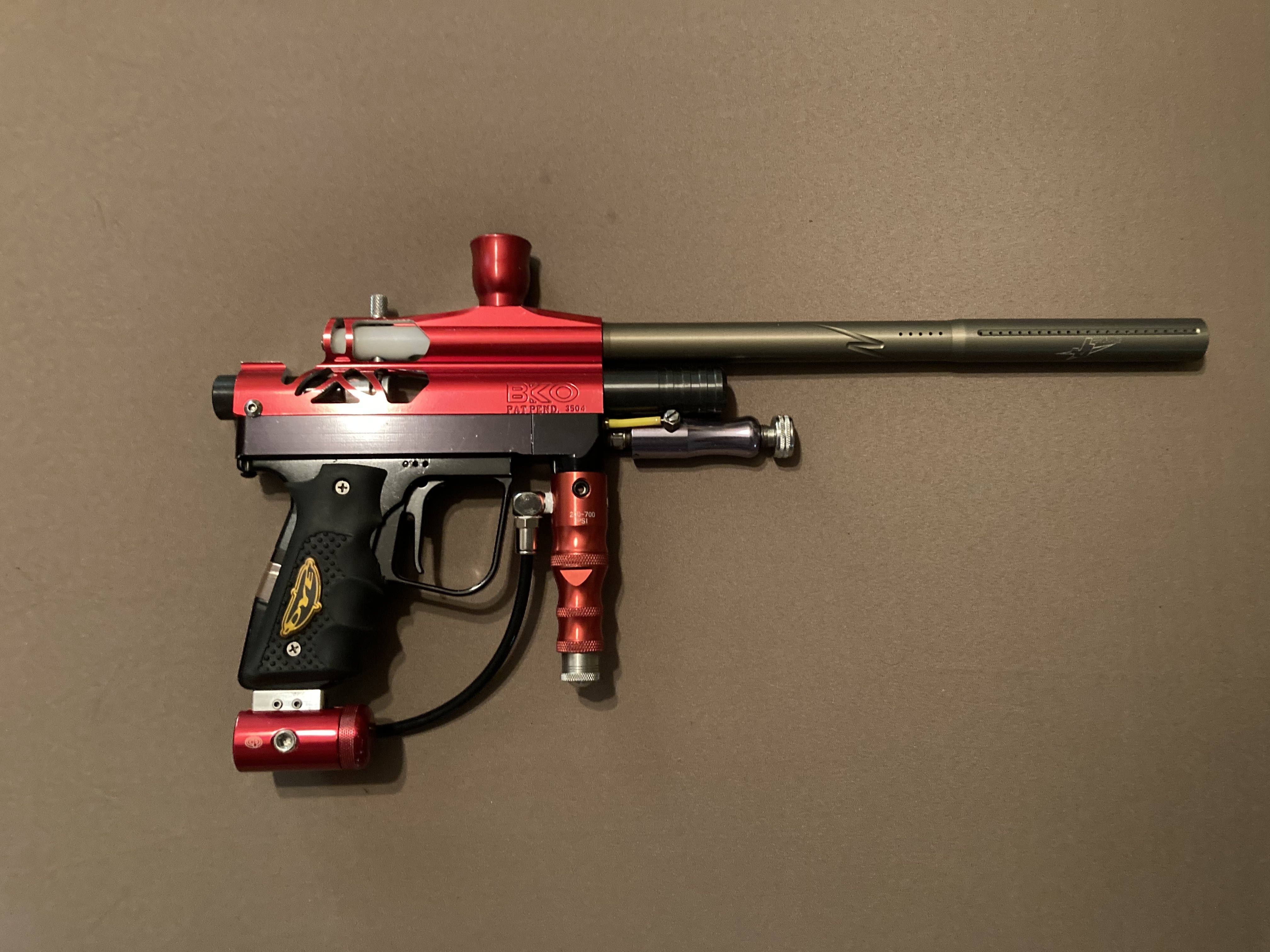

      • k_obeastly
        • 450
        I had this one for several years that had this done to it. I don't recall anywhere on the ASA for an LPR though so it may have been made specifically like that.Click image for larger version  Name:	1EA8FEF4-BF8D-425F-8430-9219E9198B0D.jpg Views:	0 Size:	4.22 MB ID:	514090
