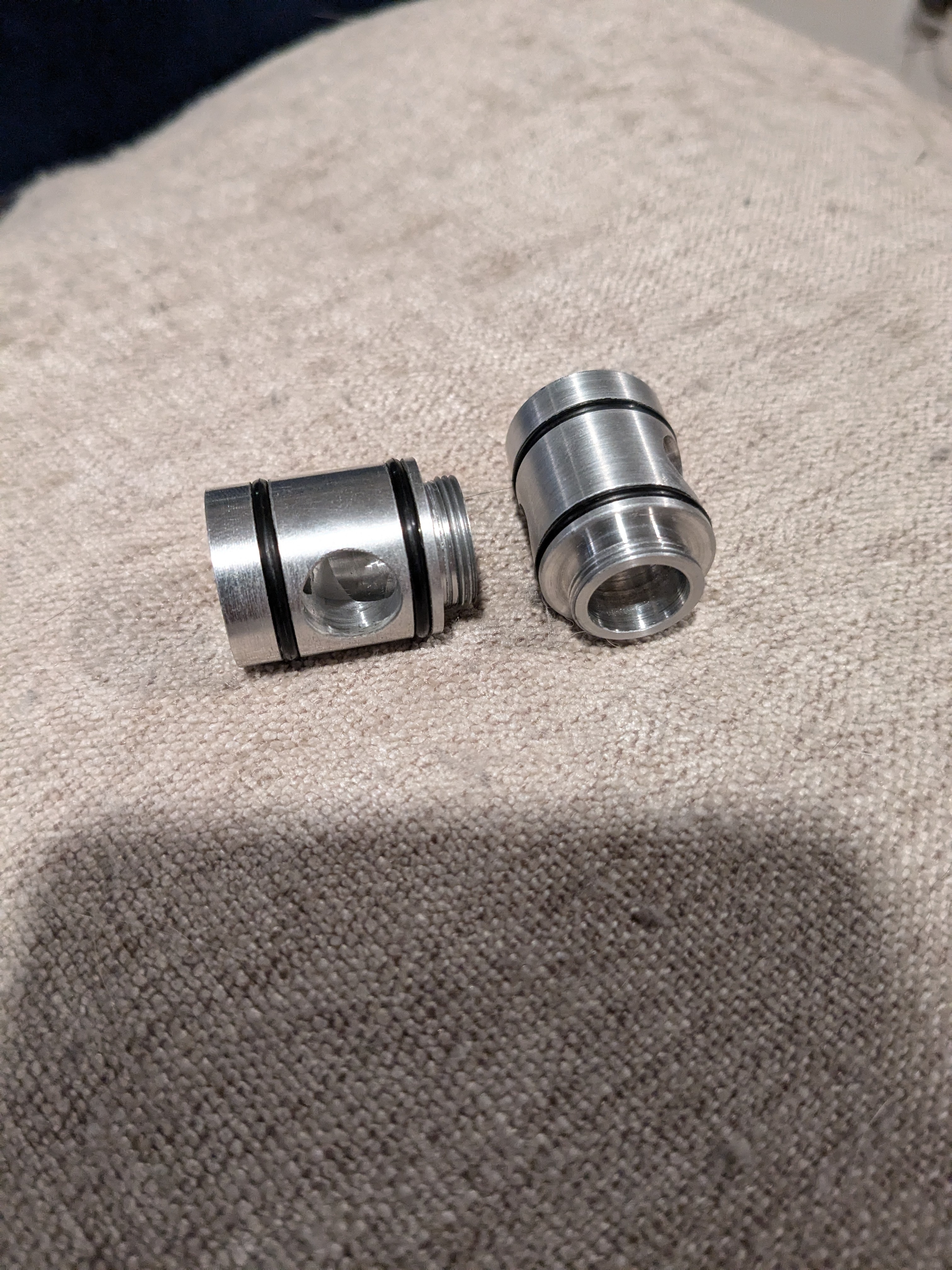

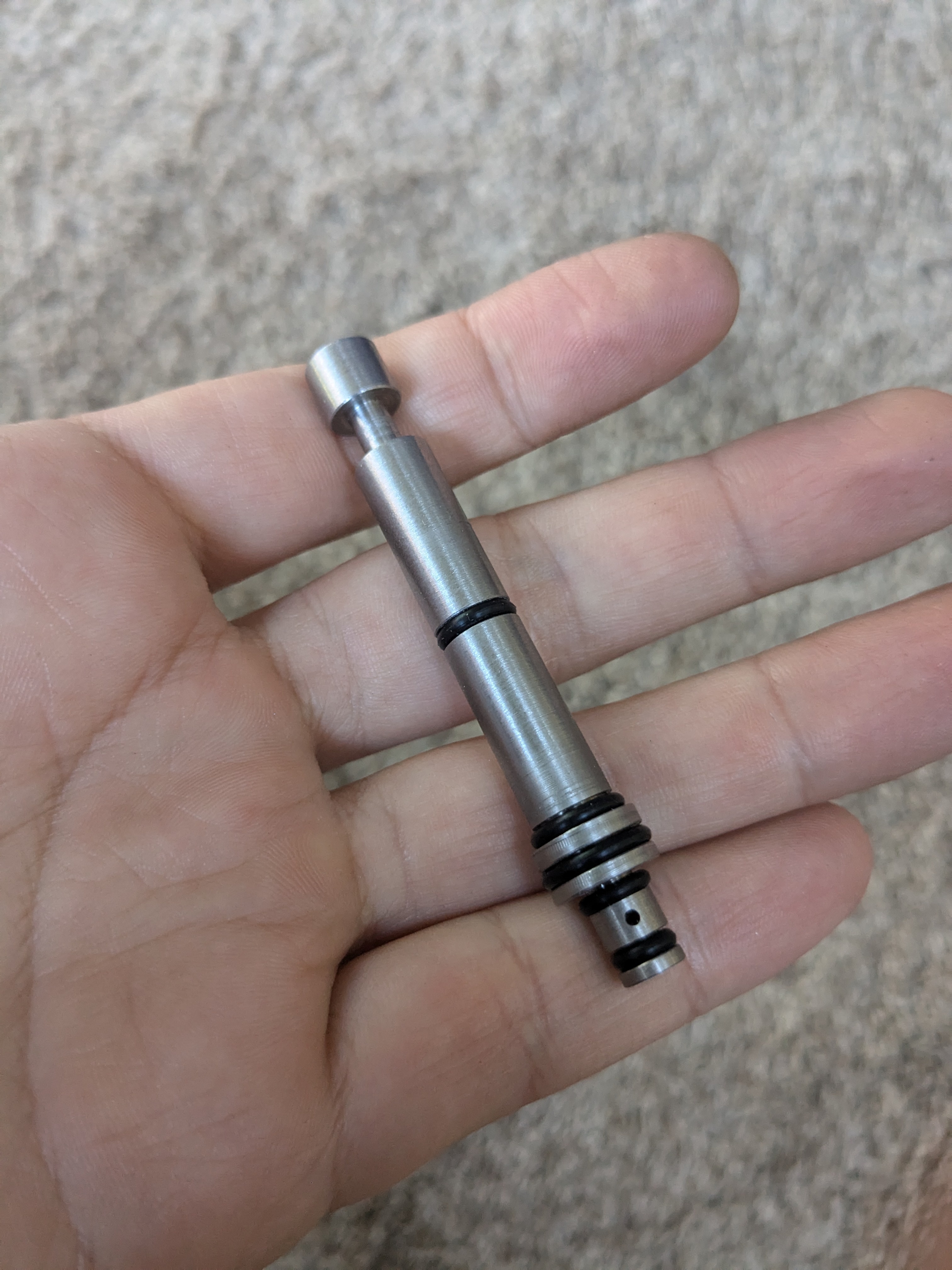

      I made the new ram yesterday and most of the ram housing, though I realized I don't have a small internal threading tool and don't want to grind one, so I'm waiting on a tap for that.

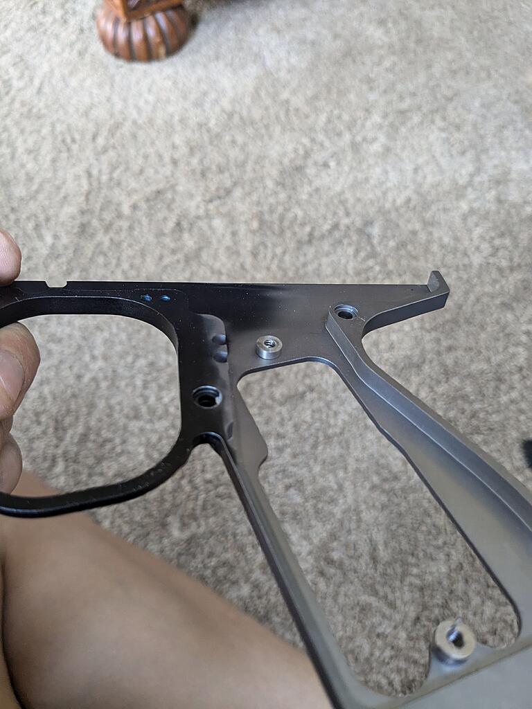

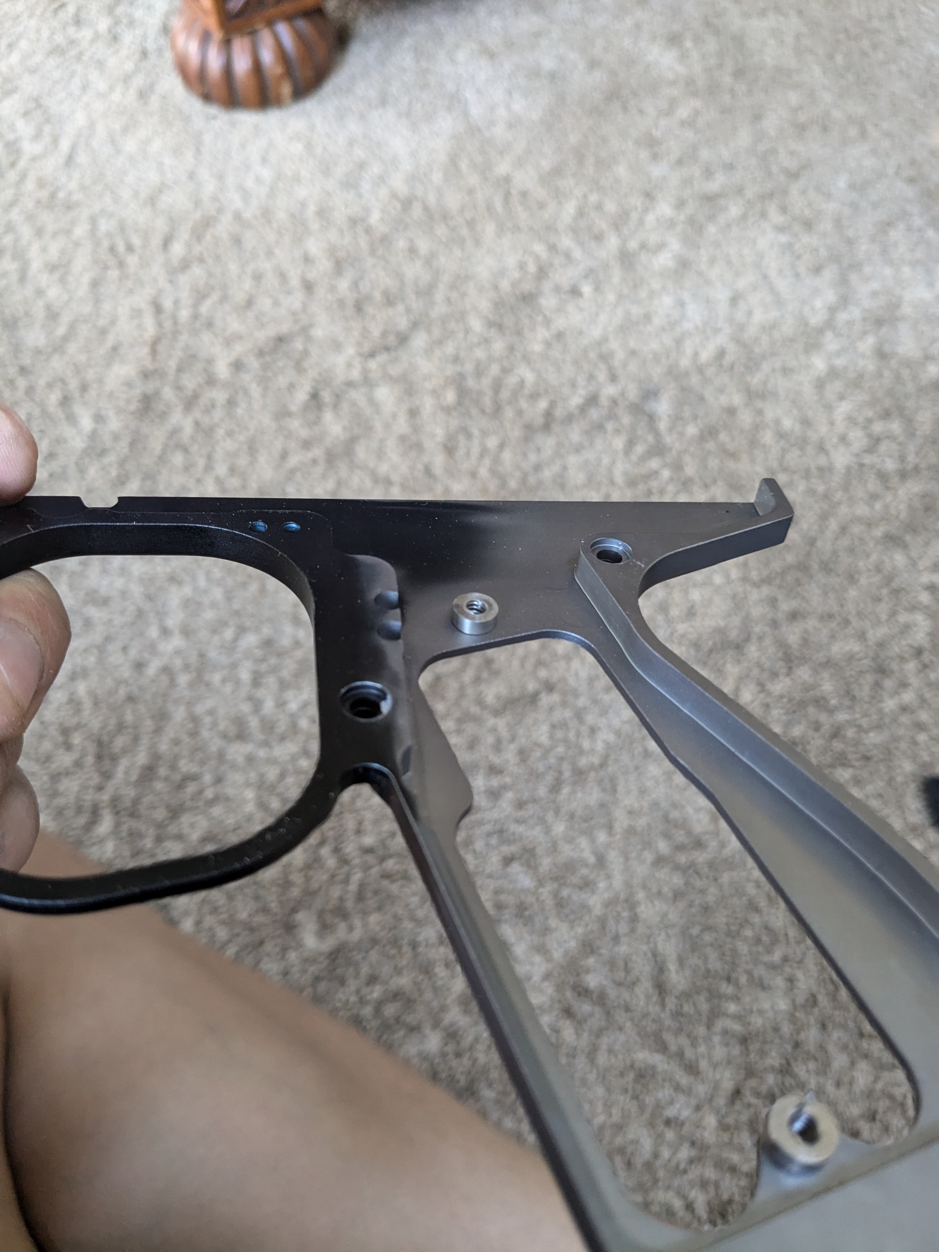

      I also made some SS screw studs for the grip frame to both repair and increase the strength of the grip screws going through the thin aluminum frame.
      • Sneak Miester
        Sneak Miester commented
        What size are those O-rings, nice ram
      • tyronejk
        tyronejk commented
        Thanks! From front to back, they're 009, 009, 011, 006, 006.

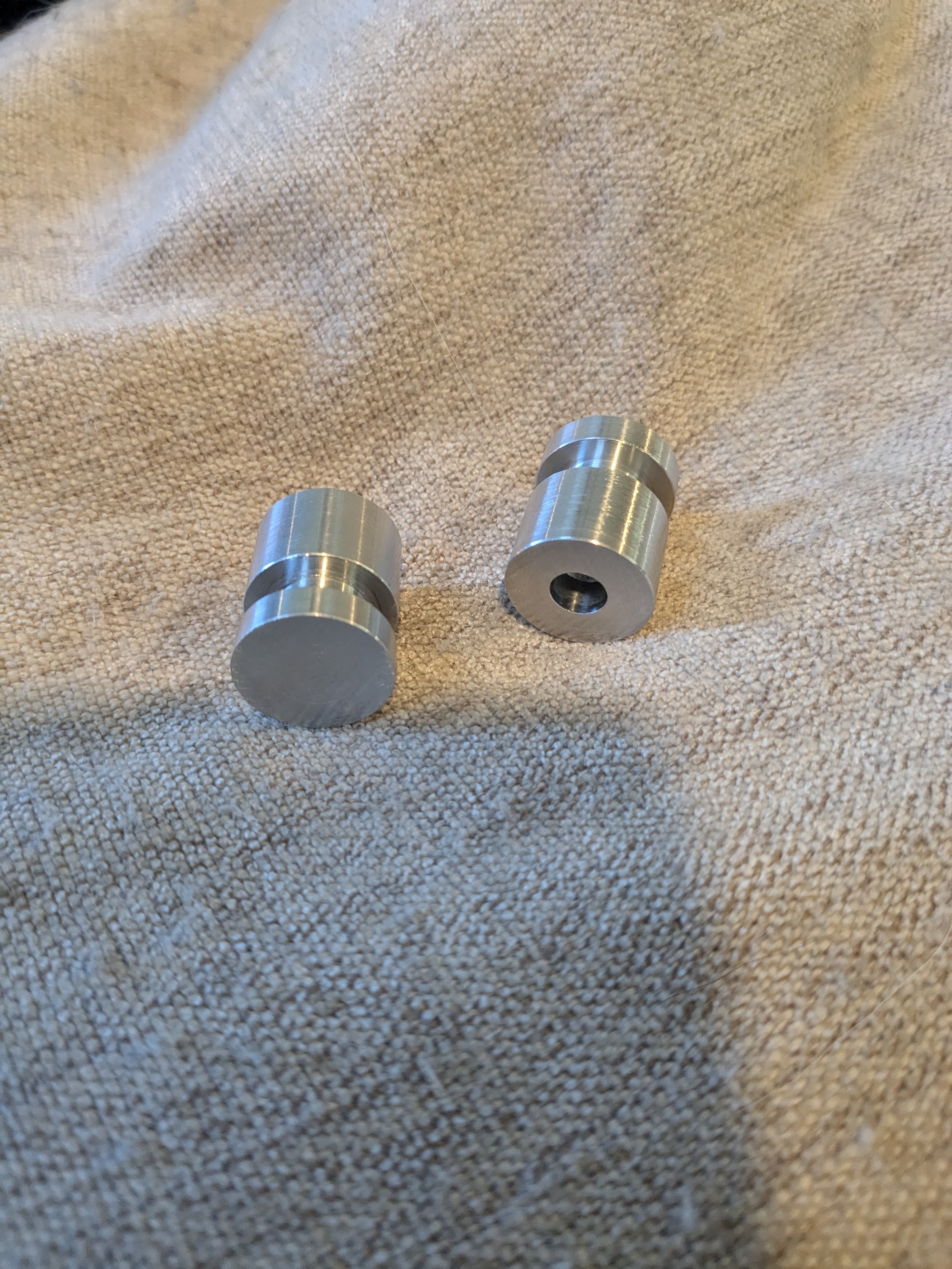

      I got another couple valve bodies made for Myrkul. I should have time tomorrow to make the hammers and then ship them out.
      • Myrkul
        Myrkul commented
        Awwwe ya!!! I'm excited to try these out!!!

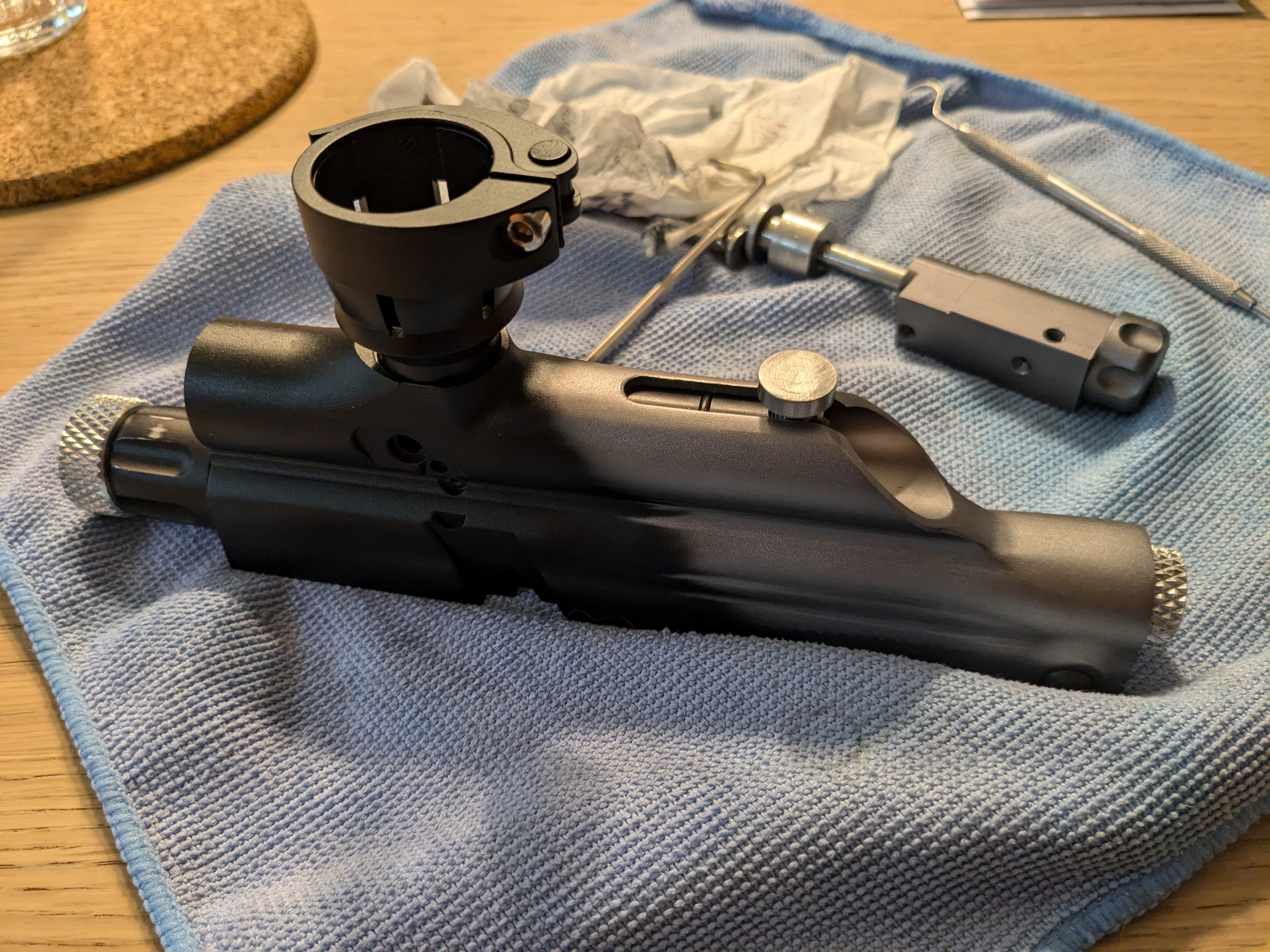

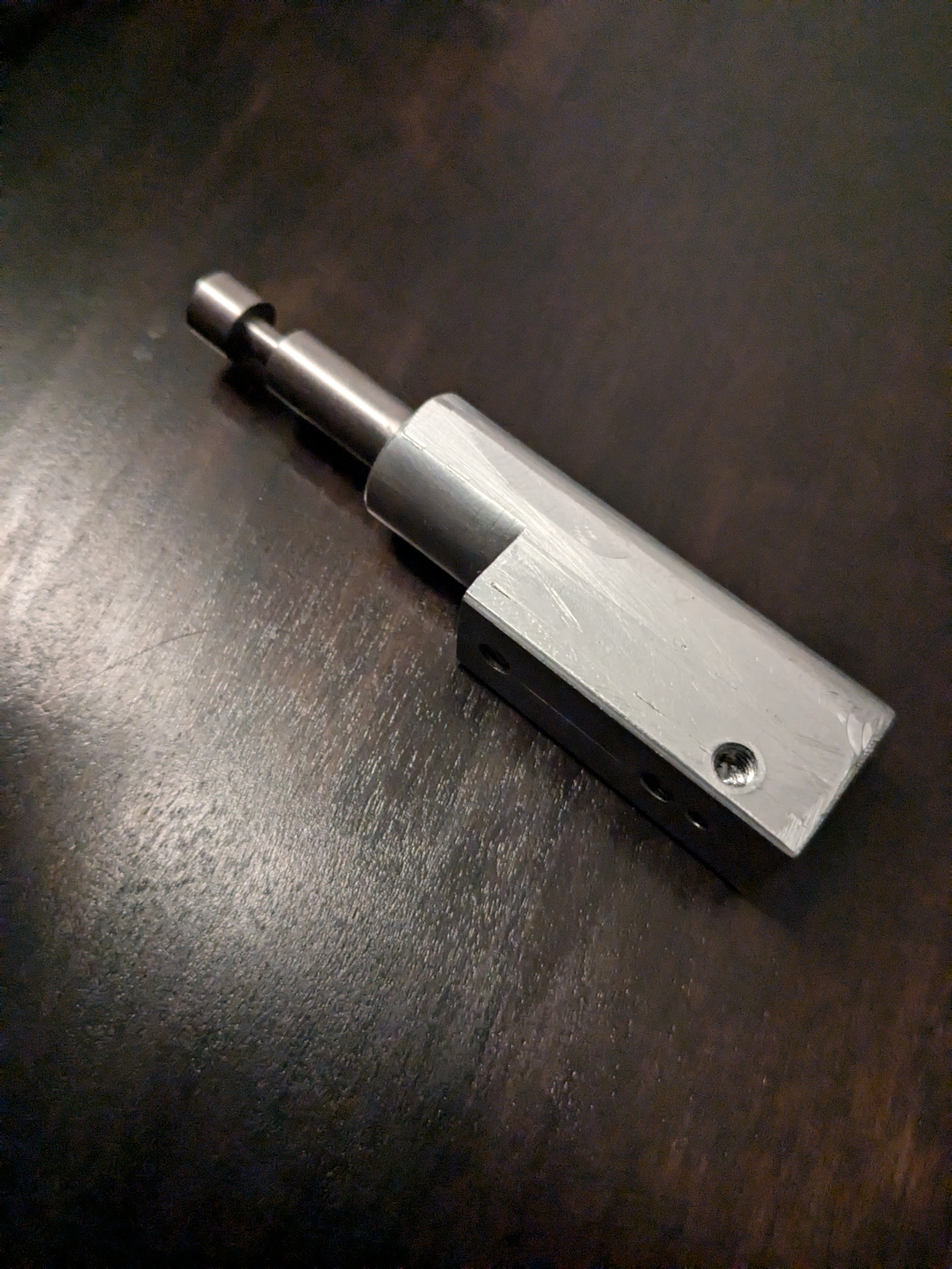

      Ram housing is 99% done. It needs a little more fiddling with a file to sit level in the gun body, but the dimensions look good. This was a huge PITA to machine on a lathe so hopefully it works. The oring seals feel right, so that's a good first sign.

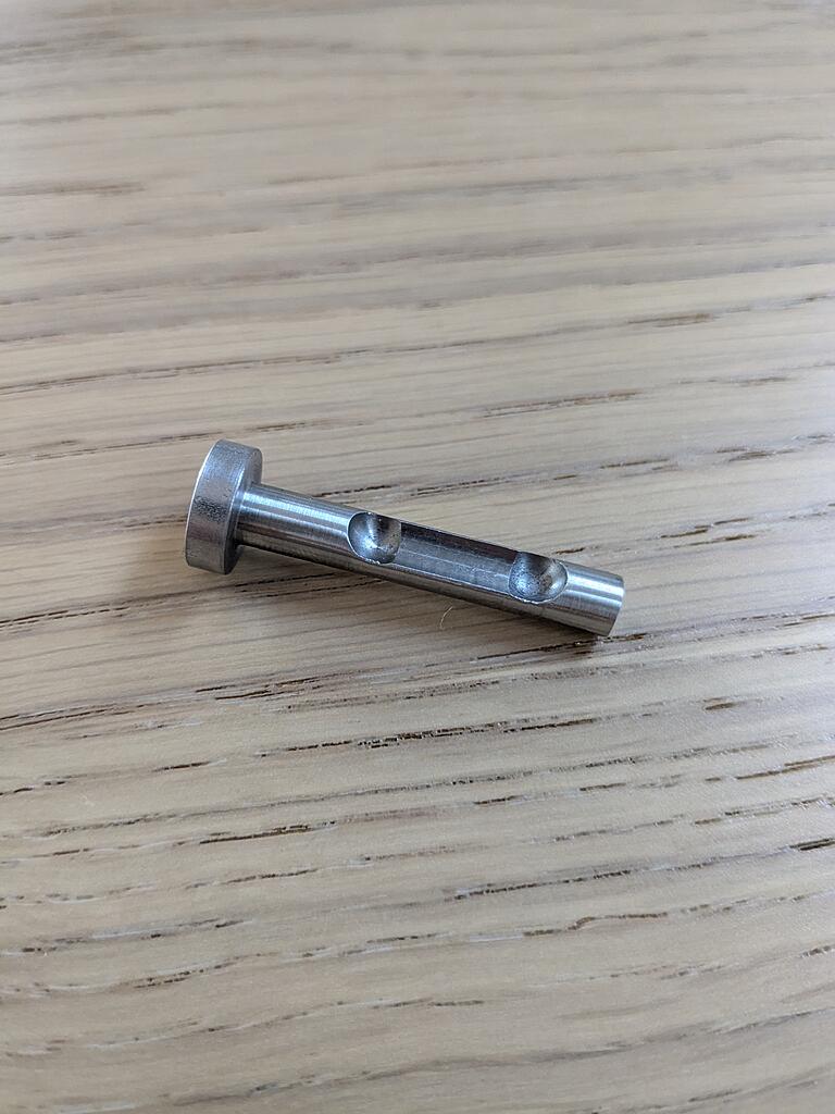

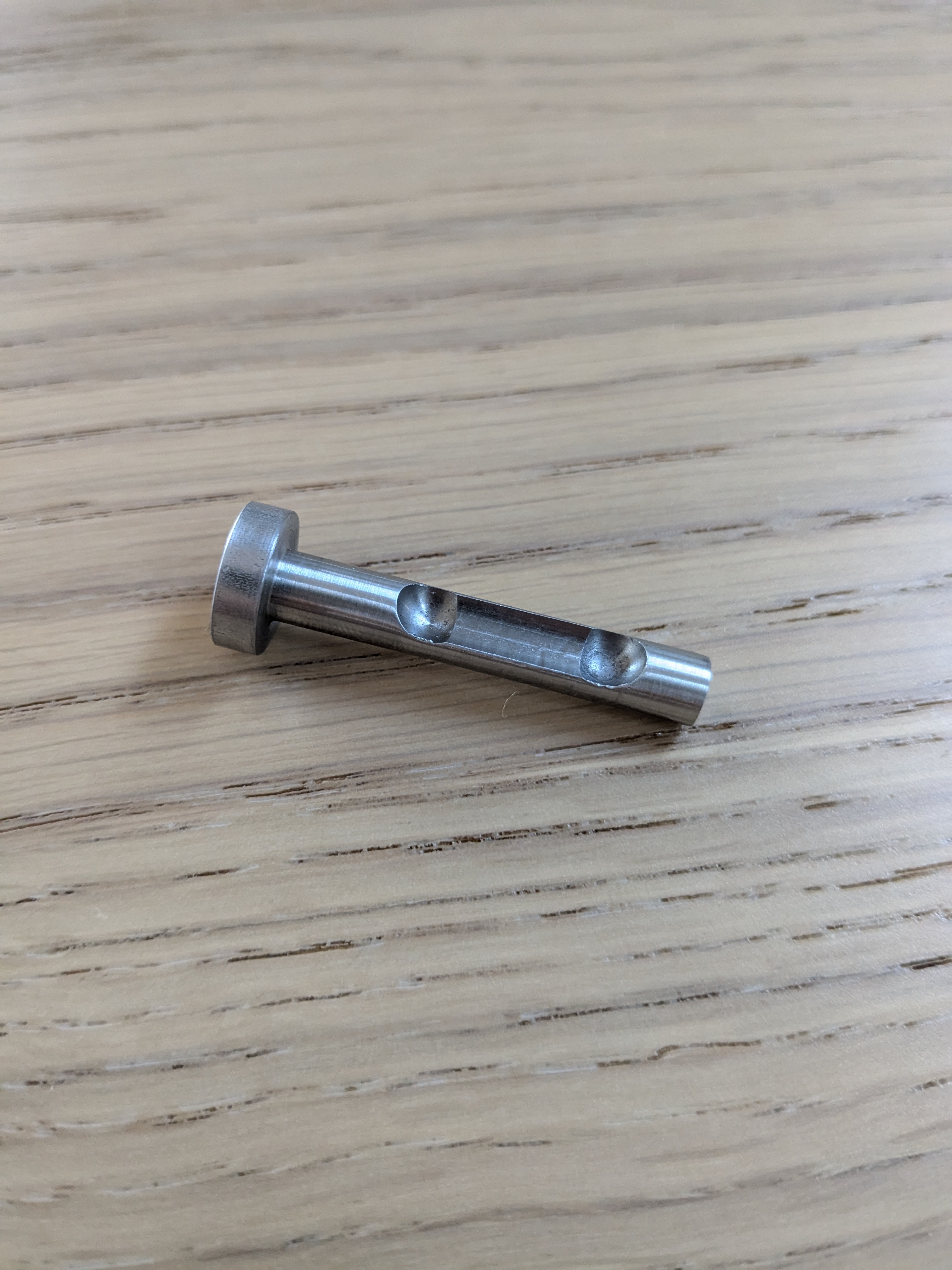

          Bolt pin finished and that should be the last part machined. Now I'm just waiting on a couple 6-32 plugs to finish the ram housing. Click image for larger version

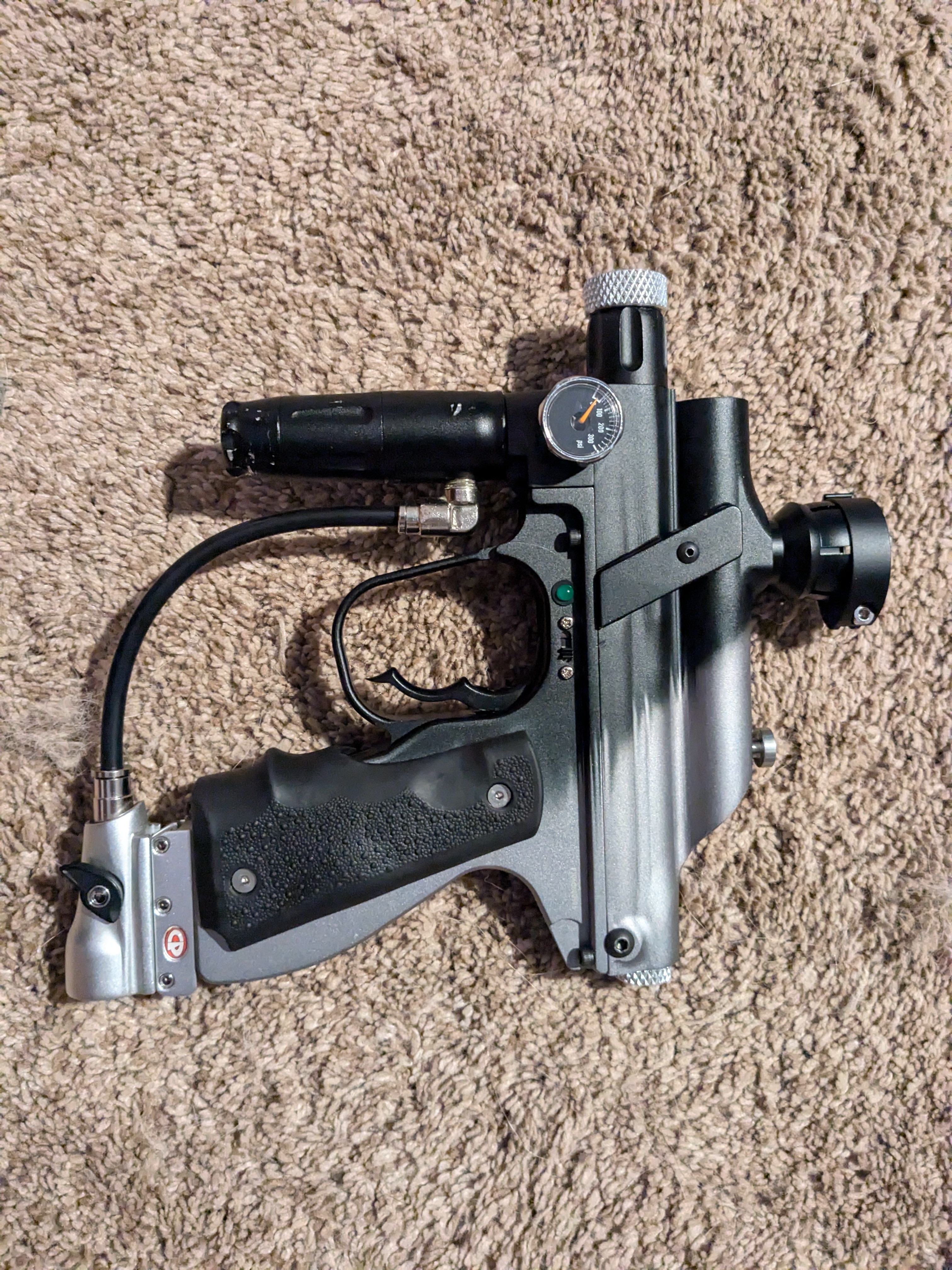

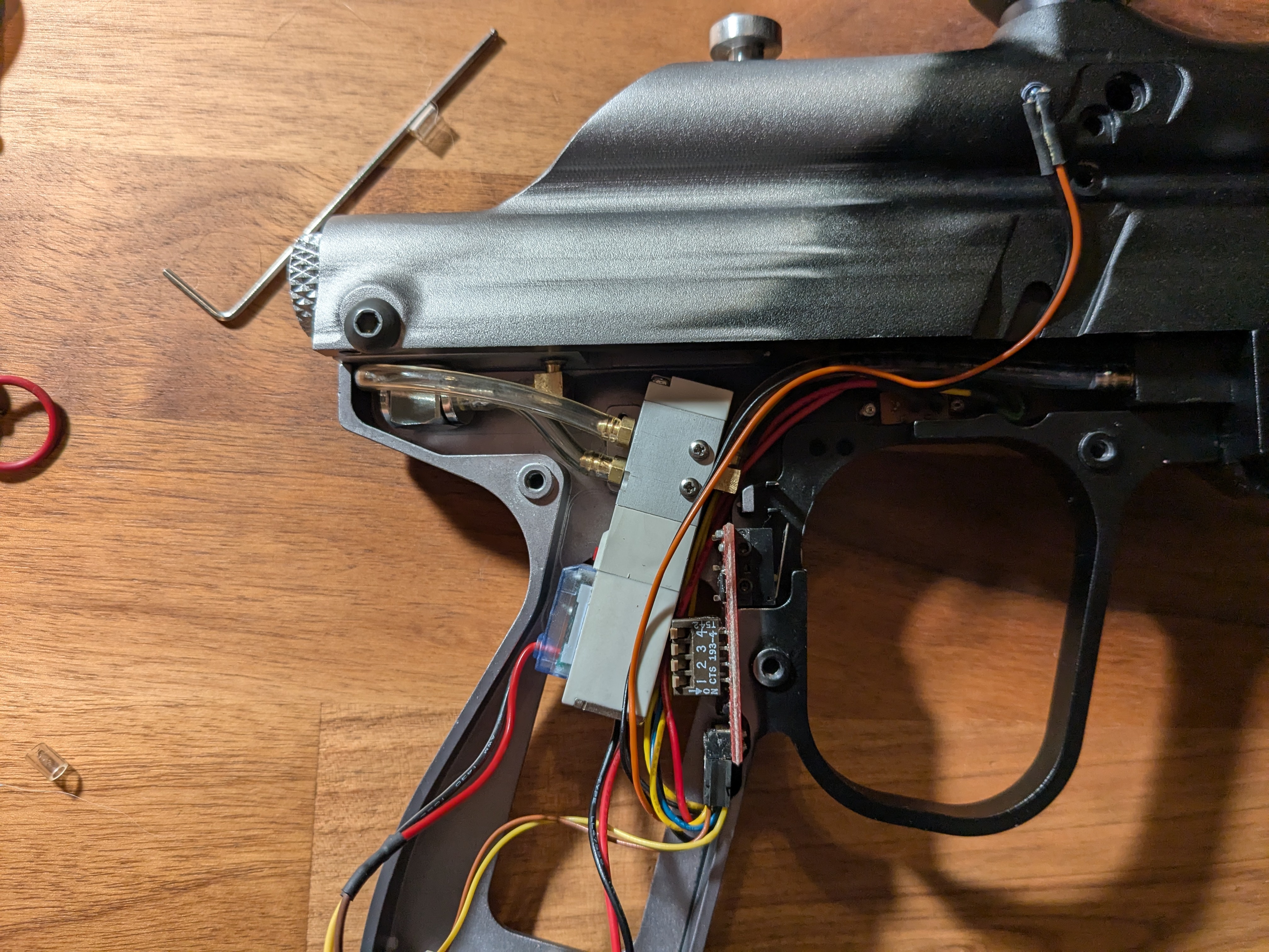

            I spoke too soon. The plugs were in my mailbox. Routing the hoses was also a PITA but I think I got it. Someone suggested moving the QEV to the front of the ram to vent that volume faster and I thought it made sense, but there's just not enough space right next to the solenoid.
            I'd bet money that this leaks from at least one spot, but I'm also overly optimistic and will hope it works on the first try. I'm not sure when that'll be, unfortunately, as I'm prepping for a cross-country move.
