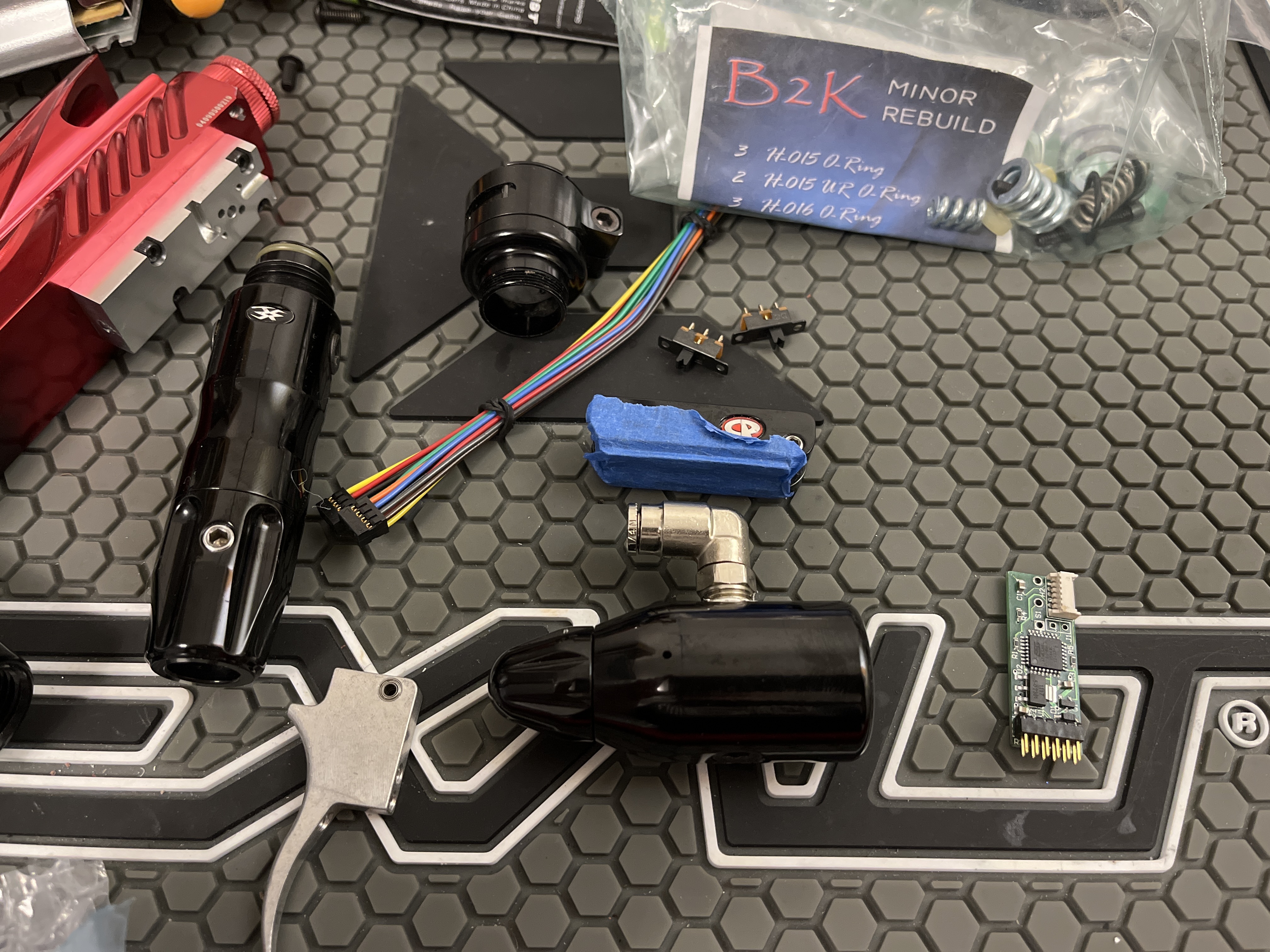

    *Gather Parts*
    From ICD:
    1. Minor rebuild
    2. Clamping feedneck
    From Vapor Works
    1. Chaos board
    2. Vapor trigger
    From Digikey:
    1. Two Molex 0511100850-06-A-6-Y-ND​ wire assemblies to rob wires from
    From eBay:
    1. two switches to replace power and PDS switches
    2. CP gloss black rail
    From the parts bins:
    1. gloss black Empire HPR
    2. gloss black CP asa
    3. orings, sandpaper, mag wheel polish cream

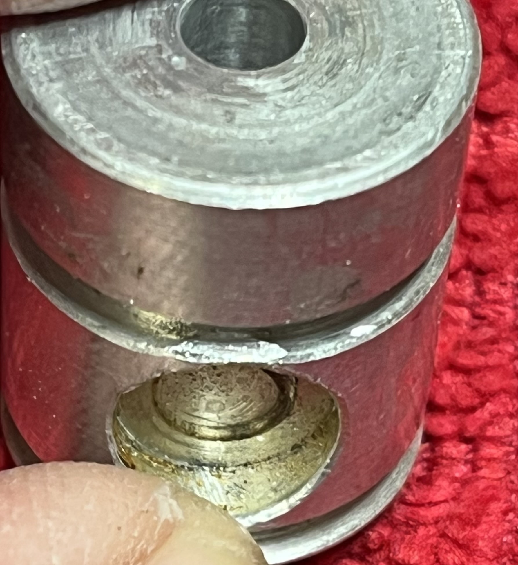

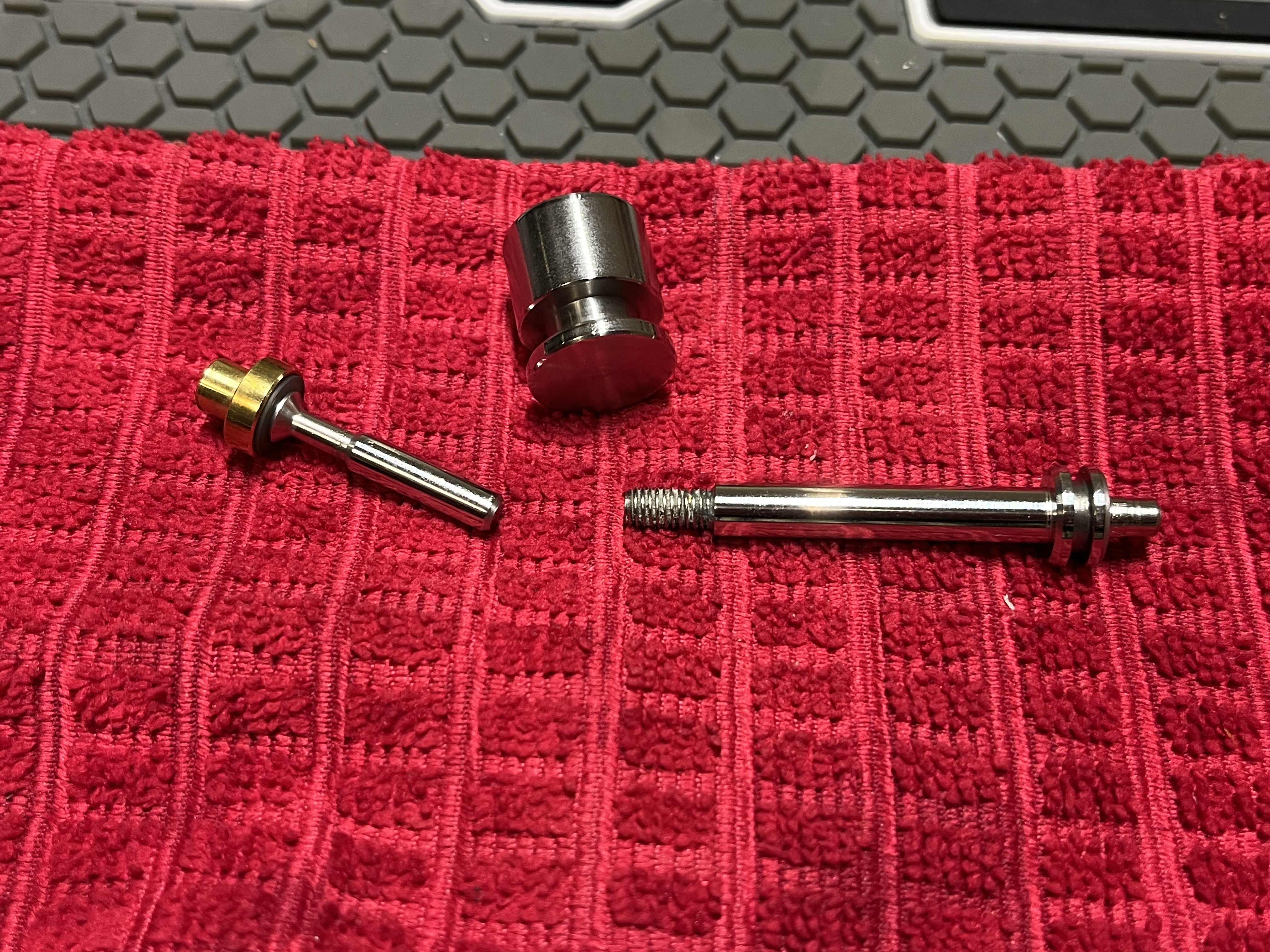

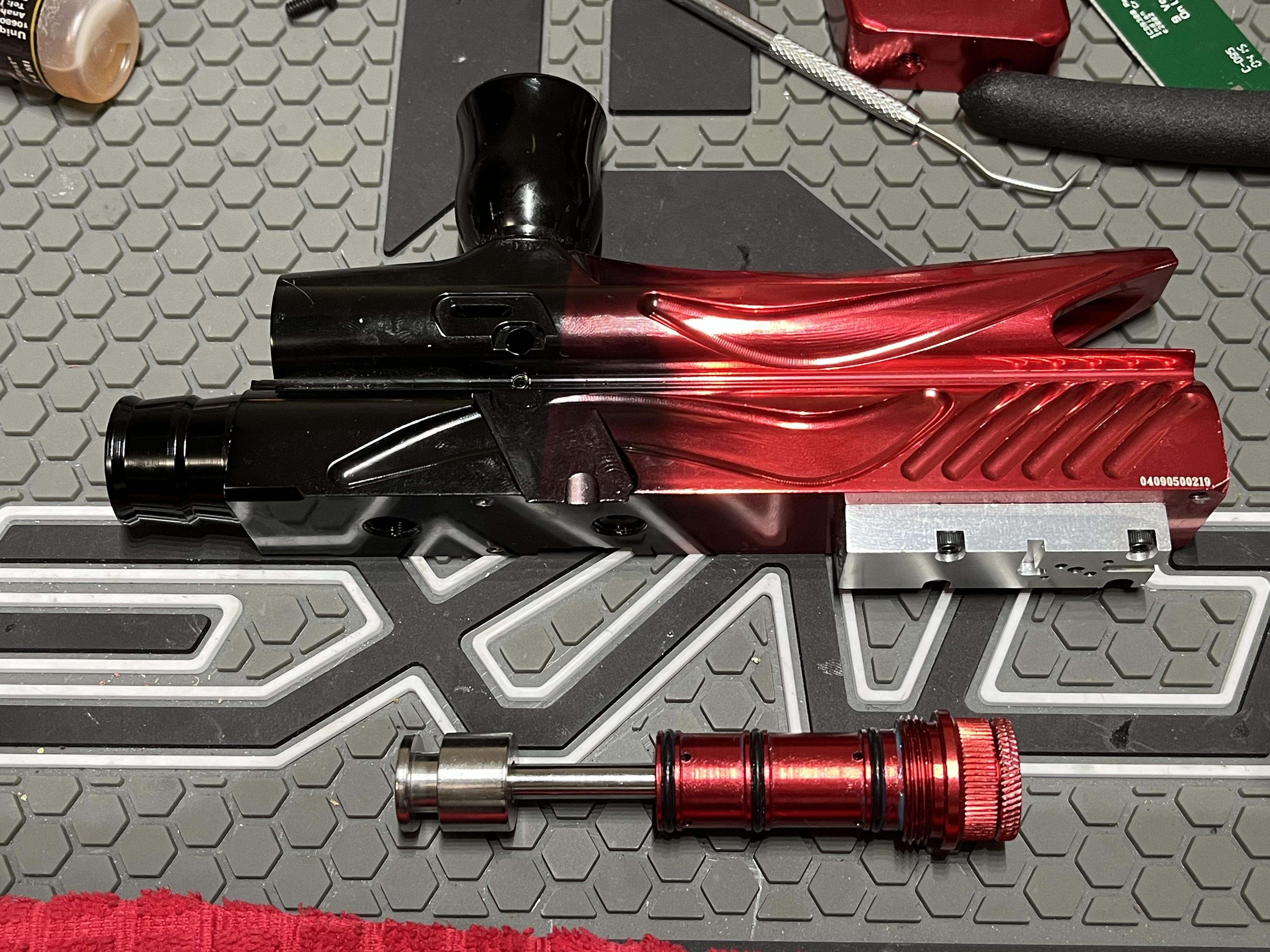

    *Rebuild Ram & Sleeve*
    Used a torch to separate the ram head from the shaft. Thankfully no one had used pliers in the past, so I applied 800 - 2500 grit sandpaper and then mag wheel polish to get them nice & shiny.
    The poppet shaft was polished in a similar fashion, and the two-oring valve was given a polish in the poppet shaft hole with a qtip and mag wheel polish. The valve had been lightly mangled near the oring slot by a misaligned set screw, which I carefully ground down with needle files.
    Everything was washed with soap & water, then cleaned with rubbing alcohol for good measure.
    Reassembled with new seals, blue loctite, and added an 011 in the back of the sleeve to account for modern paint.

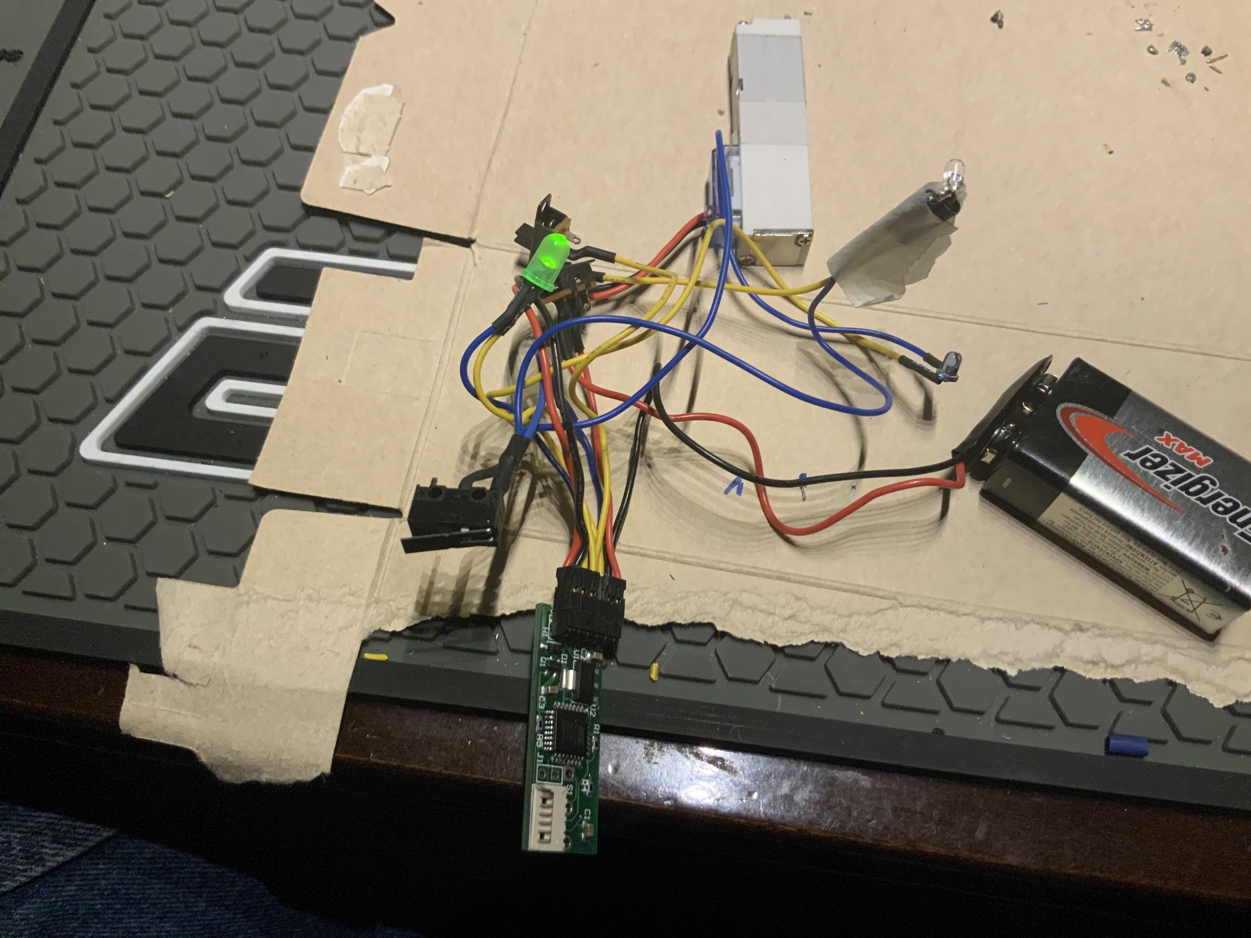

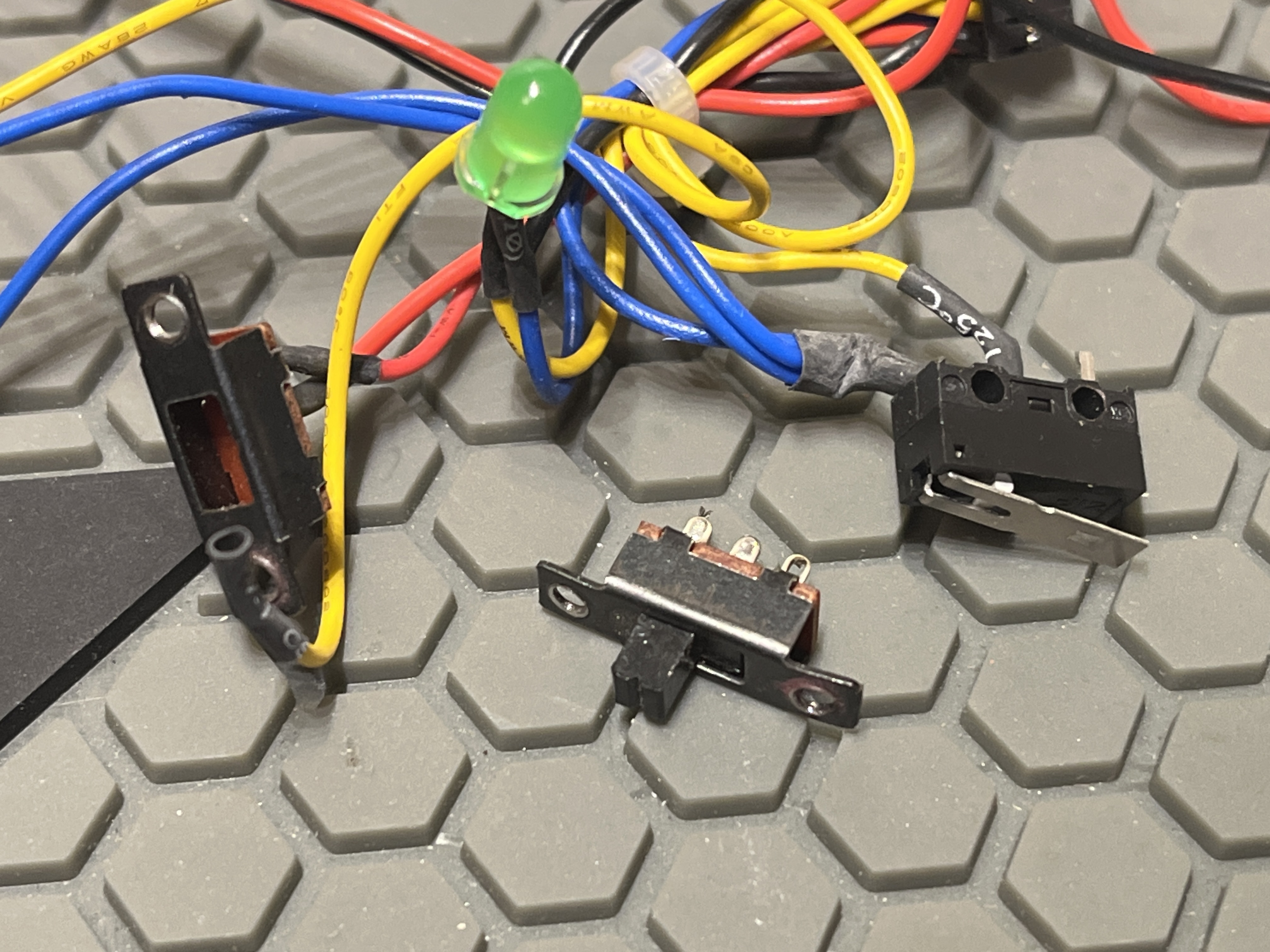

        *Fix Wiring and Swap in Chaos Board*
        ICD wiring instructions with specifications
        The wiring actually isn’t cracked or brittle so I think this had a repair attempted or maybe the 2004 version just didn’t have the brittle wiring issue? One switch is broken and the other had cables fall off.
        ​ Click image for larger version  Name:	IMG_0683.jpg Views:	0 Size:	1.80 MB ID:	653832
        I’ve got it wired up! The noid clicks and the switches work. But the eyes seem to be broken. Can’t get them to not sense that there’s a ball. The emitter (clear LED) won’t put out any light - it’s supposed to, right? i put the contacts of an LED from my Arduino kit across the leads and it lights up when the switches is engaged (or not, if it’s turned off), so there’s voltage there and the wiring is correct. Do I need new eyes, or is there other t-shooting I should do?​
        Click image for larger version  Name:	IMG_0684.jpg Views:	0 Size:	2.60 MB ID:	653833
        Edit: Fiddled with the eyes and got them working. We’re in business! I noticed the stock board didn’t illuminate the LED nearly as much as the Chaos board.

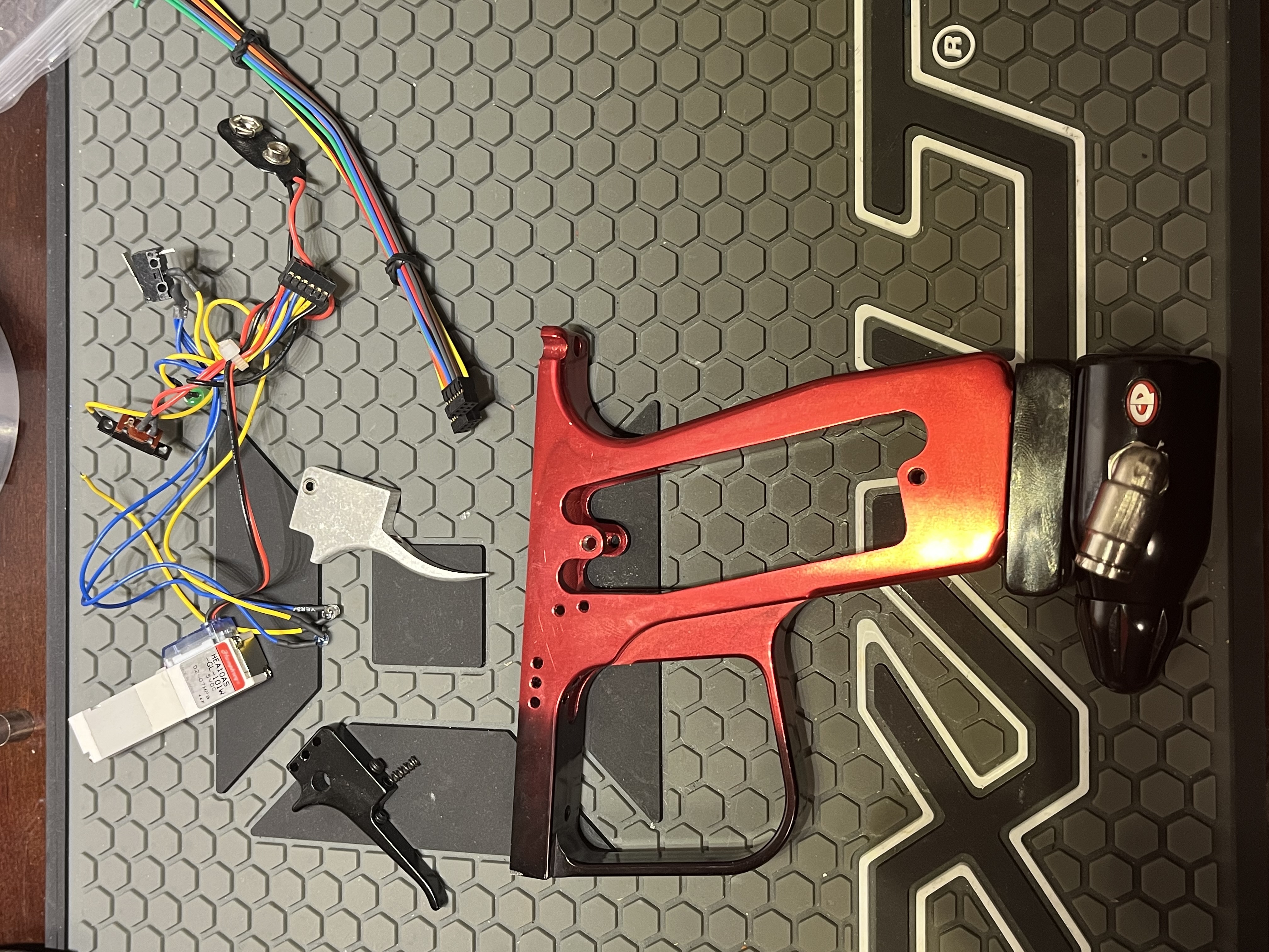

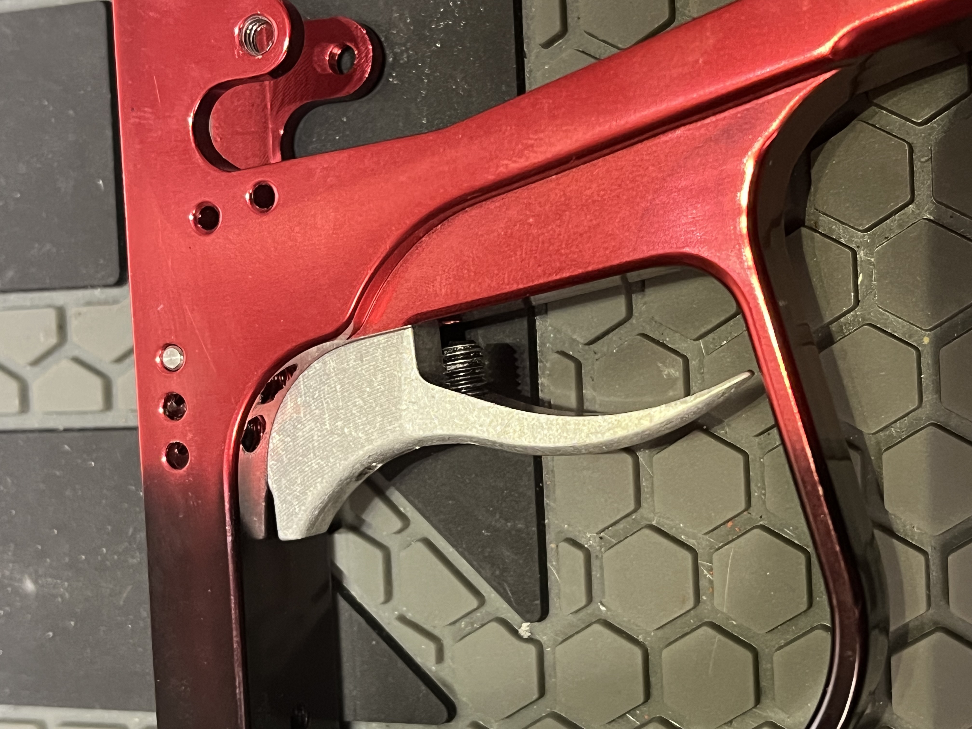

          *Feedneck, trigger, bottomline, and gauge replacement*
          Vapor trigger is installed
          Click image for larger version  Name:	IMG_6944.jpg Views:	4 Size:	2.78 MB ID:	653160
          Click image for larger version  Name:	IMG_6945.jpg Views:	6 Size:	1.87 MB ID:	653196
          Assembled with parts swapped in. Waiting for loctite to cure. Found an Empire rail & ASA in my parts bins to stick with the ICD/Empire theme. Plus this DEFINITELY needed more height 😂
          I need to dig around my laptop screw kit for two more screws for the switches, but for testing this will work fine.
          Click image for larger version  Name:	IMG_0682.jpg Views:	0 Size:	2.35 MB ID:	653831

          • lhamilton1807
            lhamilton1807 commented
            Edit: if the diode emits IR, then the sensor definitely doesn’t see any with the way I’ve got them scrambled about. Will line them up and see.
            The wiring diagram says they’re “Fairchild” diodes. May be able to find some replacements on the interwebz if I can’t get these to work.
            https://www.indiancreekdesigninc.com/s/Wiring.pdf
            Original comment:
            I’ll try the dark room & camera method tonight. The leads to the emitter (clear) eye were soldeee on backwards so I had to re-solder that. The tape is there just to hold the unshrunk tube in place to prevent shorts
            Everything else seems to be working so I may just assemble and air up just to hear it roar for the first time
          • Myrkul
            Myrkul commented
            Go for it! If you can pre-set the regs, 250 on the HPR, 65 on the LPR. If the eyes are cashed you can just run it blind. I have 5 B2Ks and only one of them has PDS....and it's my least favorite one. A rotor plus the bolt mod should take care of the 99% of ball breakage issues.
          • lhamilton1807
            Fiddled with it some more and got the eyes to work with both the stock and Chaos boards. Will assemble tonight and air it up tomorrow.

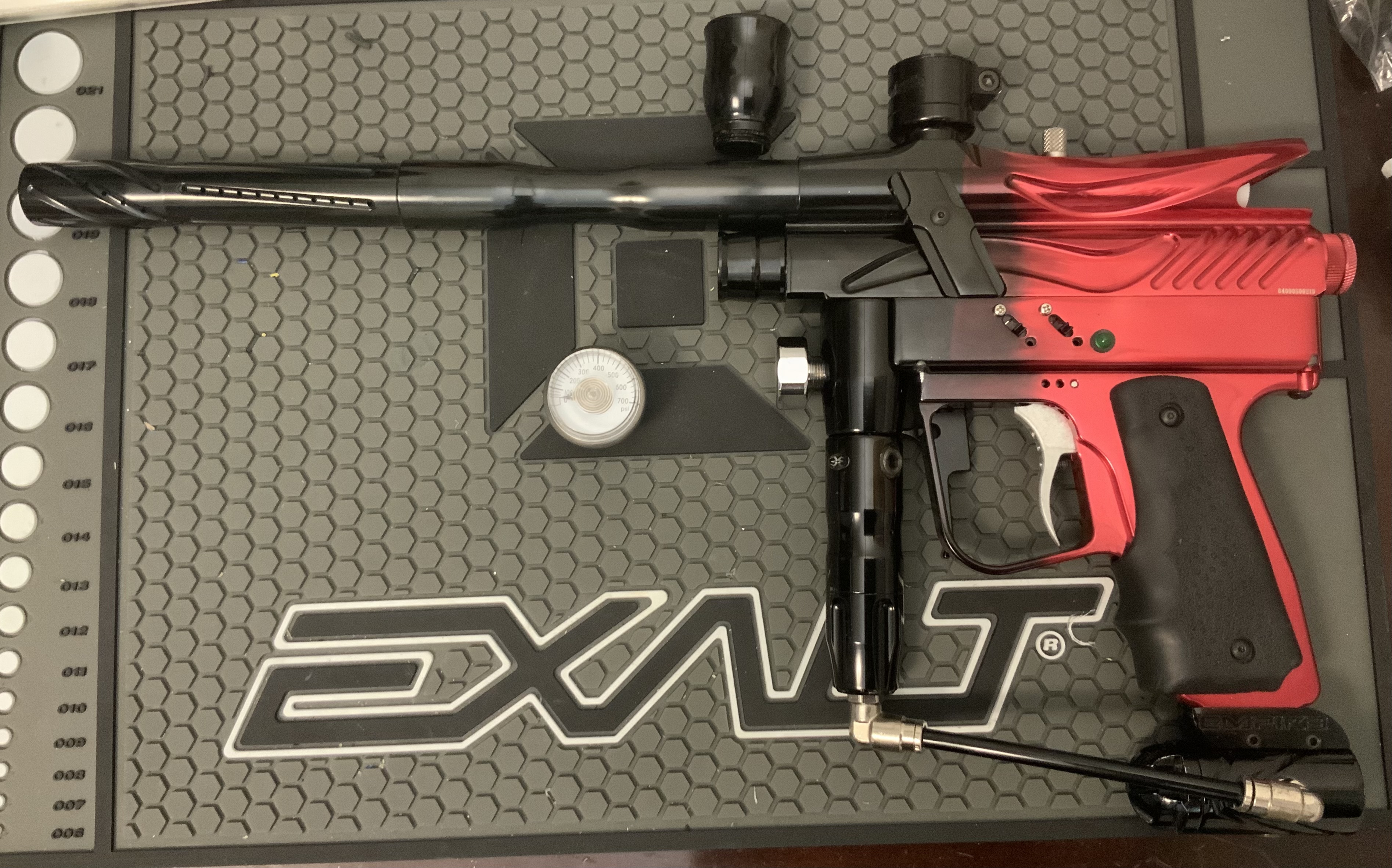

          • lhamilton1807
            Friends paint friends
            • 1128
            Assembled! Just need to air it up & test, then send the bolt off for modification.
            My Feedback Thread

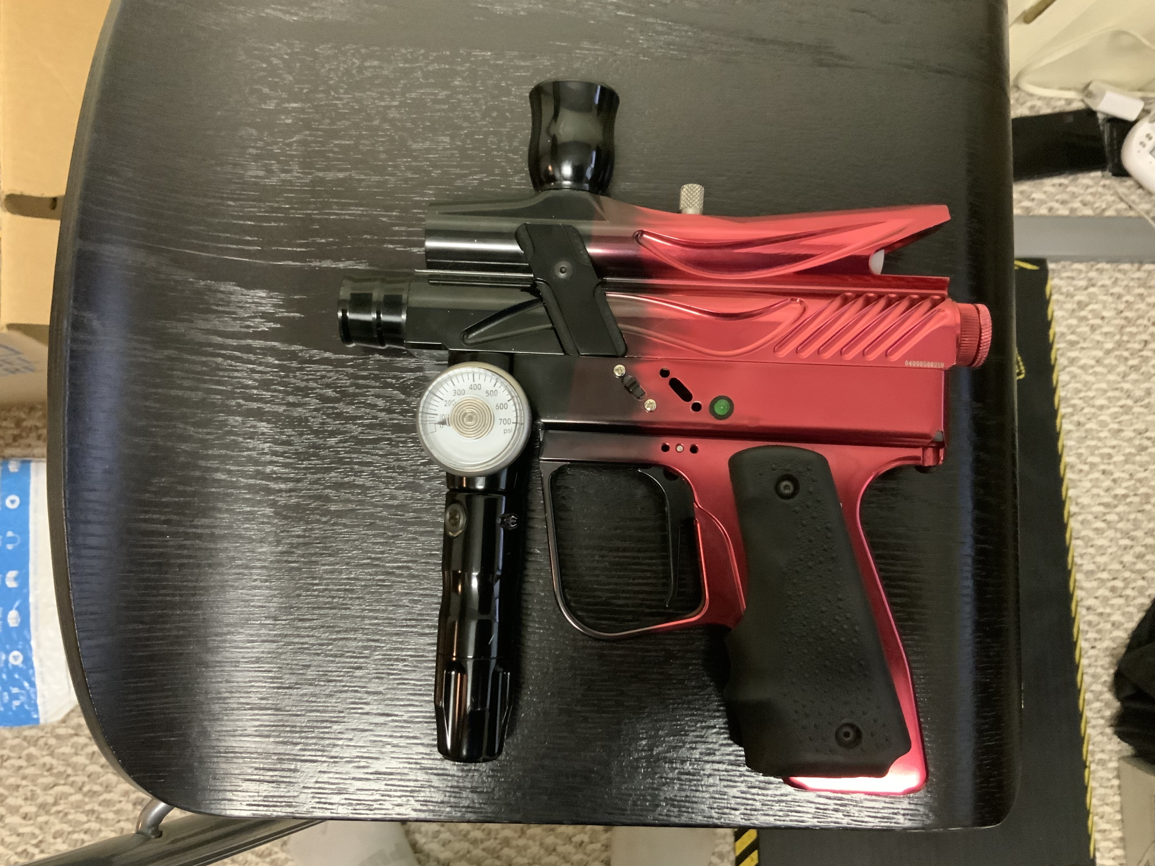

            • Sneak Miester
              Retired
              • Apr 2024
              • 185
              • Alberta

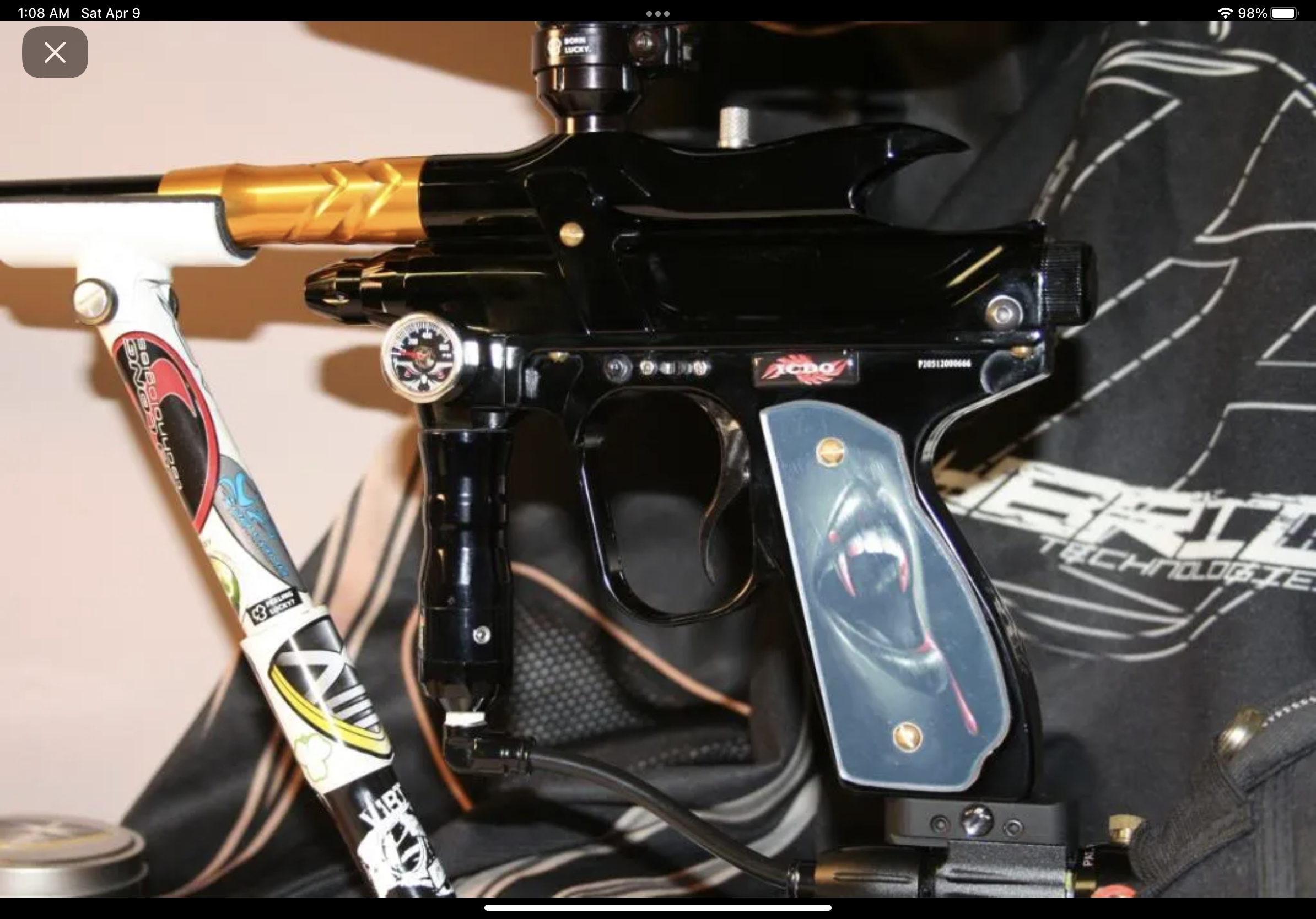

              Looks really good, I would swap out the micro gauge for an evil look. Something like this
              Click image for larger version  Name:	IMG_5238.png Views:	0 Size:	7.99 MB ID:	654145
              my feedback

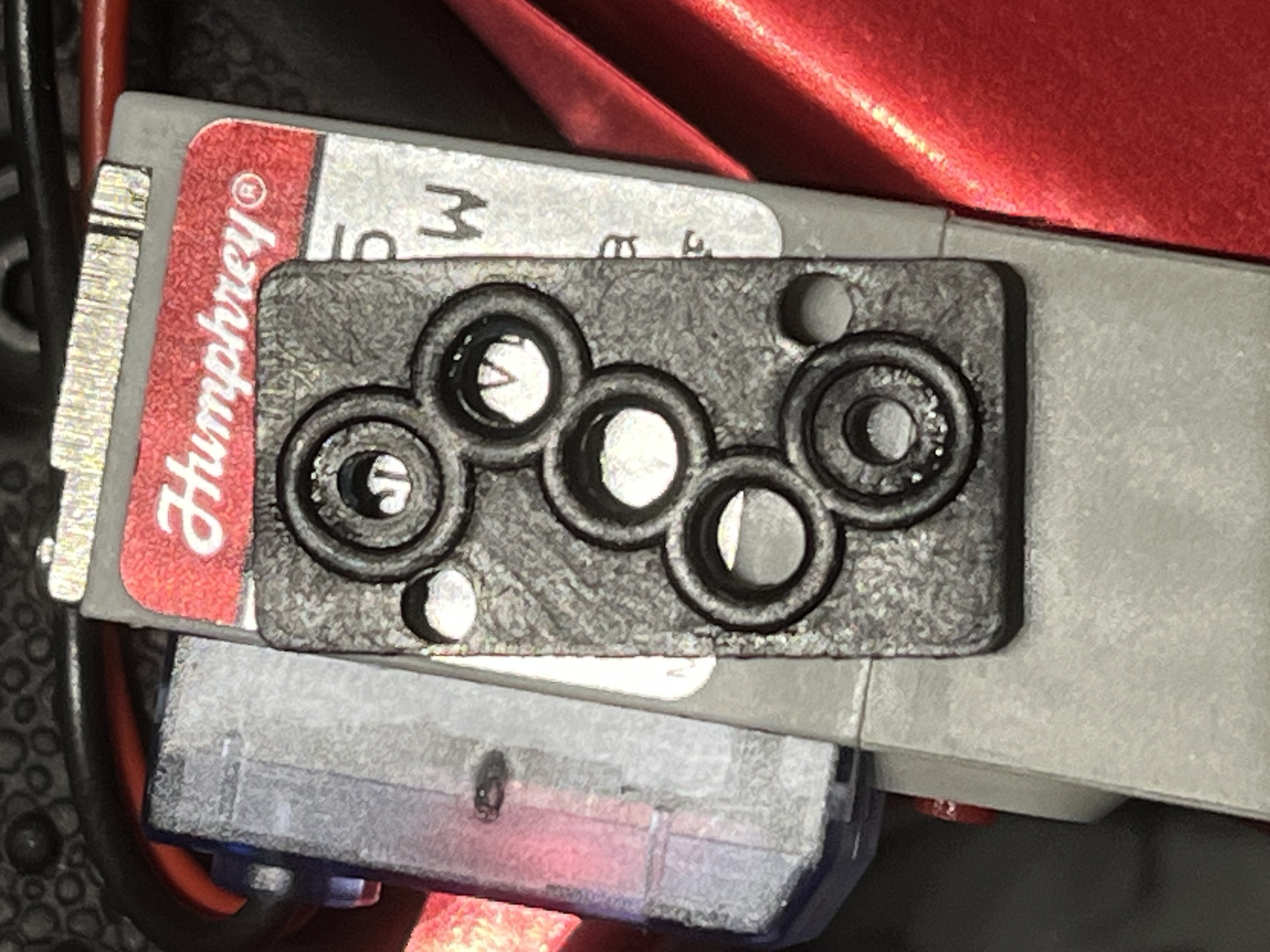

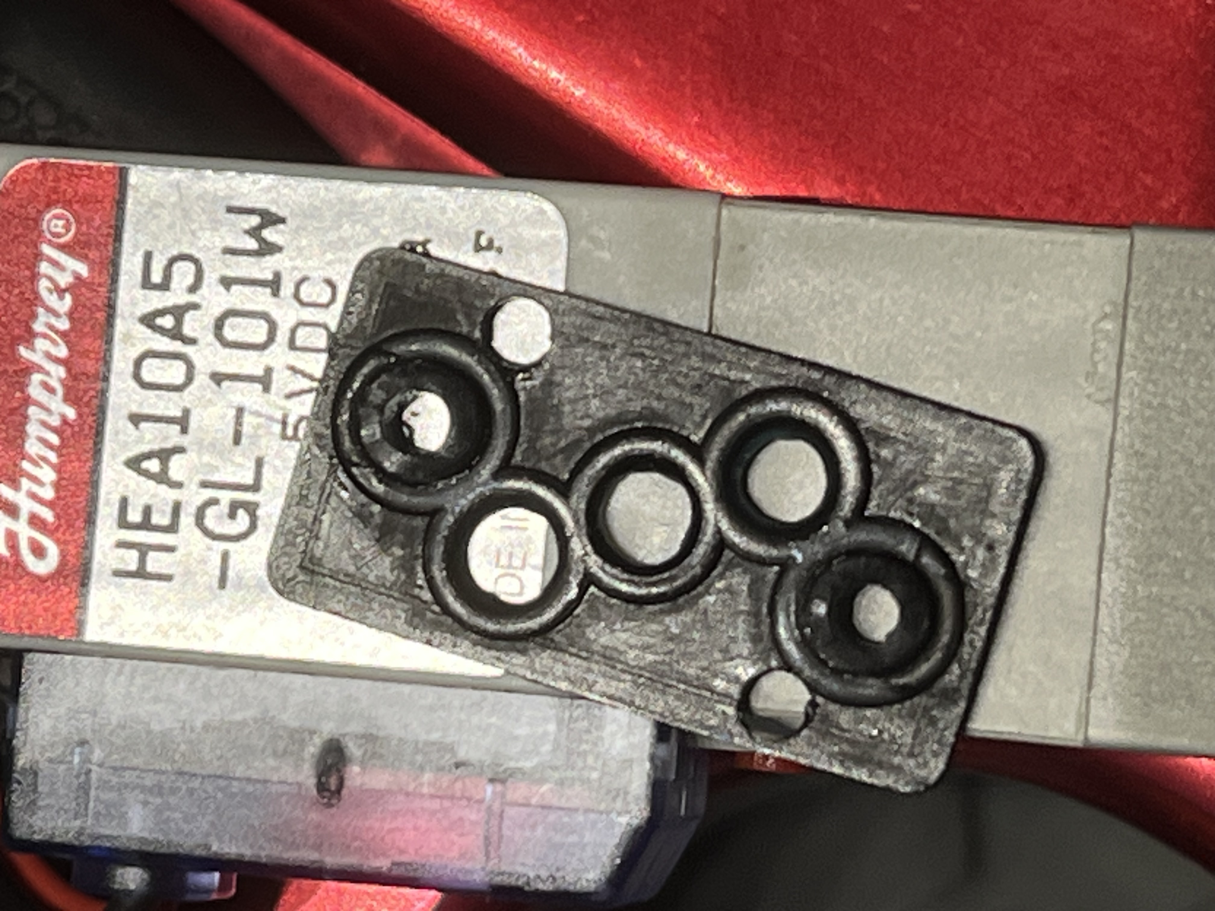

                I’ve been struggling with what I assume is either a manifold leak or a bad solenoid. After airing up with no leaks and the lpr adjuster all the way out, I’d slowly adjust the lpr in, waiting for the hammer to slam back. Instead I’d just get a leak from the grip frame.
                The manifold o-rings were probably originals (010 urethane seal crumbled as I took it out) so they were replaced with BNR90 010, 011, and 017 seals.
                Reassembled and got the same bloody leak. Any ideas?
                My Feedback Thread
                • martix_agent
                  • 548
                  • Indiana
                  To find out exactly where it's leaking from try the soapy water spray. I've actually used my tongue to locate small leaks; seems weird but you can tell exactly where it's coming from.
                  If you determine it's not the manifold, it must be coming from the solenoid. I can't remember of these are rebuildable, but it's very possible that somebody has already been in it and lost/reinstalled incorrectly those tiny metal pins that fit into the cap. It's been a long time, but i think that can either cause a leak, or the solenoid to not activate.
                  It's also possible that your LPR is sending too much pressure to the solenoid, and it's venting out from over pressurization.

                    This is the manifold gasket. I’ll try the tongue/soapy water test, thx

                    • martix_agent
                      • 548
                      • Indiana
                      ugh. memories of those gaskets haunt me; they're kinda notorious for leaking. Was a new one part of the rebuild kit you got from ICD?
                      I think there was a guy who made/sold a replacement for these back in ICD-owners.com was still a forum. They were blue maybe? If that's what leaking, you can ask on the ICD facebook page. A lot of the guys from that site ended up there. https://www.facebook.com/groups/141615685892675
                      • lhamilton1807
                        No gasket came with the minor rebuild - that came with reg springs, reg seats, and o-rings. Thankfully the gasket didn’t end up being the problem. It was my stupidity.
                      • Myrkul
                        Myrkul commented
                        @martix_agent
                        I've actually never seen a bad gasket. There are multiple parts of the gun (LPR, Ram, Manifold) that will all cause the solenoid to leak from the bleed off hole. Everyone thinks it's the gasket because the leak is coming from the solenoid, but it's litterally never once been the actual cause of the leak in my experience.
