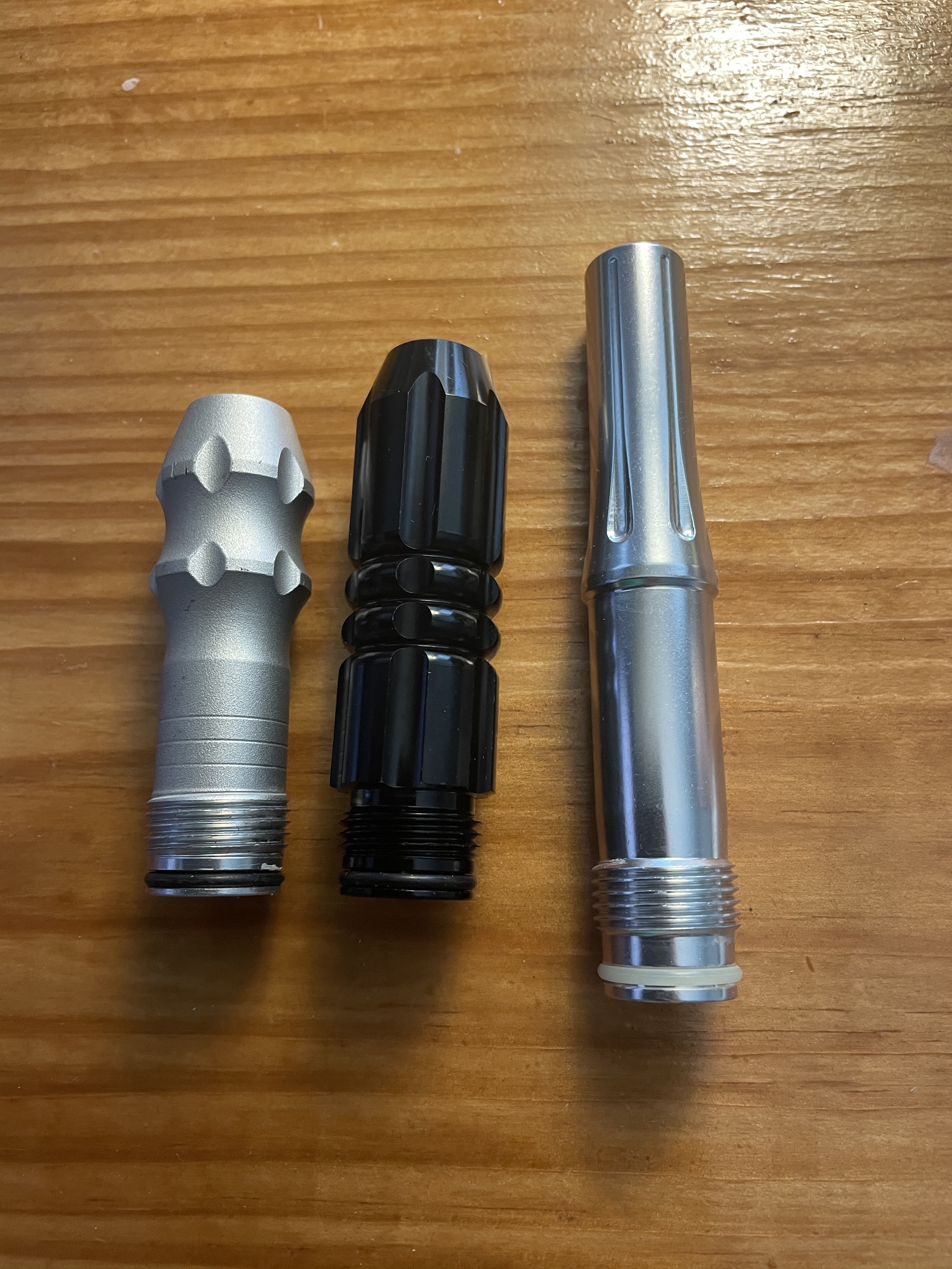

    The stupid LPC I dug up for this classic body has ridges that interfere with screwing in most barrels. Does anybody have one available that doesn't get in the way?

    What style did you get that wouldn’t work? It would help in figuring out what will work for you when people start offering

ID:	102241 On the left, and middle, the knobby bits are too knobby and prevent a barrel from lining up properly.
        The shocktech on the right doesn’t have a lip inside which is too bad because it would be low profile enough to work otherwise.

          Shave em and get in a basic batch of black ano :P

          Definitely gave it some thought, might still. The grey one is only hollow for half of the chamber so I’d want to bore it out a bit also.

        Look for a pro line LPC if you can. I will dig in my parts and see if I have a spare. They’re not very flashy but it should get the job done.

        Why not an insert for the right lpc?

          Yeah, that could work. Just a little washer maybe, made to fit? Is there a better/ existing option?

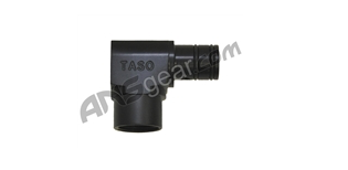

          On that note, there is a Taso vert adapter over on ANuSGear. Do the Taso adapters have a hole for an LPC? the photo on the site is from directly to the side and it looks like the vert adapter is threaded but I can't see the front.

            scottieb commented
            Yes, Taso one hole front blocks are threaded for LPC's. I have some that LPC's don't thread into well, though they are in the minority as the other Taso front blocks I have and have come across work fine.
            Now if you ever find a two hole Taso front block...
