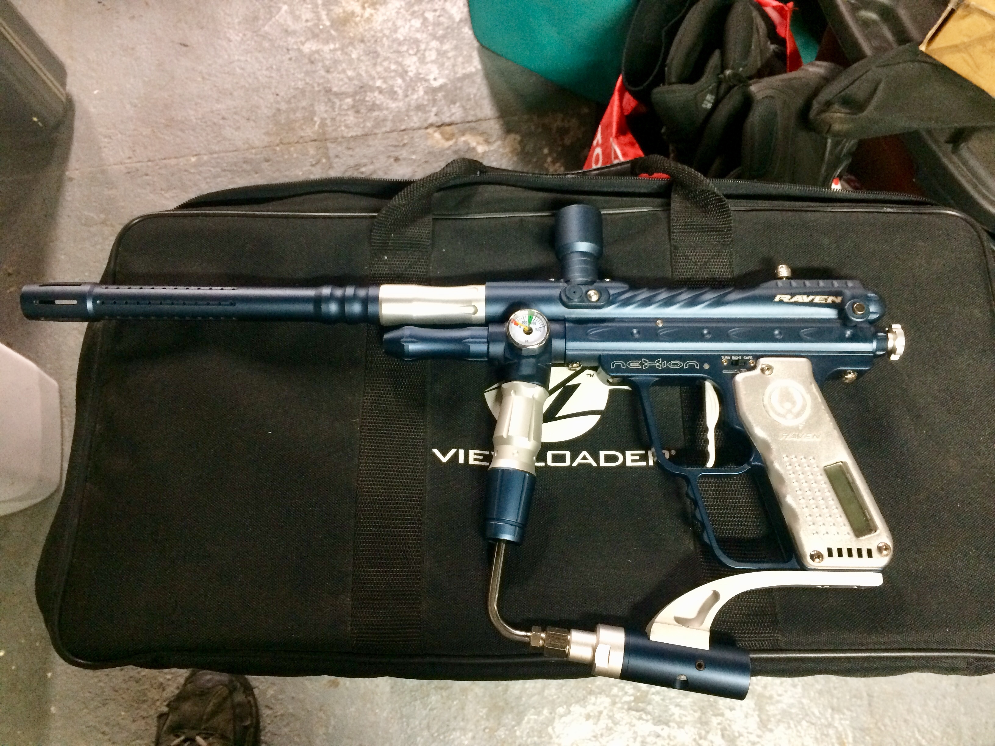

        Updated with a pic fresh off a rebuild! Minor ano fade in some spots from dried paint, corrosion on the clapper noid, and some minor dings, but overall its in pretty darn good shape.
        I realized that the body is heavily inspired by rippers, or the cobra angels (thinking more so the cobras). I like the milling a lot. In my opinion, this is probably the nicest milled stock spyder available.
        Interesting facts:
        - Grip panels are aluminum
        - Grip frame appears to be milled - no signs of casting (seams or finish)
        - The top tube has a rear plug... that is threaded into the body. So the quick strip pin is completely pointless if you keep the top plug installed.
        - Its a model made before catalytic converters so it will run good on regular gas.
        - Feedneck is clamping! Just a pinch bolt, but I'm easy to please.
        If I can get the board manual that would be nice. But it's not needed. Its only two function buttons. Everything seems to work; except the battery. It airs up, holds air, and cycles properly for 1 or 2 shots before the battery throws in the towel. Including the battery that came with the gun, I have 2 JAVA batteries and a powerex. The powerex seems to be slightly better than the JAVA batts, but its I think its toast to. 3 shots per battery ain't gonna cut it. Guess I can't be called out for shooting too fast though, lol.

          Definitely not the capacitor. I replaced it just because I had a couple of spares. Same issue. Just for the heck of it, I used my multimeter to check the output voltages of a bunch of 9v’s and the 3 rechargeable I have. The rechargables are between 11.25 and 12.6v (odd). The good 9v’s are at 8.8-8.9v.
          So I threw in the best 9v just because.
          It functioned properly and I was able to give it a little rip, check the velocity, etc.
          Well it’s definitely batteries, lol.
