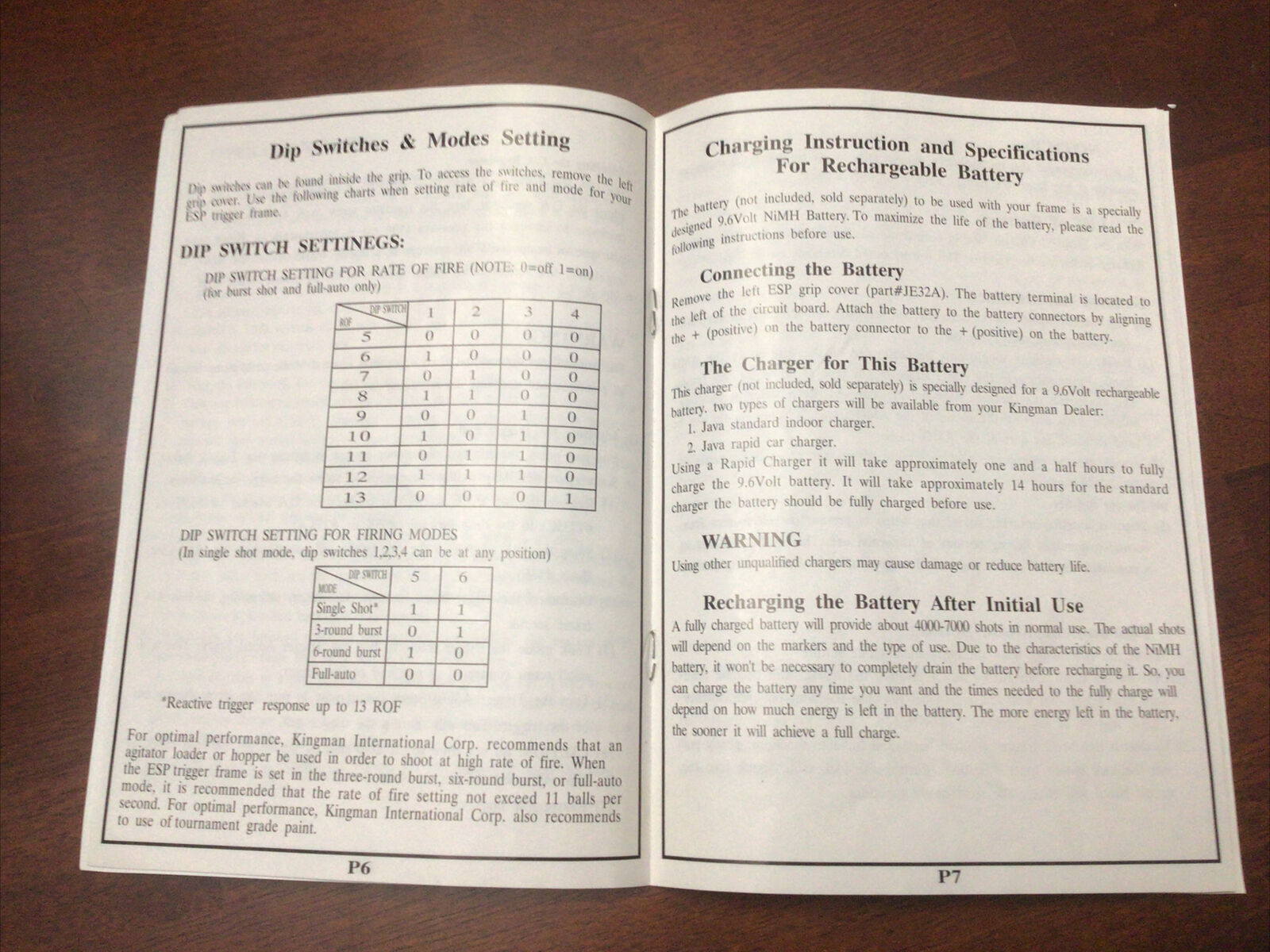

    I found out using the AMG manual that LCD boards in the various other spyders with LCDs are NOT adjustable in semi only.
    Only the full auto and burst modes allow you to adjust ROF. It wouldn’t surprise me if the primal/em1 boards had the same stupid logic.
    can anyone confirm this in non-LCD boards? It’s been so long since I have tinkered with them.

    Here is the settings diagram per the manual for my AMG with the non-LCD board.
    • ChoSanJuan
      ChoSanJuan commented
      Thanks, but no dip switches on my board. 😟
      scottieb commented
      Oh yes, I'm aware. And I apologize for the hijack. I was posting the pic for Tony. I should have quoted his post. That would have been a more clear way to answer his question.

      I know it is an old thread, but here it is in case someone needs it. I made a PDF from the physical manual I have. Enjoy.
