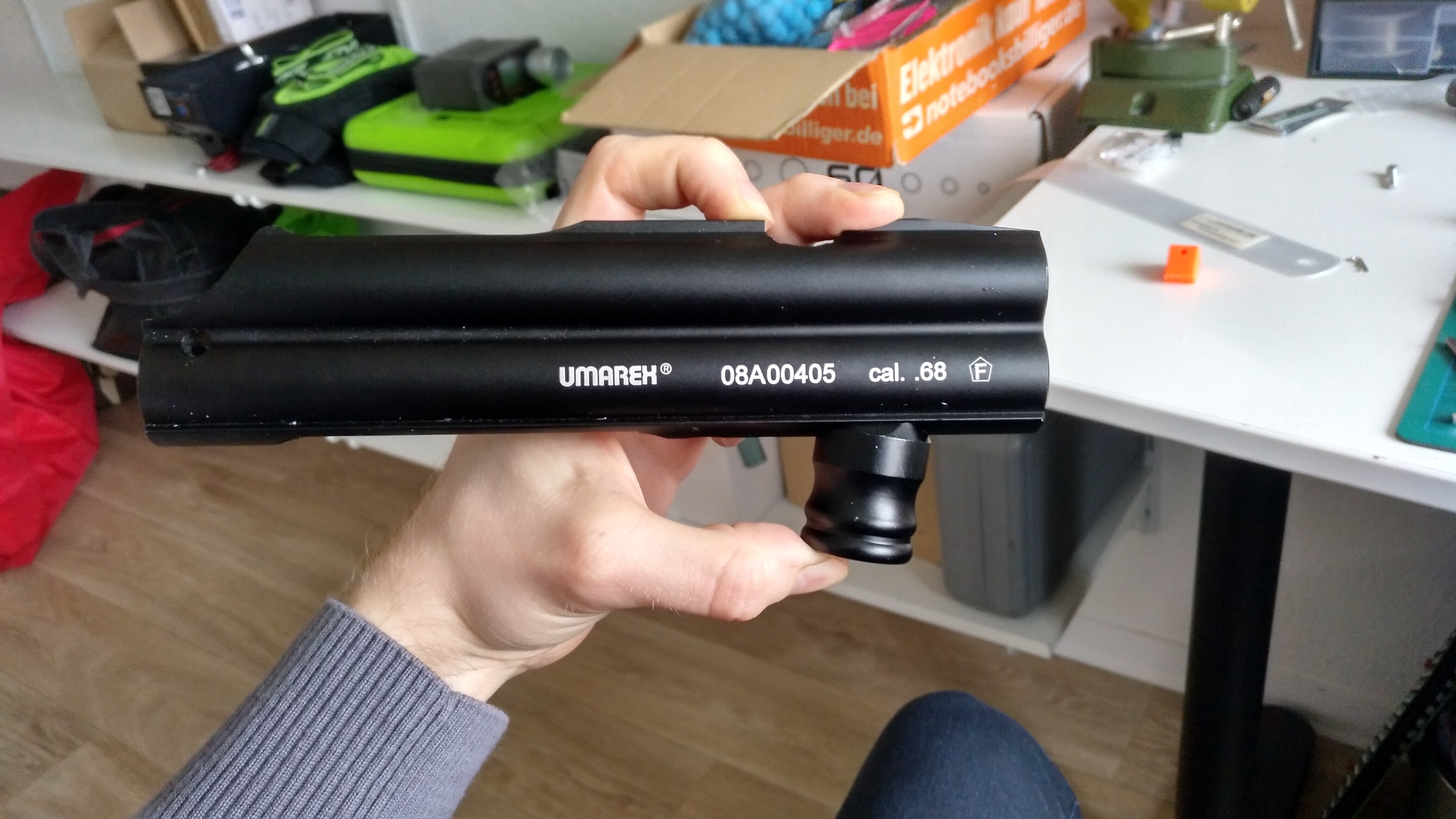

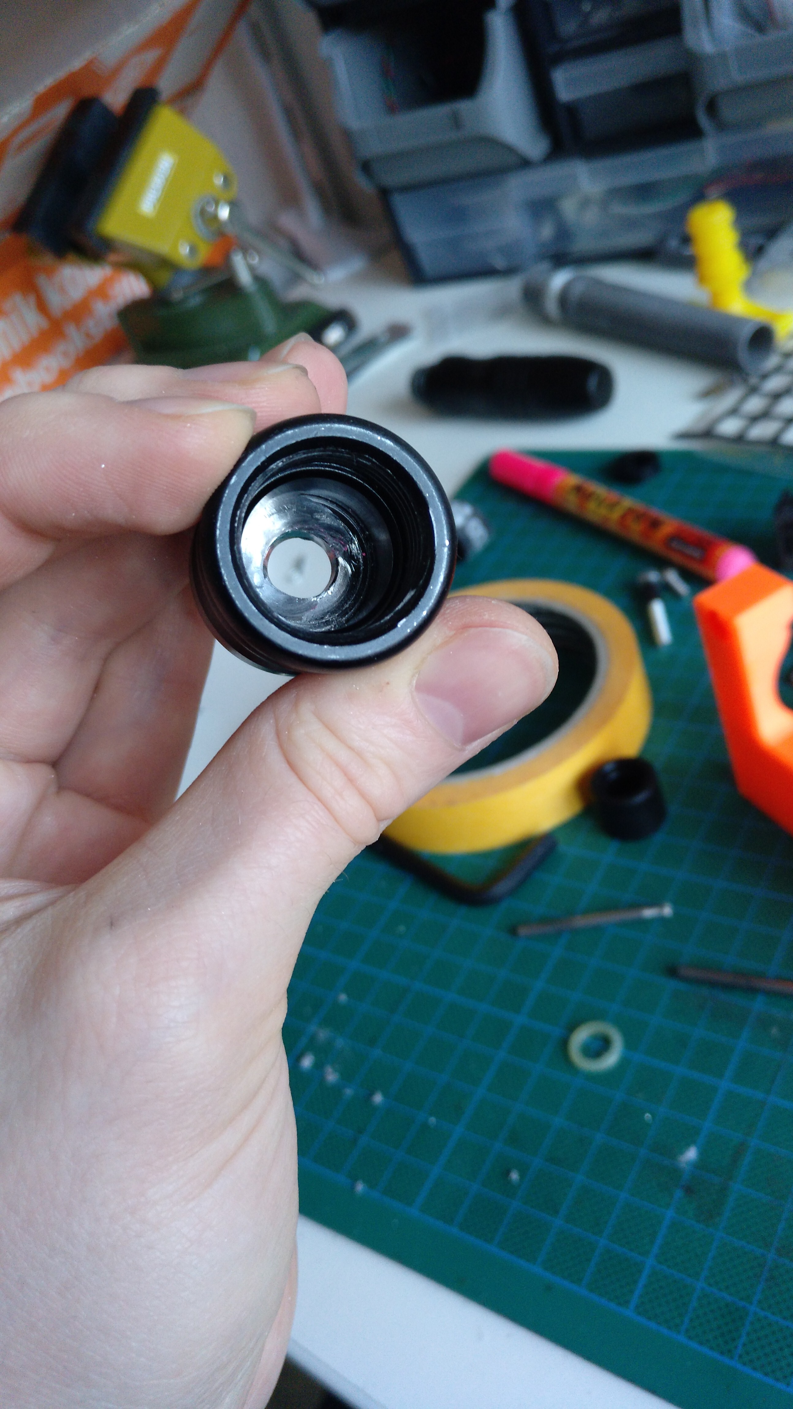

    So this is a mod that I had in mind ever since I first disassembled this gun after I bought it.
    Click image for larger version  Name:	IMG_20220410_164859_073.jpg Views:	0 Size:	1.76 MB ID:	257413
    The Vertical adapter that Is usually angled forward easily fits on in reverse - If it weren't for its screw that is also angled.
    Click image for larger version  Name:	IMG_20220410_164915_641.jpg Views:	0 Size:	1.54 MB ID:	257414

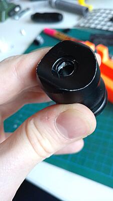

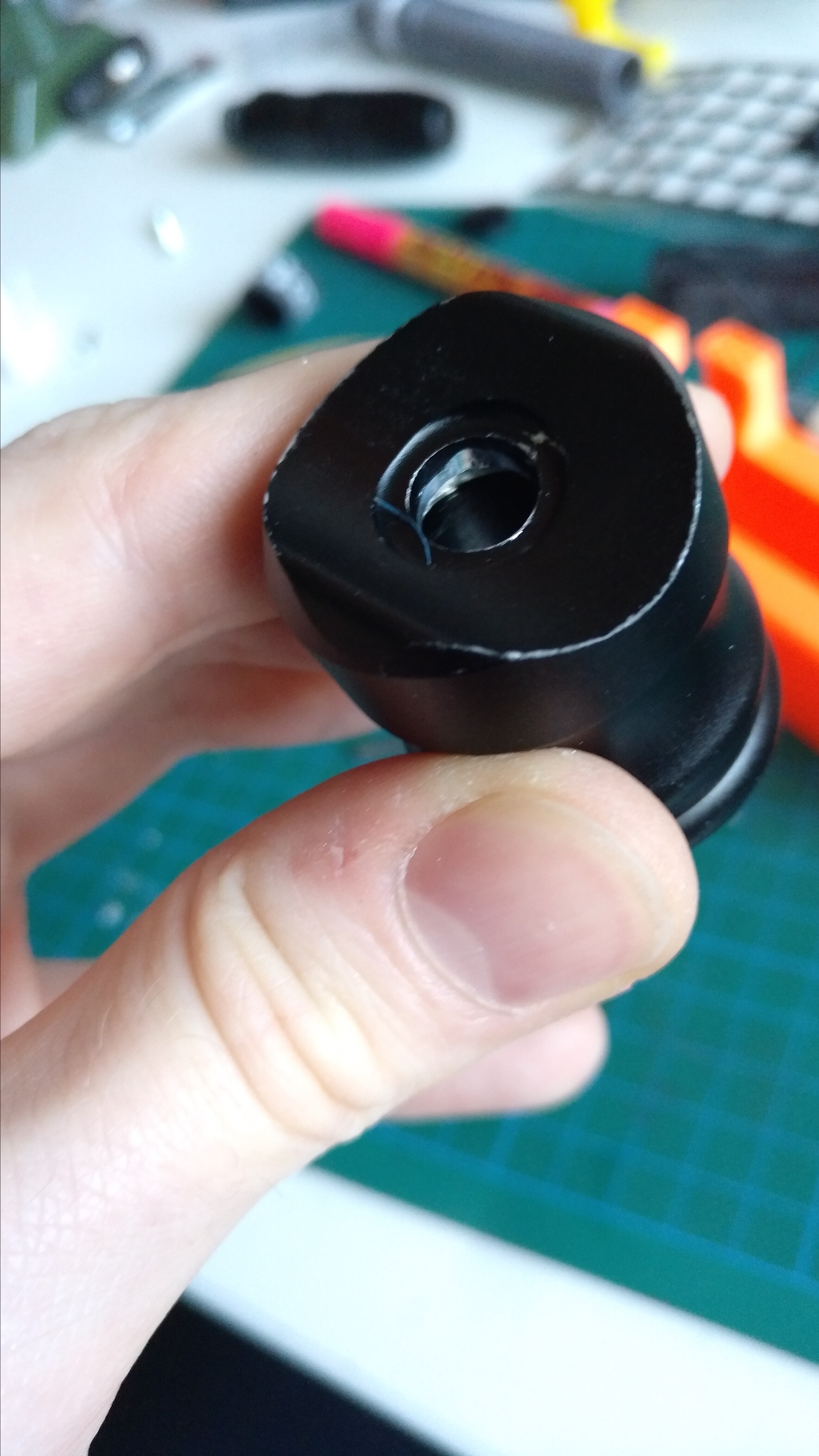

    This caused me to ditch the Idea at the time, but while prepping the gun for another mod I thought about it again and figured I could easily dremel out the insides of the VASA without having to worry about ruining the seal between it and the body, since its an O-ring that sits on the outside.
    So I started hacking away.

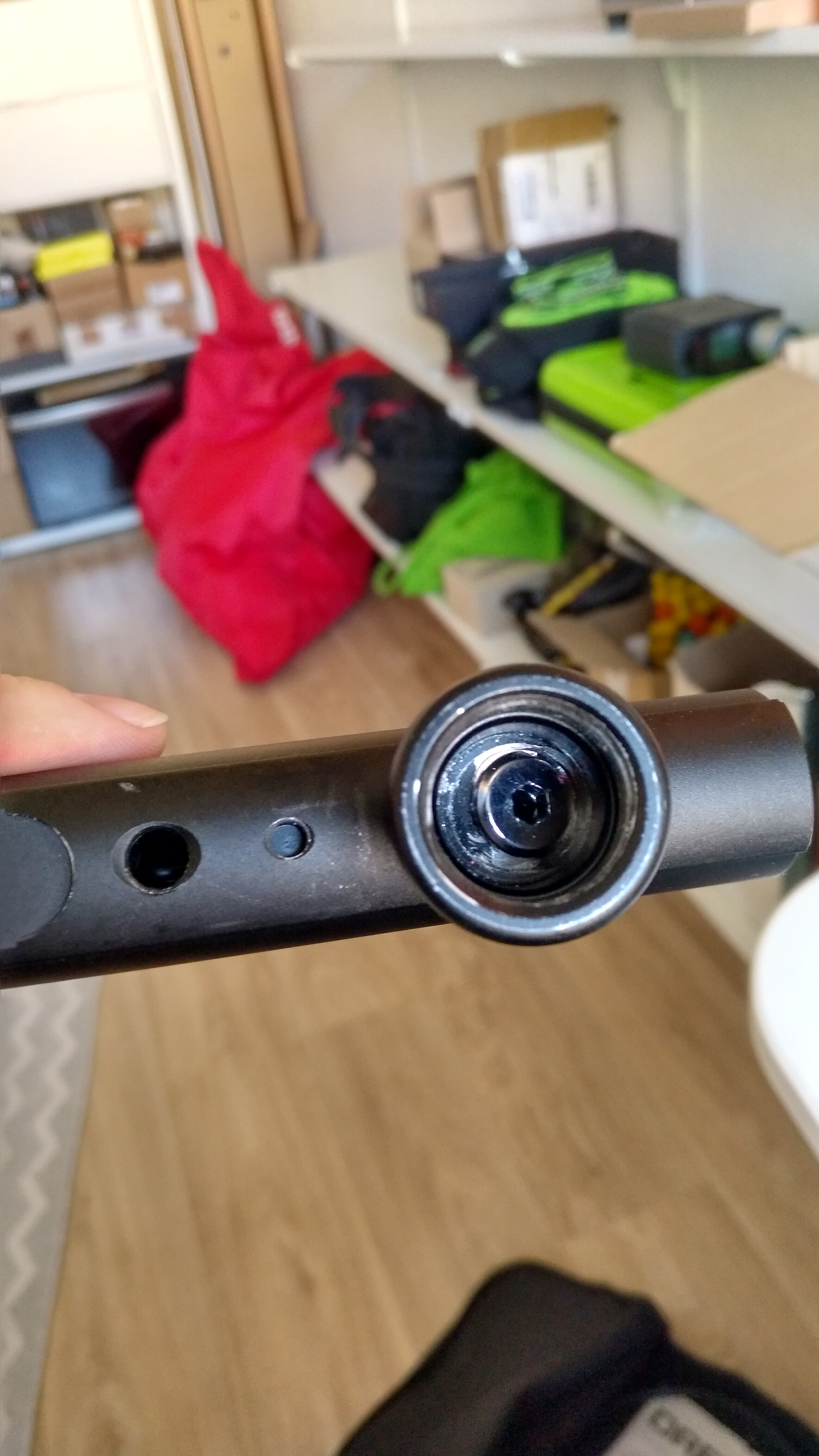

    Click image for larger version  Name:	IMG_20220410_170809_713.jpg Views:	0 Size:	1.58 MB ID:	257417 Click image for larger version  Name:	IMG_20220410_170743_000.jpg Views:	0 Size:	1.81 MB ID:	257418 Click image for larger version  Name:	IMG_20220410_170700_001.jpg Views:	0 Size:	1.65 MB ID:	257419

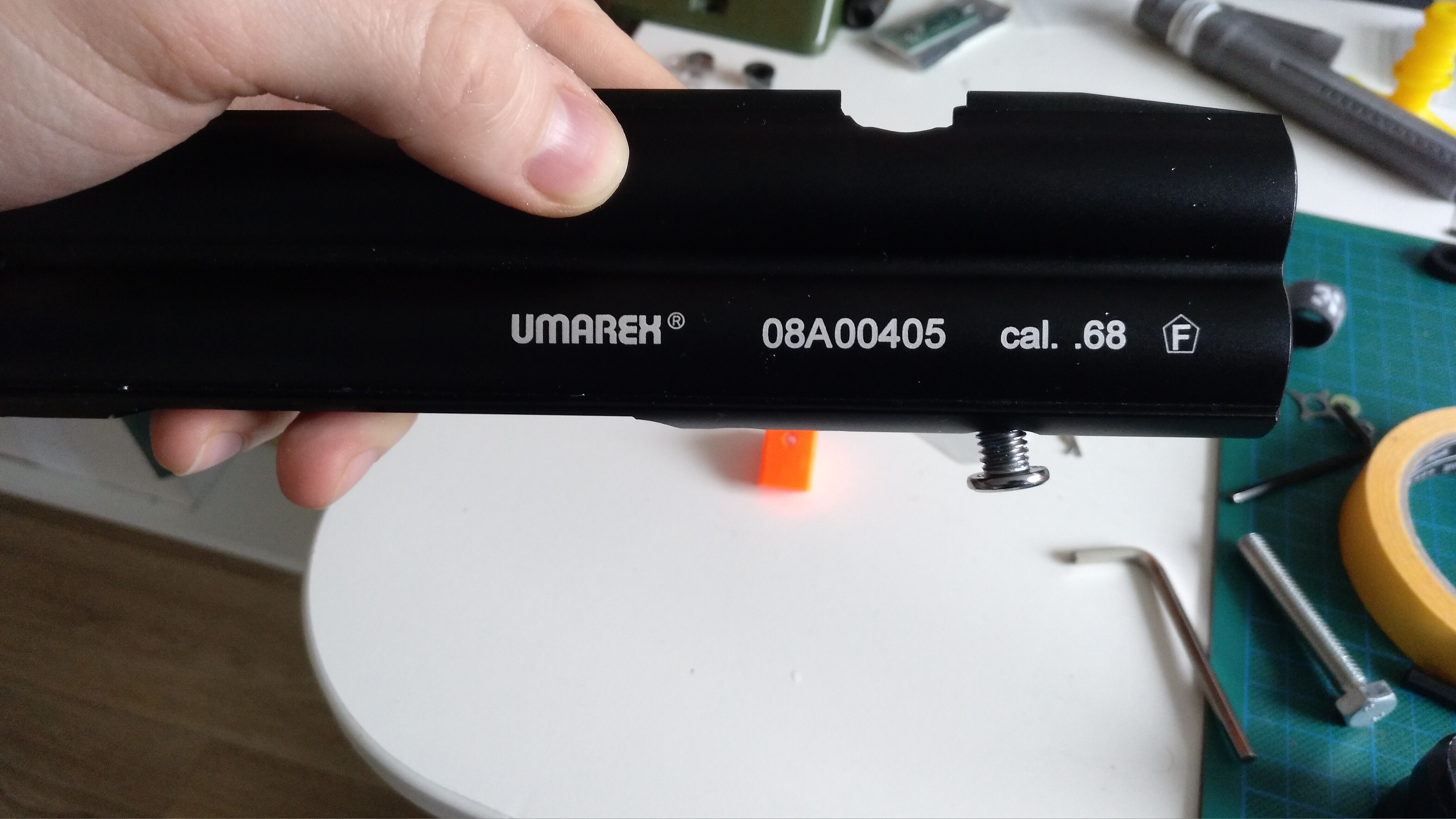

    Et Voila:

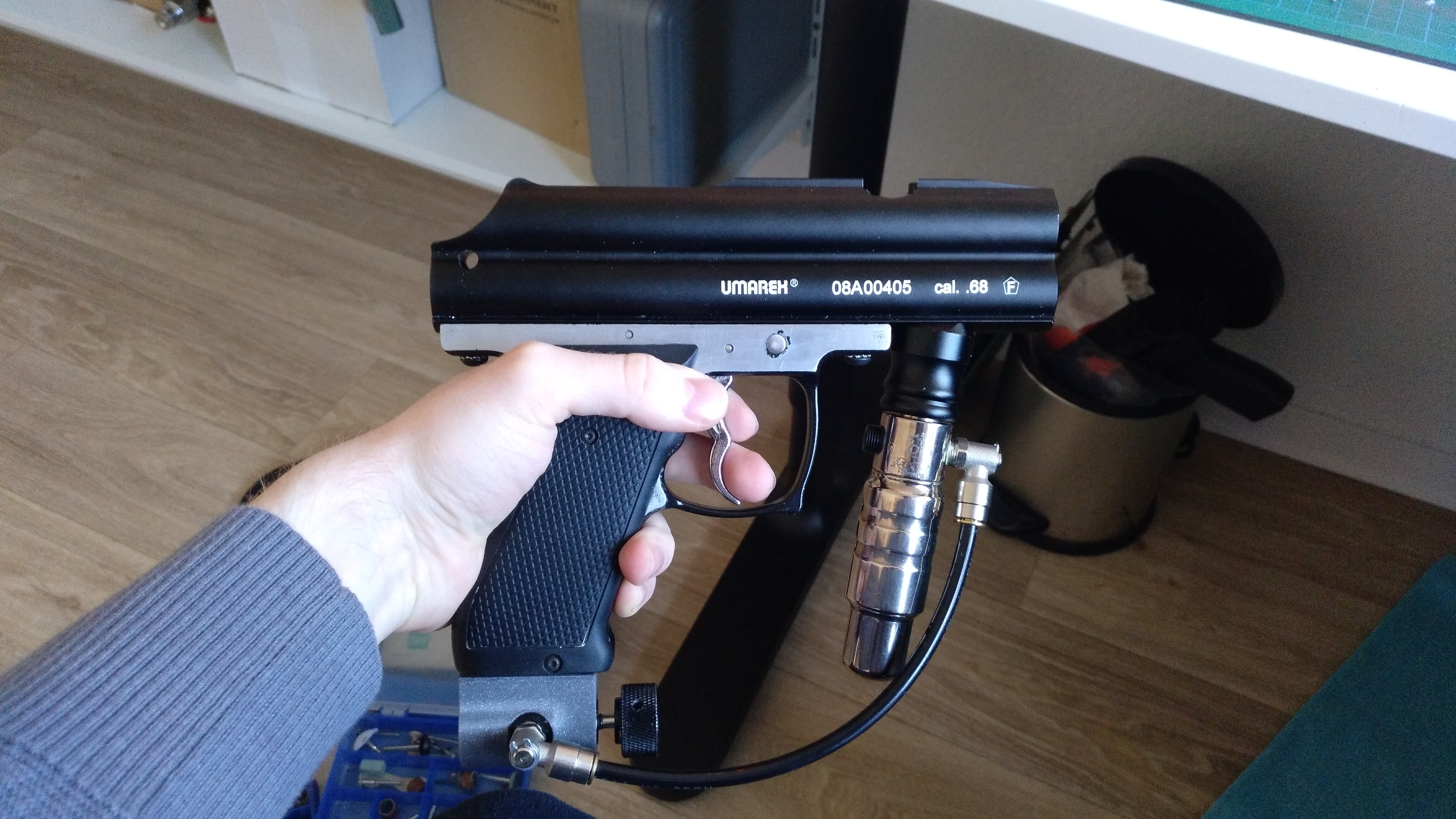

    Click image for larger version  Name:	IMG_20220410_170602_941.jpg Views:	0 Size:	2.23 MB ID:	257420
    It lines up beatifully with the grip and the 90° Fitting will sit beatifully between the trigger guard and regulator (once I shorten the macroline).
    The new angle looks much sleeker and will suit the pump-setup better.

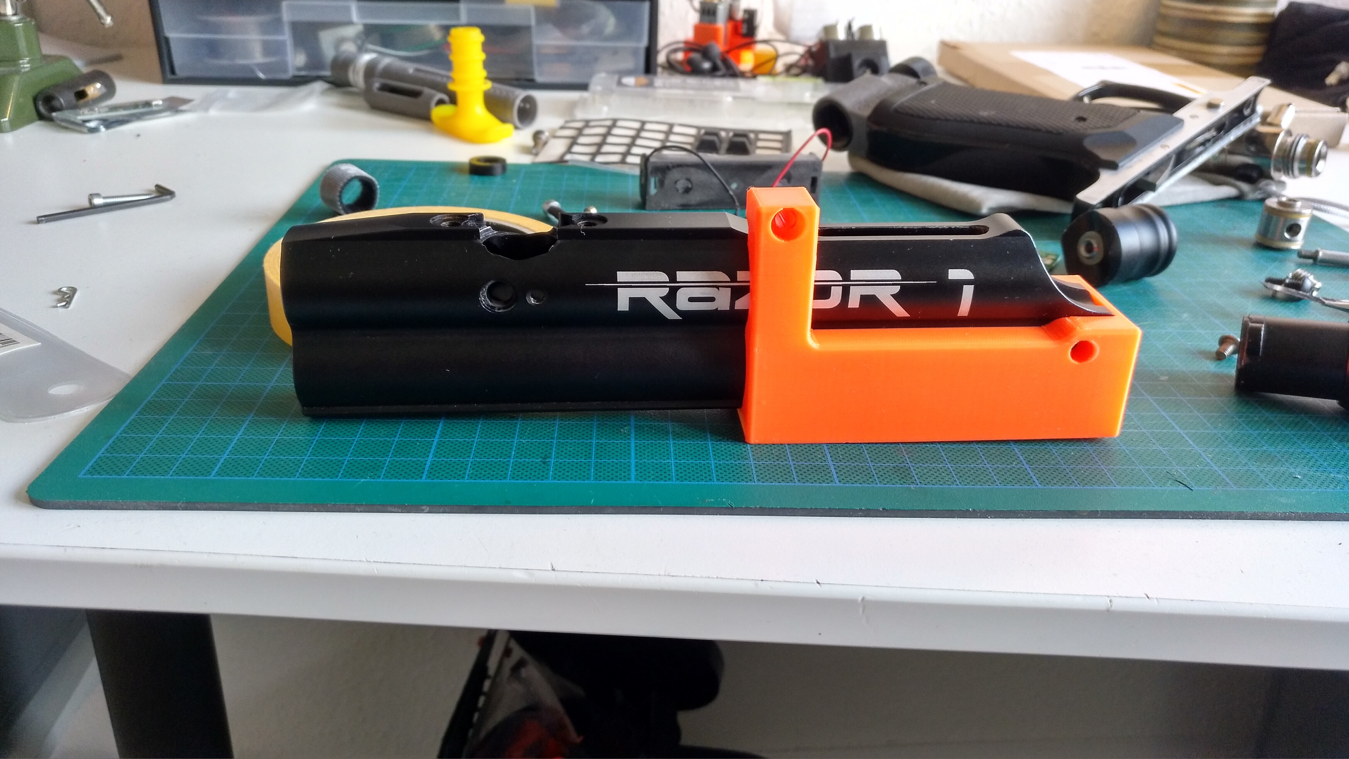

    Now onto halfblocking it.
