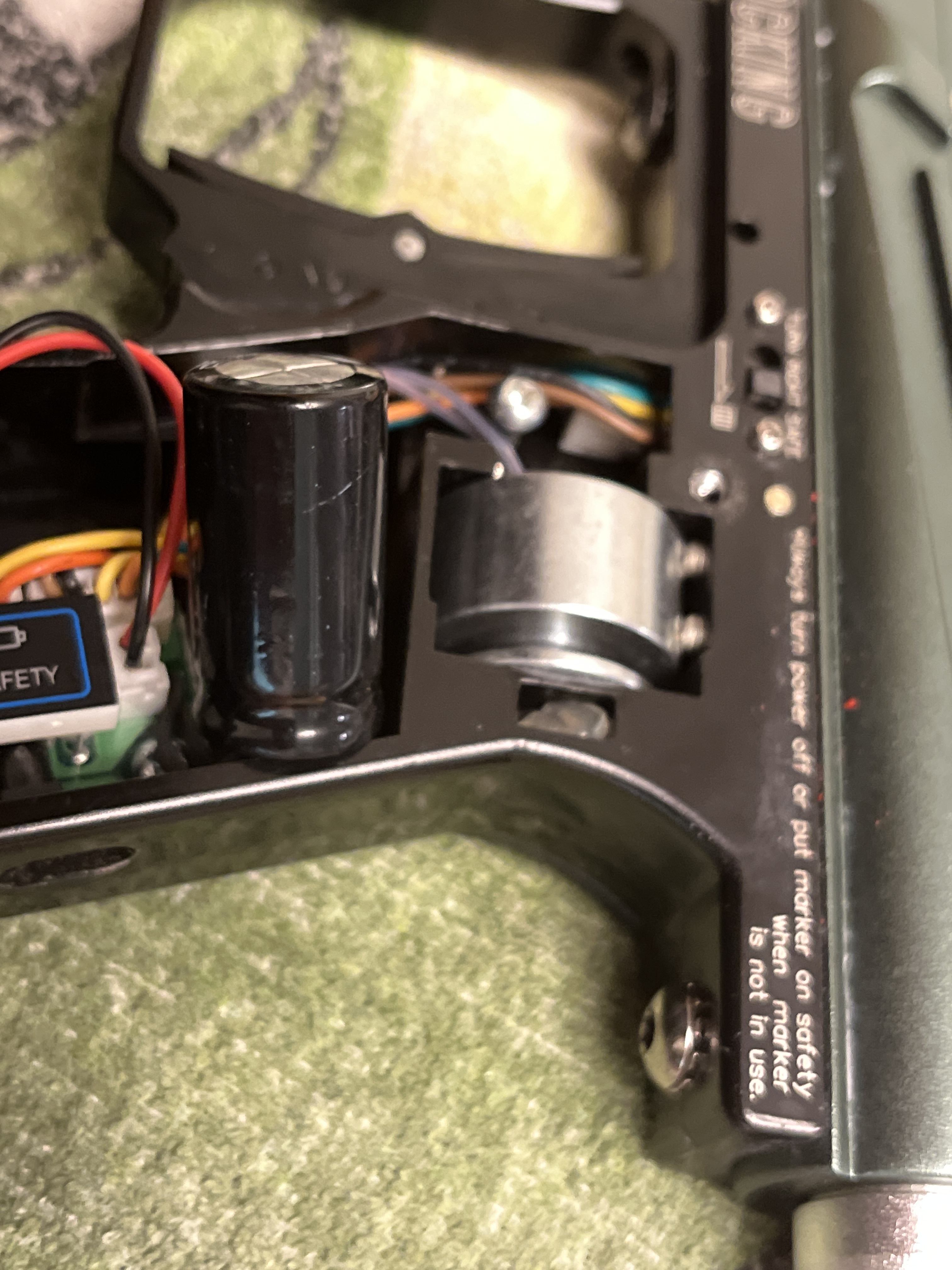

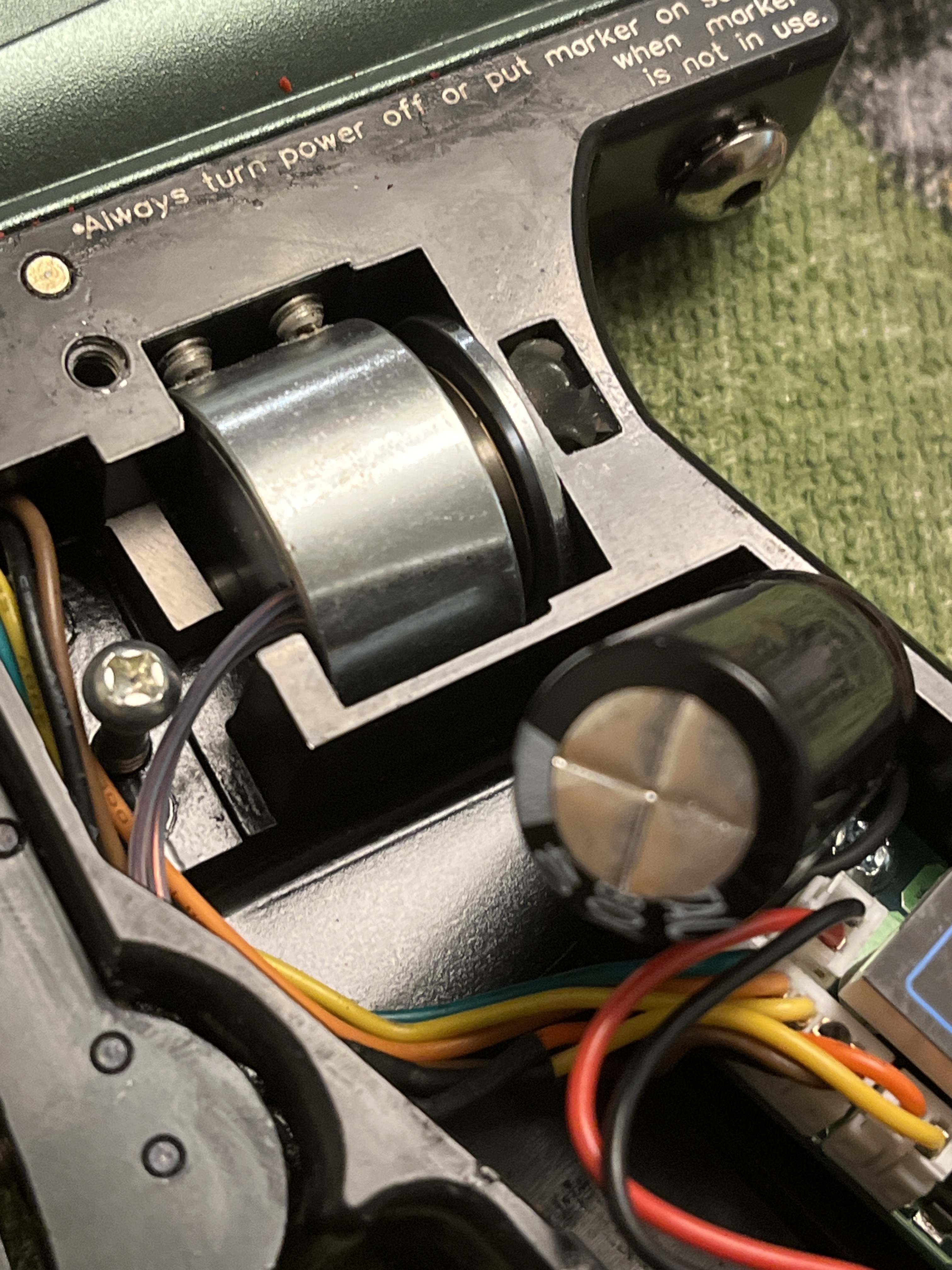

              Glad I found this discussion. I’ve been t-shooting a Rodeo with a rocking trigger frame and cannot for the life of me get it to trip the sear, even on a 9.6v battery. My other swing e-markers work just fine.
              We’ve tried:
              1. 9.6v NiMH batteries
              2. 9v alkaline
              3. 9v (8.4v) NiMH
              4. Different spring combinations front & back
              5. lubed and new o-rings throughout
              Essentially we either get a sear that won’t trip OR velocity that maxes out at ~220fps​
              The capacitor looks fine, and the clapper noid isn’t corroded or anything. The board lights up and seems to be happy. Anyone have an idea about what the issue might be?

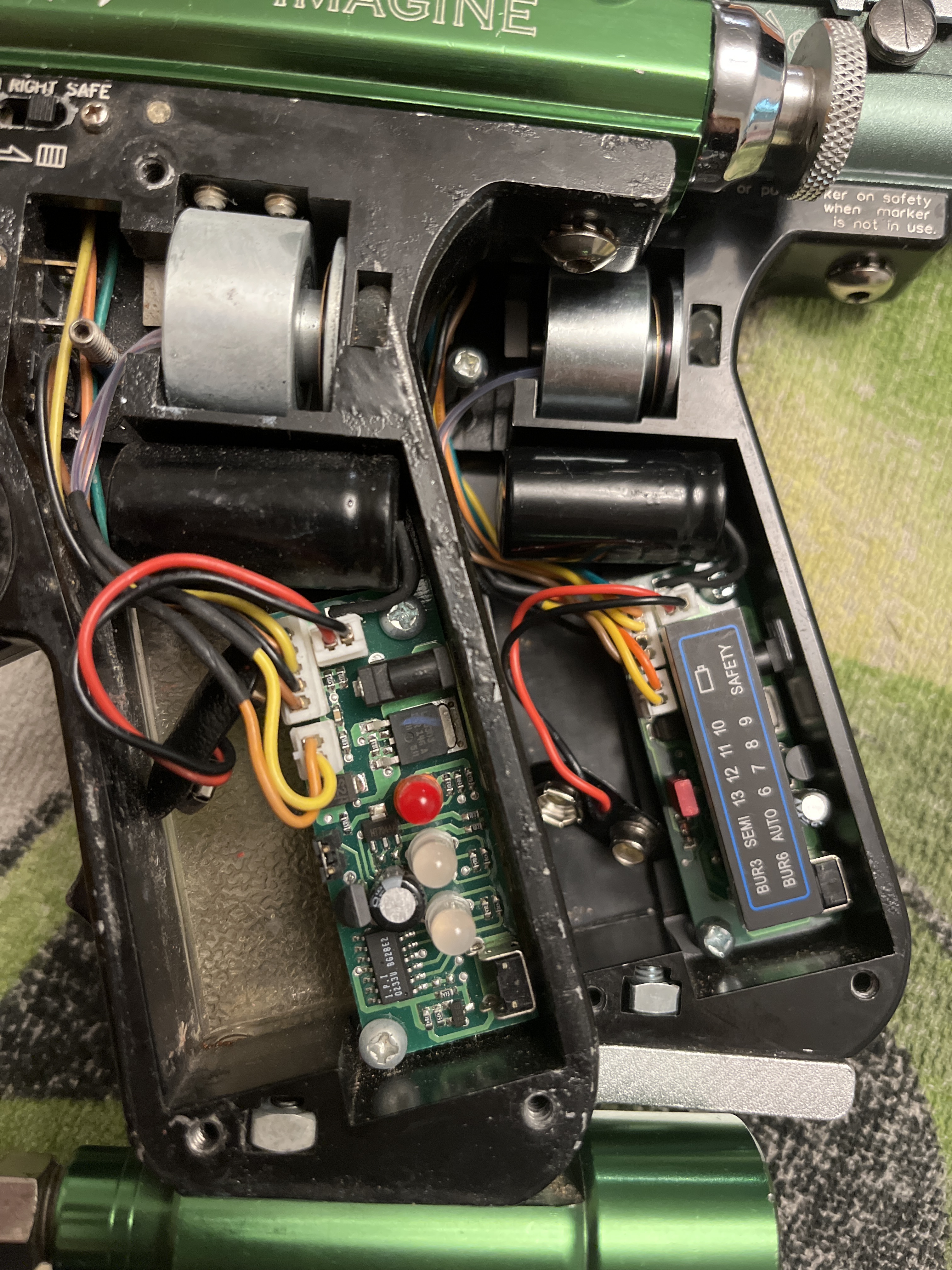

                But a the idea of a board swap isn’t a bad one… there’s no difference in connectors between an old Imagine (left, big LED indicators) that I have and my friend’s RT Rodeo (right, lighted firing options LED board)
                Edit: the noid is fine - swapping these boards got the gun to cycle with the heavy spring, so there’s something wrong with the capacitor or board on his rodeo.

                  It could very easily be the cap. I do electrical work, and I replace non-exploded caps all the time. If you have a meter, you can probably check the capacitance.
                  • lhamilton1807
                    Friends paint friends
                    • 1153
                    That’s what we figured would be the next step. I don’t have a fancy tester, but a cap can’t be that much, and I know I can solder it for him. If that doesn’t work, I’m sure we can find a donor or replacement gun somewhere.
