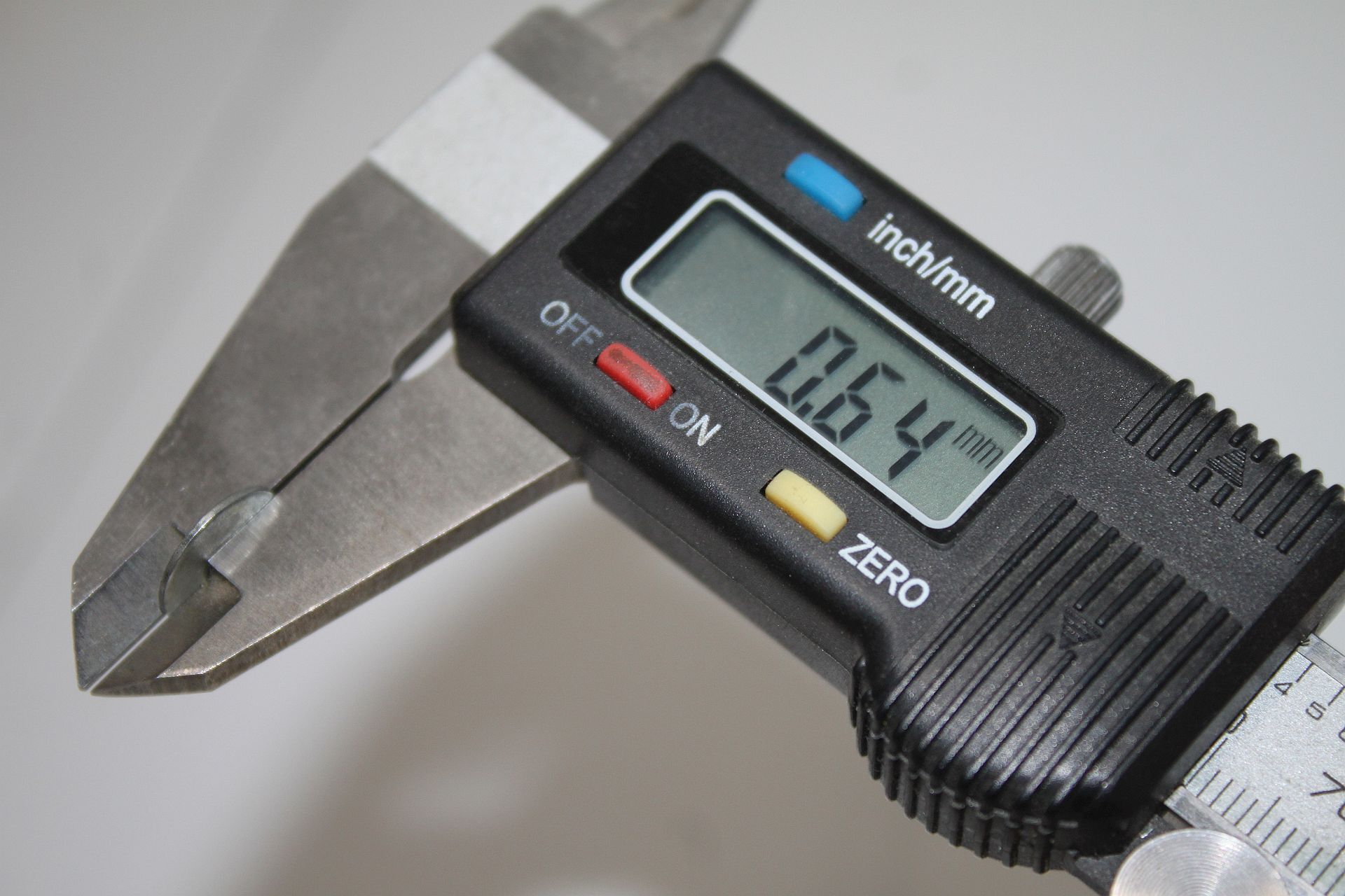

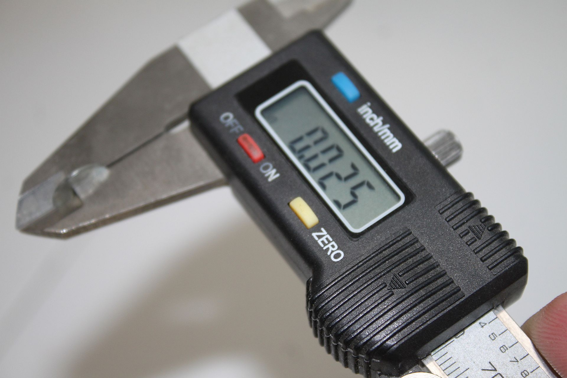

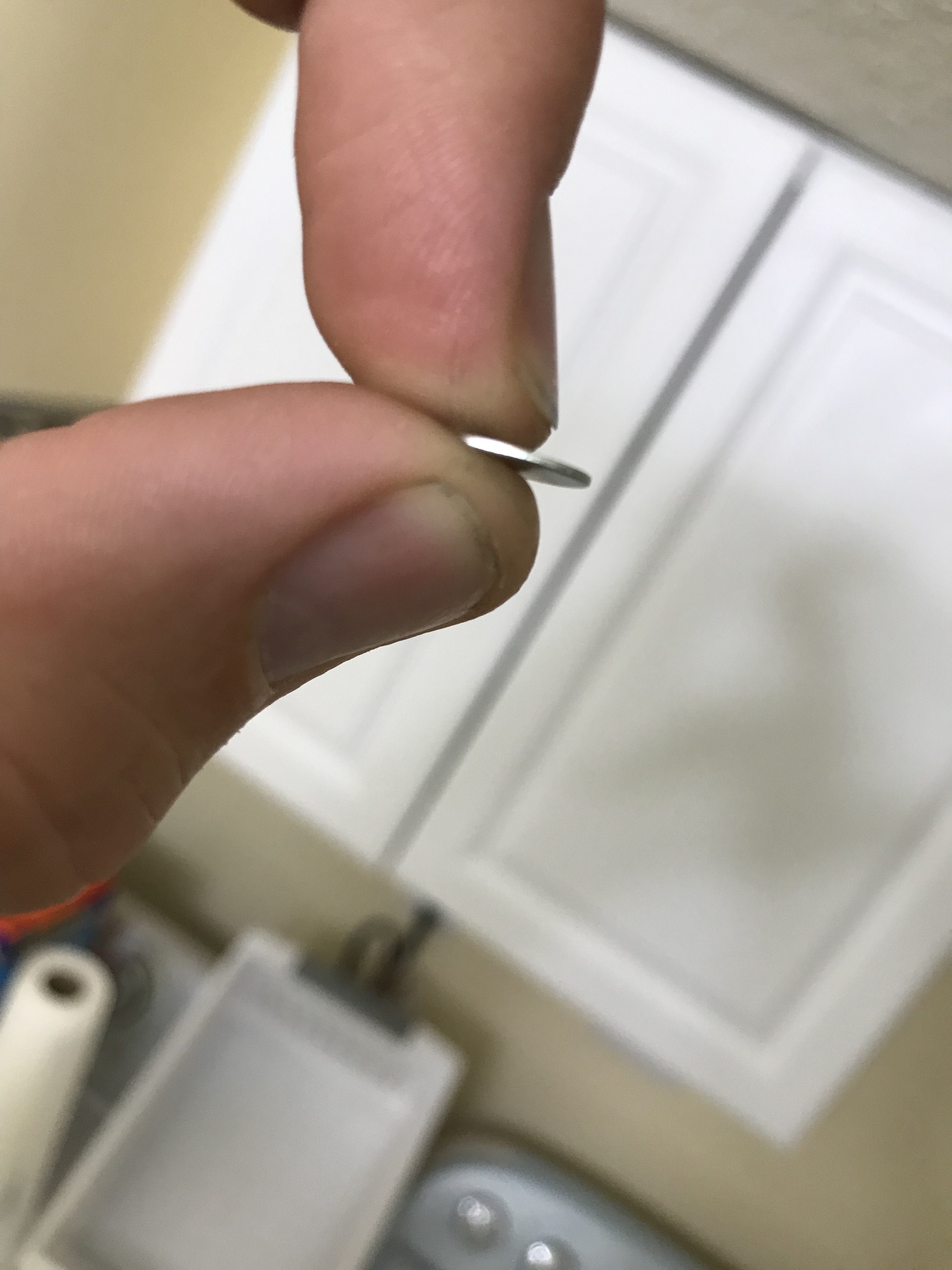

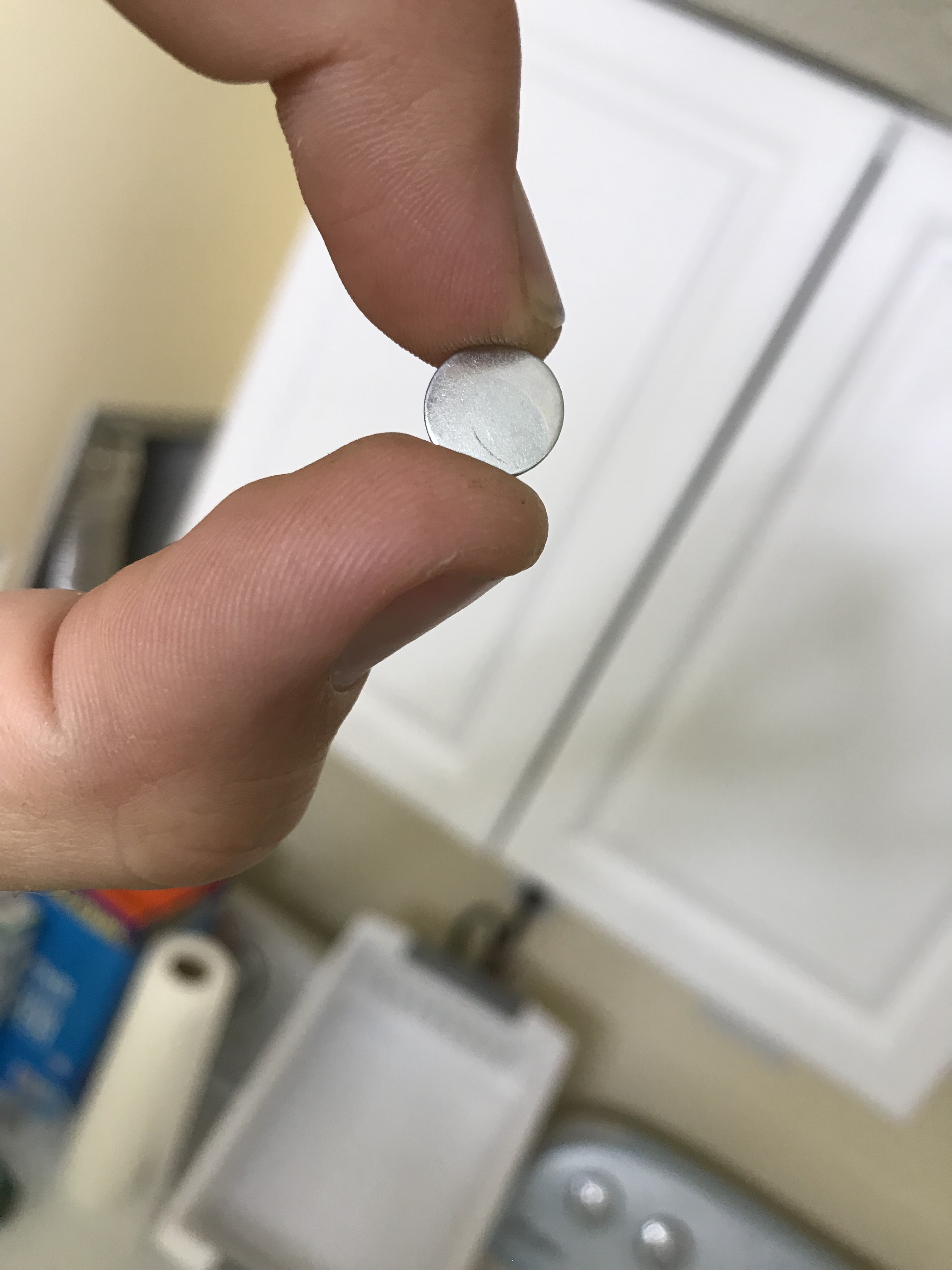

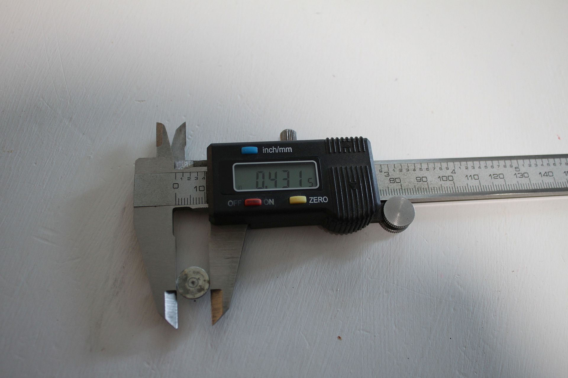

          The discs measure in around 11mm (7/16") in diameter. I haven't calipers so I used a tape measure. They are just under 1mm in thickness. Unsure of the material but one would think it's cheap-o steel. Here are some pics:
          Click image for larger version  Name:	C6CE65DA-FF34-4EE2-AF73-CF3985998205.jpg Views:	0 Size:	1.72 MB ID:	455993 Click image for larger version  Name:	6710F6A9-1876-44DF-A1E9-C29445250A92.jpg Views:	0 Size:	1.59 MB ID:	455995 Click image for larger version  Name:	C9CCEABA-12B7-4551-9E51-DC7778B1EEB3.jpg Views:	0 Size:	4.04 MB ID:	455994
            They stick to magnets so I would assume cheap o steel

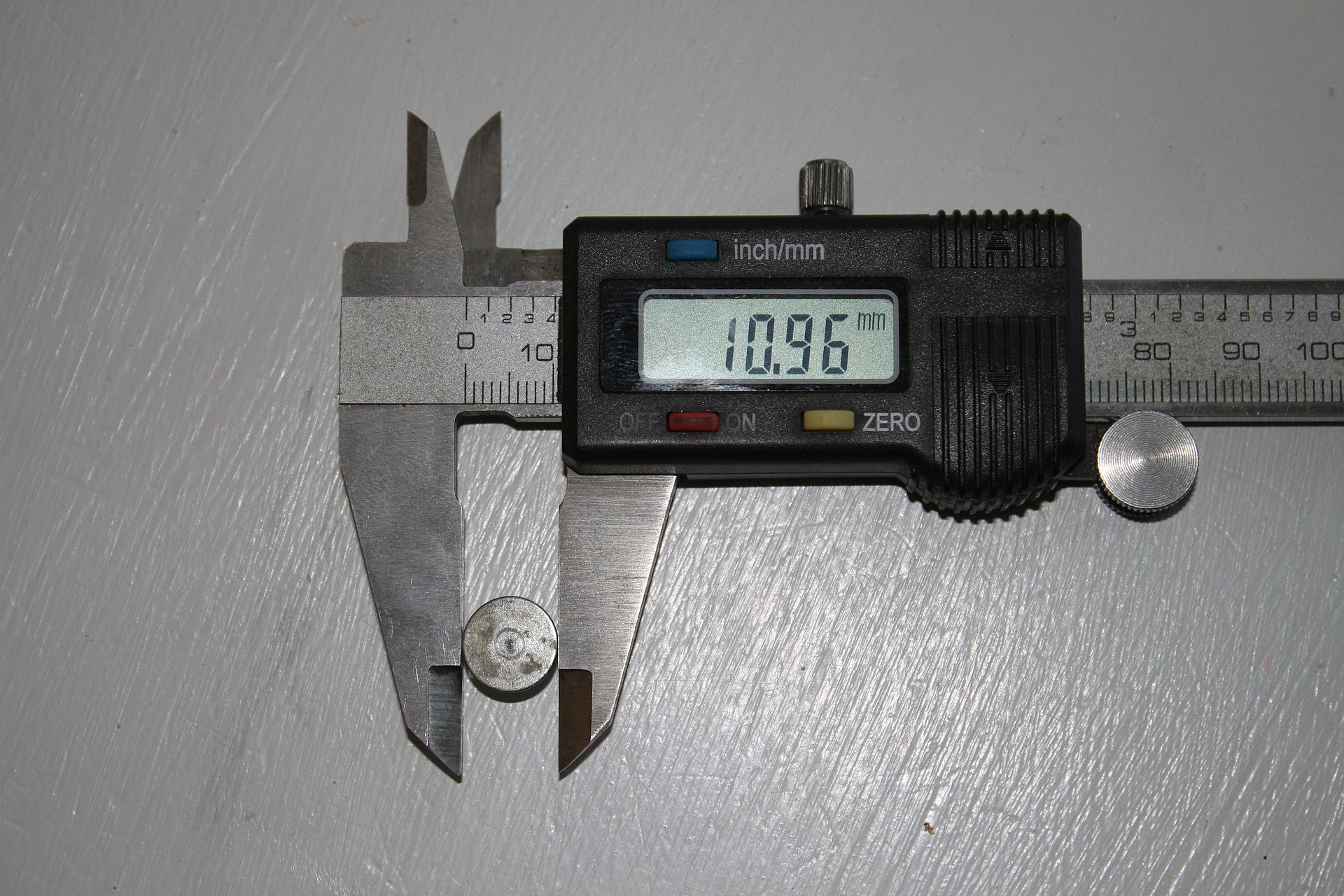

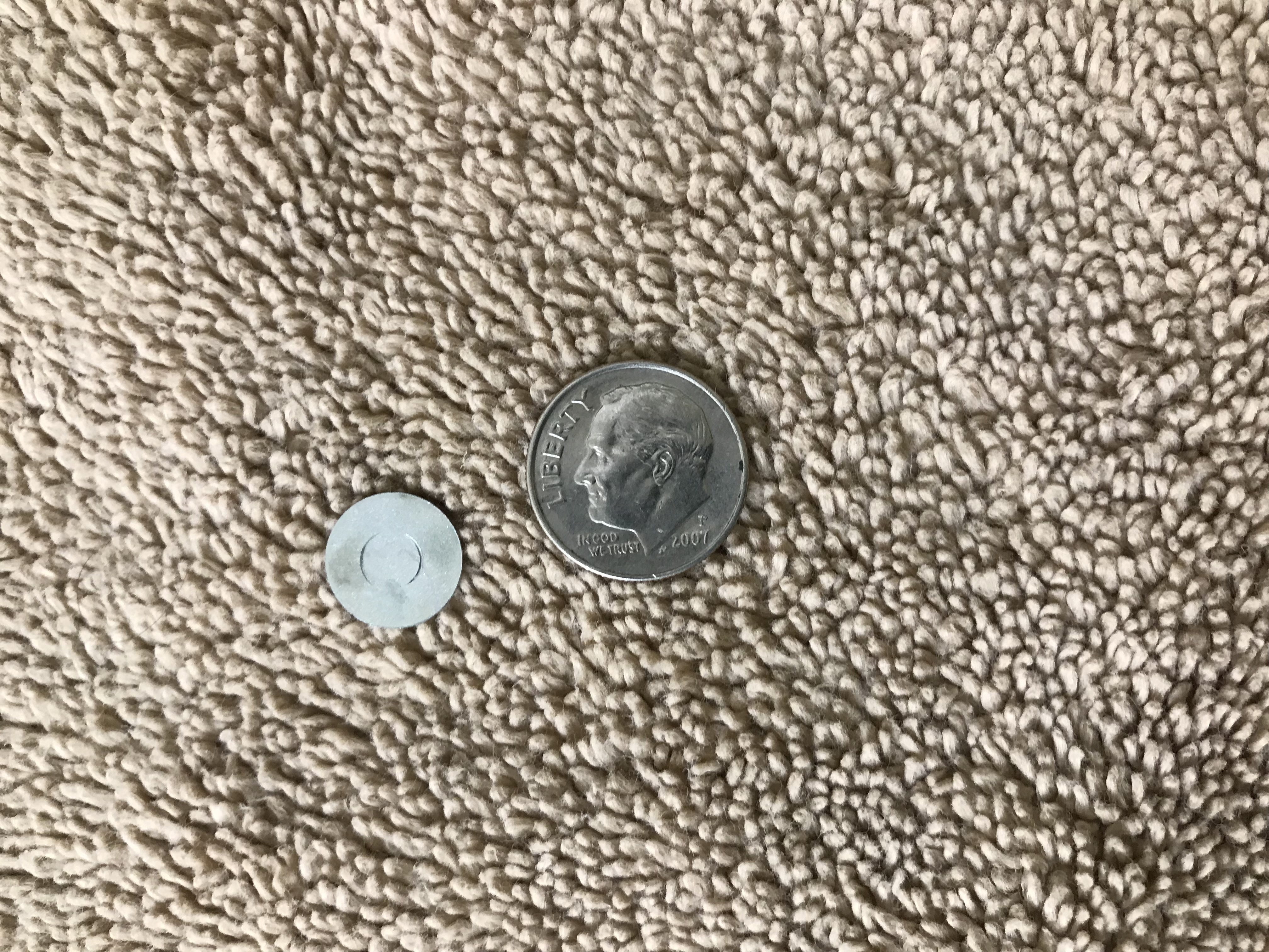

              Got a hold of one of those discs and a big thank you to Scotti for getting that to me so I can get my old spyder up and running. So +1 on to him for that.
              I took some pics of the actual dimensions. In case anybody in the future wants to make some.
