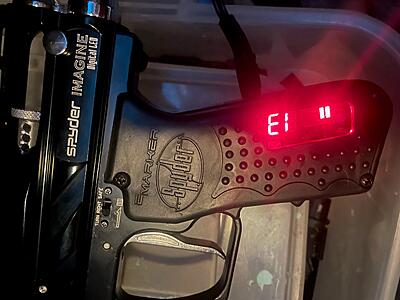

    Imagine Digital LED board settings?
    Picked this up on ebay, didn't come with a manual and everything I can find online is for the non-digital LED board, can anyone help me out with how to find and change the settings?

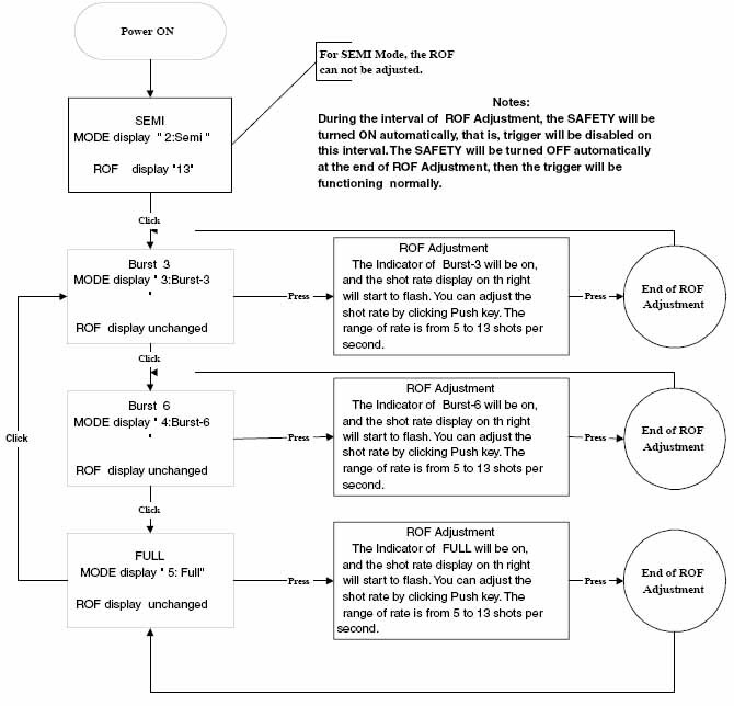

    The Google fairy visited me in my sleep, found it on a site from 2007 that's somehow still up It was under the instructions for a Spyder Electra:
    Spyder Electra DX Digital LED Panel (D.L.P) Specifications and Operation Diagram
    1. The D.L.P has one push key for adjustment and one LED Array for Mode Indicator, and two digits LED to display ROF.
    2. For "MODE" indicator, the LED Indicator shows following functions: ( From left hand side to right hand side, the left hand side is the side near push key. )
    (1). Battery Low
    (2). SEMI
    (3). Burst-3
    (4). Burst-6
    (5). FULL
    3. For "R.O.F." display , the rate of fire can be adjusted from "05" to "13", that is the rate of fire will be ranged from 5 shots per second to 13 shots per second. But for "SEMI" mode, the "R.O.F" display will be fixed on "13" for reactive trigger response up to 13 shots per second.
    4. When Power turns ON, the defaults will be Mode ="SEMI" and "R.O.F" = "13". All settings can be adjusted while power keeps ON. Any adjustments will be lost when Power turns OFF.
    5. The "Battery Low" Indicator will keeps OFF during normal operations. When the capacity of battery dropped to about 1/3 of the battery full capacity, this indicator will be turn ON.
    6. The D.L.P also equipped with a "LOCK" function. A short-circuit plug located on the internal circuit board serves this function. When this plug had been pulled out, the MODE will be locked to SEMI, and cannot be adjusted.
    7. Operation Methods:
    Press, Push and hold the key for over 2 seconds, then release the key.
    Click, Push and then release the key. The duration should be less than 1 seconds.
