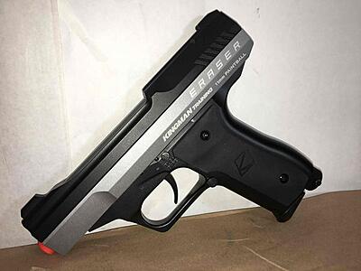

                          Ratzkie Found one on shopgoodwill
                          Kingman Training Eraser 11mm Paintball Gun Description: Kingman Training Eraser 11mm Paintball Gun   Brand : Kingman Training    Approximate Measurement: 9" x 7"   Material: Unknown   Condition: Item is in decent condition, no...

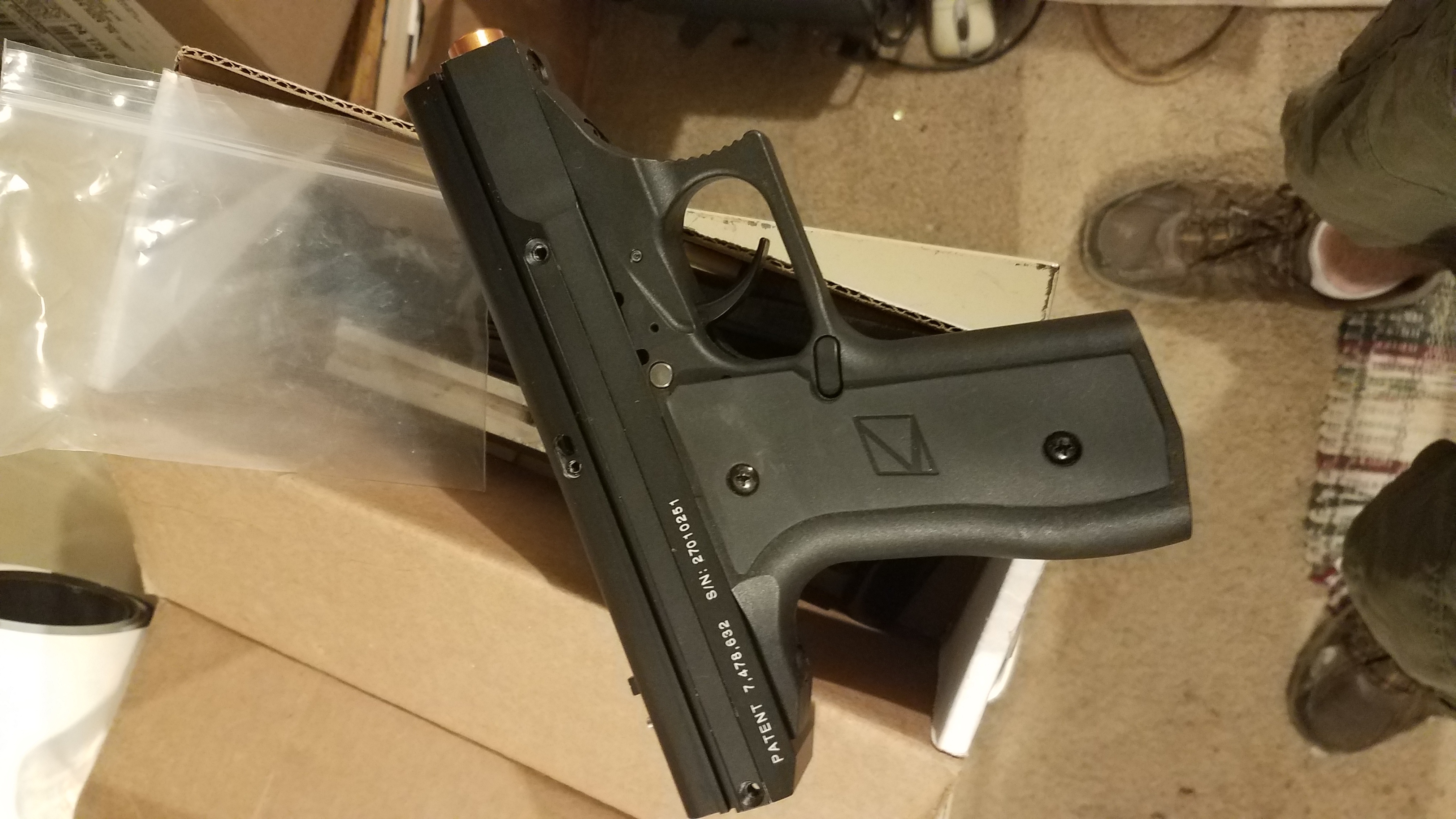

                          I picked upt he bodies on thursday. Here's the scoop.
                          He only did one, because the machinist noticed that the breech hole blew out and he doesnt know what this is or how it works so he dodnt want to ruin the second one. Jokes on him, the breech is all closed up with the angle adaptor block. So no issues there, other than light clean up with a dremel.
                          I just got done reassembling the marker (it's been 9 months, it took me a few minutes lol), and it appears to be working other than a super loose bolt. So that's the next step is to get a correctly sized bolt. I'm looking at like 12 or 12.5mm rod and then doing orings for increased sealing.
                          After that, I can test the other stuff we talked about, getting the fps up to something useable (hopefully 280!). Click image for larger version
