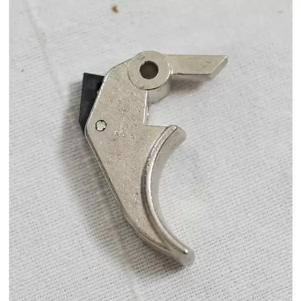

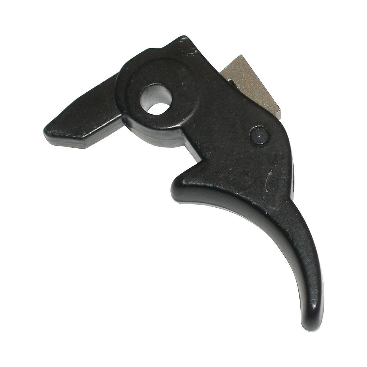

        I've put a couple blast frames together myself, never been a fan of doubles. my guess is that the pre 98 trigger is drilled to center and post 98 is offset.Bacci's image shows a centered hole.
        I&I's shows a offset hole.
Name:	only-2-39-usd-for-skinny-mechanical-spyder-metal-single-trigger-black-online-at-the-shop_0.jpg

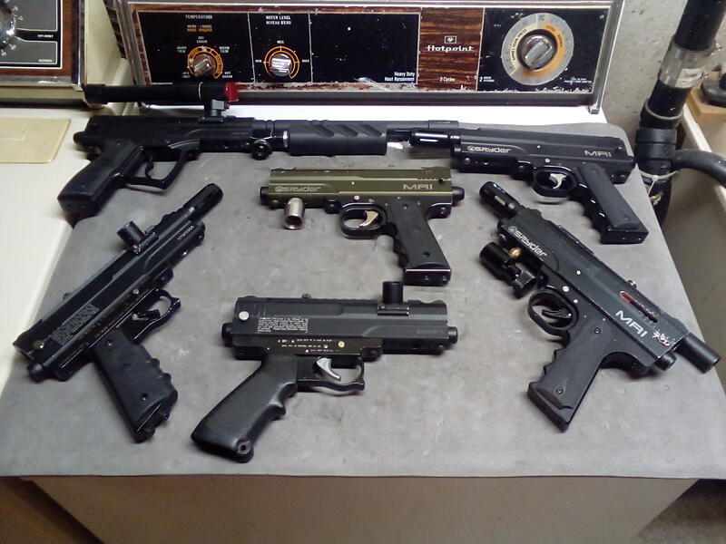

        When i've had to source a trigger, i used bacci's as some items from I&I's were not available to me in Canada, other then that i've used any double trigger frame to source sear,springs,pins. if it had a plastic trigger sear i switched to metal.
        I've only been lucky once and recieved a complete trigger frame with all orginal parts(top right). Hope this helps and good luck with your build.
