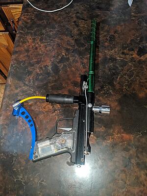

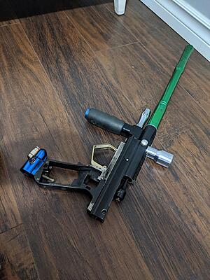

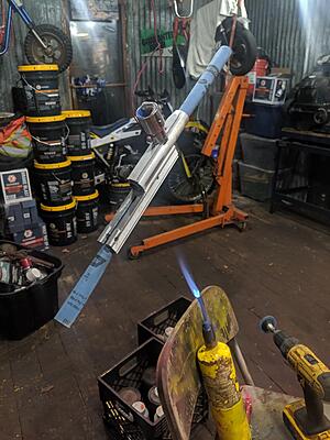

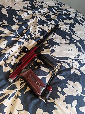

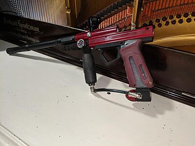

    Been working on my old black dragun spyder clone, trying to make something cool on the cheap. It came out of the old bin as a spump I made about 12 years ago. I half blocked it back then but it really wasn't anything too special.

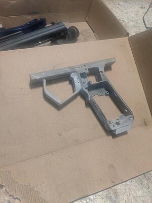

    i took a rocking spyder frame and cut the top part off to make a single frame, then soldered it together and smoothed it out. I also modified the drop forward into an asa. Stripped the anno and blasted the frame. I found someone locally selling off old inventory and got a forward and rearward front block, dye stickys, and a clamping feedneck. Besides finding a decent front grip I'm almost ready to figure out how I want to coat, or try to home anodize.

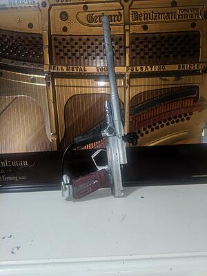

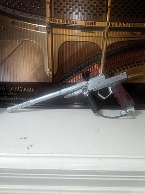

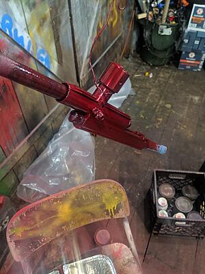

        Ya I have considered it, I hope to use this gun on co2, because locally it's hard to get hpa filled, for my other markers. So I would have to find one that works well with that. I started powder coating it yesterday
        • Surf2Live
          Blowback Throwback
          • 122
          • LBC
          A Stabilizer will do double duty with HPA or CO2. What color(s) did you choose?
          • Jmax857
            • Nov 2020
            • 17
            I did a dark red color. And a matte black on everything else. It came out very nice. It has an ion reg right now, and I believe I want to get vs2 internals to swap in to get it to LP. If I do that the ion reg will work. If not then I will look into something else. I was going to post it in custom markers I thought I might get more input into my internal question if someone else knows a bit about them.
