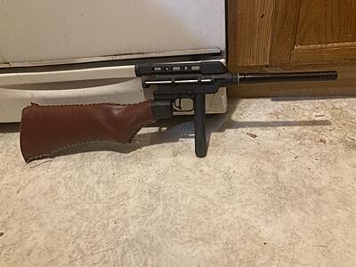

                  So I did a thing today. Have 1 more fully functioning one
                  and one that’s functional internally but not mechanically.
                    XEMON
                    commented
                    That stock cover looks sweet.
                    How confi is it?
