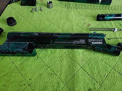

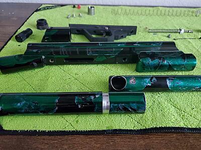

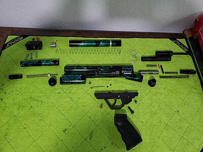

                    So it appears that they tap a hole all the way through the body forward to aft and use allen screws to seal it. Its the small plugged hole in the first pic. Pretty clever technology for back in the day seeing how hoseless markers are only about 10 years old in their current versions. Here are some close ups of the anno job. Cool fact, the orings on most of the marker appear to be the same size orings as the ones planet eclipse uses for which I have literally thousands of. The exception being the CO2 cap seal which seems to be beefy but Choas here has sorted me out with some directions to go forward with. Thanks Chaos, truly appreciate the assist.

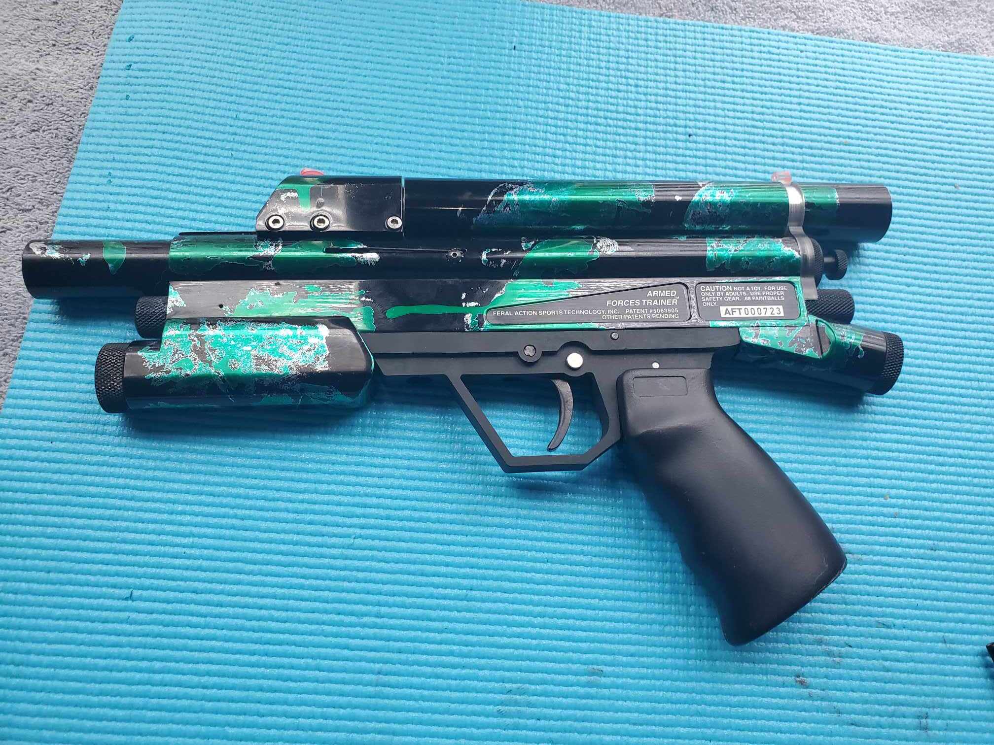

                        Got her back together and made a temp seal on the CO2 cap to test it out. Hooked up compressed air to the asa and it leaked like a SOB from the temp oring for the CO2 but it cycled. Several times. So it seems to be in working order. Got a few of the Orings on order that Chaos recommended. Once they get here then Ill try again with some video.

                          That looks amazing! If you want to lighten up the trigger pull ,polish up the trigger and put in a lighter trigger spring......My last one was buttery smooth
