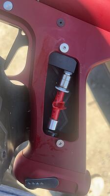

    This was my second time ever using my n3 and the internal macro line blew out right after I aired it

      What an odd design choice. It took more effort than trapping a simple metal tube with o-ring seals, and now you have this failure mode...

        that looks like guest tubing doesnt even look like macroline. looks too thin walled.

          It’s not macroline I tried to fix it but I don’t know where to get the tube

            Not knowing a ton about these things, my thought would be that line acts like a fuse, it blows if pressure is too high so the rest of the marker doesn’t. Is the ASA also a regulator on these?

              I see why someone might think that, but if that were the intent then Nova should have made it a "pressure relief valve," which many, many paintball guns have... as they simply re-seal when pressure is in the safe range again. What OP has shown is a design flaw. It's just curious as to why it exists... seems much easier to make it the tried and true way.

            That tubing is specifically used as a frangible relief hose , designed to blow in case someone over pressurizes the reg or you get trash in the lower and the reg fails.... Trapping a metal tube like other have done could be a problem in most guns if the 4500 psi tanks and the first stage rgs get over loaded..... After being on the road at every possible big game we can im seeing alot of dirty air from the fill station supply hpa... We always put safety reliefs in all our pneumatic devices ...As far as then qc issues and the anodize problem from the pre production run we have moved way past that and continue to evolve and still have a ton of new stuff were doing... Anodizing for production in the USA is a huge pain in the ass , with limited options.

              On the red n3,, did you adjust the regulator?
              • TheCoach
                TheCoach commented
                No it was the second time ever used and it blew when I aired it up the first time it was shooting 265-275 so I just left it
