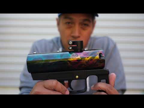

      Grendel That's what I thought, I just wanted to confirm because the guy in that video was suggesting a 500 psi output and I know my Tippmann outputs more than that.
