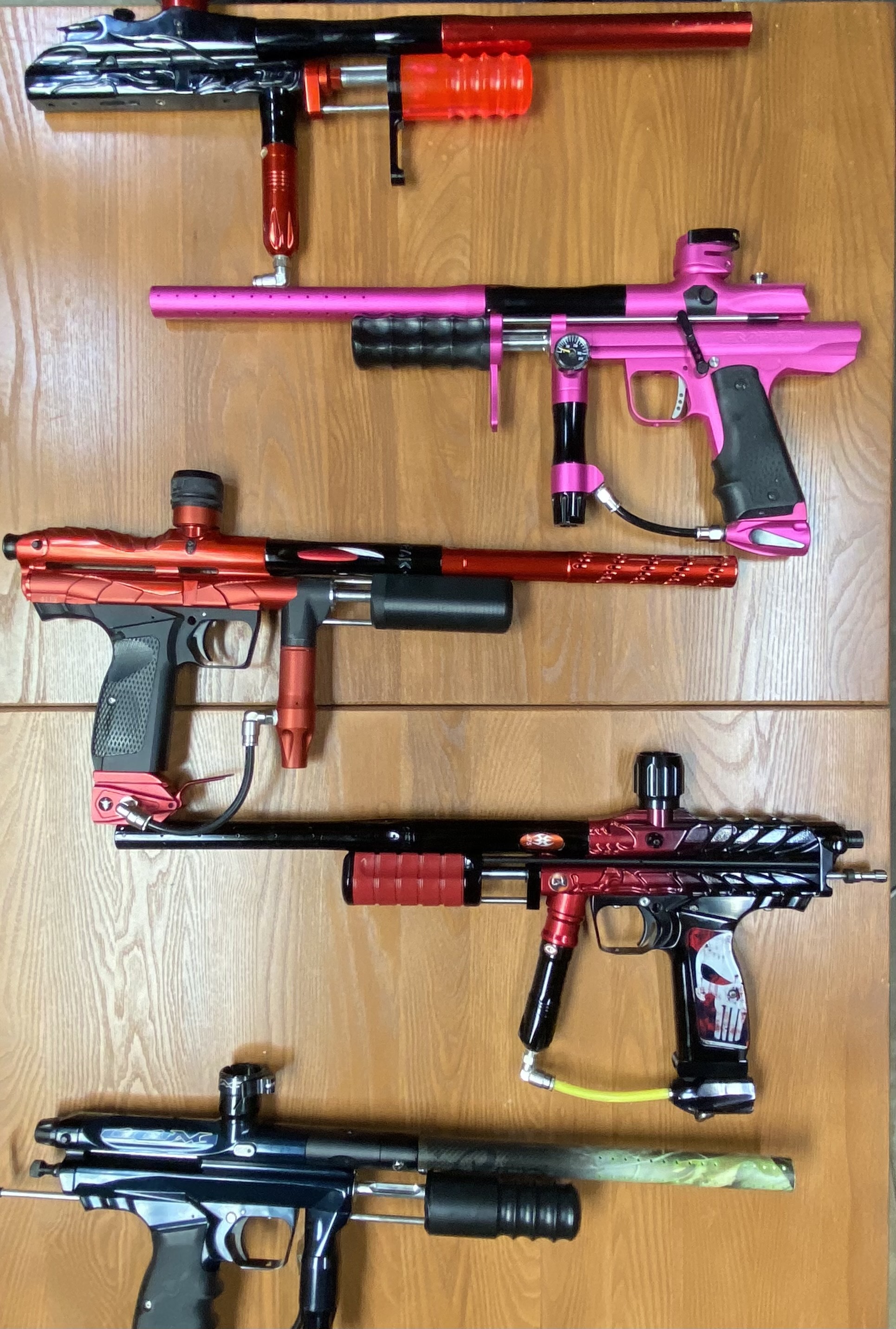

    The Guns:
    This isn't about the guns, but it's a good reference to know what I am using as these kits are not all on identical platforms and vary slight.

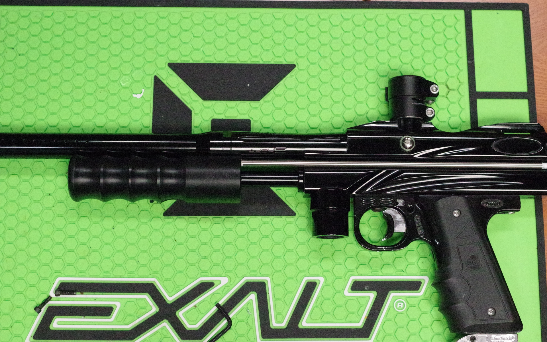

    WGP 2K5 Black Magic Halfblock uses a standard CCM pump kit for a half block. Currently has no trigger frame.
    Empire Sniper using a standard WGP pump kit but ID hammer and pump rod
    WGP Karnivor full body using a CCM Karni EZ pump kit. This has been more go-to marked for over a decade now.
    System X Dragon with Slice pump kit. This is my current build, borrowed trigger frame from Black Magic. Not sprung properly as of May 24, 2021)
    CCM Series 6 with standard CCM pump kit. This is my brother-in-law's gun and the only one I do not own.
    WGP Prostock loaner gun using the Inceptions Designs pump kit. Gun isn't the prettiest, but is sprung identically to my Black Magic. This will be the gun I will use if I switch pump kits onto different guns. It is also not shown in the photo below.
    2k RF body (not shown) will be the test bed for the Genesis kit.
    Click image for larger version  Name:	Testers.jpg Views:	1061 Size:	1.22 MB ID:	133198

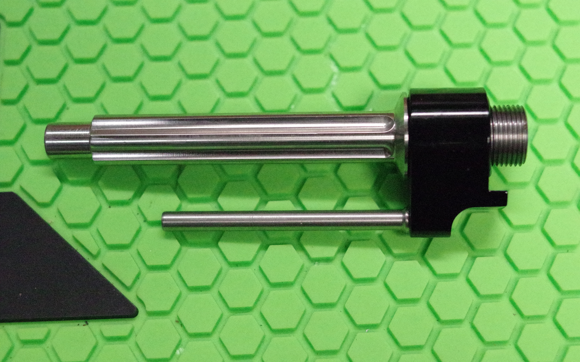

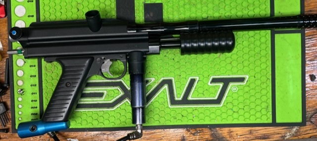

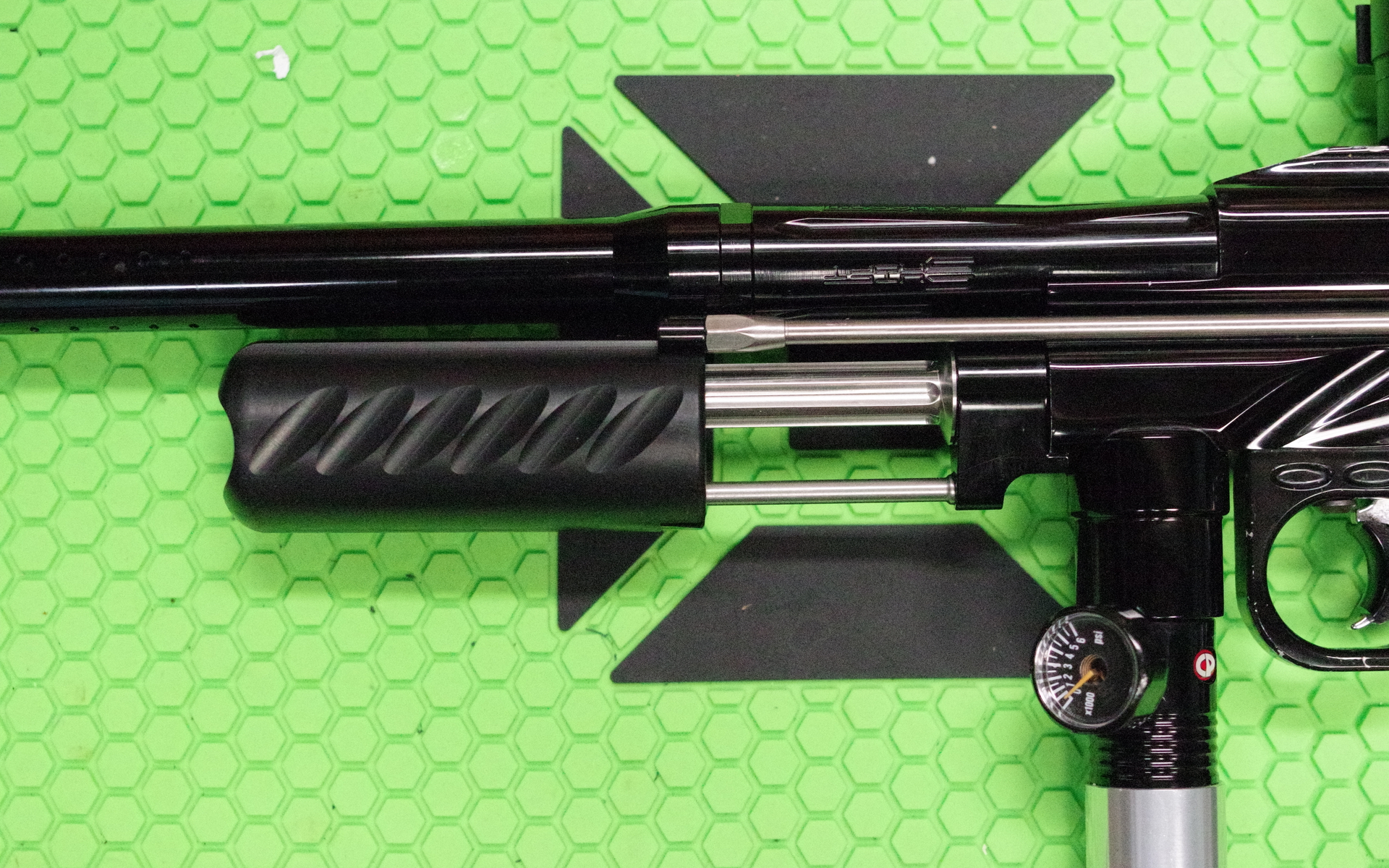

      The Inception Designs Pump Kit:

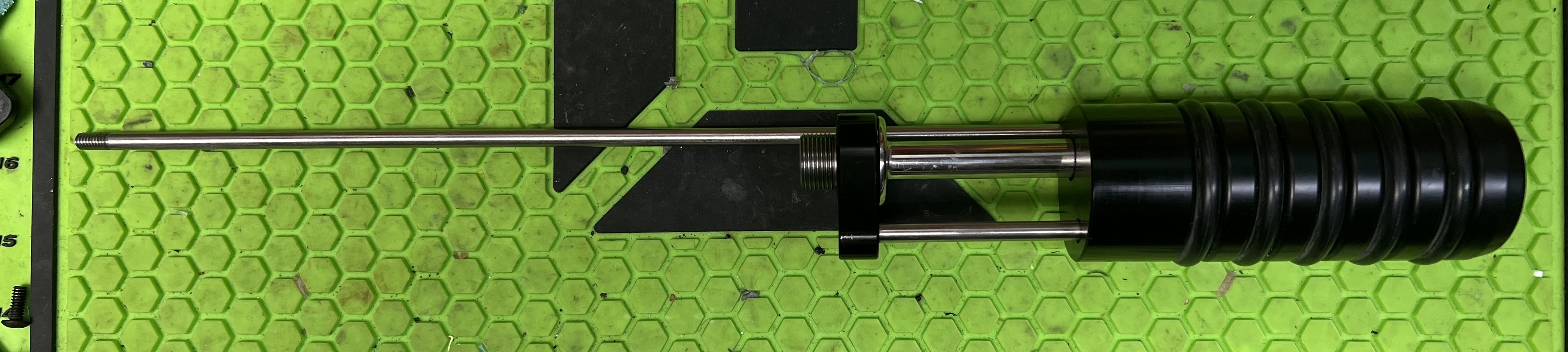

      Here's Inception Design's premium pump kit. Features a fluted main pump rod, a secondary pump rod and an easy to remove pump arm that has a threaded bolt and wrench flats.
      And a look more specifically at the body of the pump kit. Note the wider block with a lip that attached to the bottom of the body to prevent the pump frame from twisting:
Name:	ID pump Rods.jpg

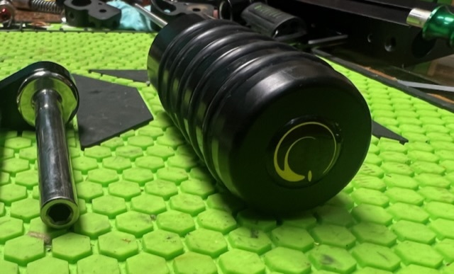

      Now for an in-depth look at the pump handle itself. It's the back plate is recessed into the pump's grip, held on by two bolts. The third bolt connects the cocking rod, which makes for much quicker removal of the pump handle. There are also inserts in the pump kit (one shown removed, once installed) in the pump plate for added smoothness. And finally the return spring:
Name:	ID Pump handle.jpg

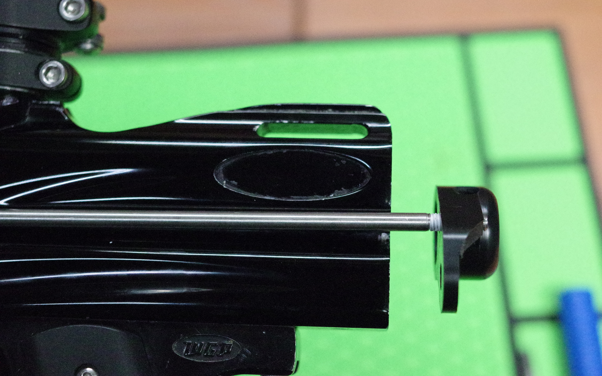

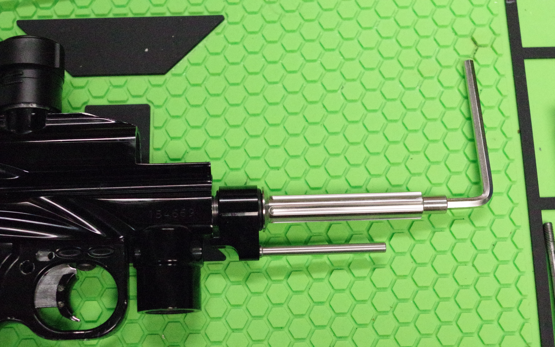

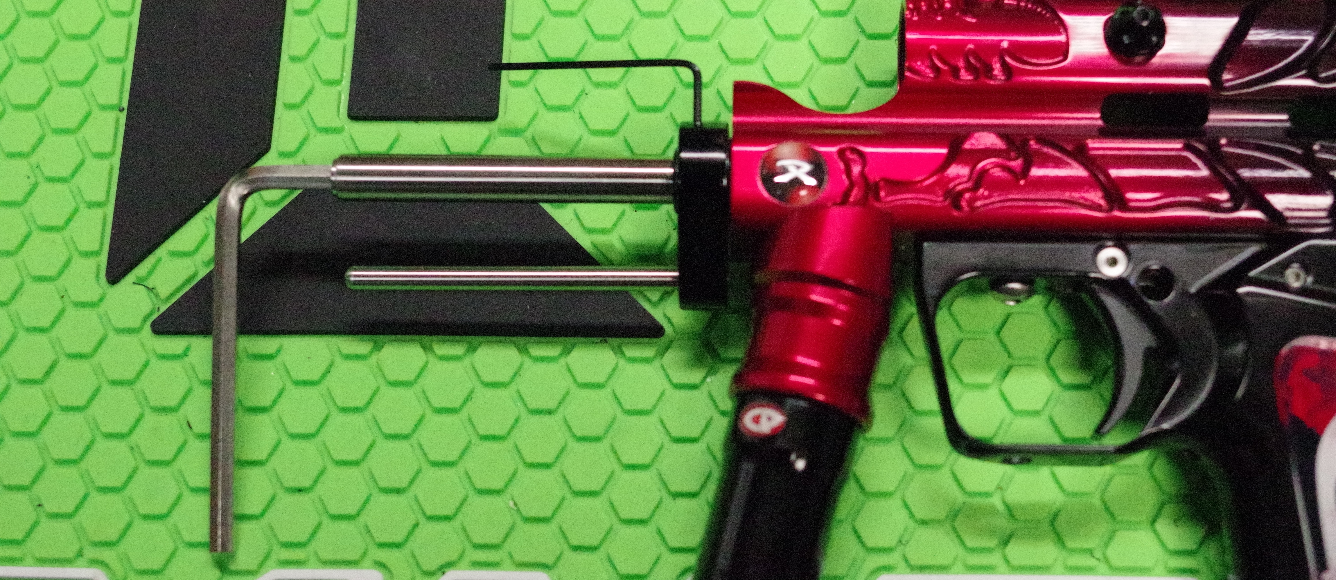

      Pump kit installation:
      Installing thing pump kit is very simple. There's an Allen head in the tip of the main pump rod, simple tighten this down, making sure the kit is kept straight so the little lit sits under the body of the gun. Easy peasy lemon squeezy.
      And just slide the pump kit onto the guide rods, throw your back block onto the cocking rod and you're done with the install. Don't forget to put your bolt and cocking rod back in!
Name:	ID Backblock.jpg

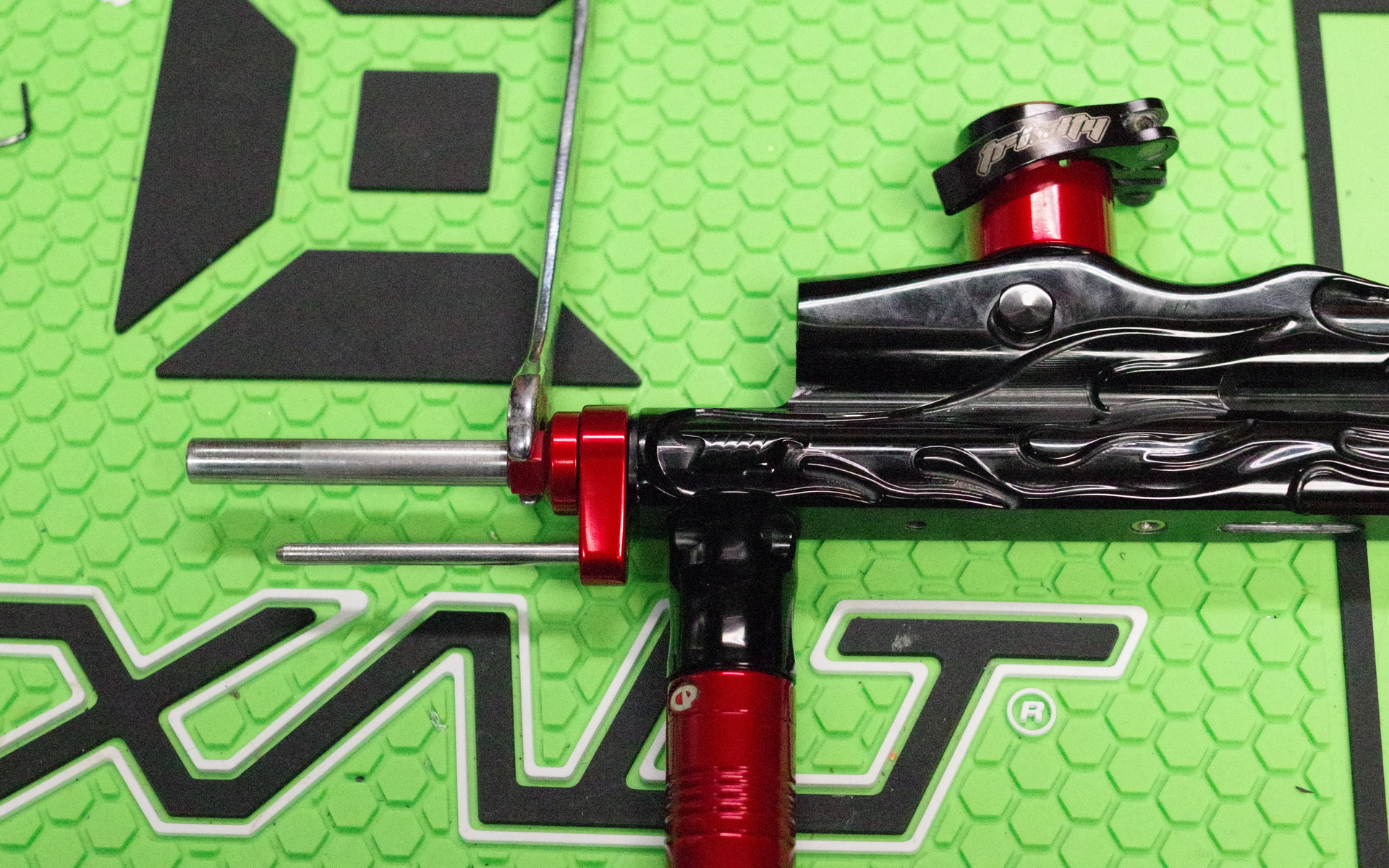

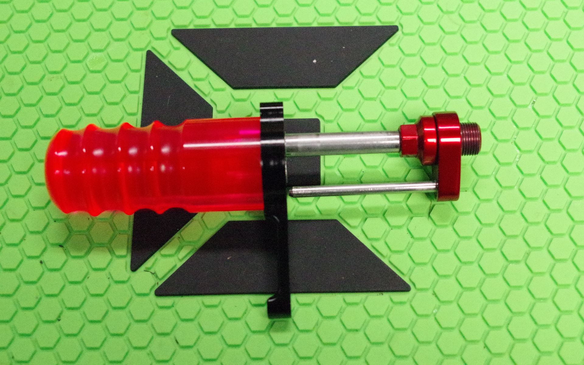

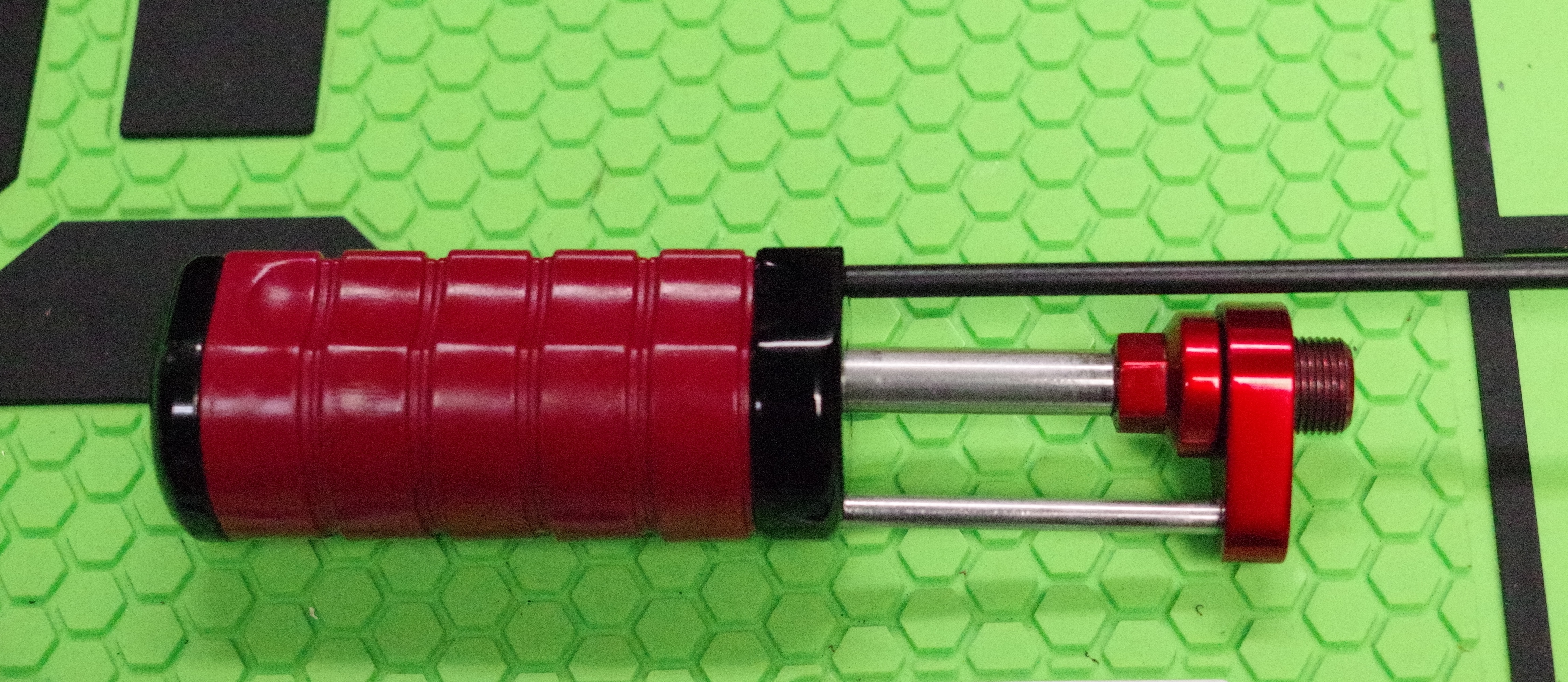

        CCM Kit: (Older Style CCM kit)
        This is old school Deluxe-style CCM kit, which has been replaced by the updated standard CCM pump kit with the classic style pump handle. This kit also features a hitman pump plate. I do not know if this is an original CCM plate or not, I'm sure someone will clarify in the comments below. This kit features dual pump rod, a main and a secondary. There is no lip of the pump rod base, so it is held on by pressure. I have not experienced the pump kit twisting personally, so never been an issue.
        Click image for larger version  Name:	CCM Hitman.jpg Views:	14 Size:	2.31 MB ID:	134306

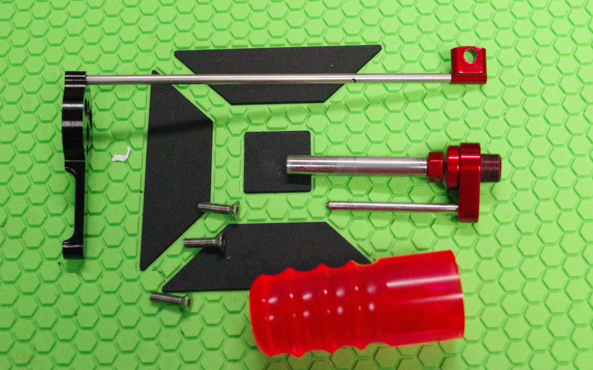

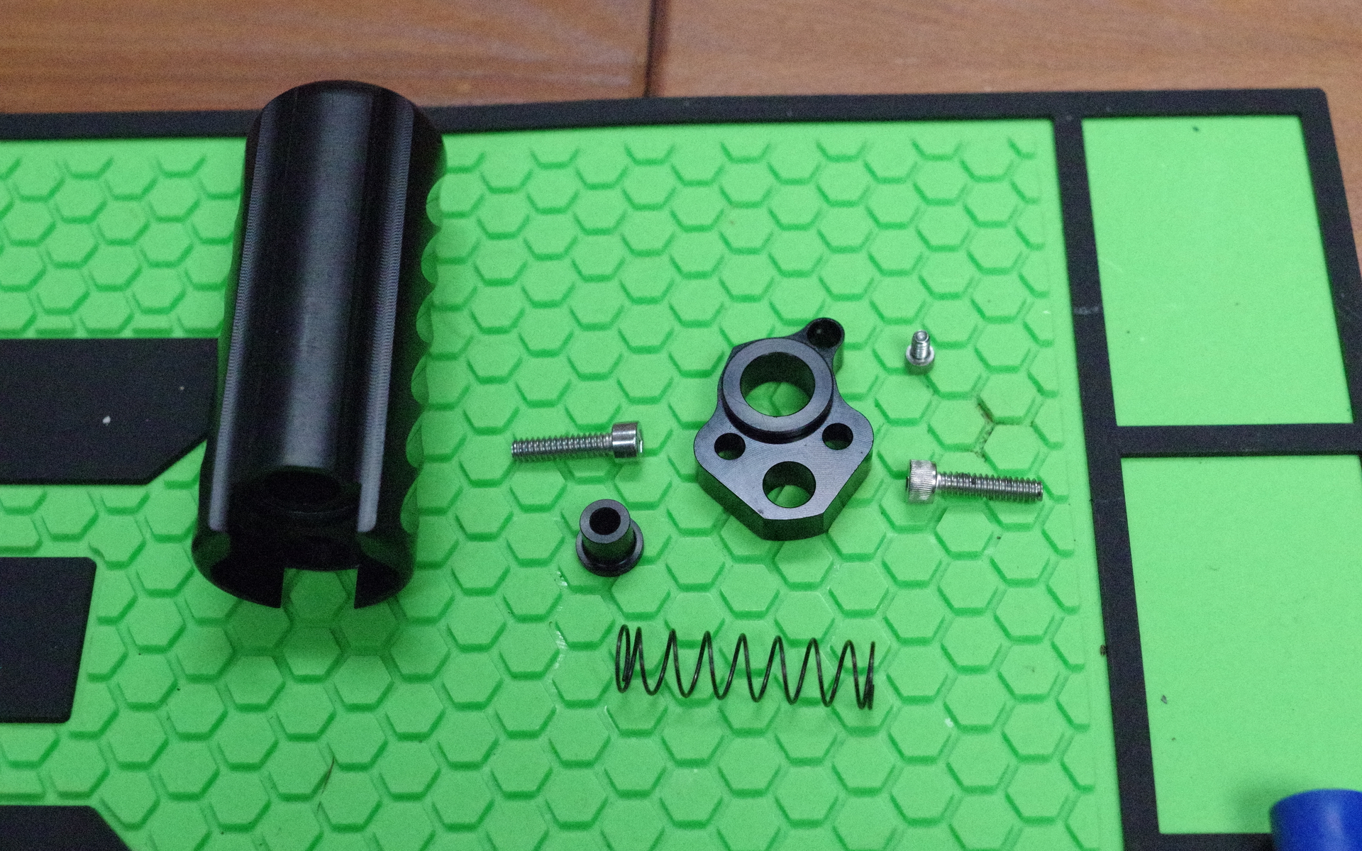

        Here are all the bits and pieces once disassembled. This pump kit has three bolts connecting the pump handle to the pump plate There is no bushings or inserts between the pump handle, block and pump rods. The pump arm threads directly into the pump plate with no quick or easy means of removal.
        Click image for larger version  Name:	CCM parts.jpg Views:	13 Size:	2.39 MB ID:	134307
        As this is an older kit you need to install it using a wrench. There are wrench flats at the base of the main pump rod and it's quick and easy to install the pump kit. Be sure you have the lower guide rod straight before tightening down so your pump doesn't bind.
        Click image for larger version  Name:	CCMinstall.jpg Views:	12 Size:	2.49 MB ID:	134308
        CCM has a variety of different pump handles, including different styles and lengths. I have a mini handle (translucent), regular handle (on the S6, shown at the bottom) and an EZ Pump handle on the Karnivor (shown on the top). CCM does make other pump handle styles as well. The S6 also has a fluted pump rod.

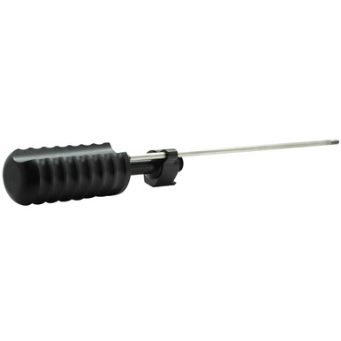

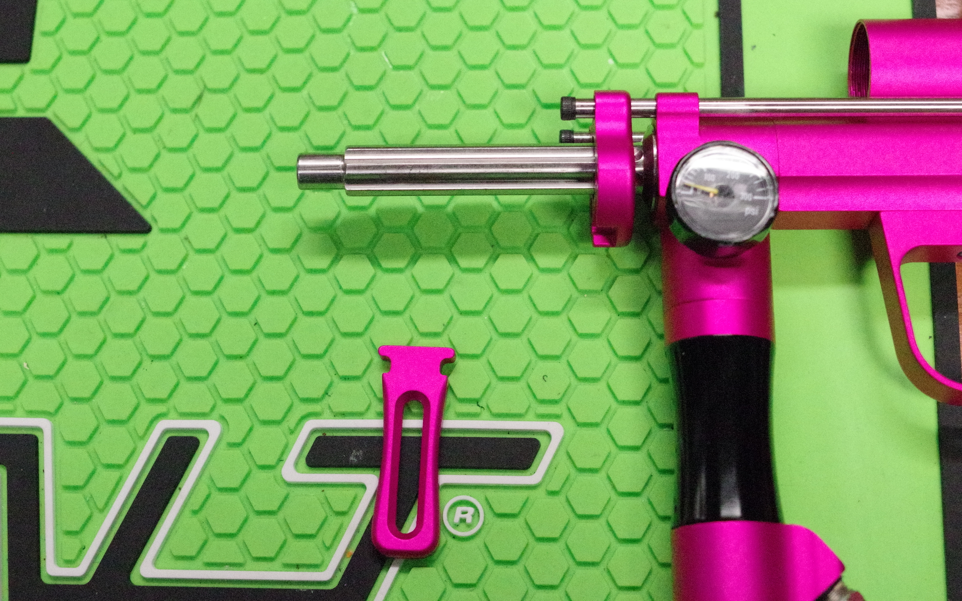

        The budget kit from Inceptions Designs. Still well made and very stable. Has a tab the fits under the front of the body to Kit the kit straight and stable. No noticeable twisting at all. That lip may cause problems on non-WGP spec bodies. Will not fit my System X body.
        Kit comes with pump arm, pump return spring.

          These are kits you're not going to buy separately or used unless you buy a gun with them already installed.
          WGP pump kit:
          This is the old style quite frankly crappy pump. Single pump rod, nothing to prevent twisting other than a fat barrel.
          Click image for larger version  Name:	WGP Pump.jpg Views:	564 Size:	2.43 MB ID:	134312
          The main pump rod (and the only pump rod) has wrench flats at the end of it for easy installation. There's no pump plate and the cocking rod is threaded directly into the pump handle. The pump handle is shaped to gently cup and caress your barrel, which helps prevent the kit from twisting, but only a little.

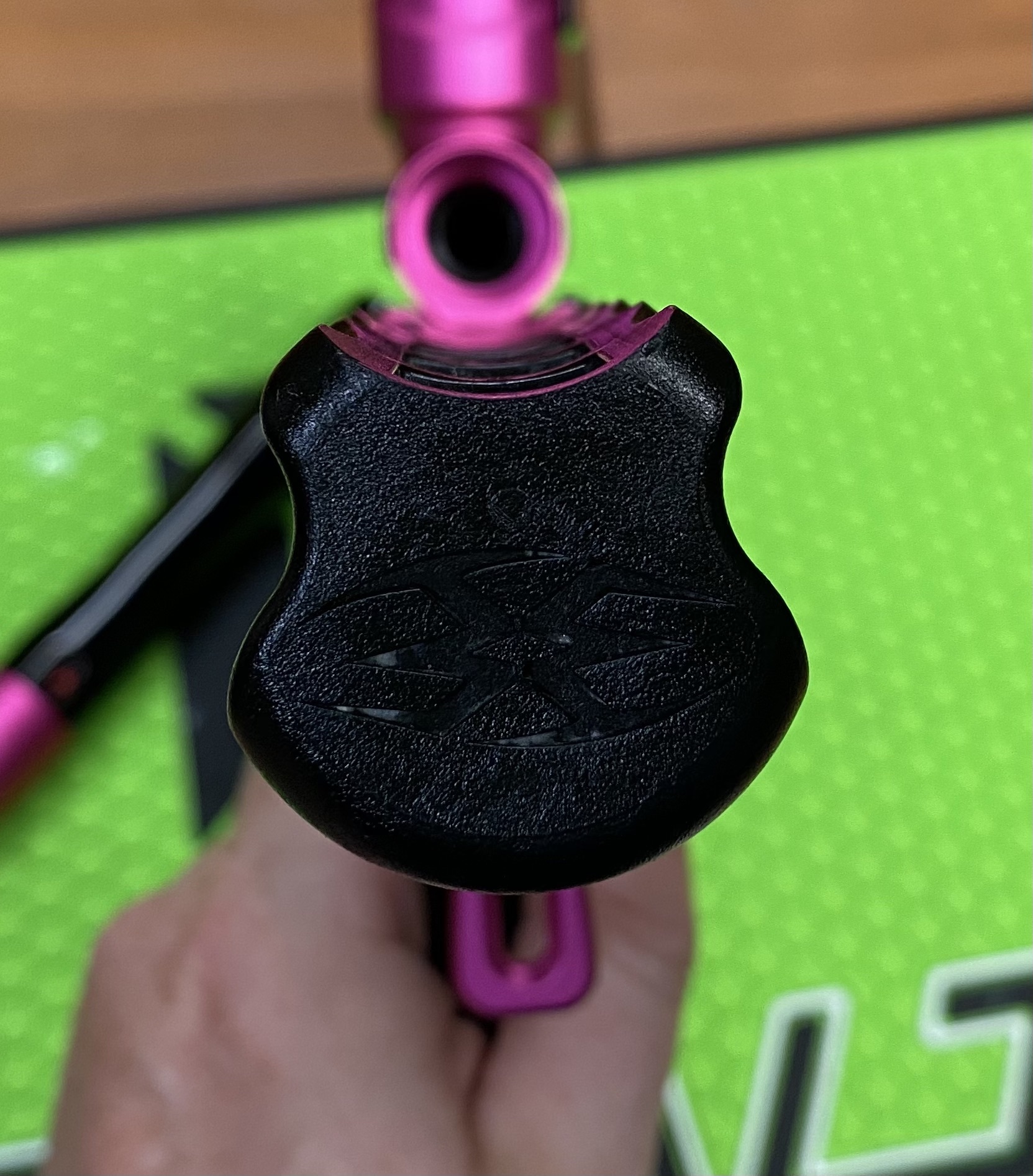

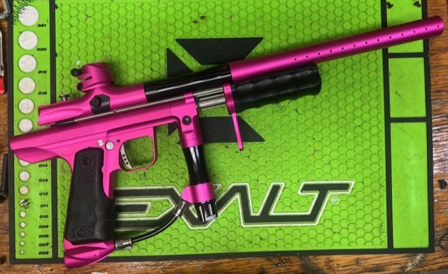

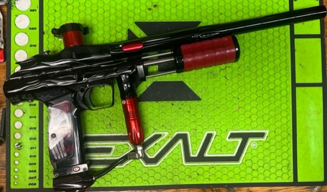

          Up next I've thrown in an Pretty In Pink Empire Sniper:
          This puppy has a dual pump rods and a single main pump rod for your stroking pleasure. In my example below the standard pump rod has been replaced by an
          Inception Design fluted pump rod. It looks to be interchangeable with the ID pump kit's rod as well. The nifty thing about this kit is ability to easy add the hitman mod, or remove it as to your whim. The dual cocking rods are attached to the pump block by bolts, which is nice, but has a drawback. If you over tighten the bolt and twist the rod you create uneven pump arms which cause binding and very poor pump stroke. Avoid this! ( I did not when reinstall the pump...)
          Click image for larger version  Name:	Empire Sniper rods.jpg Views:	534 Size:	2.42 MB ID:	134313
          Here’s a picture of it full assembled:

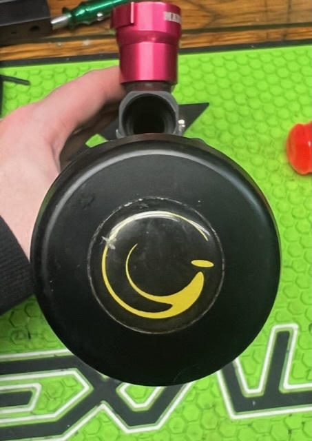

          As a late addition, I got my paws on a Check-It 2k pump kit as well, so I’m adding it in. The pump Kit itself is well made, and very similar to a CCM kit. The pump handles are interchangeable between the kits. The Check-it does have an Allen key hole on the tip of the main pump rod, making it easy to tight down.
          Click image for larger version  Name:	AD972ADD-67C8-48D5-92B5-B8F80E566CDC.jpeg Views:	176 Size:	1.08 MB ID:	379658
          Click image for larger version  Name:	DF8E3093-FB0E-4DE2-8C89-8FAB406BADF6.jpeg Views:	176 Size:	70.1 KB ID:	379659
          The pump handle is most unique part of this kit. It runs the same length as the CCM kit with the hitman plate, so slightly longer, but has large o-rings around the handle providing excellent grip. The face of the pump handle is also flat, making it comfortable to hold you finger across it, however you choose to do so.

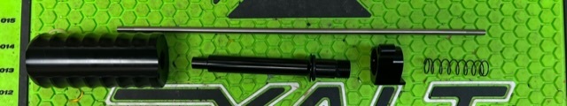

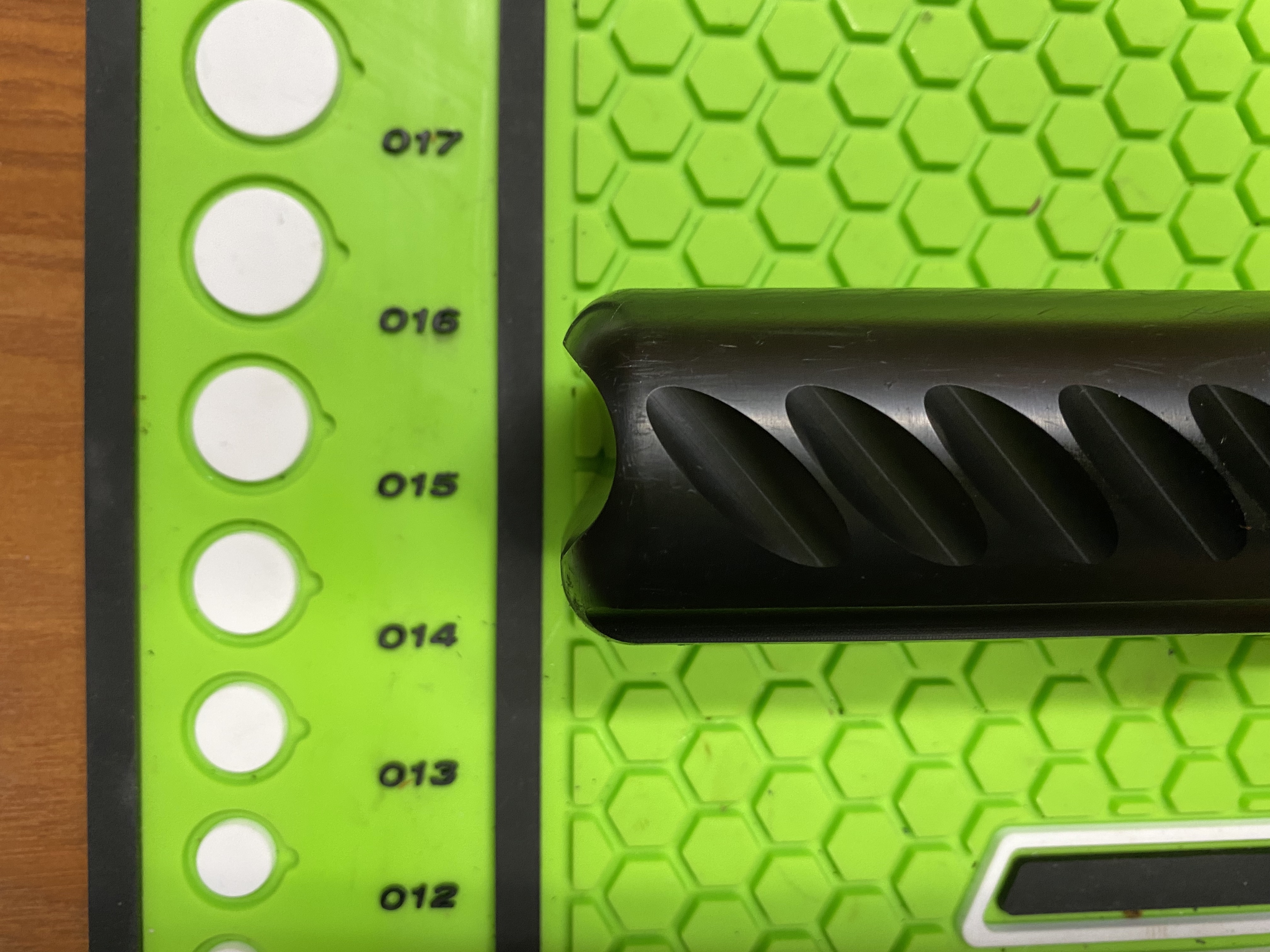

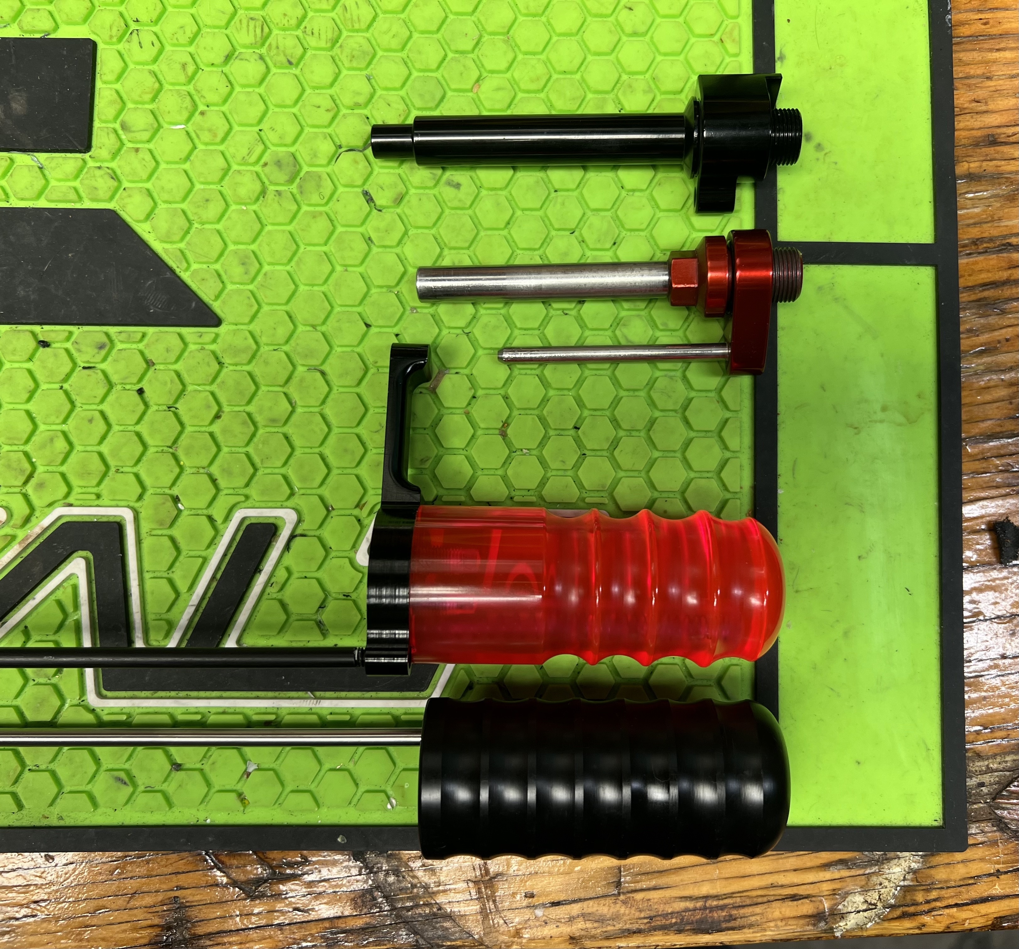

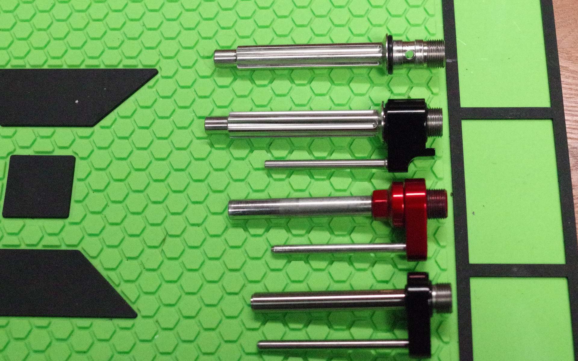

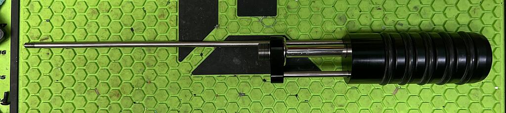

            Pump Rods:
            Like many things in life, these rods come in various shapes and sizes. Some are round, some have ridges.
            Click image for larger version  Name:	Rods.jpg Views:	555 Size:	2.37 MB ID:	134319 Starting from the top:
            ID Empire Sniper guide rod
            ID Drift pump kit rods - it's chonky
            CCM kit (old school) - it's red
            Slice pump kit.
            Not shown: WGP pump rod. It's long, it's black. We'll just leave it at that.

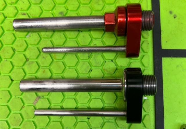

            And for additional comparison, here is the same red CCM pump rods with the Check-It rods, which has a slightly shorter main rod. Without a direct comparison it looks very similar to the Slice pump kit’s rod.
            Click image for larger version  Name:	61DF566A-0B1E-4ECD-B8CF-F4F504DB9973.jpeg Views:	175 Size:	73.8 KB ID:	379660

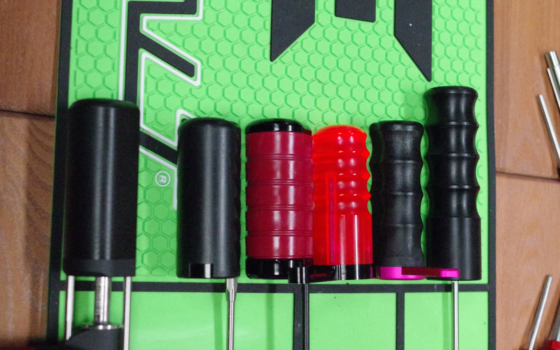

              Pump Handles:

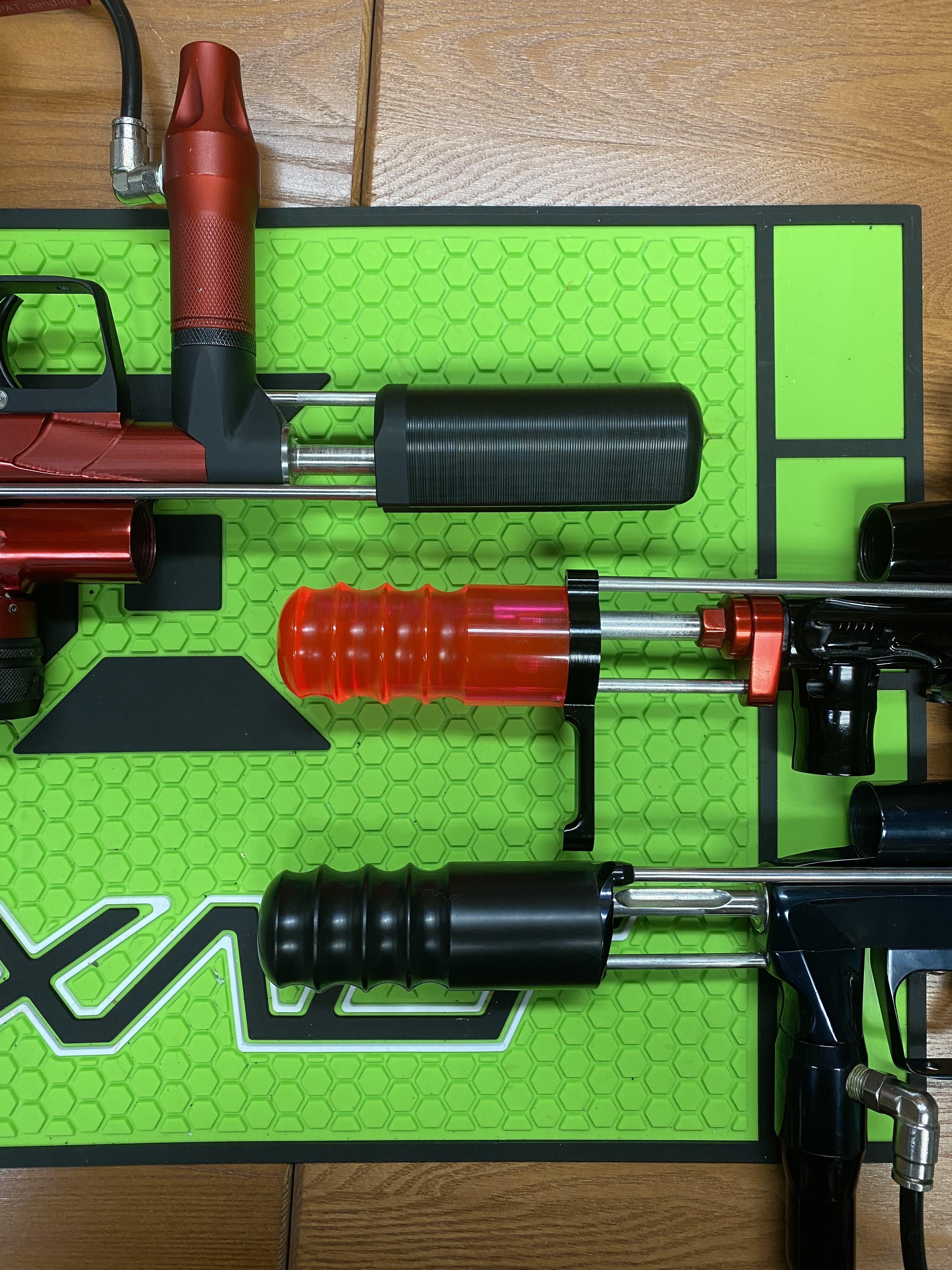

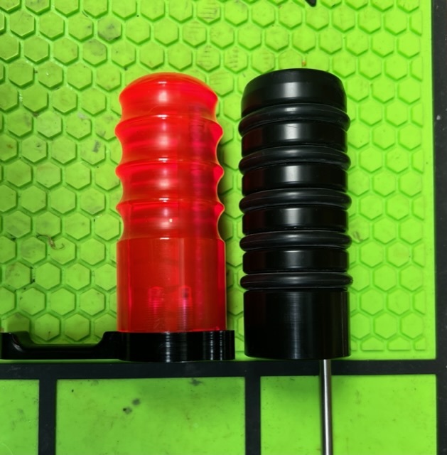

              Going from left to right on these bad boys and sneaking in a few handles I've yet to mention. How's that for consistency!
              First handle on the left: CCM EZ pump kit, next is ID Drift kit, red with black handle is the Slice Kit, translucent is the CCM, then the the stock Empire Sniper handle and finally the WGP one. This gives a general overview of the different sized, with he middle pumps all generally being a similar length and width.
              Click image for larger version  Name:	image_14901.jpg Views:	16 Size:	2.38 MB ID:	134320

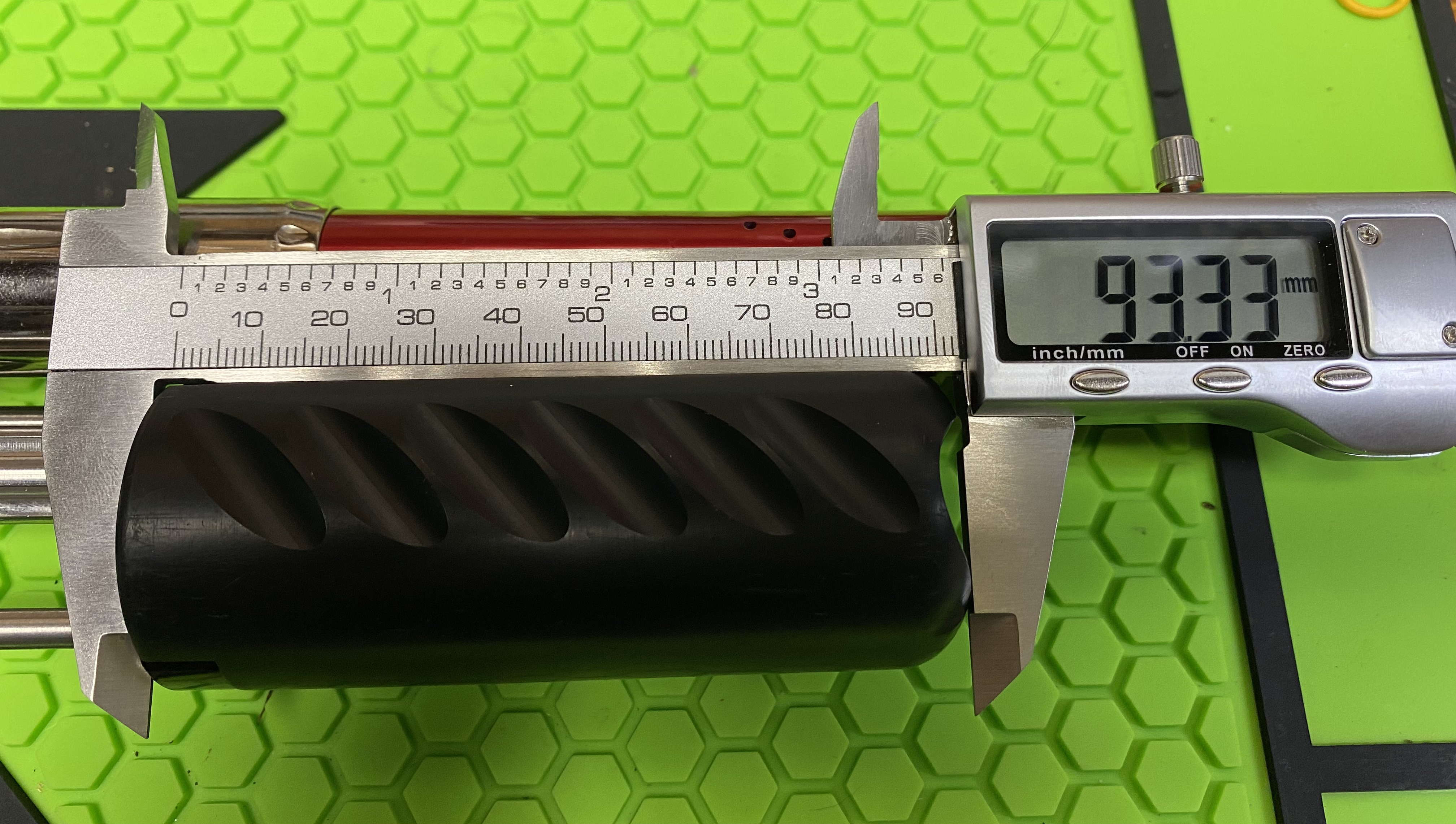

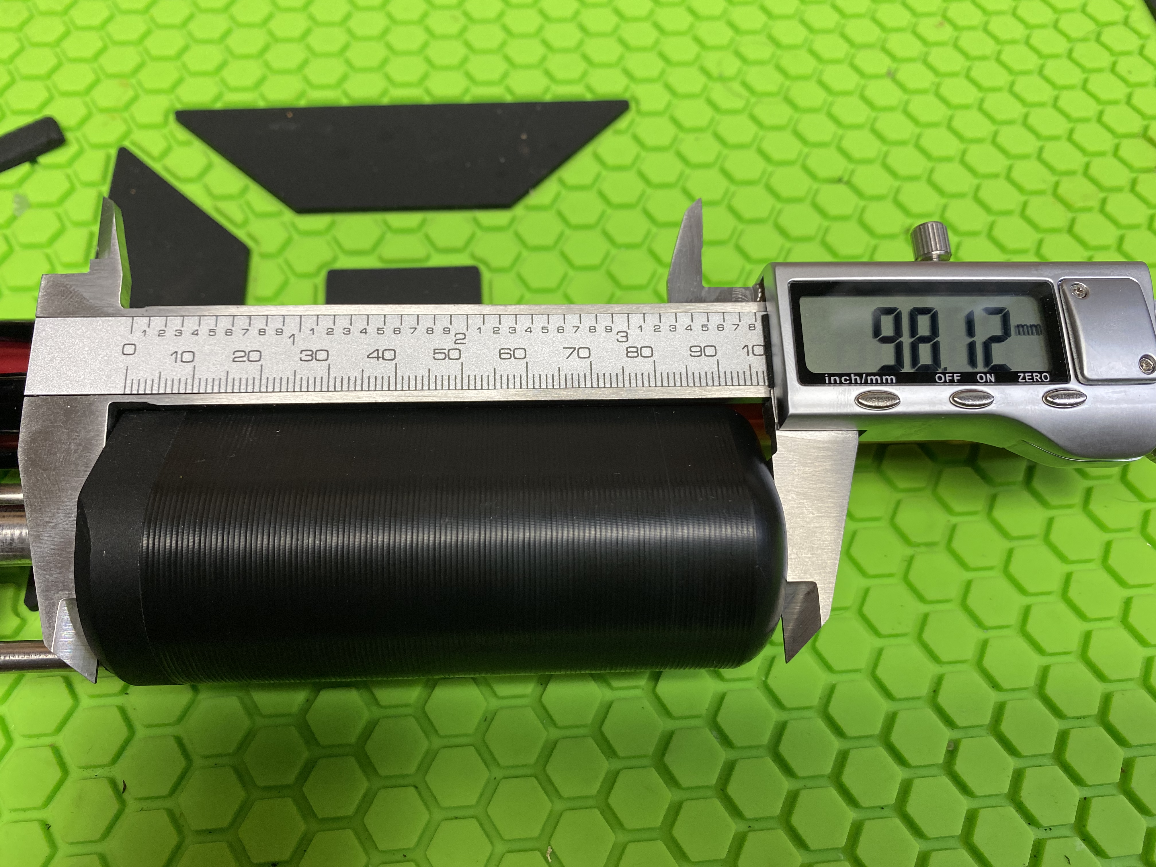

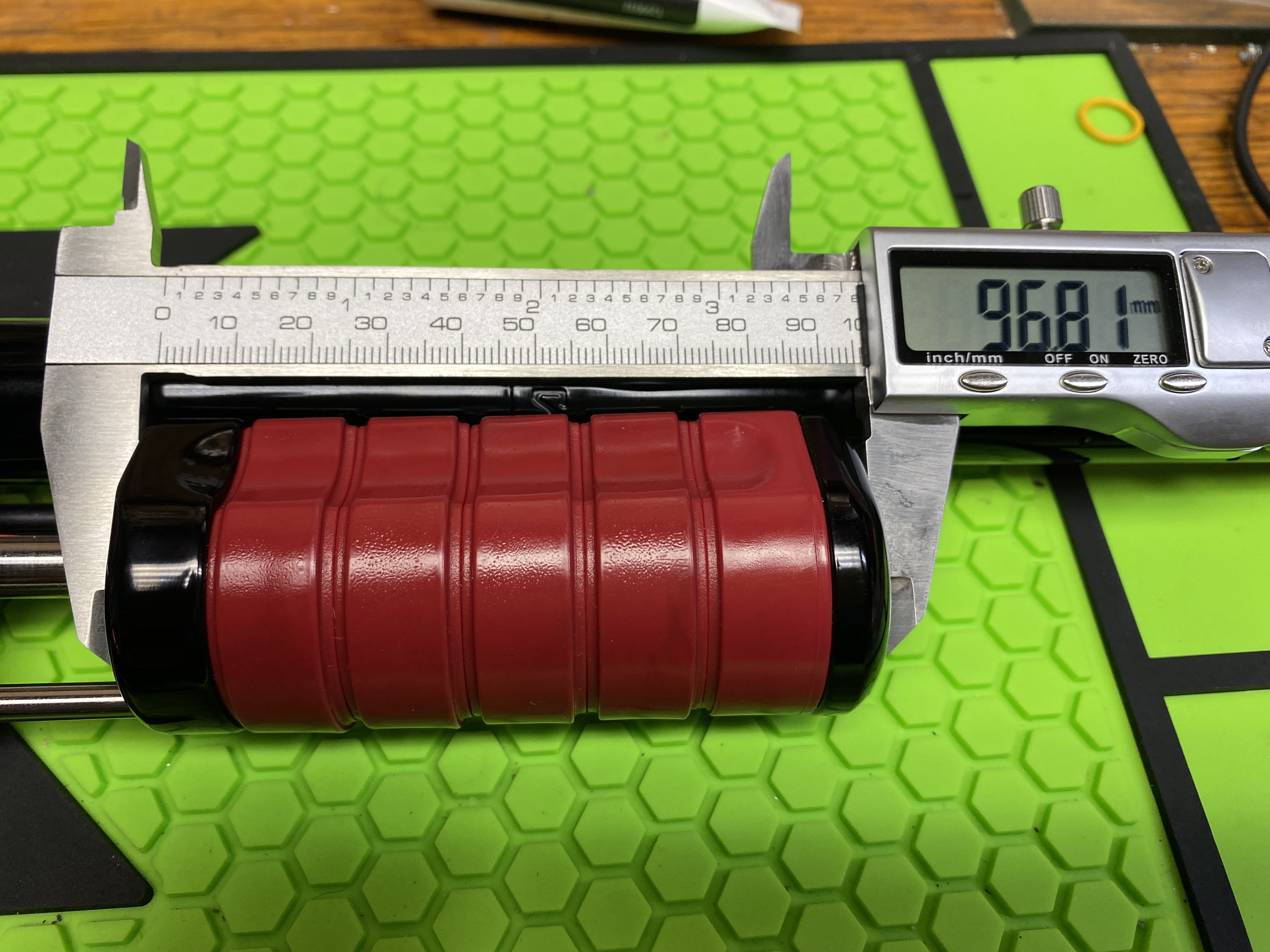

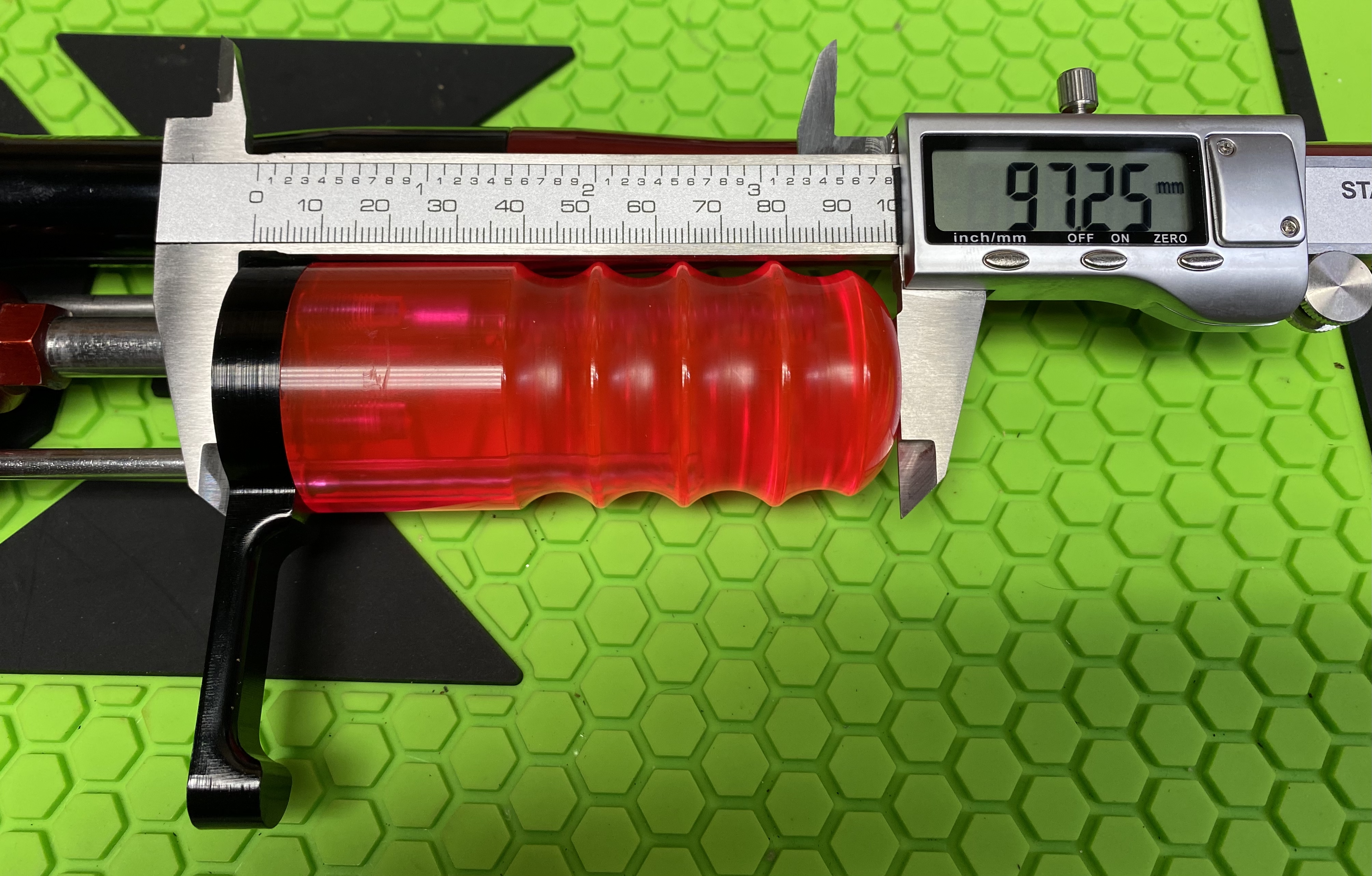

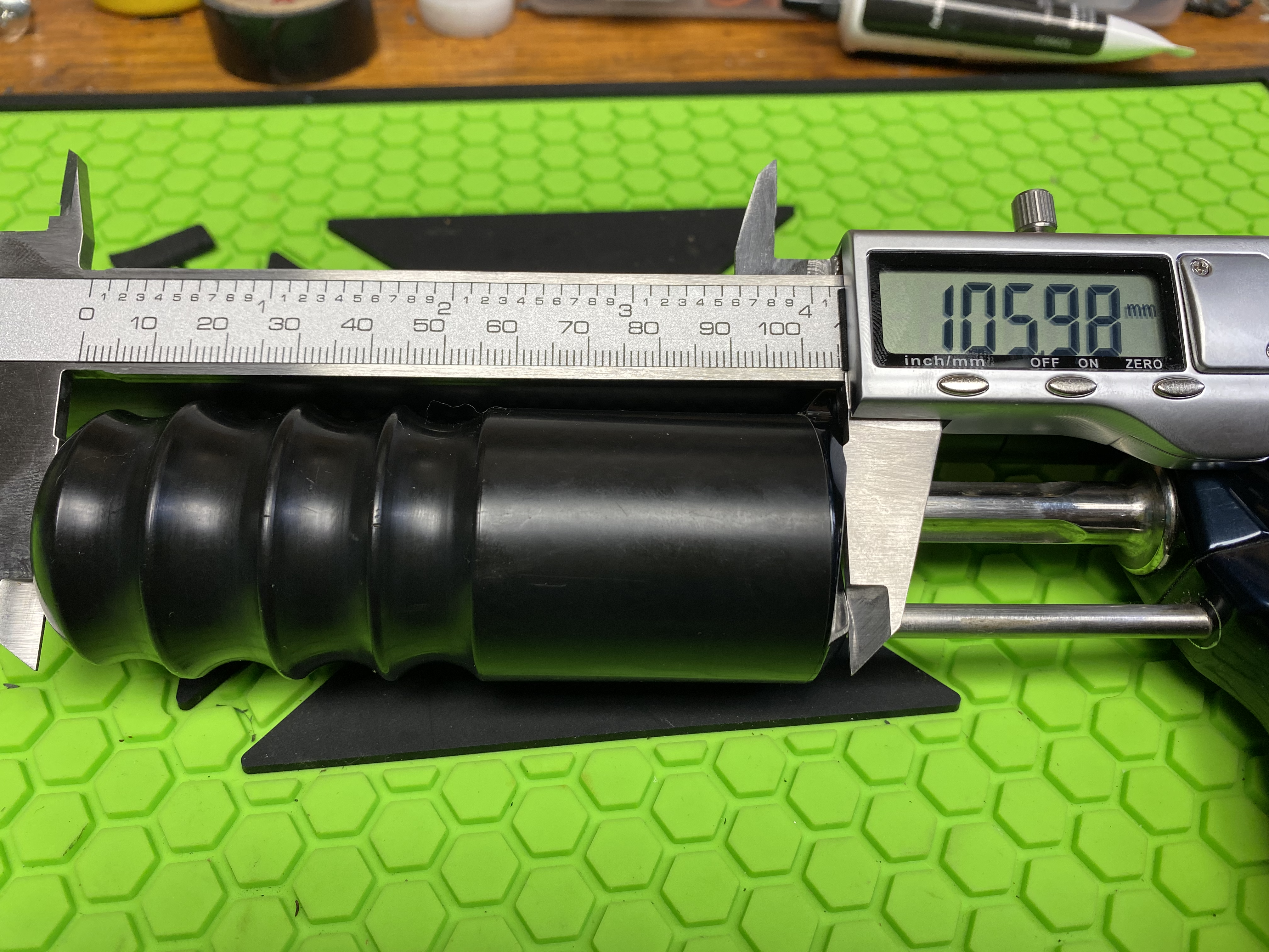

                Staying true to my Canadian roots this all measurements will be shown in metric! (with inches)
                Old Style CCM Pump plate and pump measurement: (3.828 inches)
                Click image for larger version  Name:	CCM mm.png Views:	608 Size:	10.26 MB ID:	152261
                CCM EZ Pump Kit: (3.863 inches)
                Click image for larger version  Name:	CCM EZ mm.png Views:	597 Size:	12.21 MB ID:	152262
                CCM S6: (4.172 in) Longest handle
                Click image for larger version  Name:	S6 mm.png Views:	595 Size:	12.36 MB ID:	152263

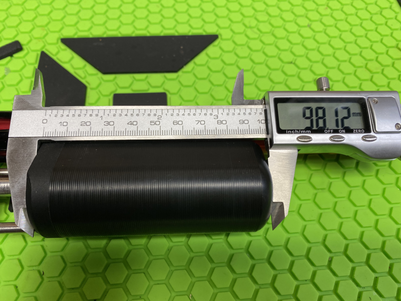

                ID Drift (3.674 inches) - Shortest handle
                Click image for larger version  Name:	ID mm.png Views:	592 Size:	9.13 MB ID:	152264
                Slice: (3.811 inches)
                Click image for larger version  Name:	Slice mm.png Views:	597 Size:	12.28 MB ID:	152265

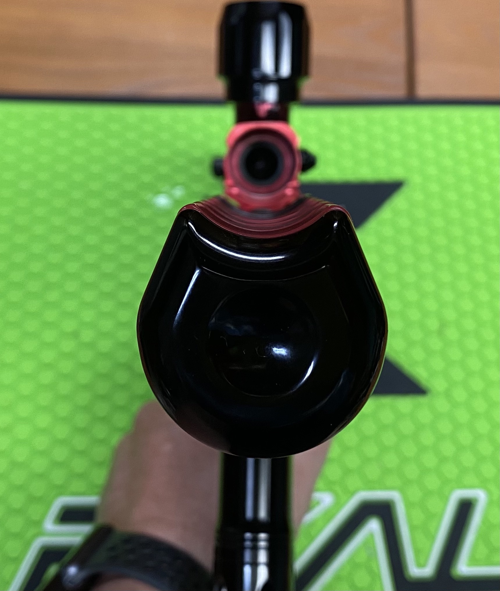

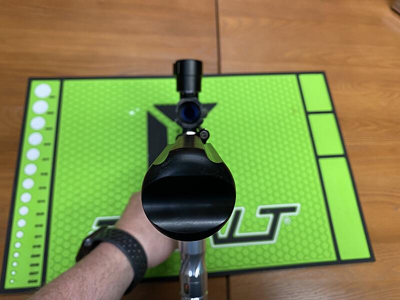

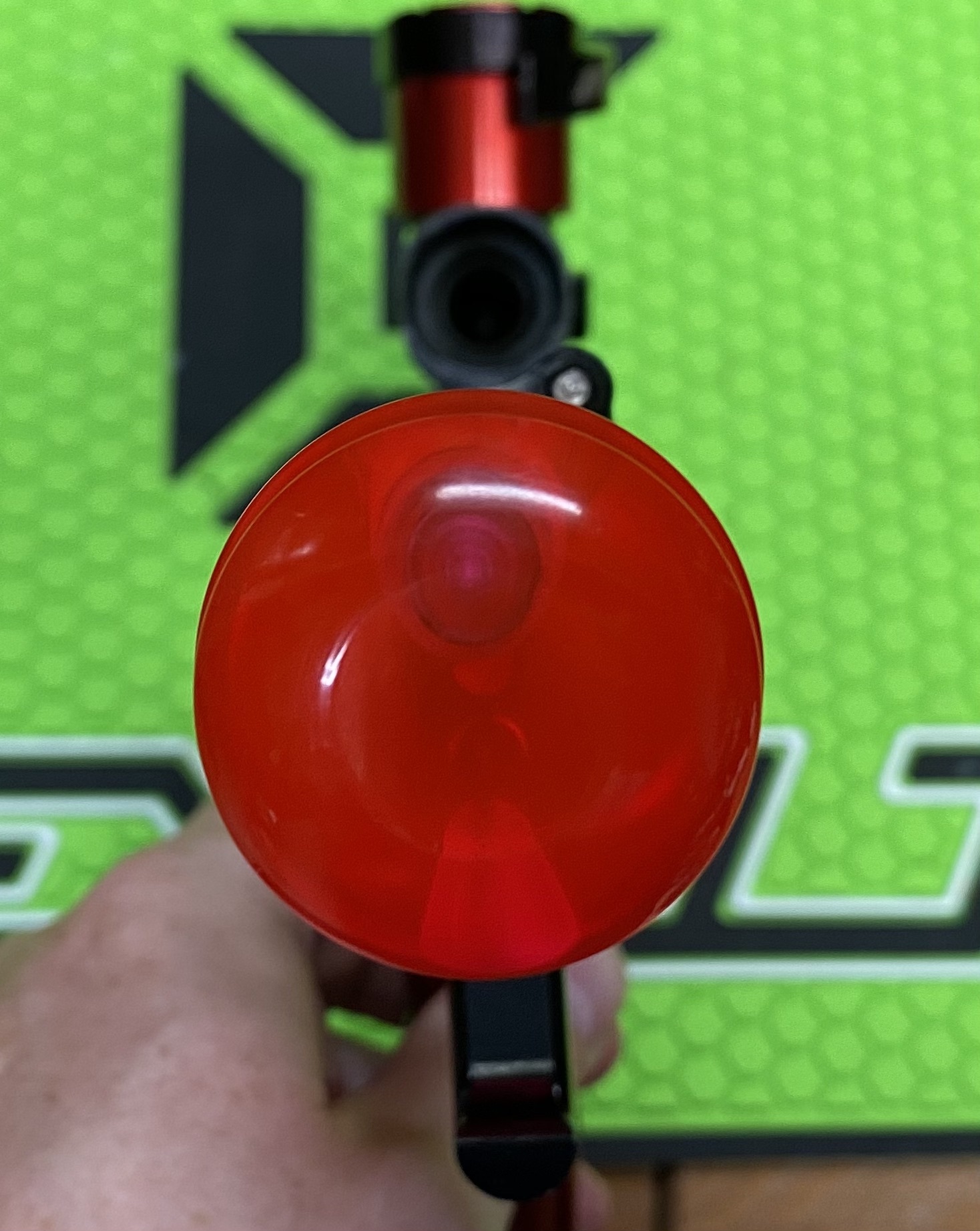

                  Pump Handle Fronts:
                  Why?! Because they make a huge difference on the feel of the pump in hand. I like to wrap a finger around the front of my pump handles. If you prefer to just pinch the handle then skip this section as it makes no difference to you!
                  CCM EZ:
                  Click image for larger version  Name:	CCM EZ front.jpg Views:	450 Size:	392.9 KB ID:	152272
                  CCM Old Style:
                  Click image for larger version  Name:	CCM front.jpg Views:	429 Size:	541.5 KB ID:	152273
                  Empire Sniper Handle:
                  Click image for larger version  Name:	Empire front.jpg Views:	423 Size:	734.6 KB ID:	152274
                  Slice Handle:
                  Click image for larger version  Name:	Slice Front 2.jpg Views:	428 Size:	672.3 KB ID:	152275
                  ID Handle:
                  Click image for larger version  Name:	ID front.jpg Views:	434 Size:	2.27 MB ID:	152276
                    Front end of the Check-It kit:
                    Click image for larger version  Name:	81B92AE7-C94B-4598-BC90-EB1228A95D4E.jpeg Views:	0 Size:	74.0 KB ID:	379666

                      Nice review! I had the same feelings about the ID Drift pump handle. If the Drift kit came with the Genesis pump handle I think it would be a winner.
                      Warmongrel's Feedback😈

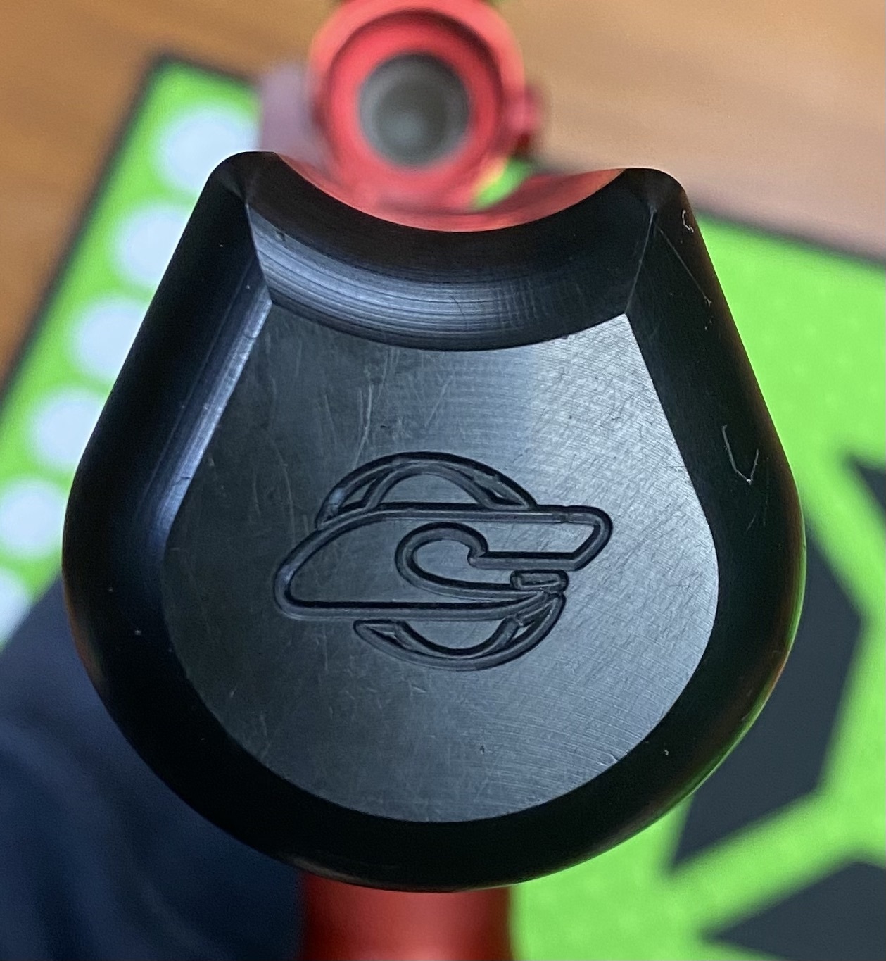

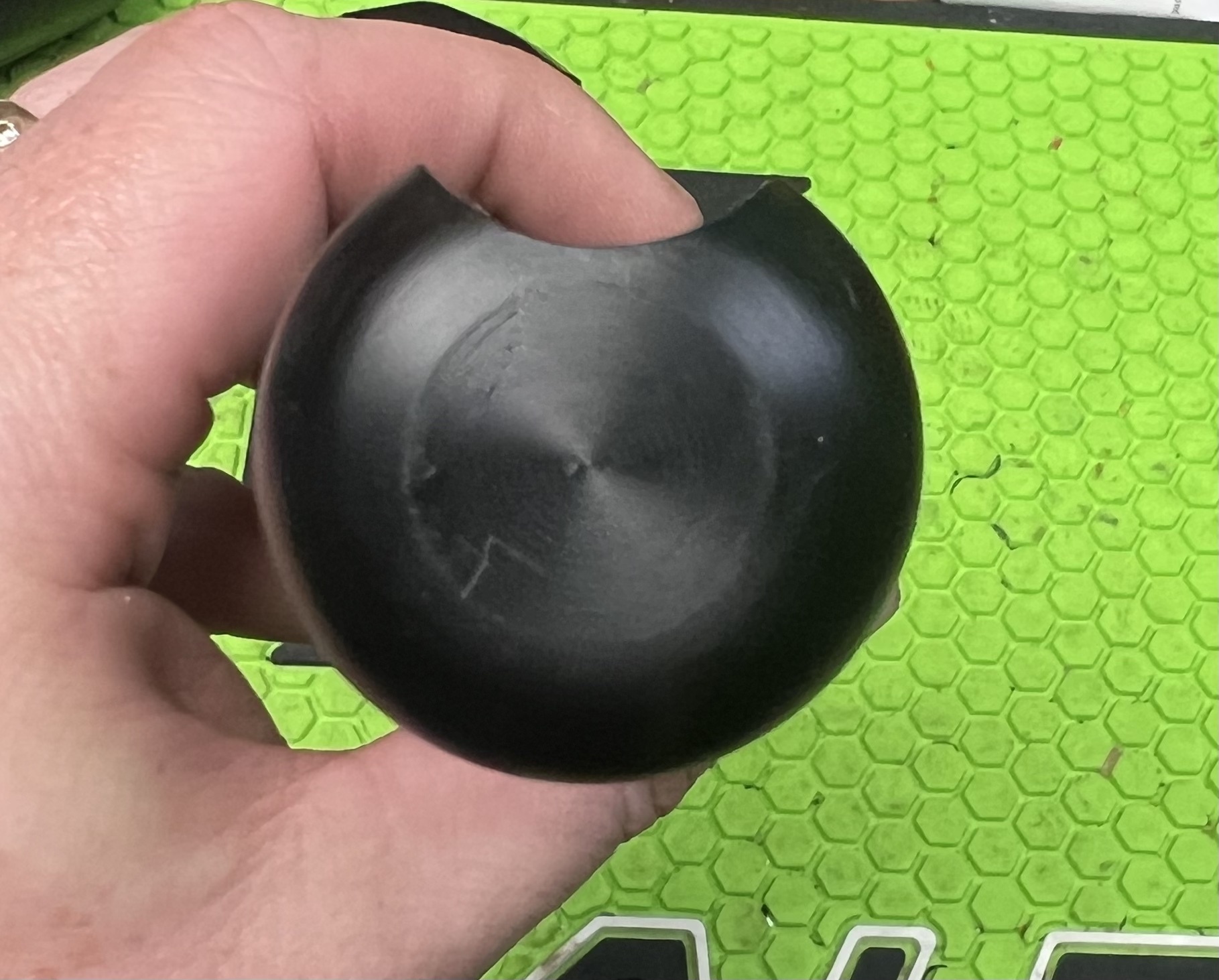

                        Drift Handle Issues:

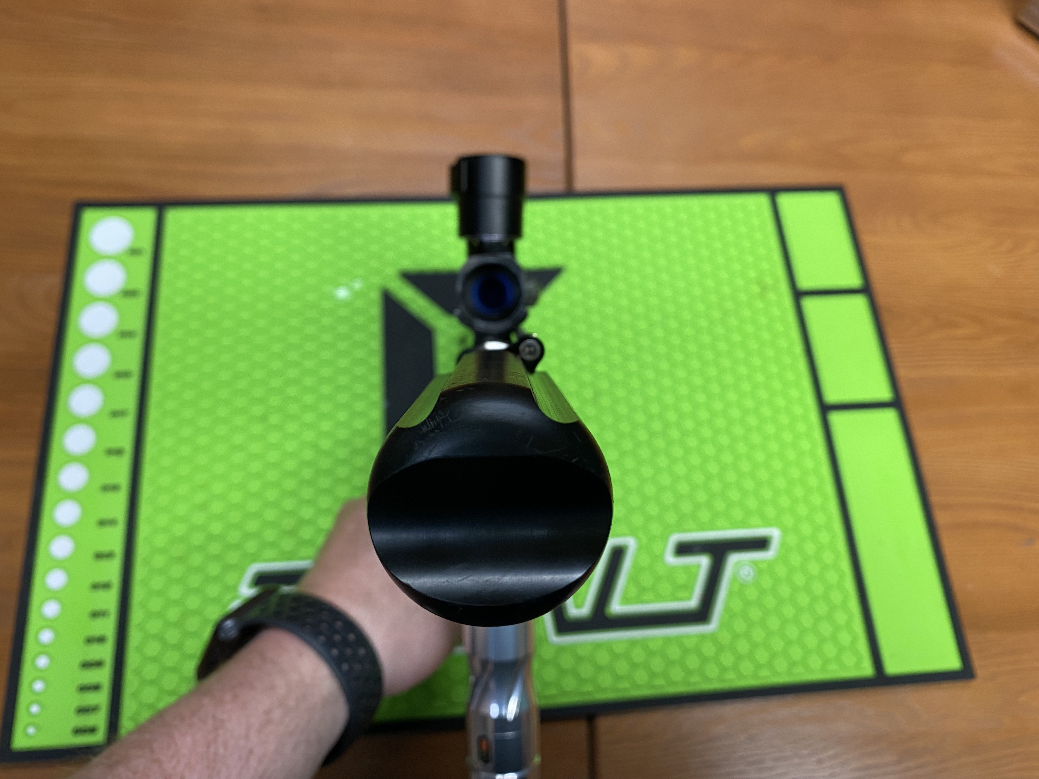

                        While the fit and finish of the Drift kit is excellent, one aspect of the handle design really hinders an otherwise excellent kit.
                        The design of the front of the pump handle does not work for me at all. The lower lip just digs into my finger and is very uncomfortable. It the lip was taken completely off on the bottom it would likely be fine, but as it stands in your front finger goes across this section of the pump handle outside of where the groove it cut then this is not the pump kit for you.
