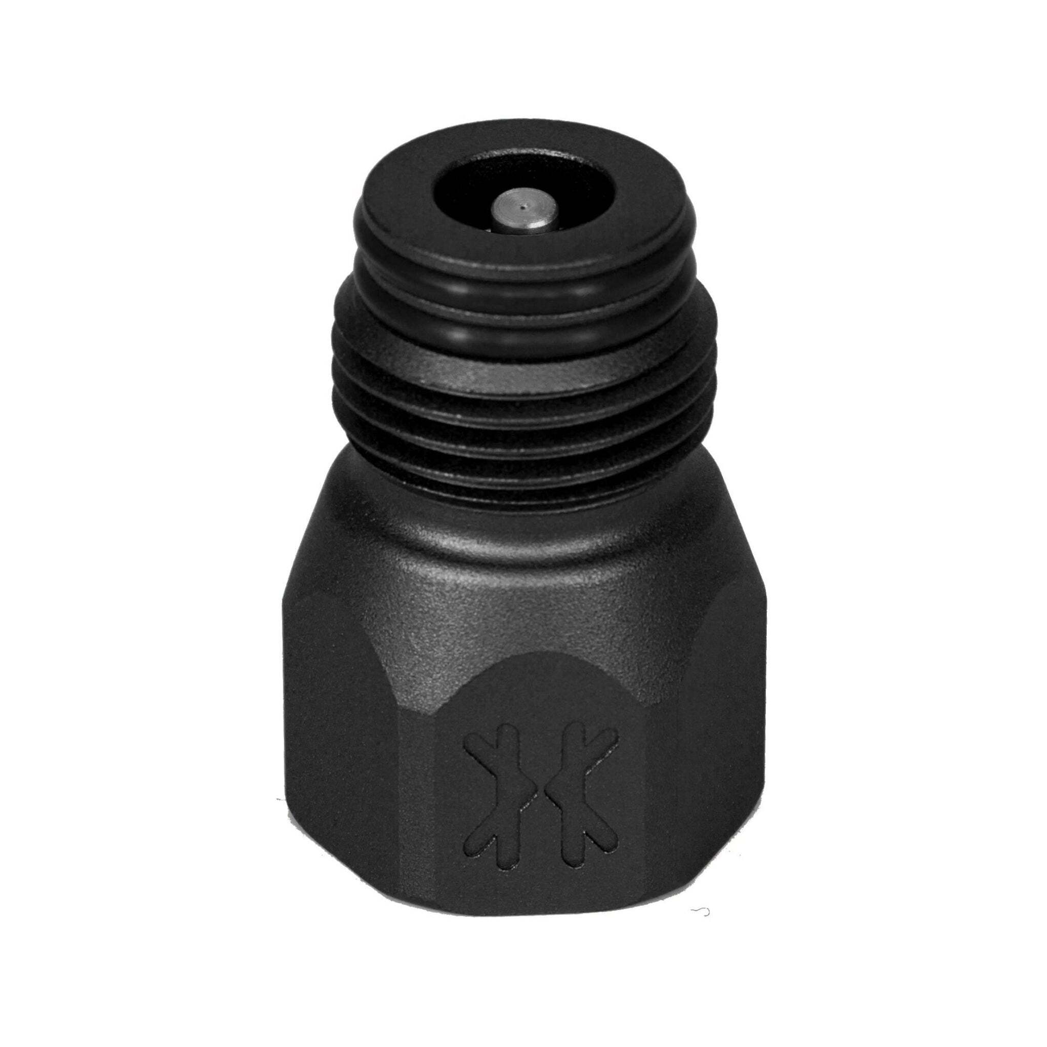

                        This might be a silly thought, but would one of the reg extenders add sufficient volume? Couldn't hurt, right? Would be cheaper to mod than taking a lathe to the valve.
                        MCB Feedback
                        • Brokeass_baller
                          Brokeass_baller commented
                          I have the HK one and do not recommend it. It chokes the airflow and I get shootdown. I think it doesn't depress the valve pin far enough.
