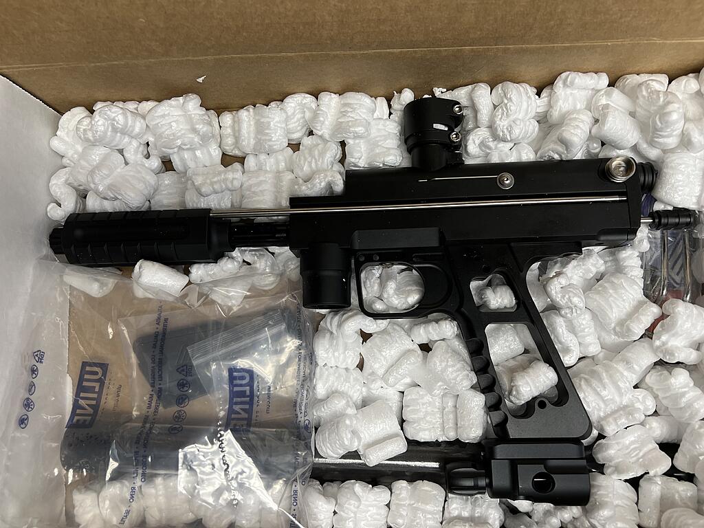

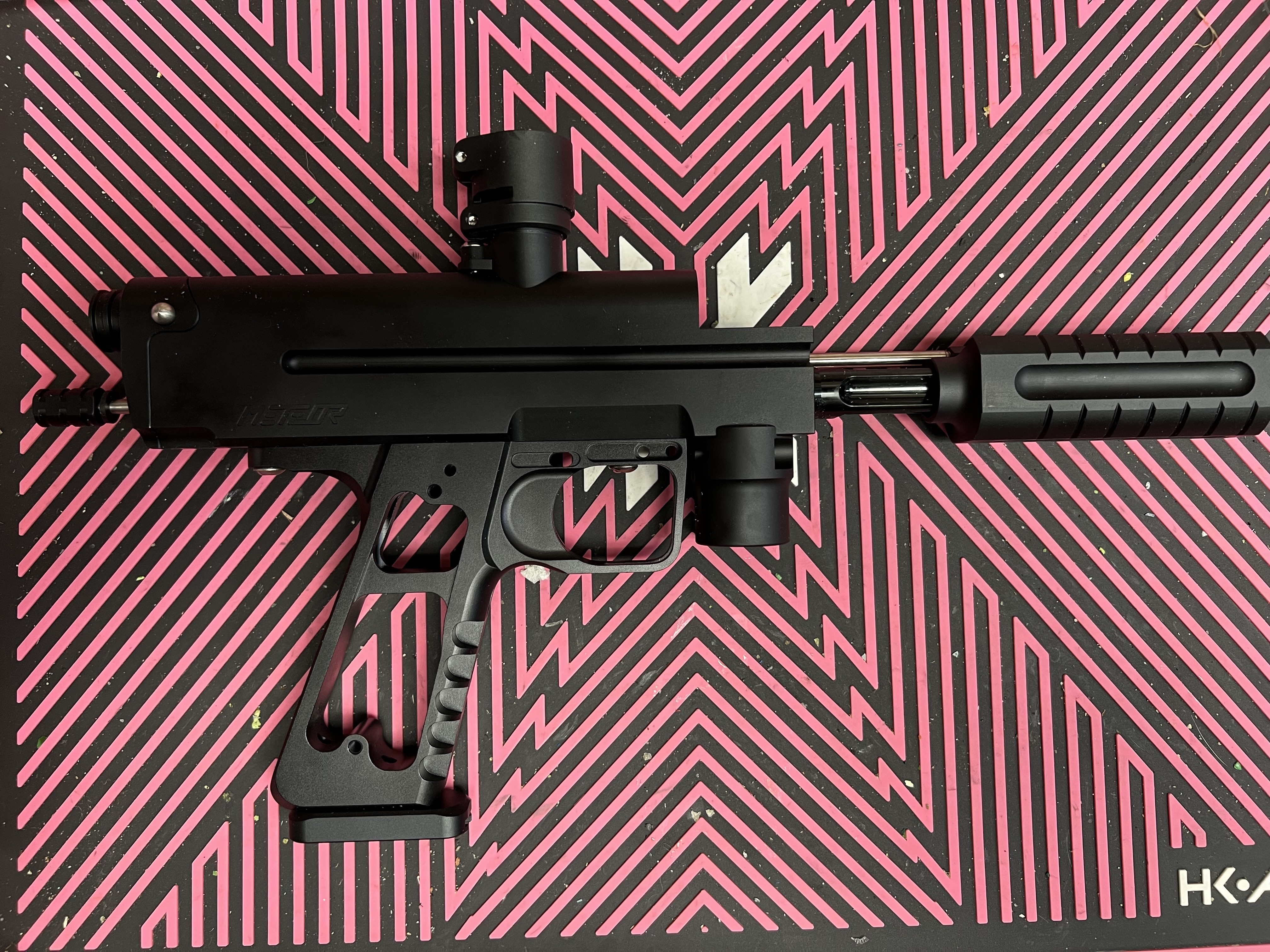

    Finally got my Meteor, so time to take it apart — actually, let’s start from the beginning on this:
ID:	581907 Click image for larger version
ID:	581911 Click image for larger version
ID:	581909 Click image for larger version
ID:	581910 Click image for larger version
    • 4563

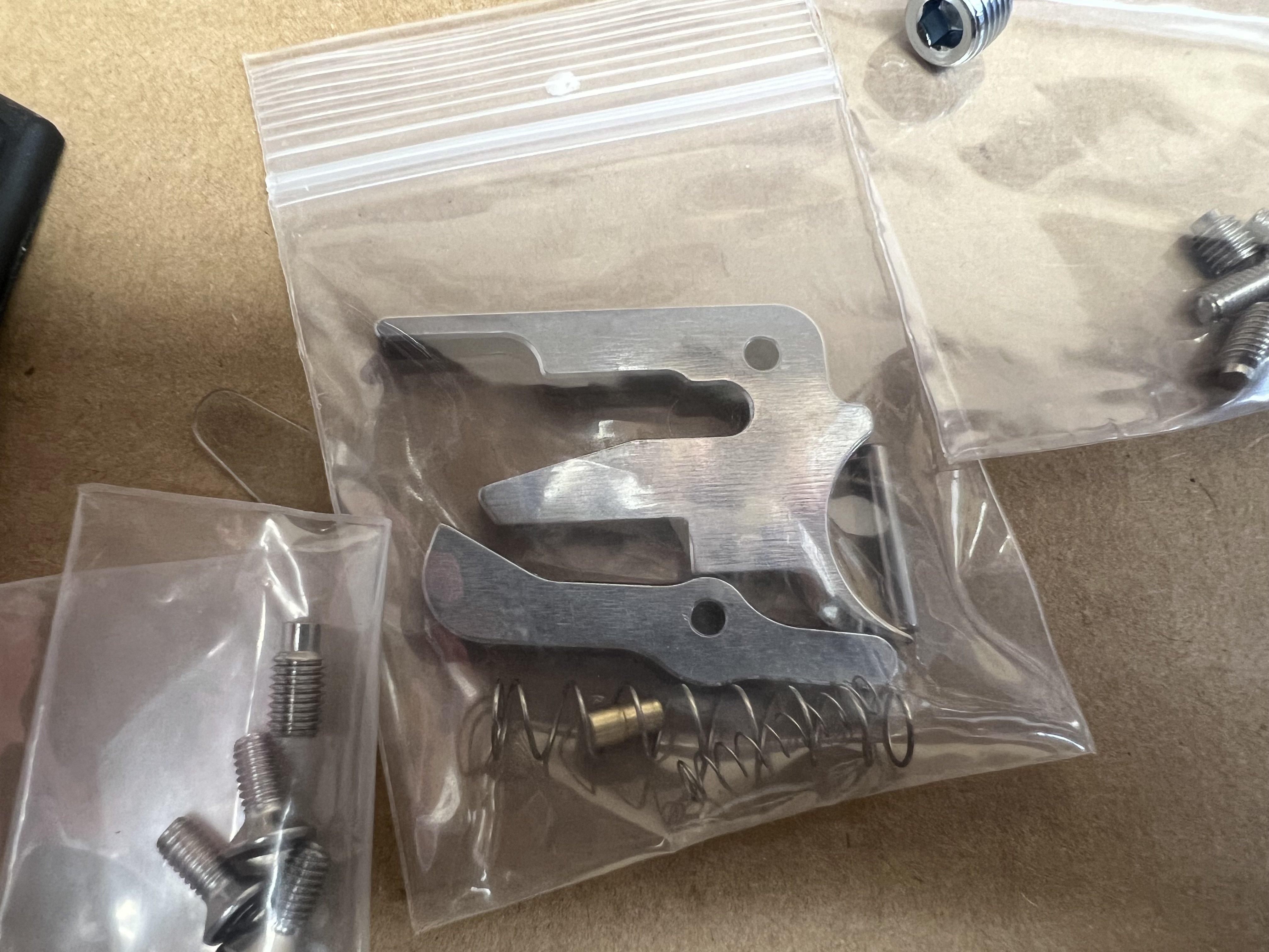

    So lots of bits and pieces to install, and I had a stray little part that later found a home:
    So make sure you check your boxes!

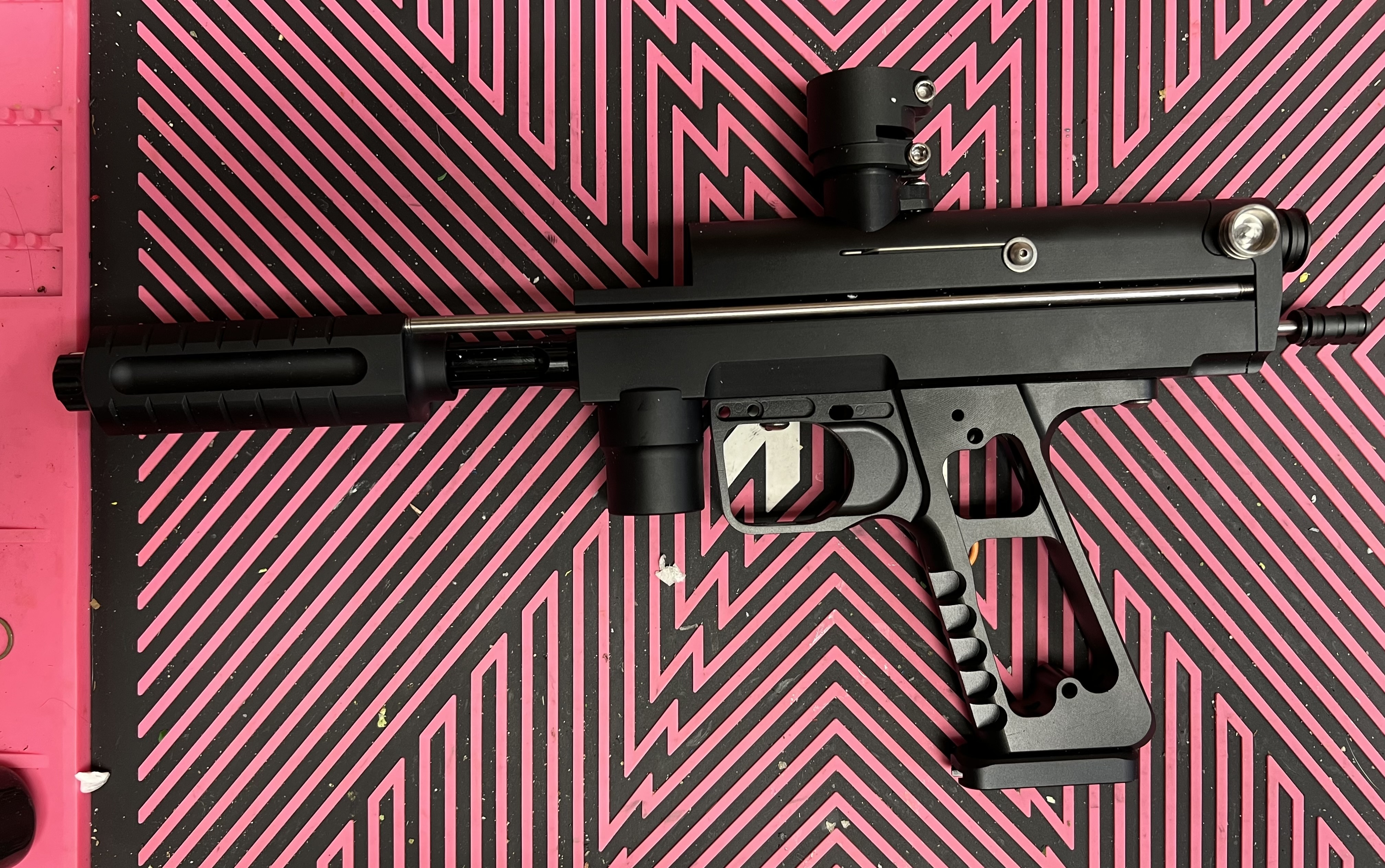

    Now don’t be alarmed, the ASA is here, it was just loose so I removed it. But here’s the marker:
ID:	581916 Click image for larger version

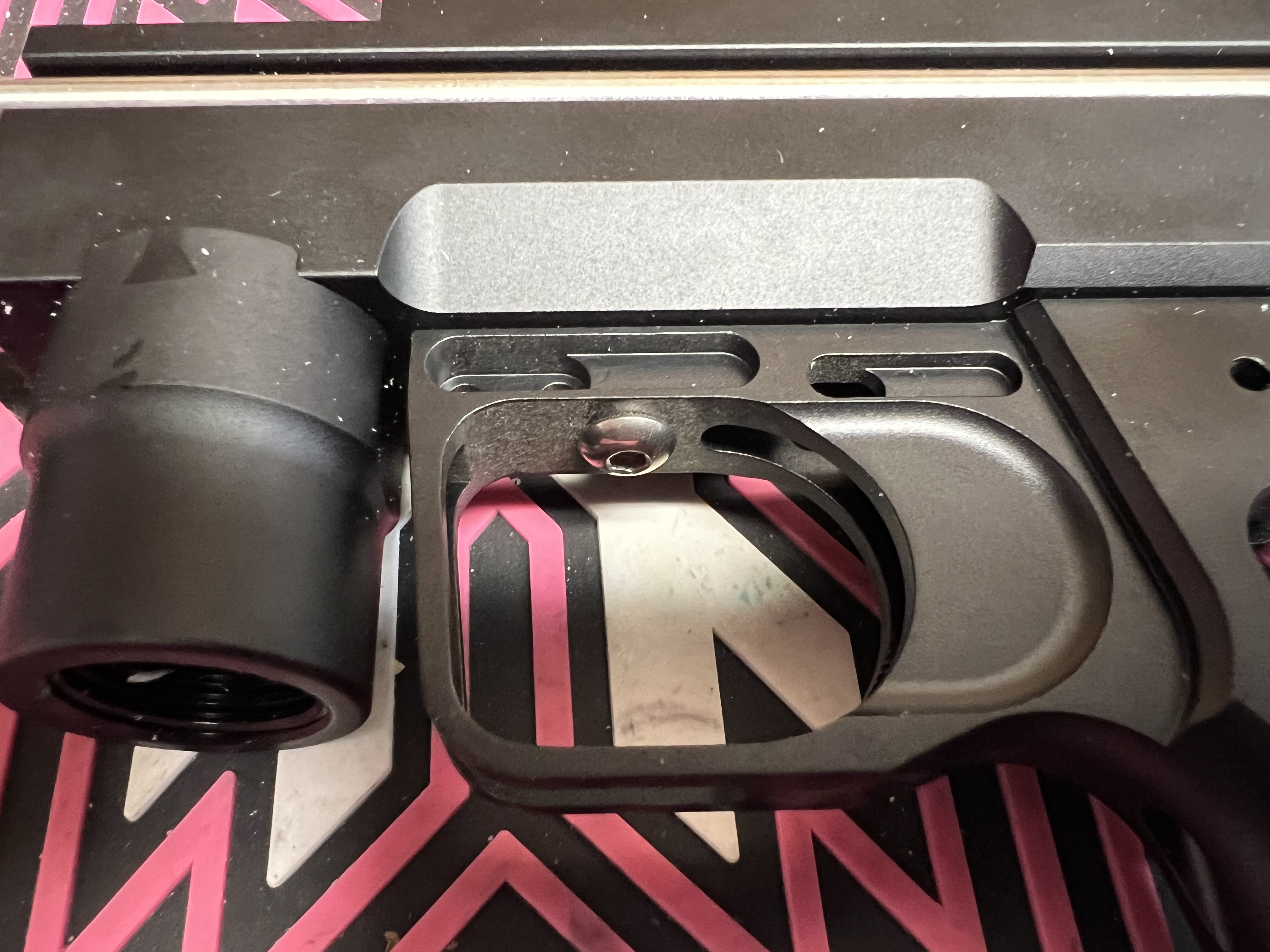

      • 4563

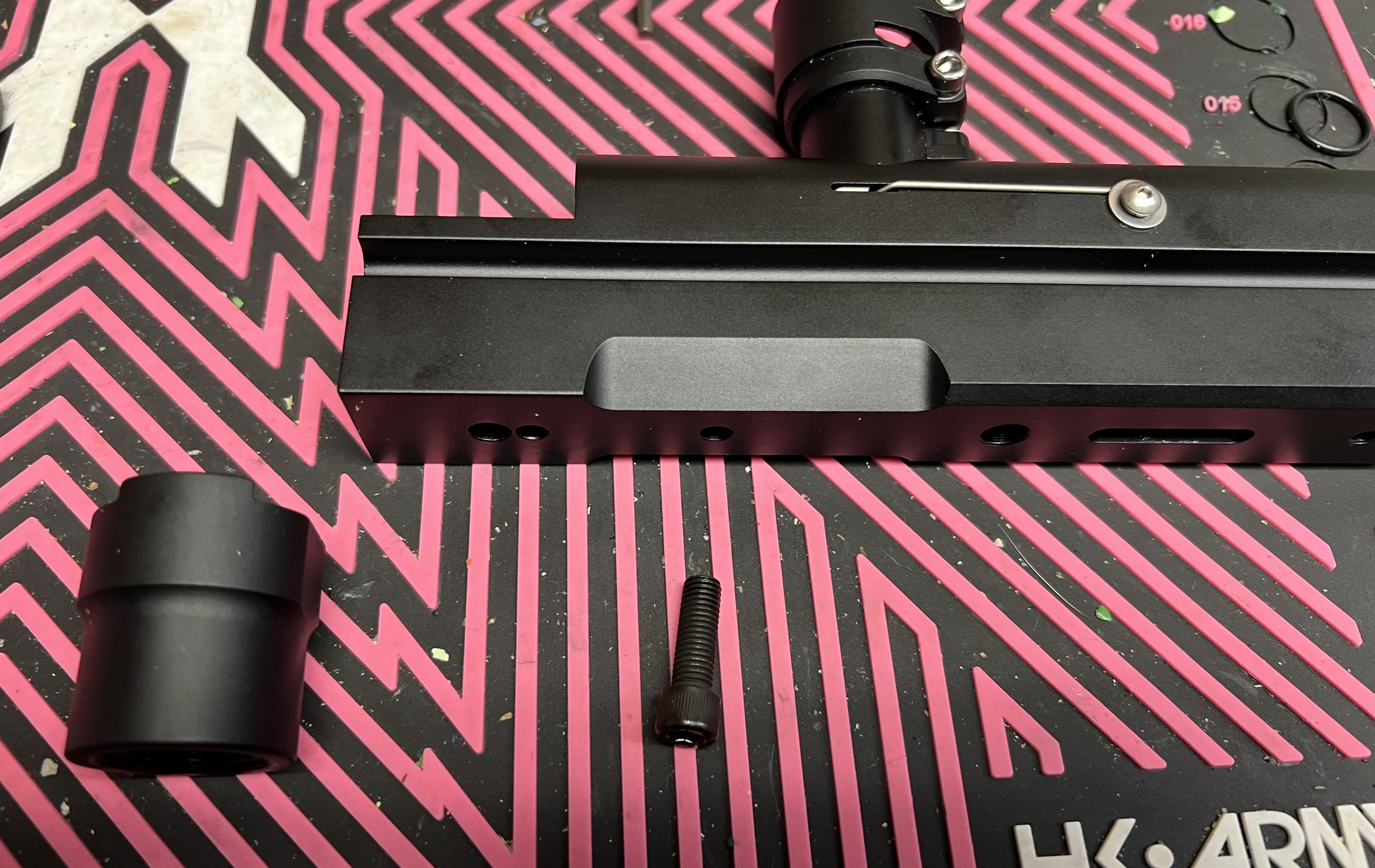

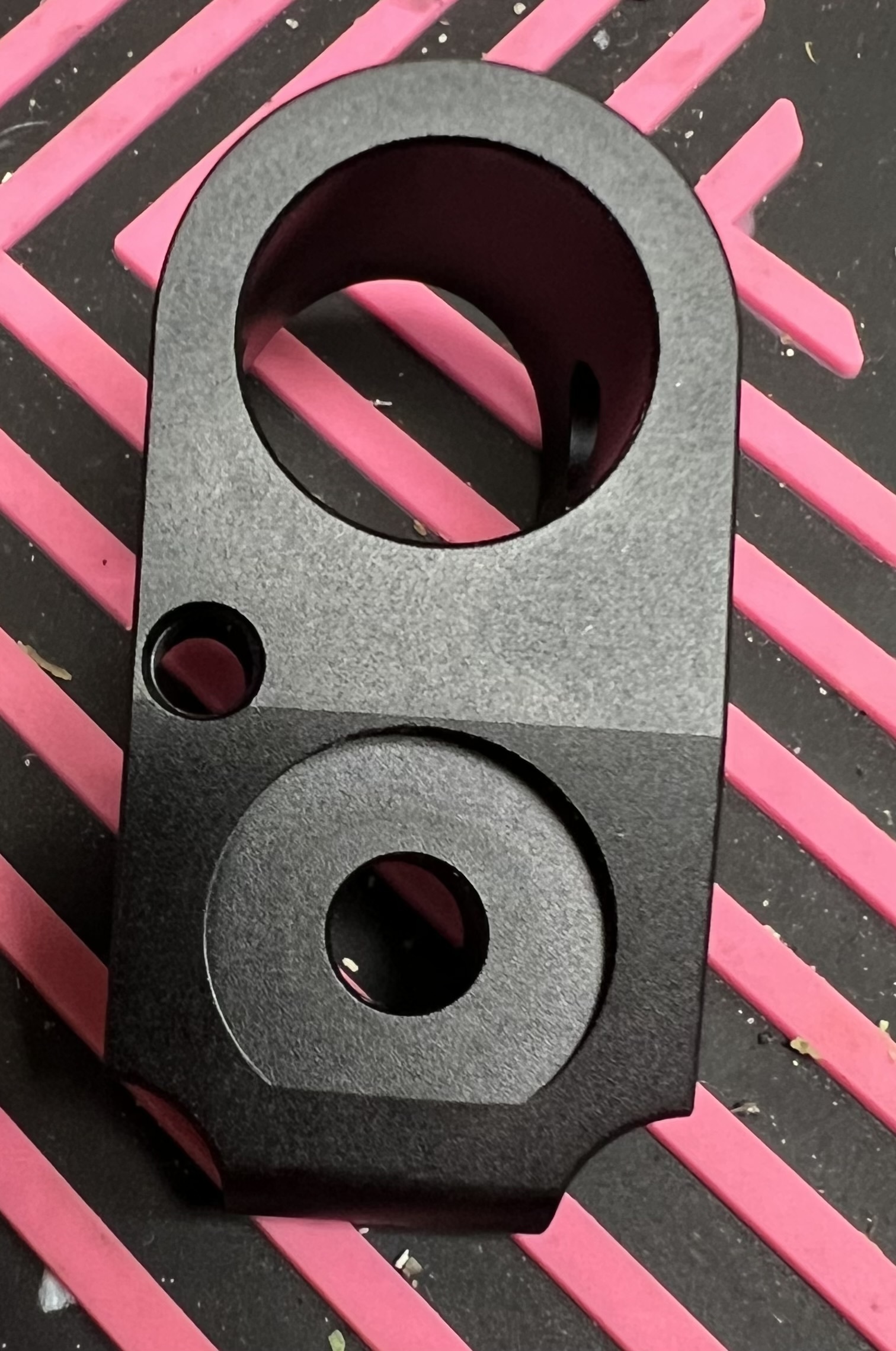

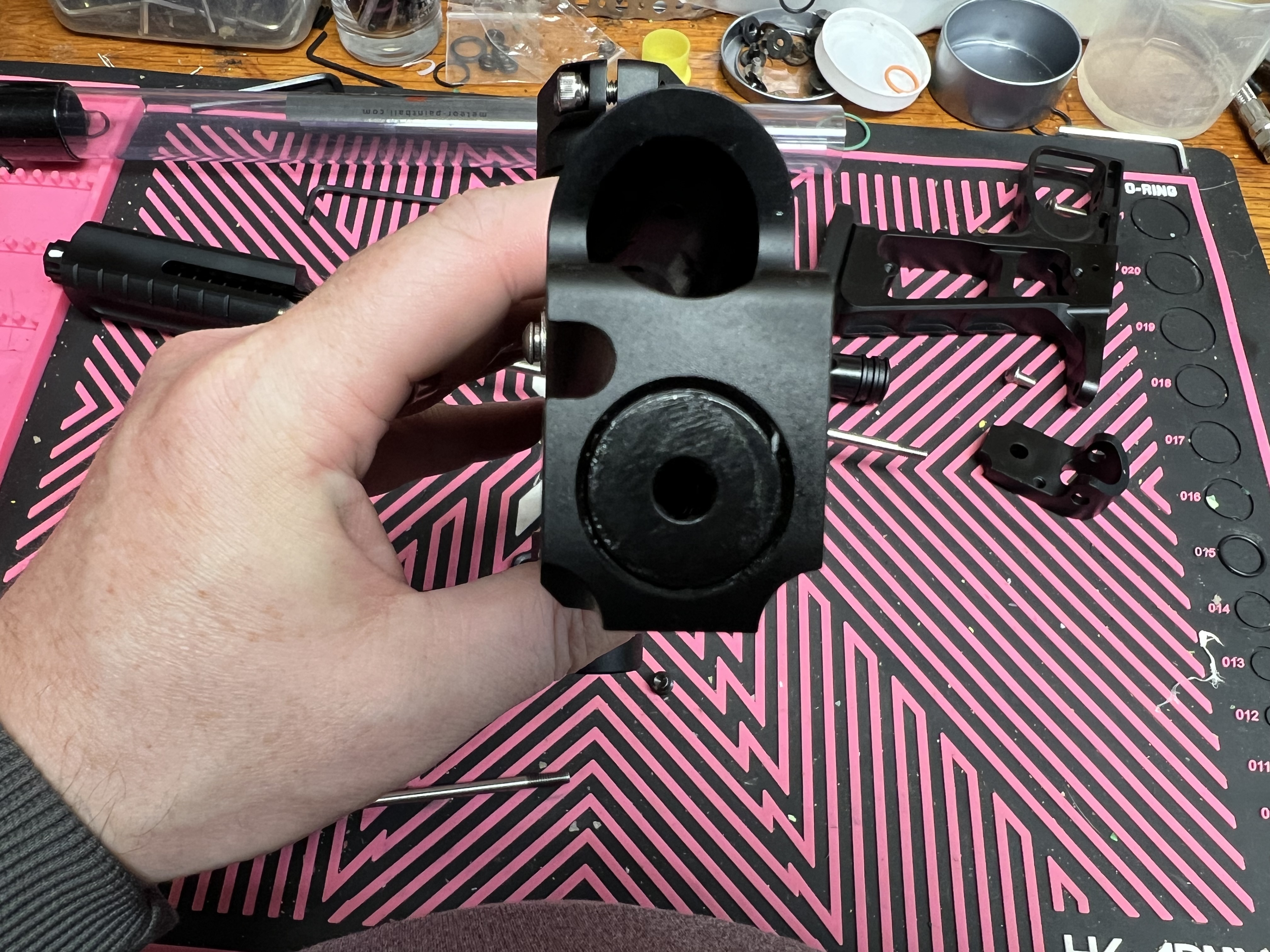

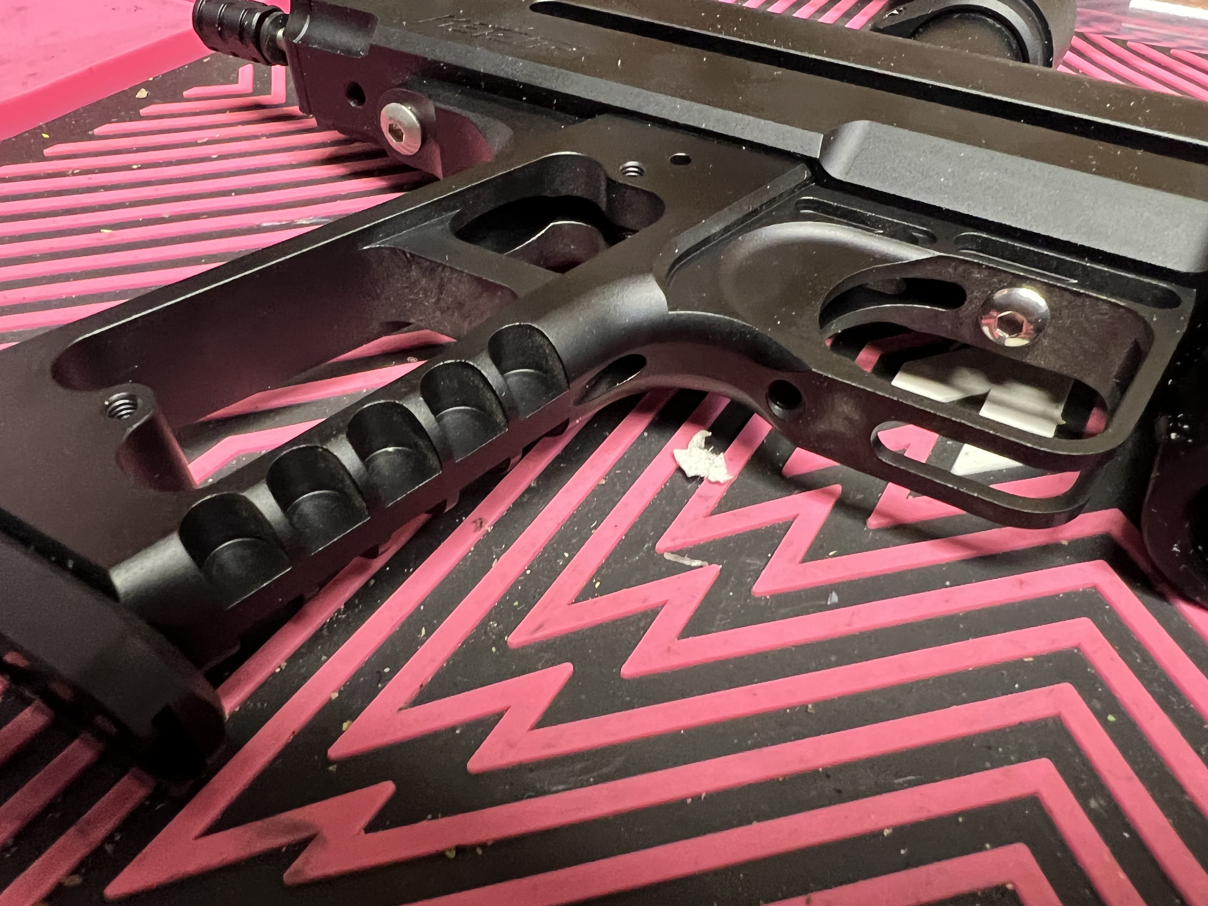

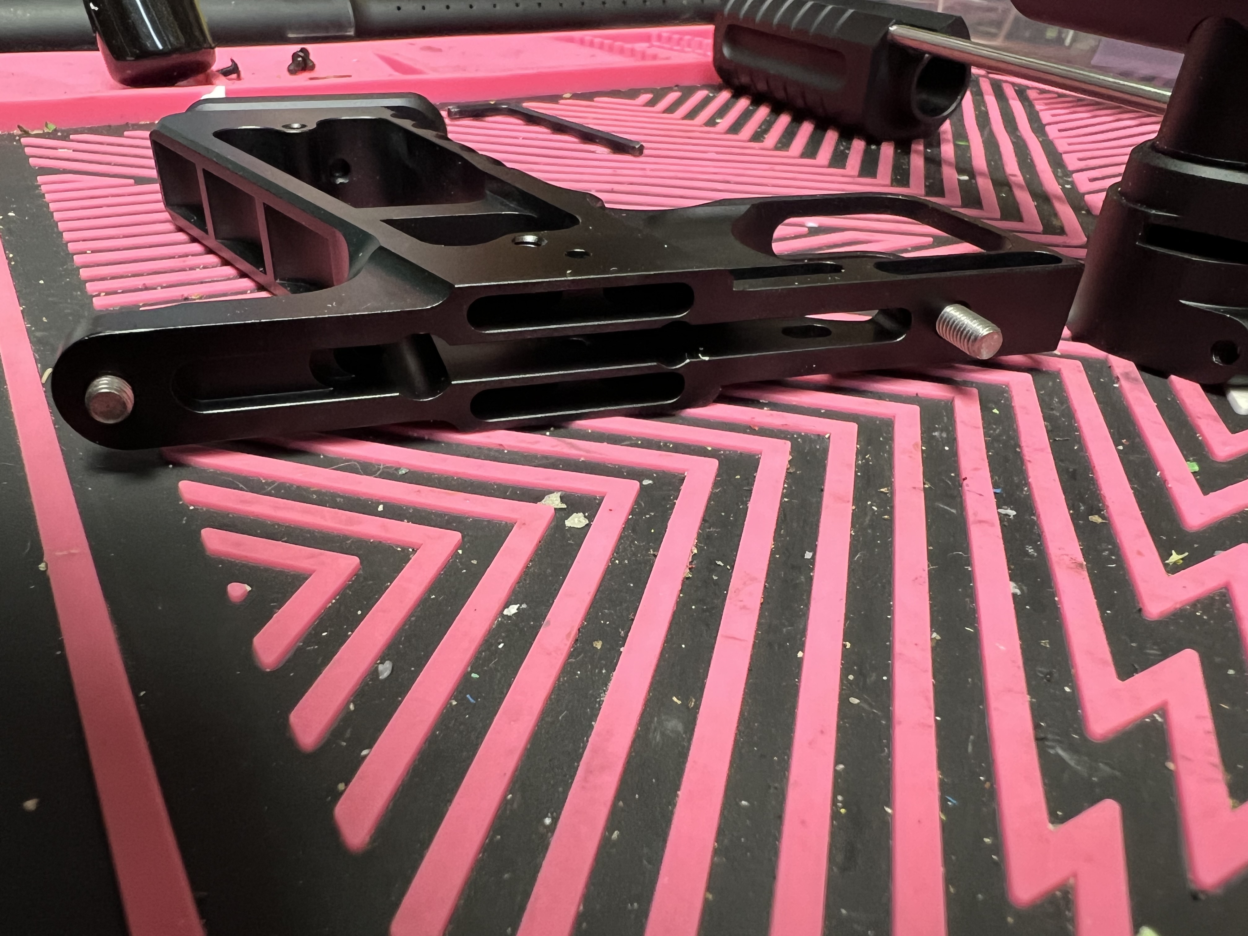

      First thing to note is the milling on that frame is no joke!
ID:	581919 Click image for larger version

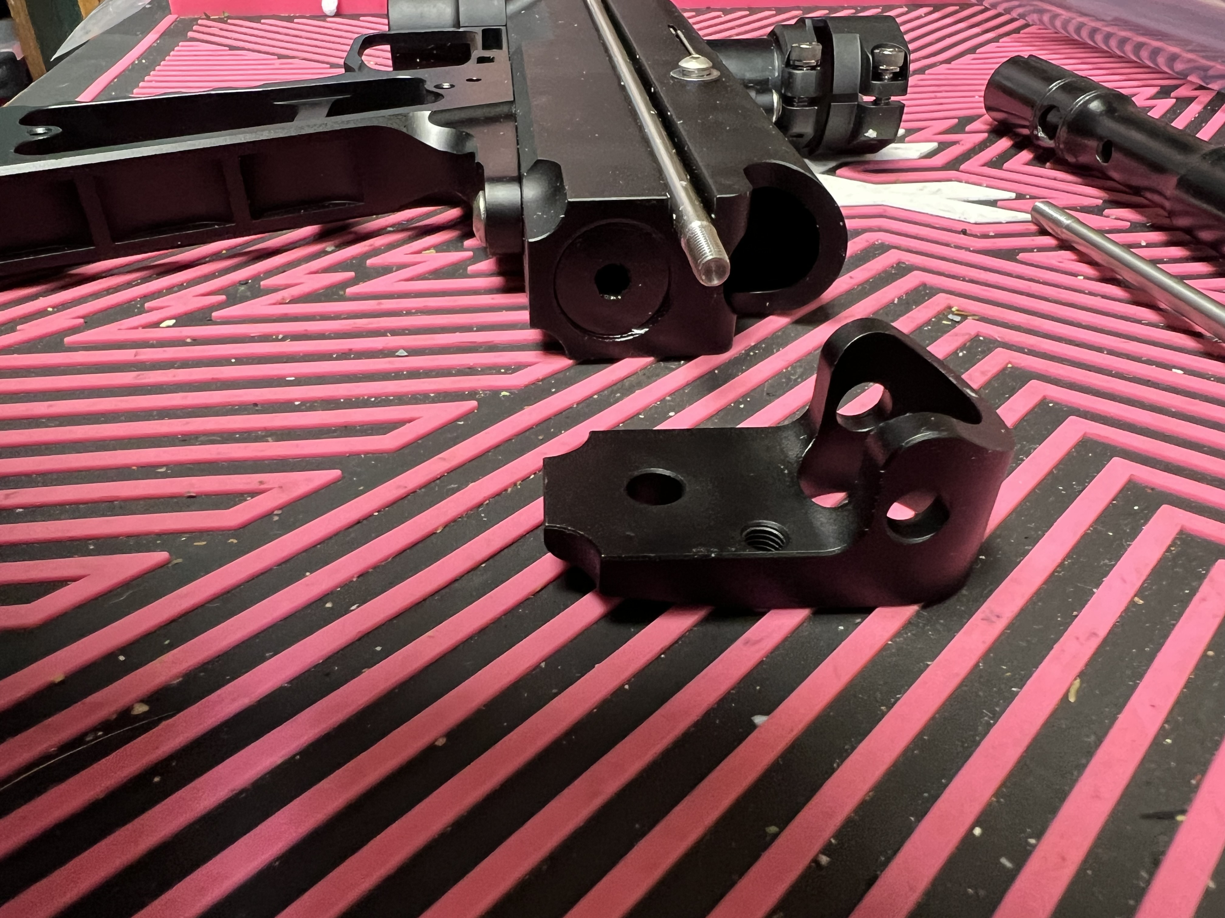

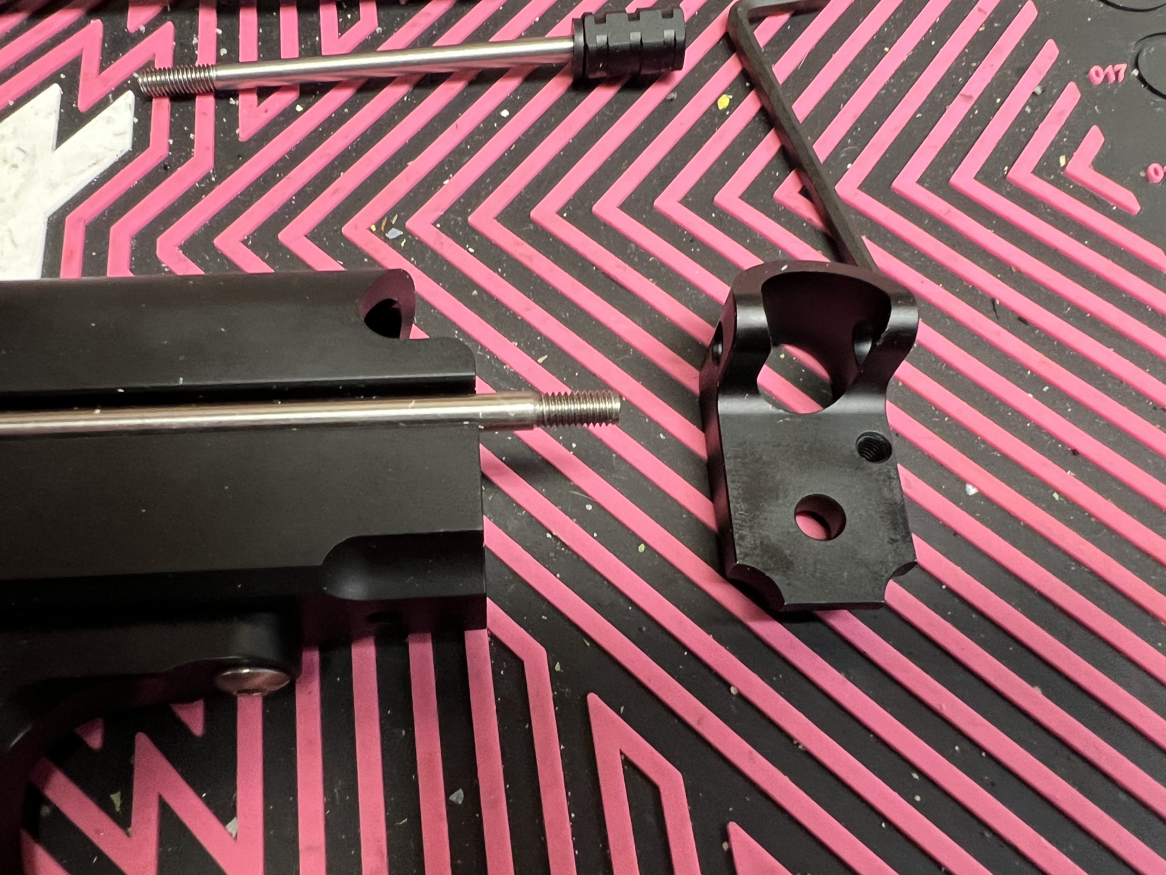

      And sneaking ahead a little to where I removed the trigger frame:
        • 4563
ID:	581927 The back block fits nicely with the body and is very nice and light. but meaty in all the right places.
        Click image for larger version  Name:	IMG_1760.jpg Views:	0 Size:	1.67 MB ID:	581924 Click image for larger version  Name:	IMG_1764.jpg Views:	0 Size:	2.04 MB ID:	581923 Click image for larger version  Name:	IMG_1765.jpg Views:	0 Size:	1.97 MB ID:	581925

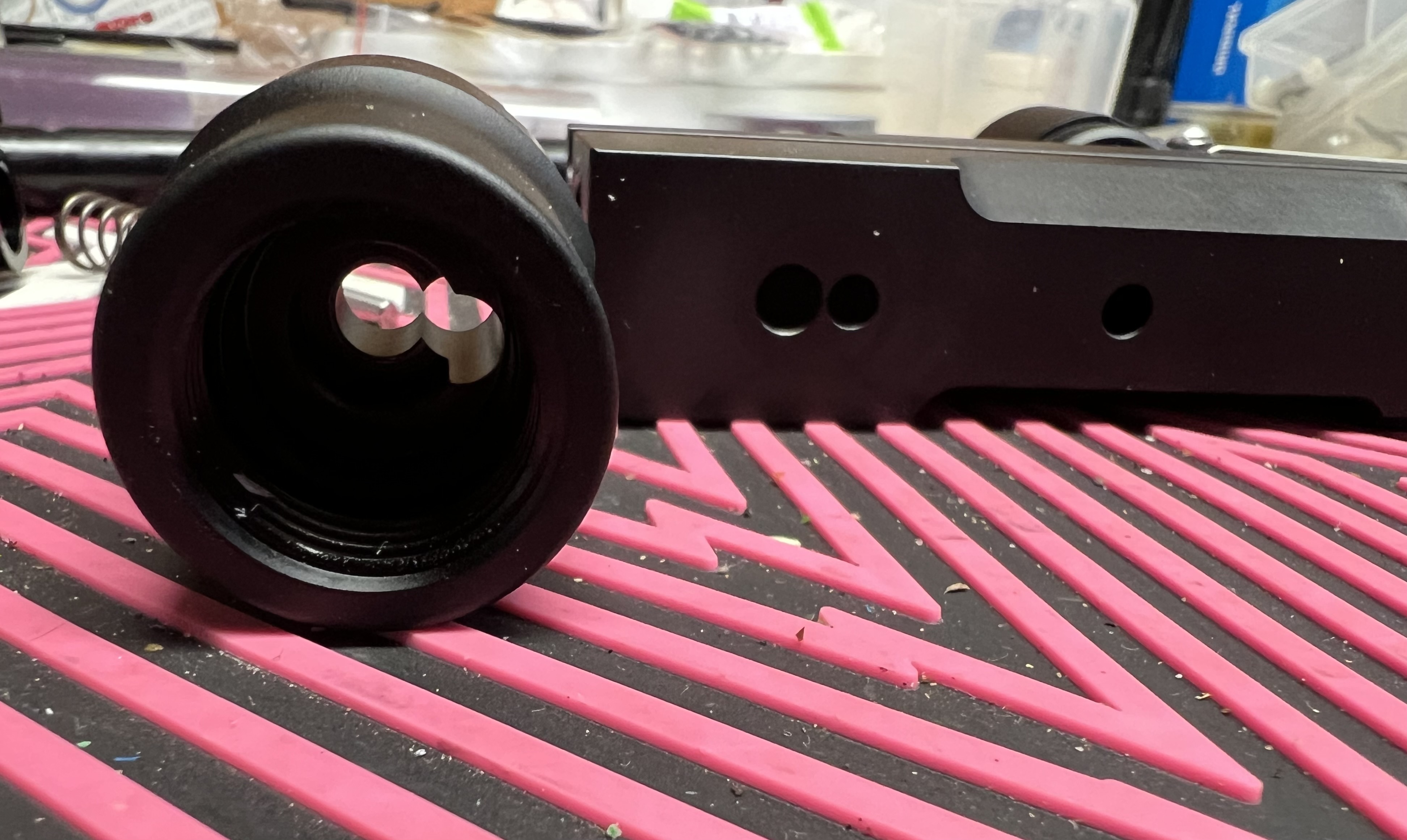

          • 4563

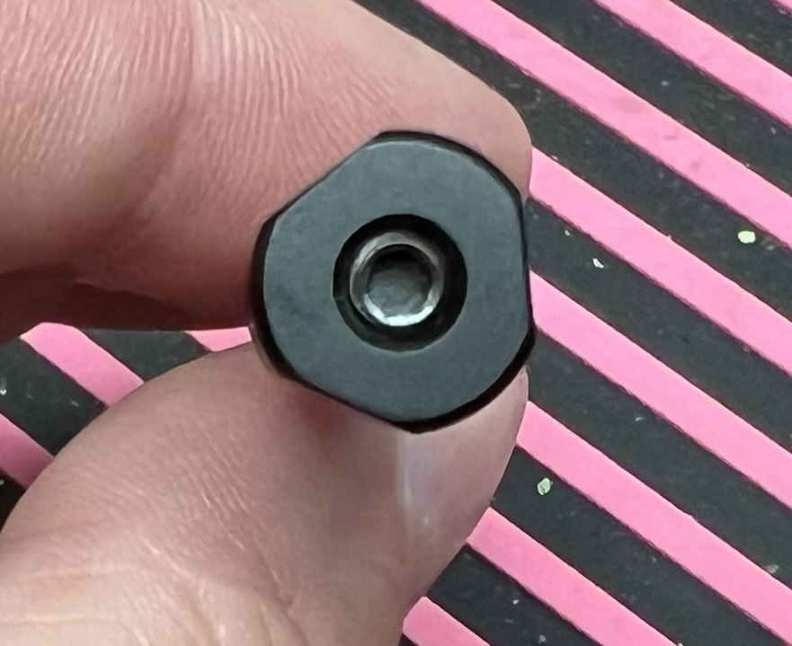

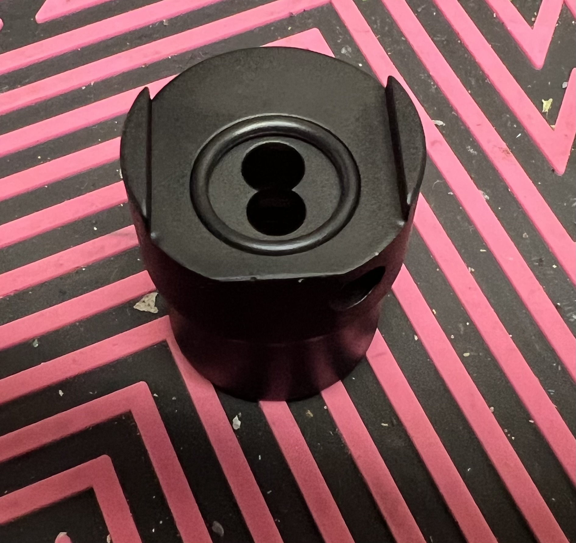

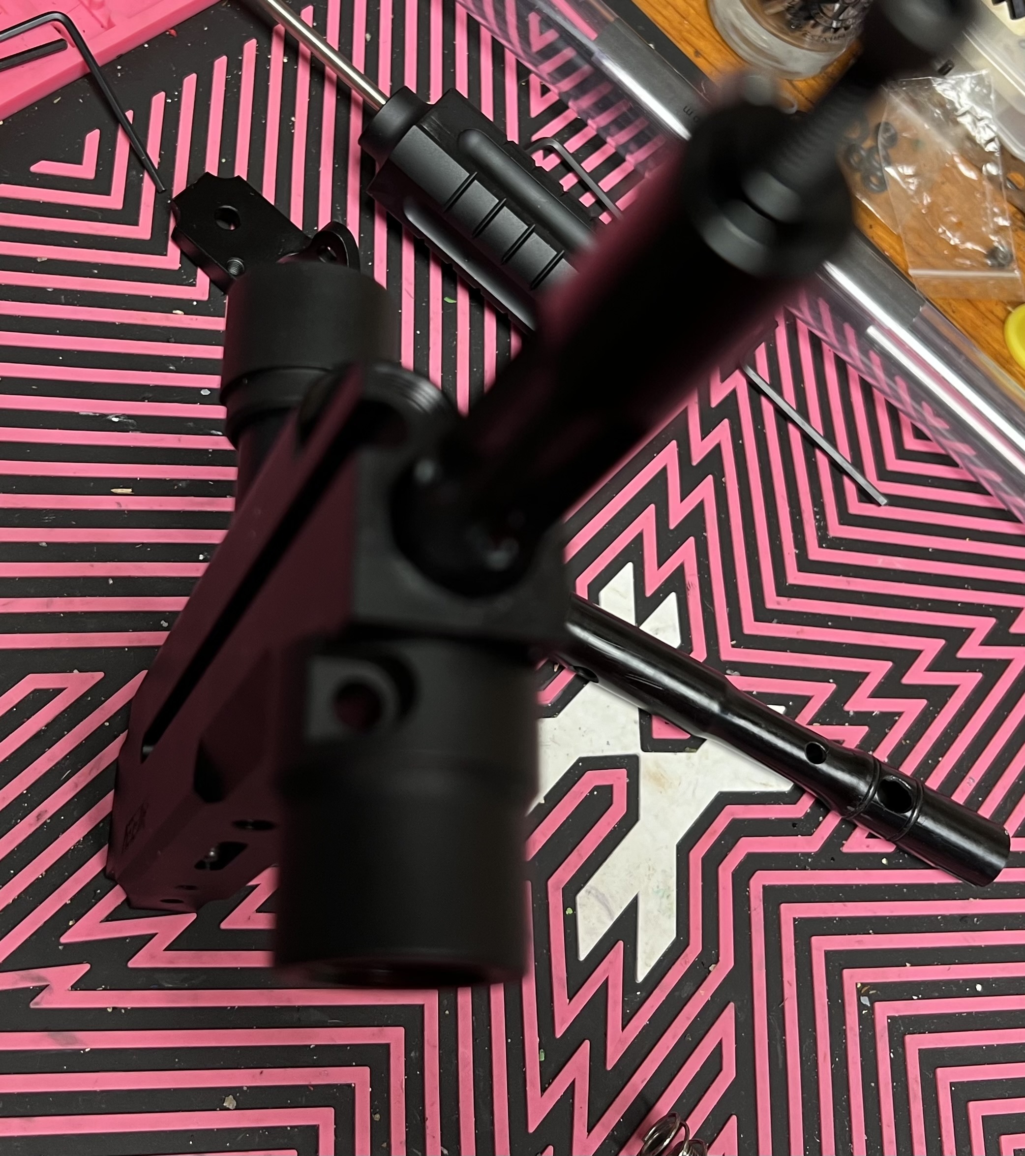

ID:	581931 Behind the back block is the IVG. Was a little surprise to see it’s just a standard single hole IVG, but given the price point understandable. Likely be replacing it with an easier to adjust version I have in my parts kit.

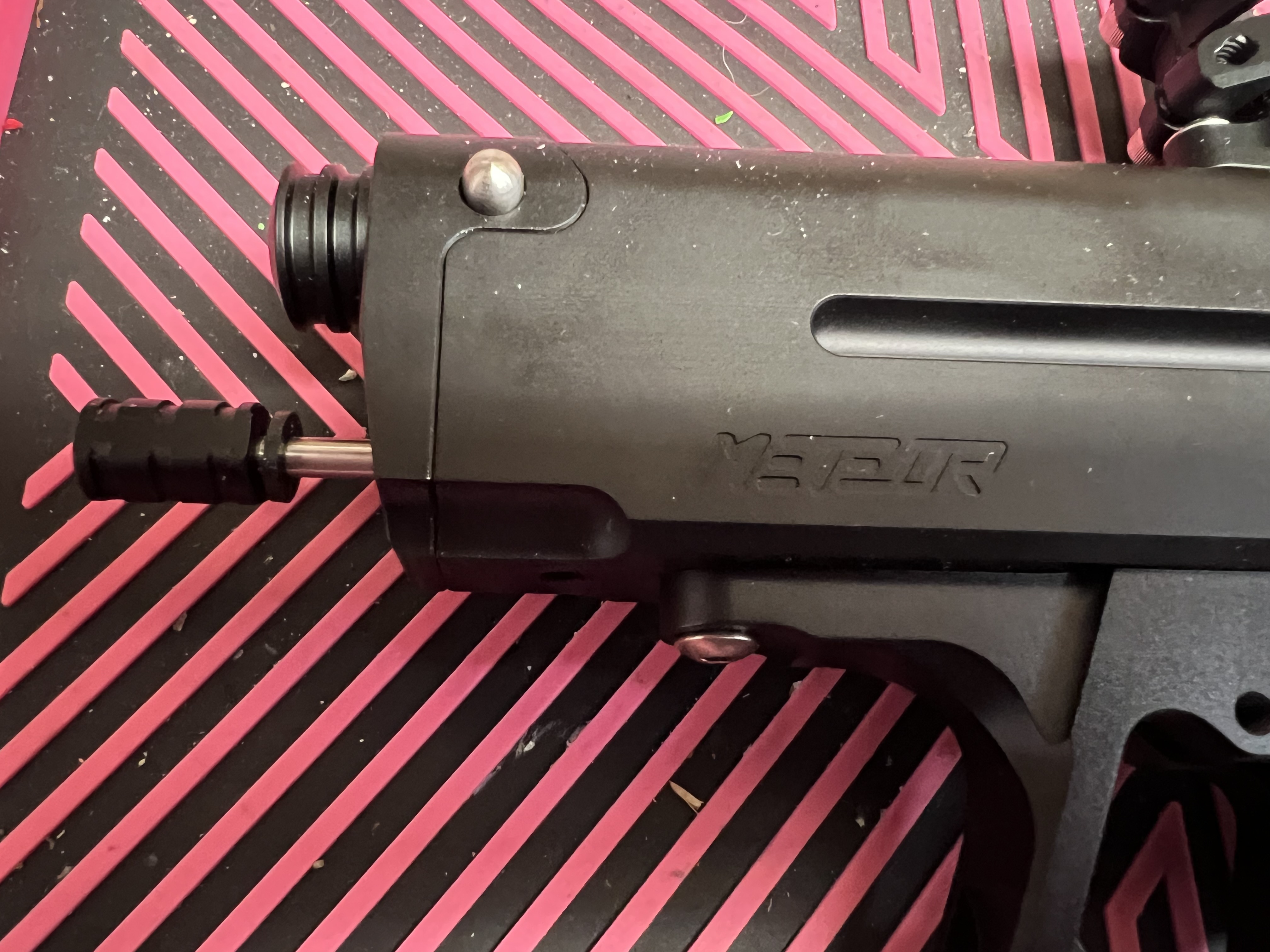

            • 4563

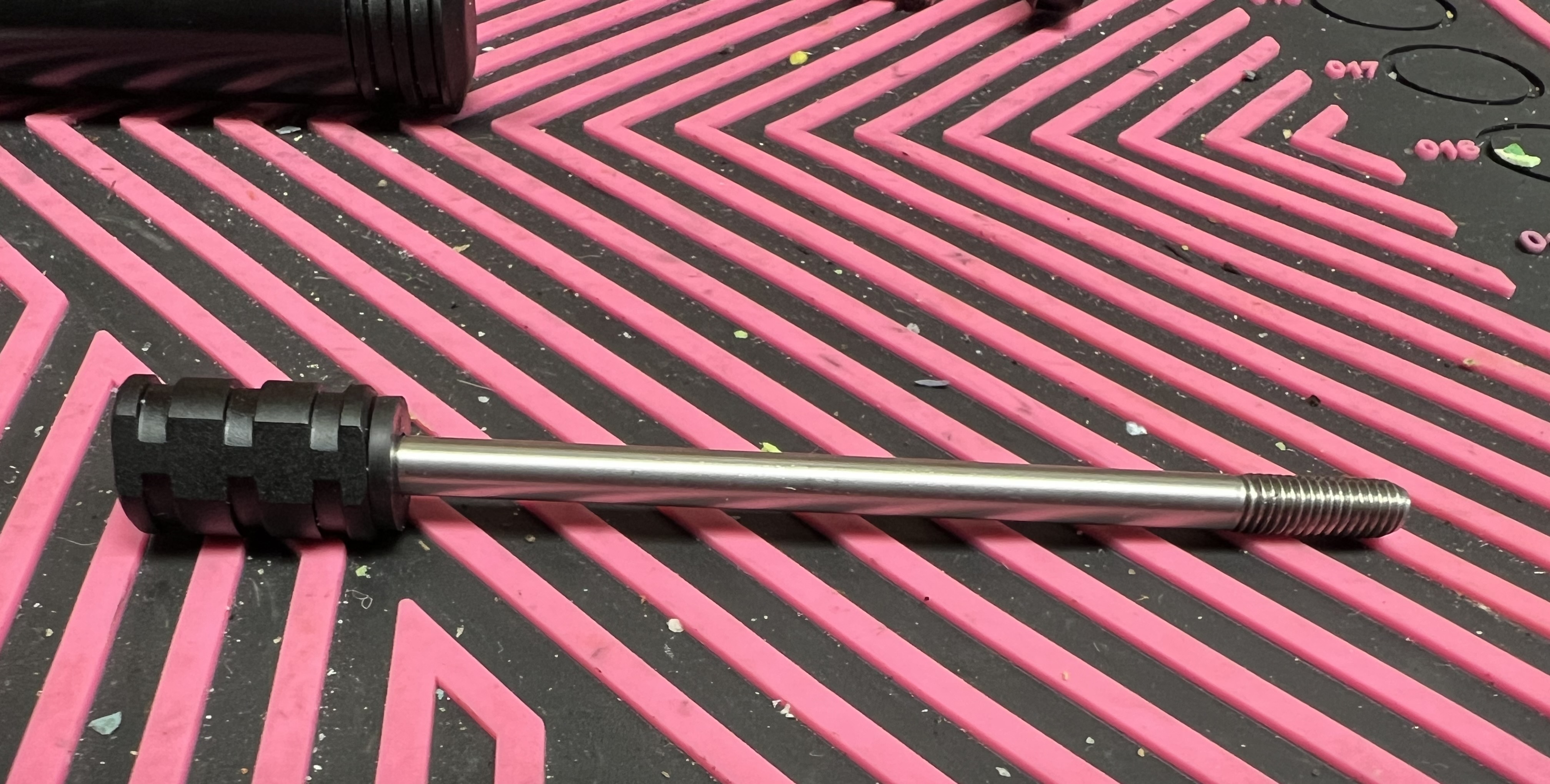

            The cocking rod is nice, but don’t forget to adjust it and loctite it! My knob spun off while trying to remove the cocking rod.
            Click image for larger version  Name:	IMG_1777.jpg Views:	0 Size:	1.38 MB ID:	581936 Click image for larger version  Name:	IMG_1778.jpg Views:	0 Size:	113.6 KB ID:	581935

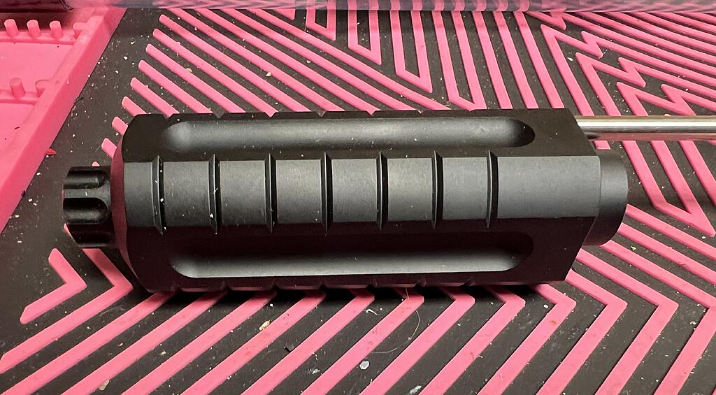

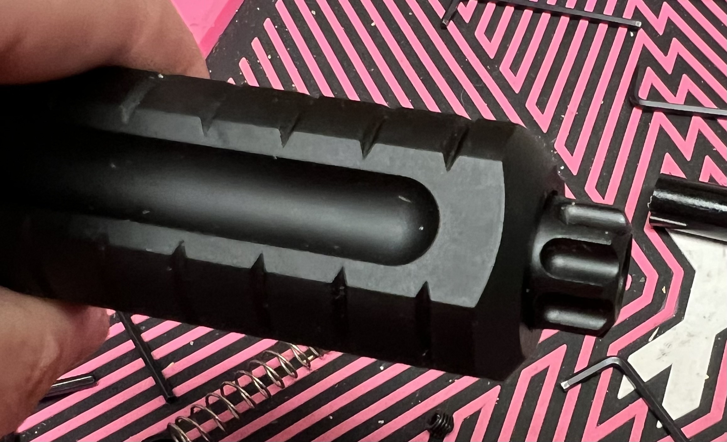

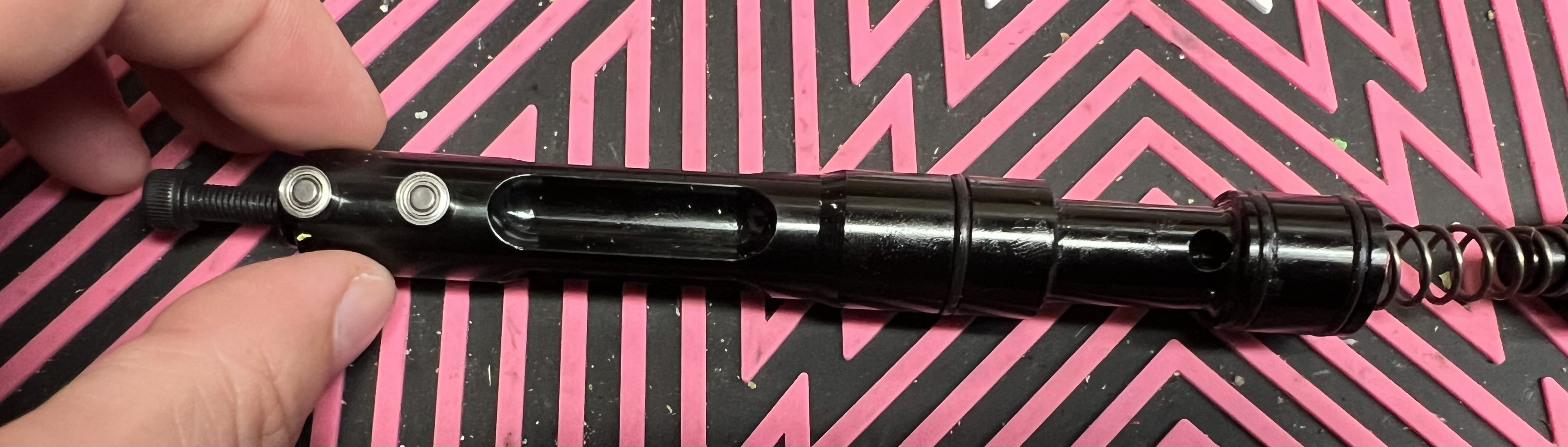

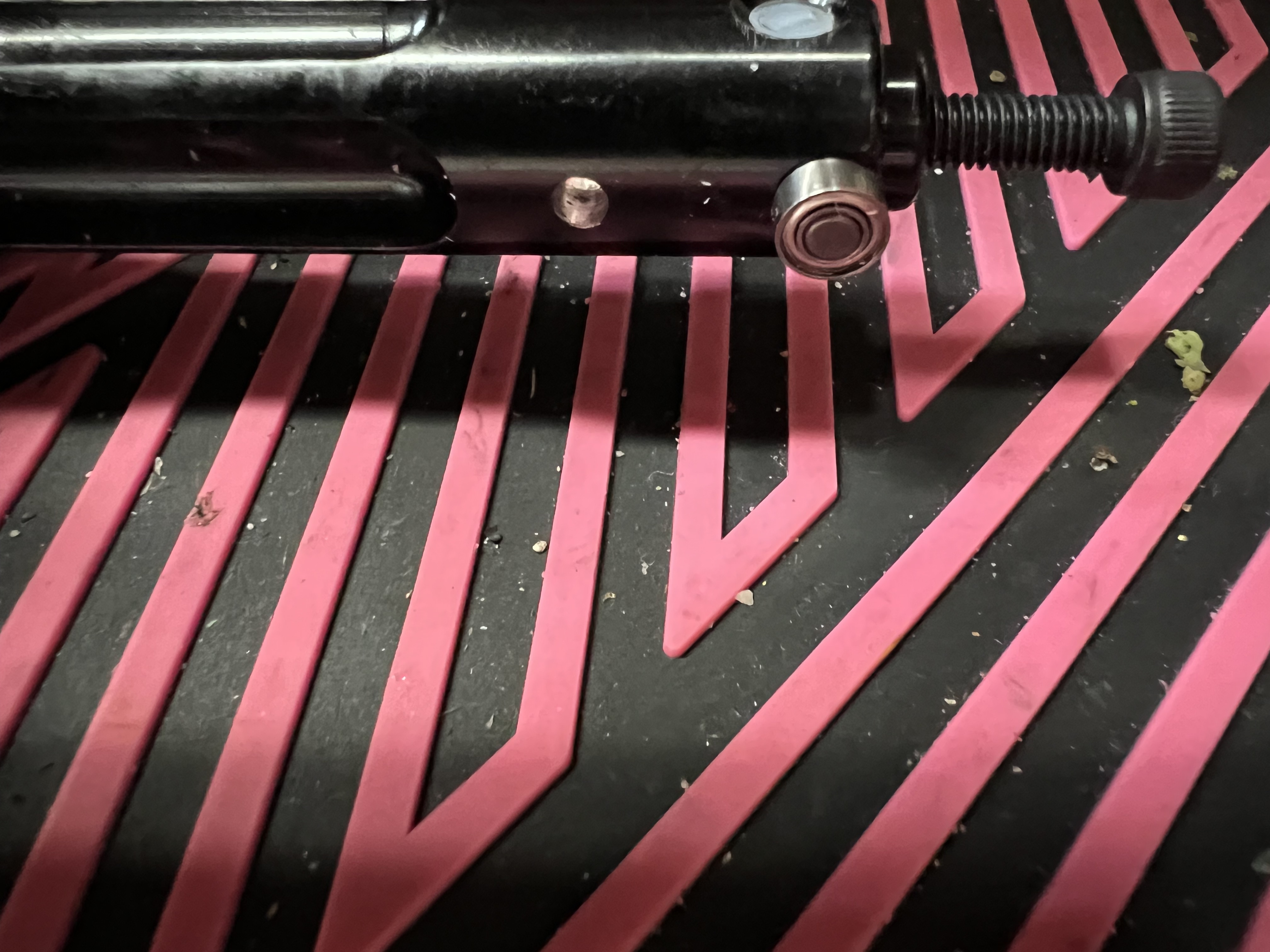

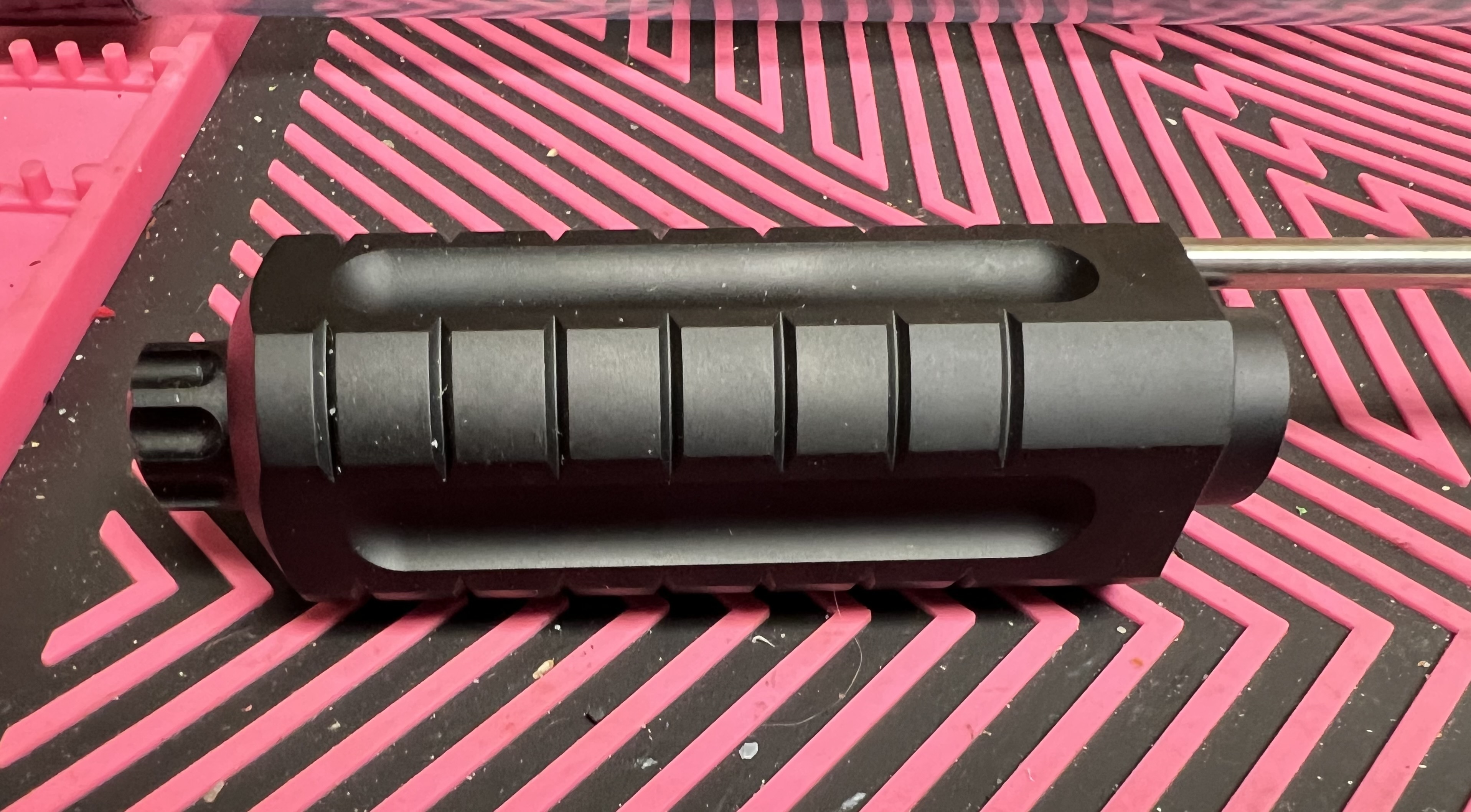

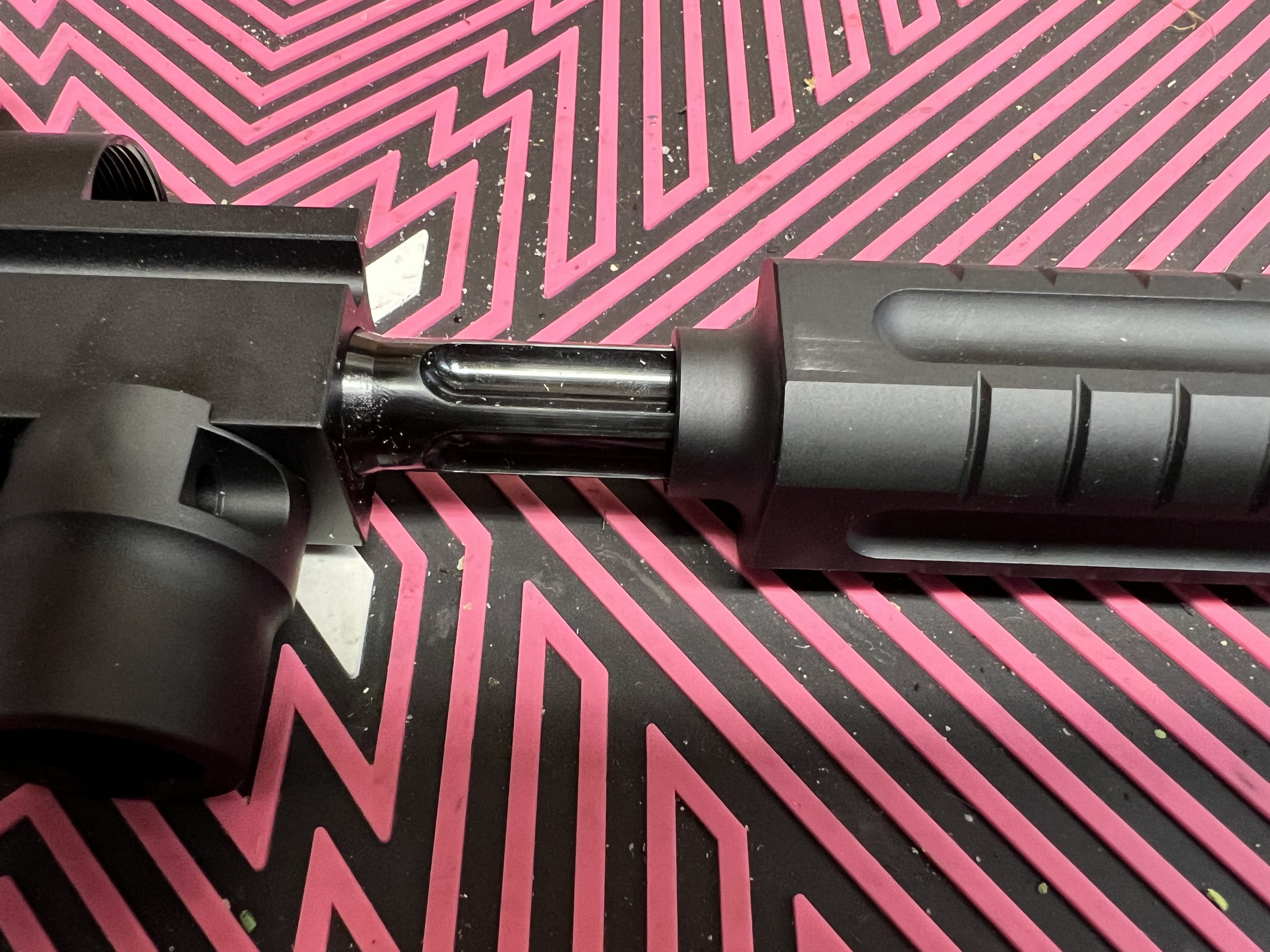

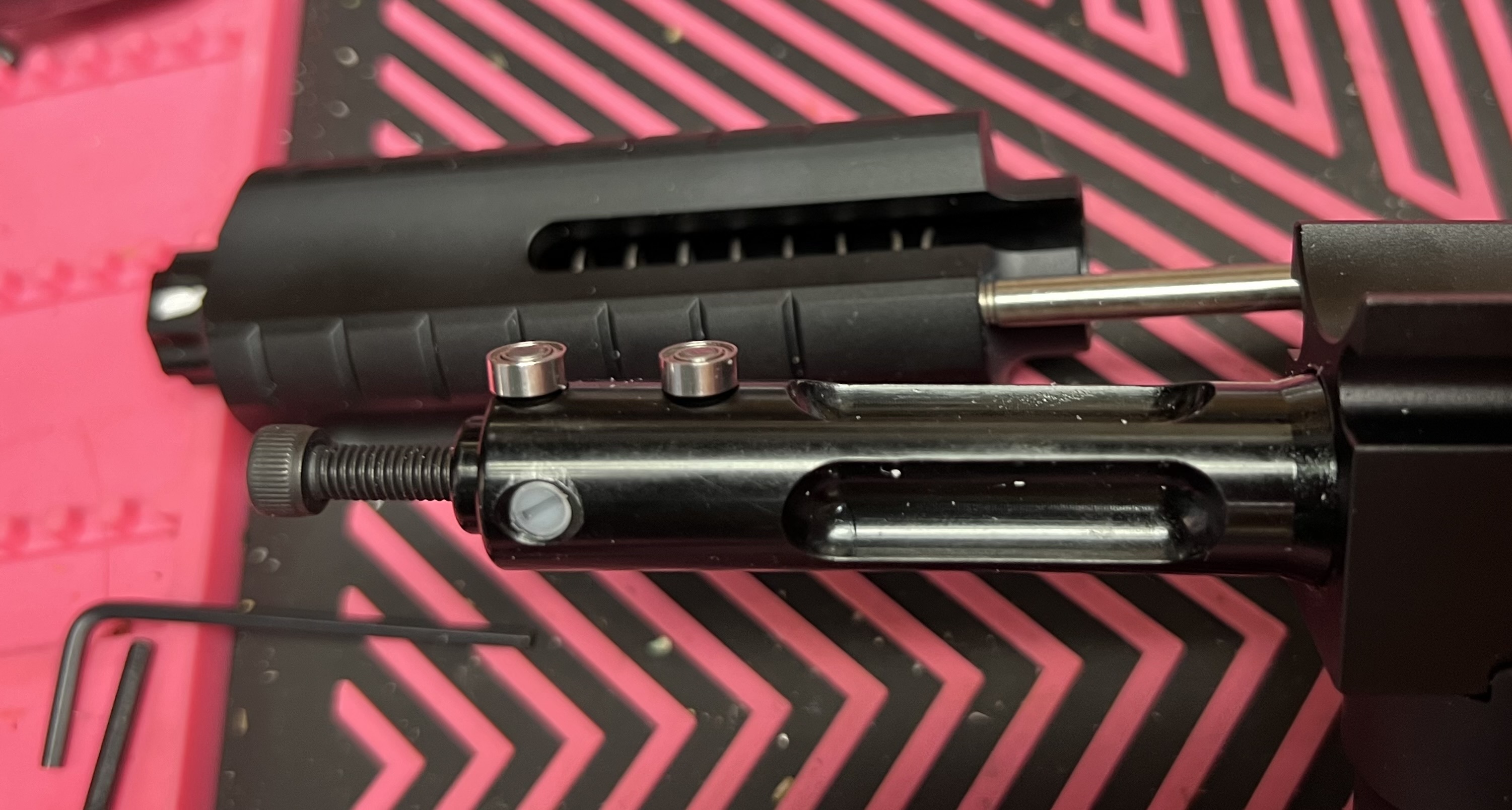

              So let’s pump back to take look at the pump handle, and it’s a pretty unique setup.
              It’s got a fluted pump rod:

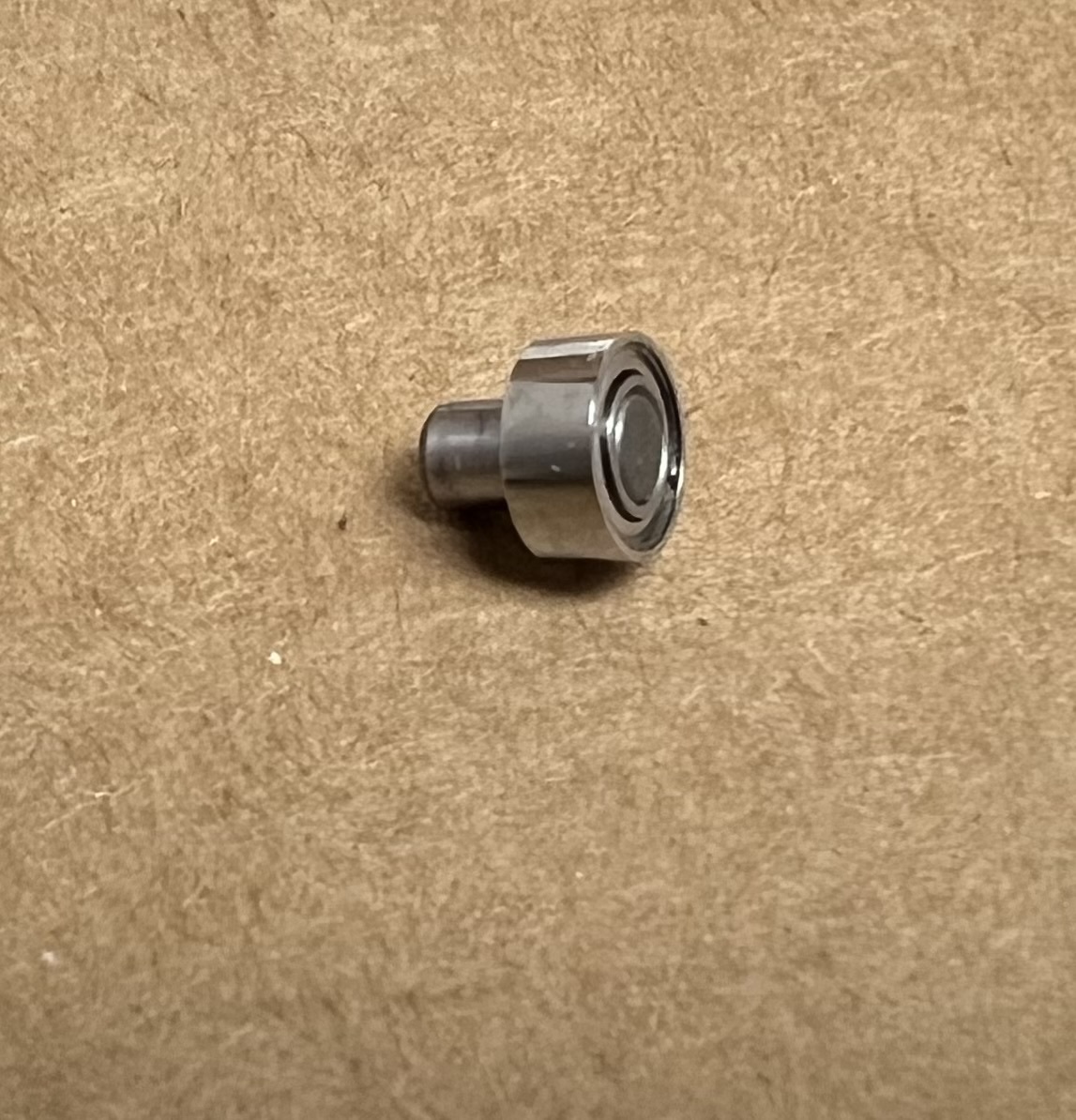

              And small bearings along the top of the pump. This is where my stray part belonged! It appears to be just press fit into the pump rod. Hopefully it does’t fall out while using it.
              And a look at the handle and internals including return spring:
ID:	581938 Click image for larger version
                • 4563
ID:	581947 Click image for larger version
ID:	581946 At the front of the pump hand is pump return tension adjuster. Screw in, for a stronger return, screw out of a lighter return.
                This is the feature that may affect me the most. I’m not worried about adjusting the tension (one can just switch springs) but the adjustment knob may I interfere with how I how my pump handle. I strongly disliked the ID Drift pump kit handle. Have to see how this fairs
                And here is how the bearings fit with the pump handle:
                Click image for larger version  Name:	IMG_1779.jpg Views:	0 Size:	791.9 KB ID:	581944

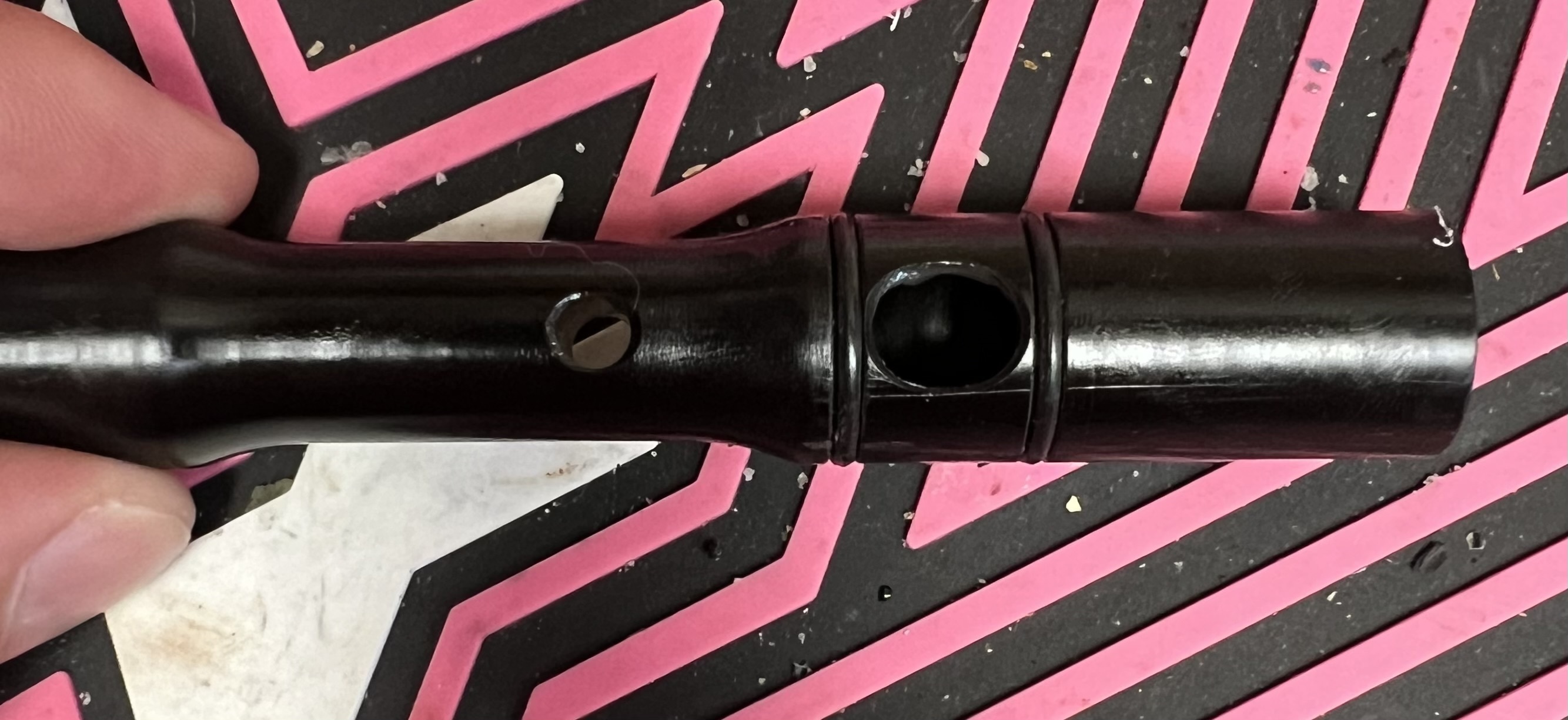

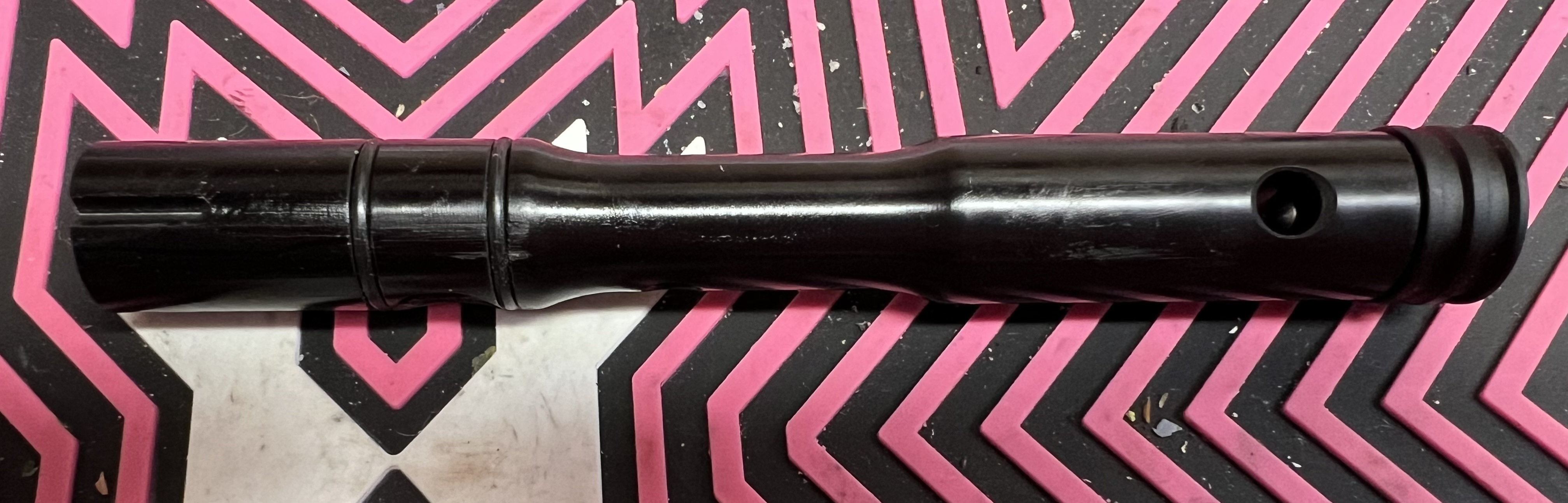

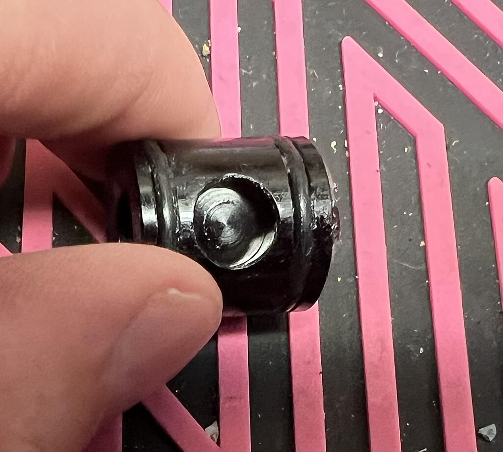

                I received a bolt with dual o-rings and detent channels on both sides.
                It’s open faced with a decent air passage.

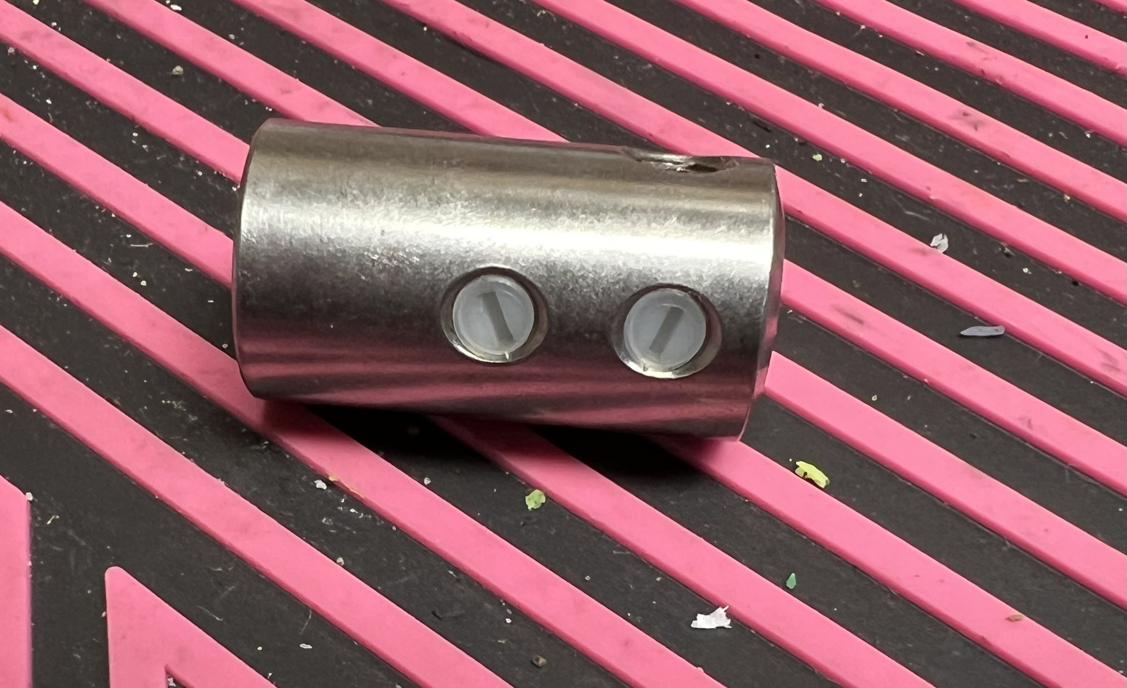

                      3mm Allan key for the win!

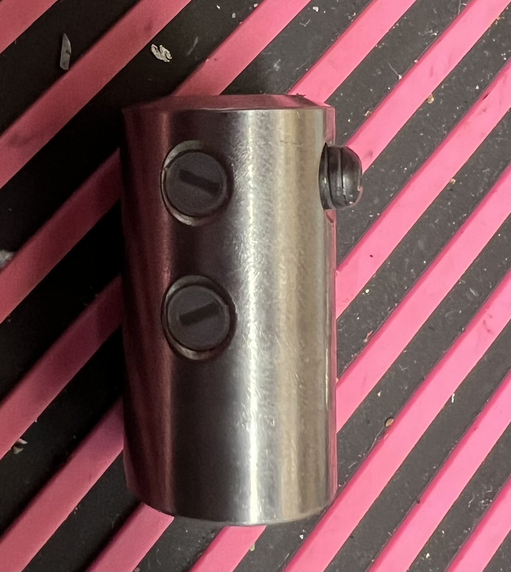

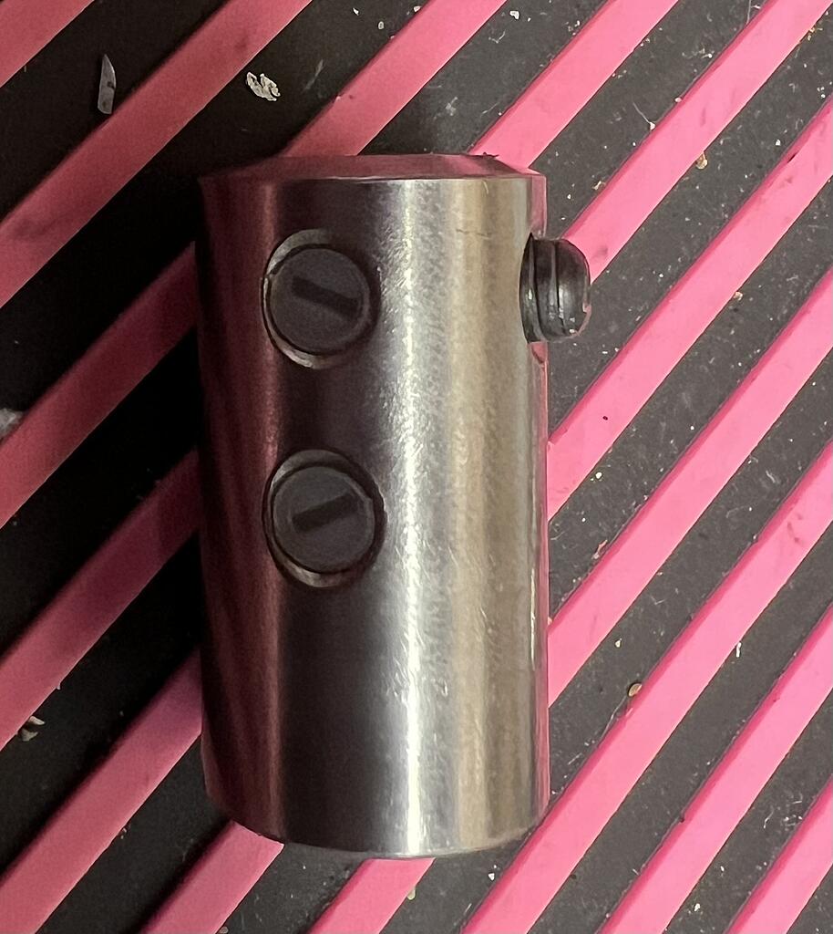

                      I’ve pulled the lug up and removed the hammer:
                      dual plastic retaining screws, rounded lug tip.
                      And bad news for those dropping Lazarus valves into this, the hammer is not flush c meaning it may have issues with the Laz valve.

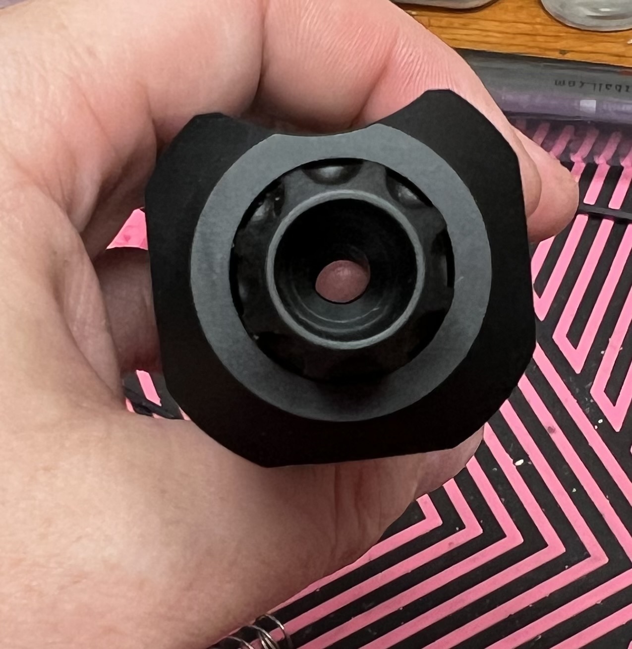

                      The VASA comes off with an Allan key, which is nice.

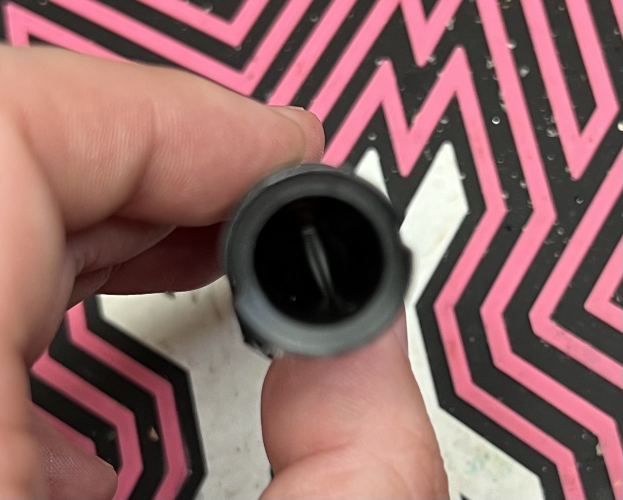

                      VASA has a nice o-ring and a good size air passage:
ID:	582007 Click image for larger version

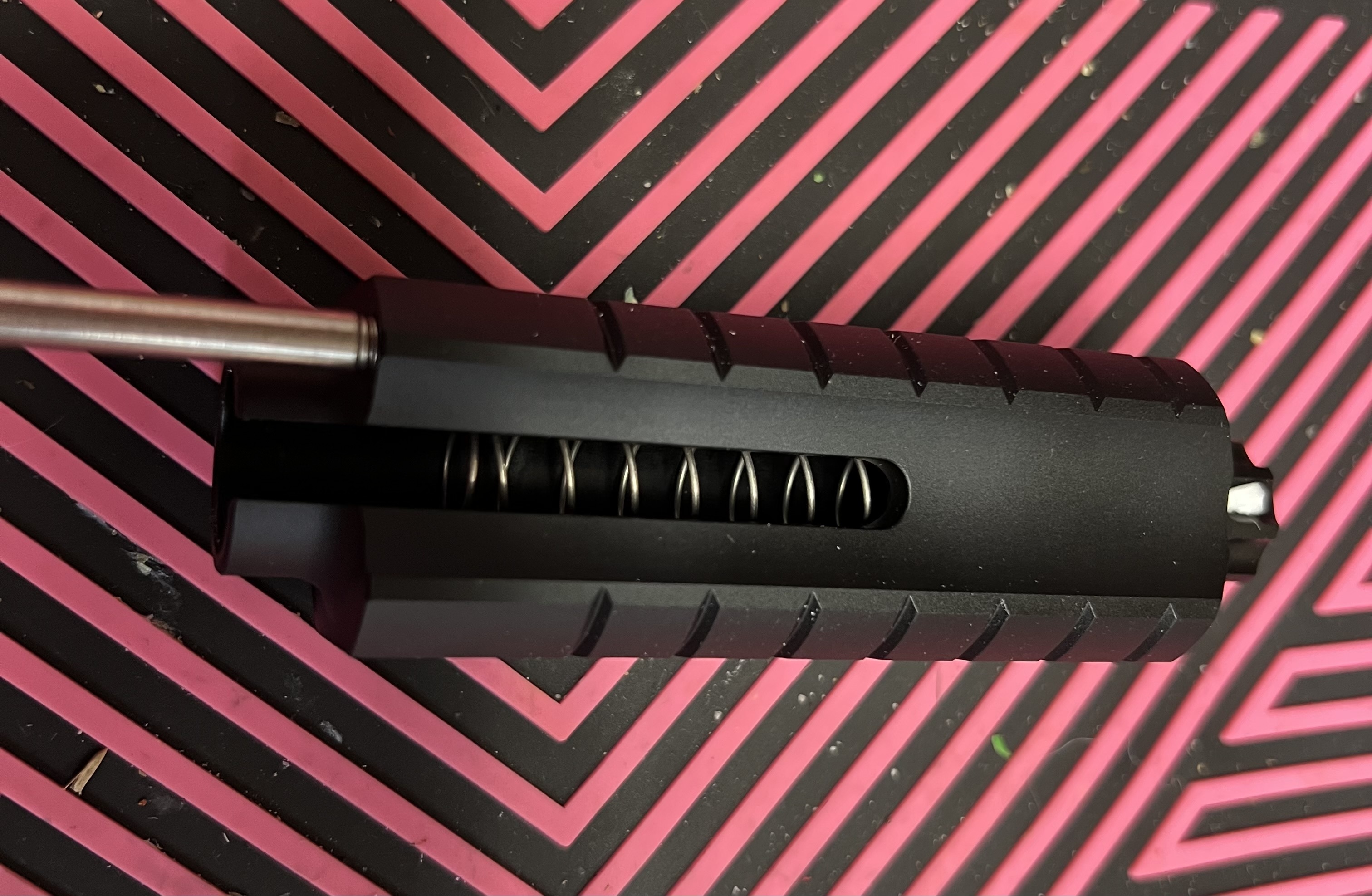

                        • 4563

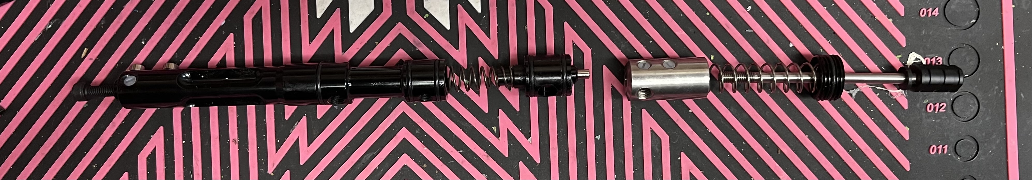

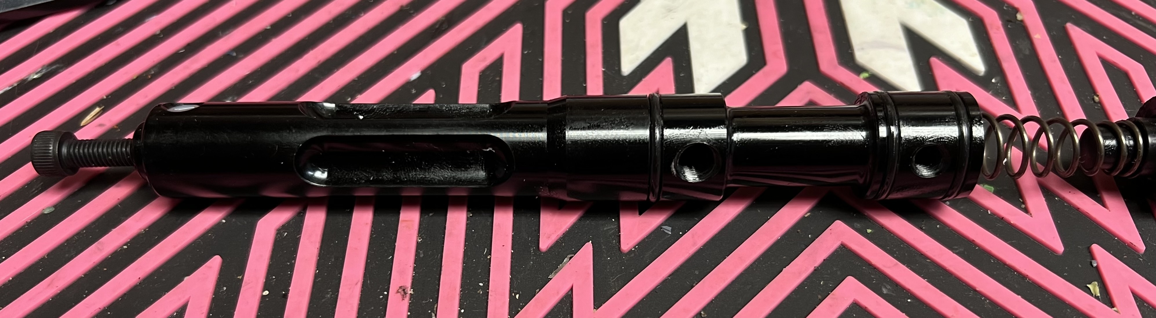

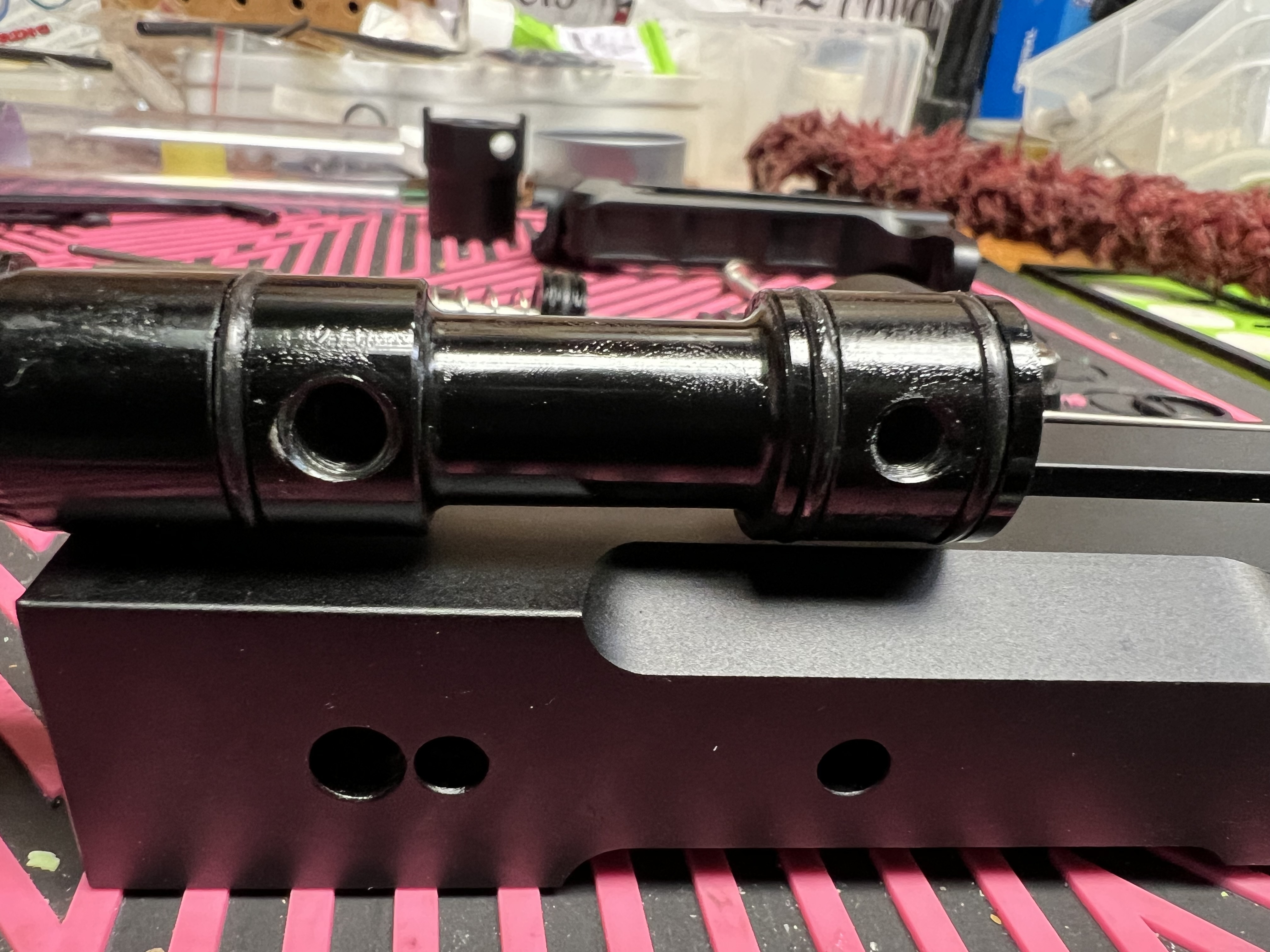

                        Now let’s get a look at the internal Meteor is using. They have bored their bodies out a full 11/16th, so they use the larger cocker valves.
                        Here’s an overview of the full lower kit. This runs from the front of the pump rod, right to the cocking rod.
                        Click image for larger version  Name:	IMG_1792.jpg Views:	41 Size:	749.0 KB ID:	582011
                        And a few move images of the front “pump rod section that continues into the body:
                        Click image for larger version  Name:	IMG_1793.jpg Views:	41 Size:	826.5 KB ID:	582012 Click image for larger version  Name:	IMG_1794.jpg Views:	41 Size:	740.8 KB ID:	582013
                        And to answer a question below, the internals are held in place by the VASA screw and the front frame screw, so in two places:

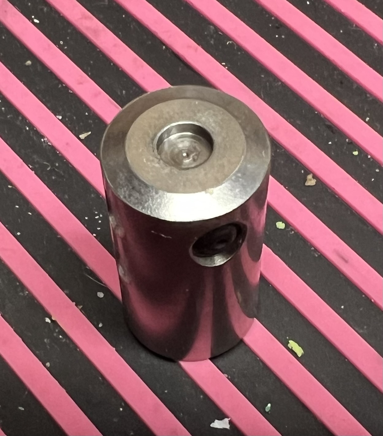

                        • 4563

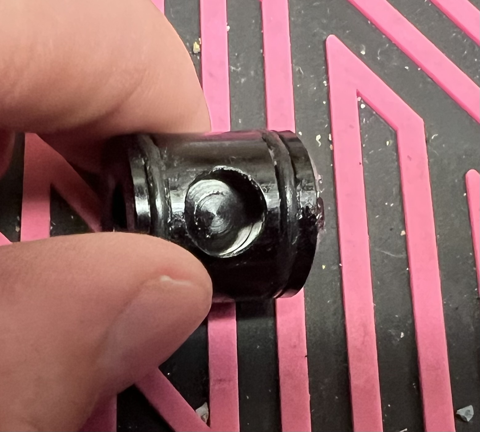

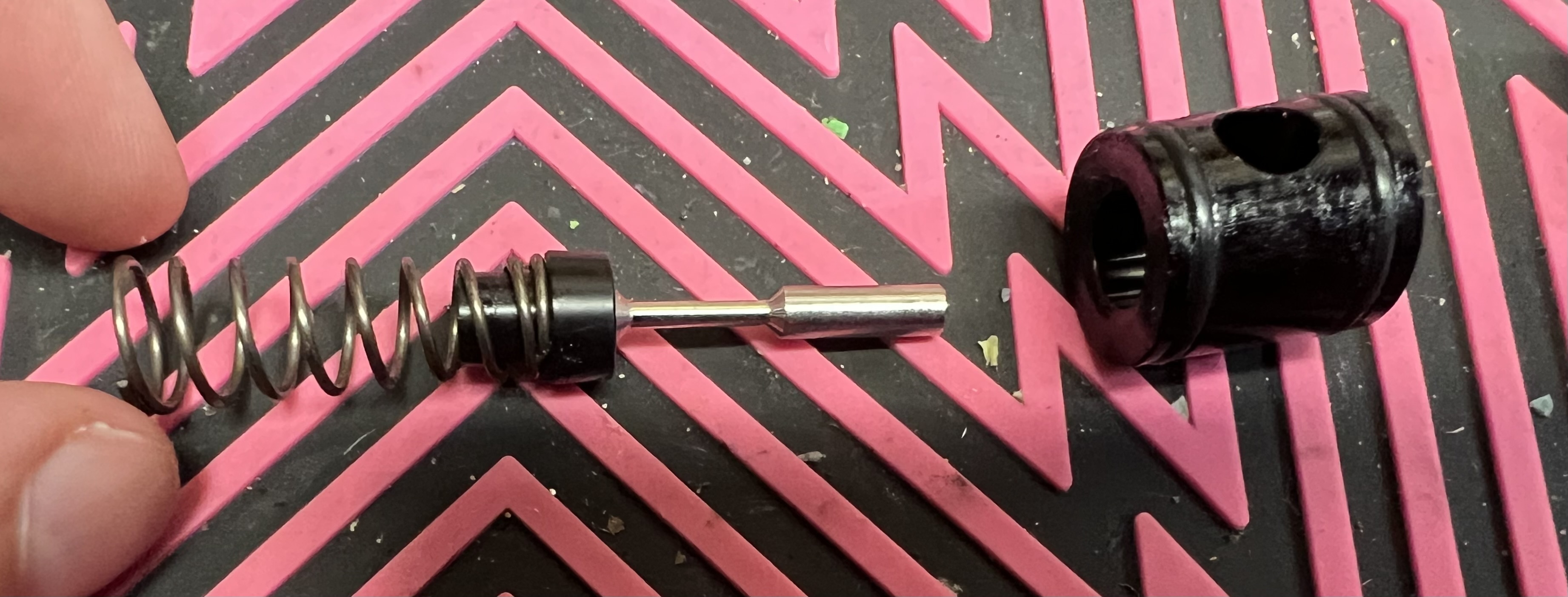

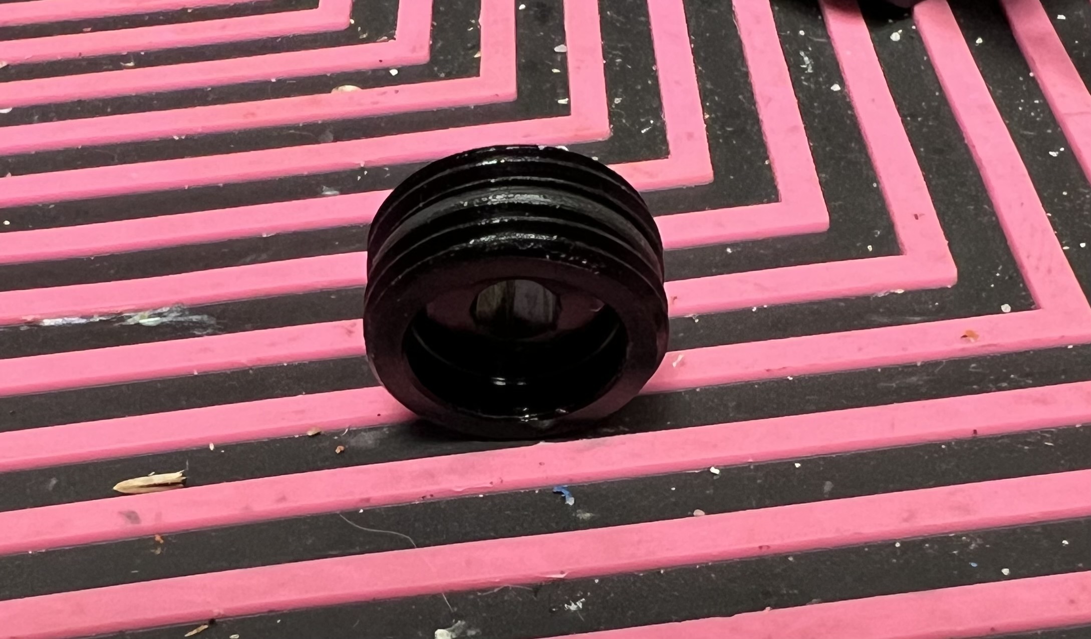

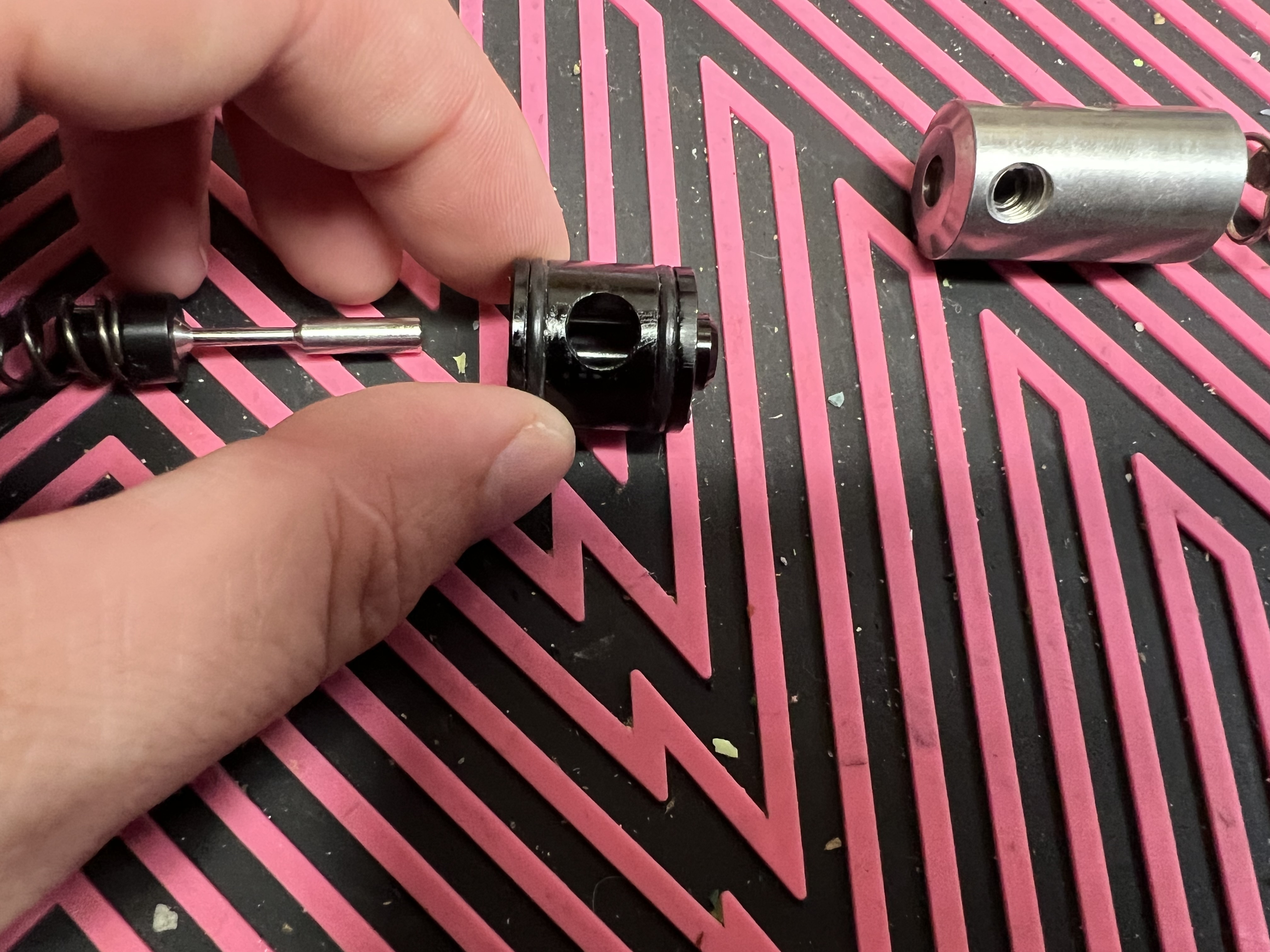

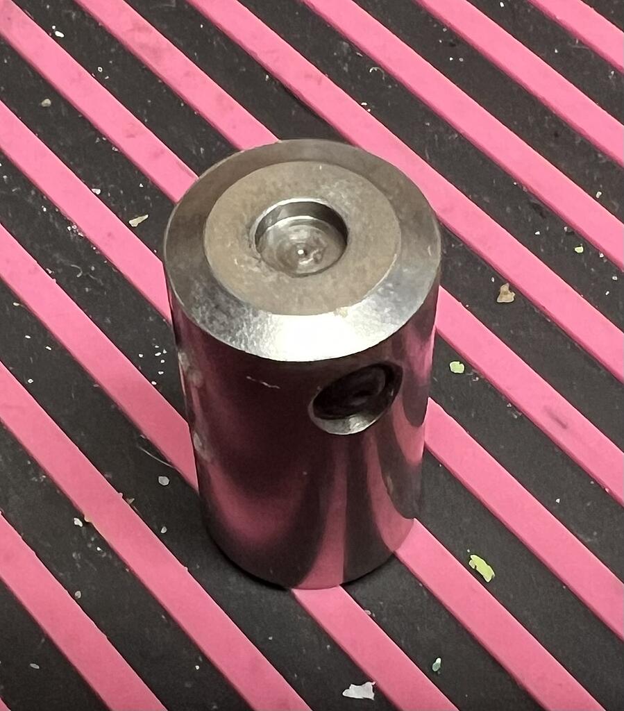

                        And here is the stock valve and valve on and spring. Note the shape of the valve spring .
                        Click image for larger version  Name:	IMG_1795.jpg Views:	0 Size:	779.5 KB ID:	582015
                        The valve itself has a dual o-ring design and is closed at the bottom
                        Click image for larger version  Name:	IMG_1797.jpg Views:	285 Size:	311.7 KB ID:	582016 Click image for larger version  Name:	IMG_1796.jpg Views:	277 Size:	1.72 MB ID:	582017
